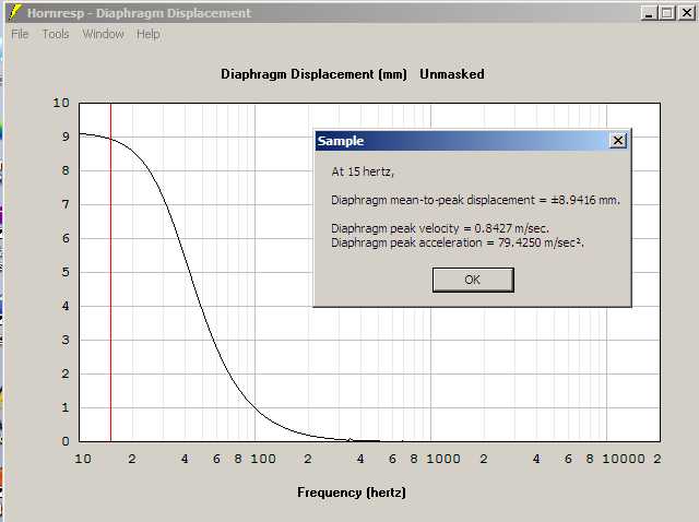

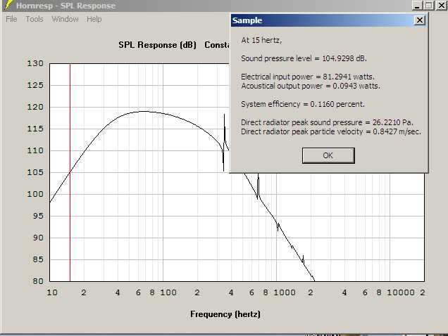

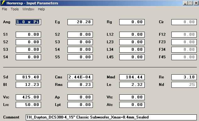

If the OP is shooting for e.g.: 105dB @ 15Hz, this would just barely do while being slightly above Xmax (, and that is assuming some room gain).

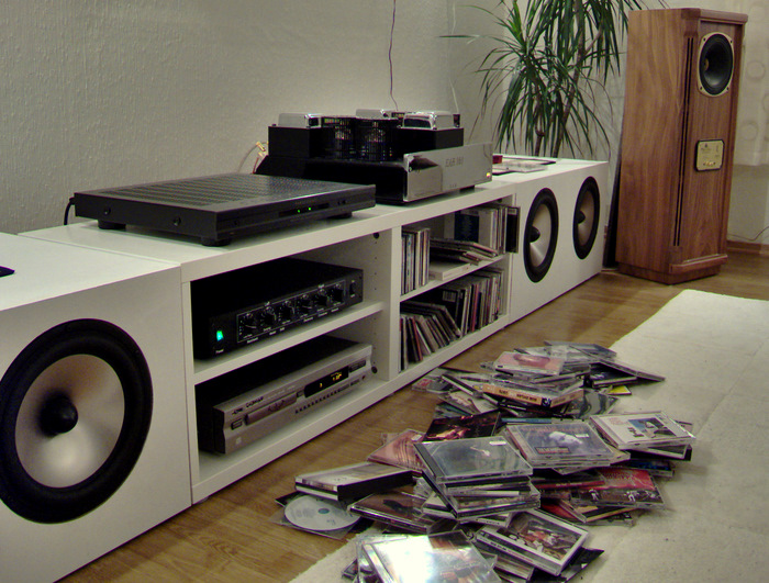

I vote "yes" to your sealed wooferbench-idea. Camouflaged as furniture it blends well into the room. Here's what i did with 4x10" Seas woofers/sealed. Nice, well balanced bass.

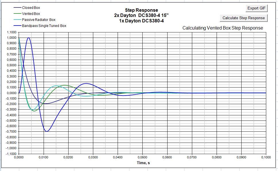

Many people with lots of experience with subs and full range speakers say that there's no substitute to membrane area! Less stroke needed to move certain amount of air. And many people say that closed cabinets give the cleanest bass (a new definition again) Please see the step response graph from UniBox below (other boxes as suggested by unibox. I don't know where that 1xDayton comes, BP?)
I want to test and try this now myself. I have made my choice of arrangement (2x15" closed), now it's just about how to do it. If I get disappointed, I'll tweak it or make a new different one just like everybody else here!
