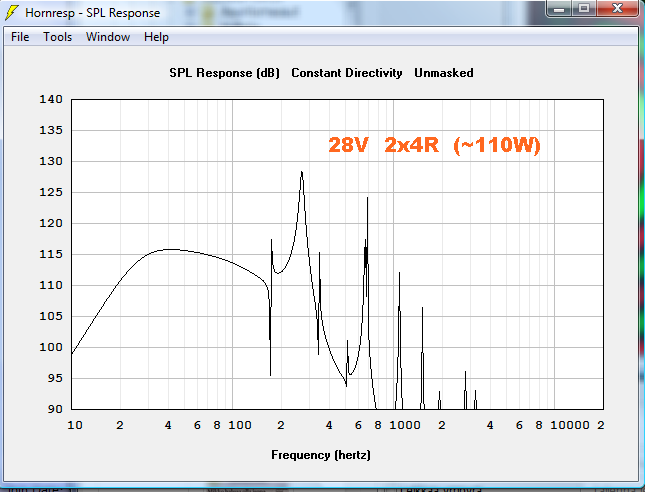

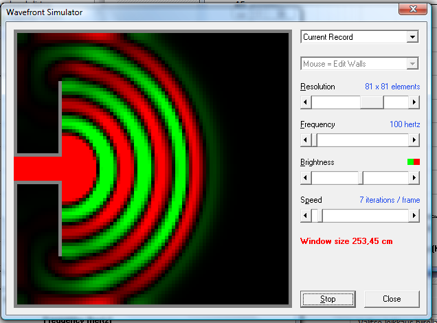

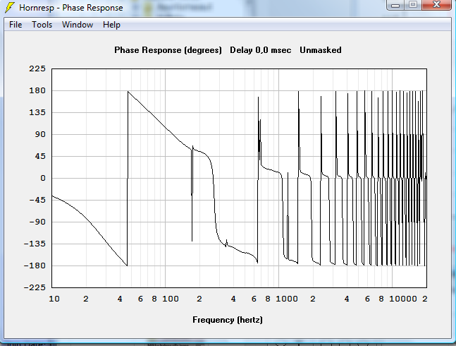

I learned how to bake a baffle in Hornresp. Here is what to expect in 1pi conditions at maximum excursion
spl
phase
wavefront simulation
spl
phase

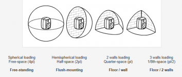

I'm not sure of the phase shift but I guess it is the plemun - depth, width, height? I mus try to change parameters and see what happens.
Pi environment definitions Radiation Space in a Room

You're ignoring the possibility of room modes.
there is no way that the plenum is causing a full rotation in phase shift at 60hz.
I wouldn't use horn response to try to model it.
It is inappropriate for subs.

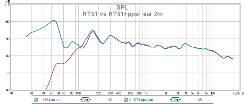

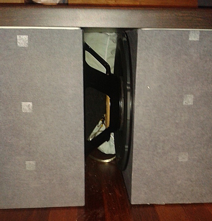

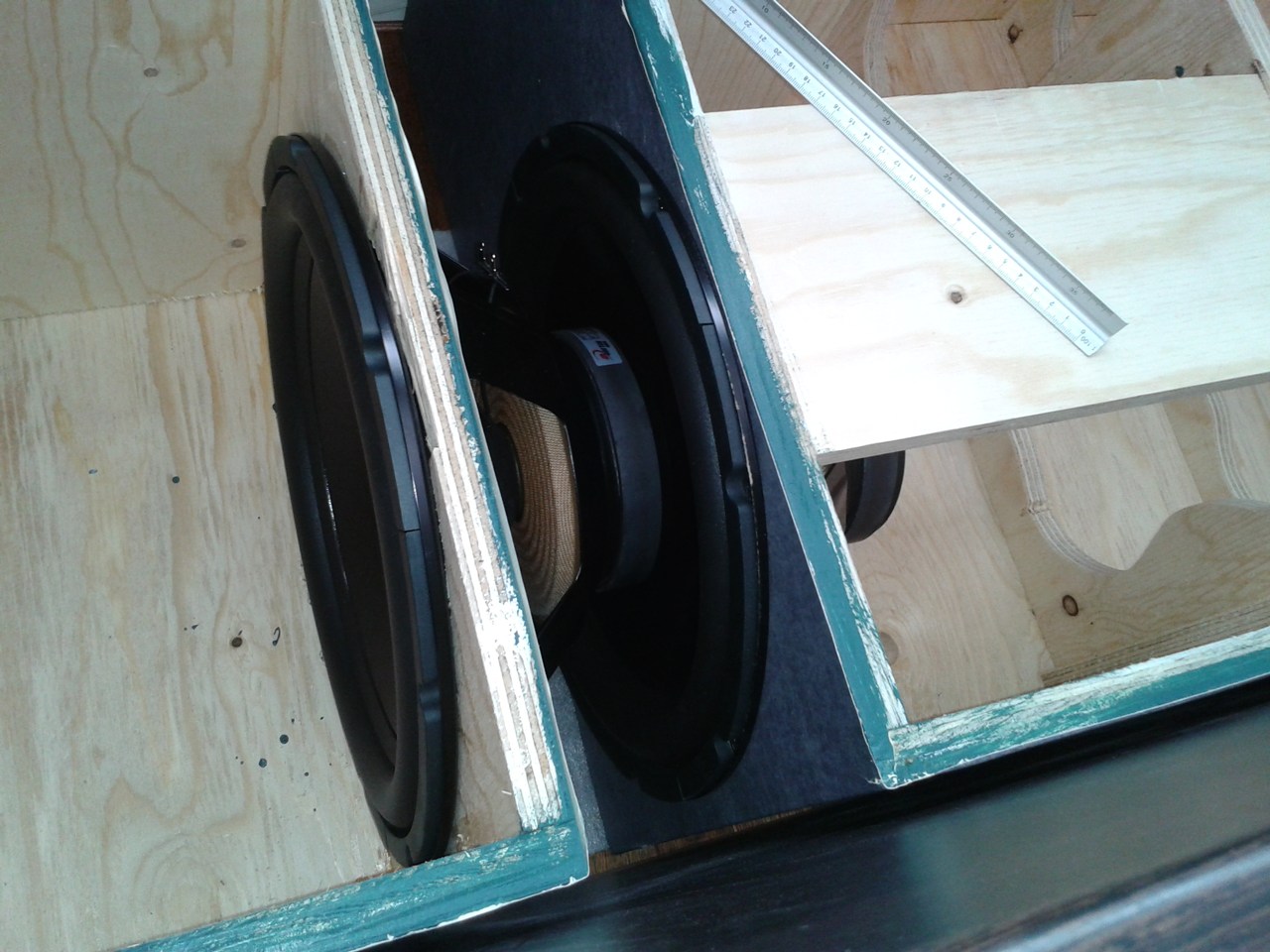

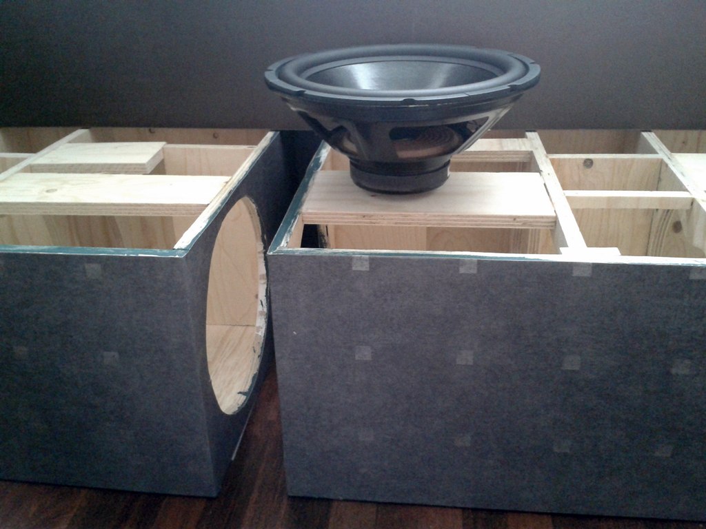

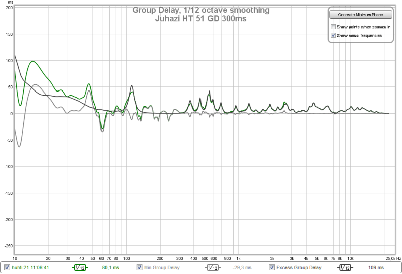

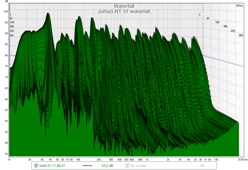

Bench sub almost finished!
A quick and dirty installation of two 15" Daytons was performed this weekend. The box was sealed wit E-profile window seal tape. The cover weighs ~40kg which is enough to stop vibrations for normal levels without screwing it. I installed the reverse driver from the inside of the box, this allowed a narrower slot, 110mm (4 3/8"). The plenum was stuffed with a pillow containing polyfill. A solid and airtight filler is needed for the finalized system. Drivers connected in series, other with inverted polarity.
The sound is "unnoticeable" ie. low distortion and low GD. Diffrent sounds and tonalities of basses and kick drums and recording setups/effects are easily noticed. Room modes at 45 - 90Hz are still a problem to be solved. A second sub on the opposing wall should help a lot. Low-end extension is limited by Hypes plate-amplifier's fixed cut-off filter at 12Hz/24dB
The Hypex DS2.0 has an easy job. The level is 9-10 o'clock, no eq, no phase shift, lowpass at 12-15 o'clock. I have connected the Hypex simultaneously to two different amplifiers a AV and a stereoamp by RCAs. The AV amp has Audyssey and selectable LFE Fq, I used 90Hz. The stereoamp feeds Hypex from pre-out's left channel without any filters. Besides measuring sessions, I tune level and xo by ear for each amplifier.
REW-measurements (Onkyo TX-NR509, Audyssey on) fed from desktop pc's headphone out which has some attenuation of lowest and highest Fq. Microhone miniDSP UMIK-1(calibrated).

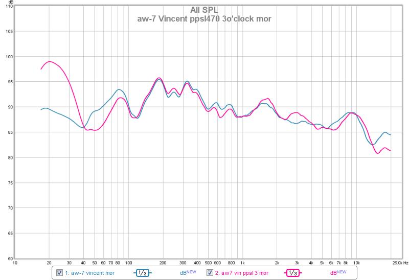

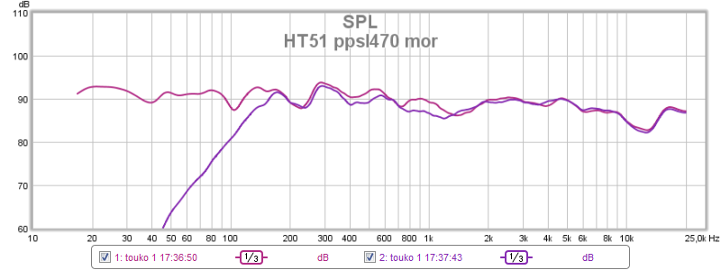

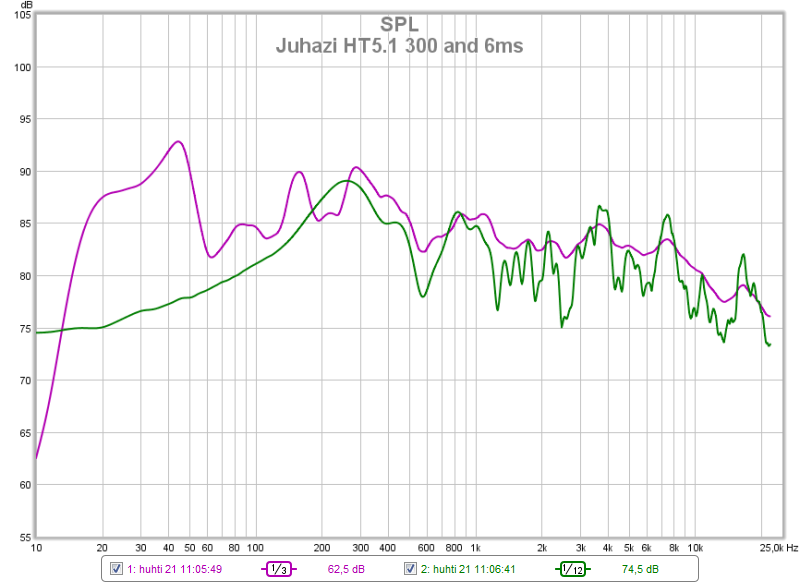

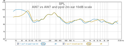

I show you more measurments of PPSL470 to show you how much the room, microphone position and amplifier setup mean to the measured amplitude response.
AW-7 Vincent is my closed box SEAS coaxials in stereo running fullrange and with the PPSL sub. The sub had it's Hypex plate-amp's xo and level adjusted to give some more "bottom"
The HT51 system is Onkyo TX-NR509 with same AW-7 front speakers (3) and Amphion Helium2 rear speakers (all set to small), and ppsl470 sub xo at 90Hz and Audyssey optimization run.
mor is: microphone in the middle of the room (140cm height)
ear is: microphone at my ears' position when listening on sofa
Measurements done wit REW, 300ms 1/3 smoothing

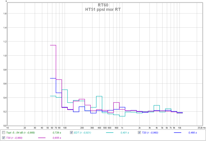

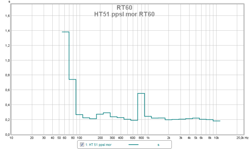

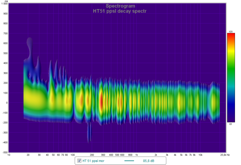

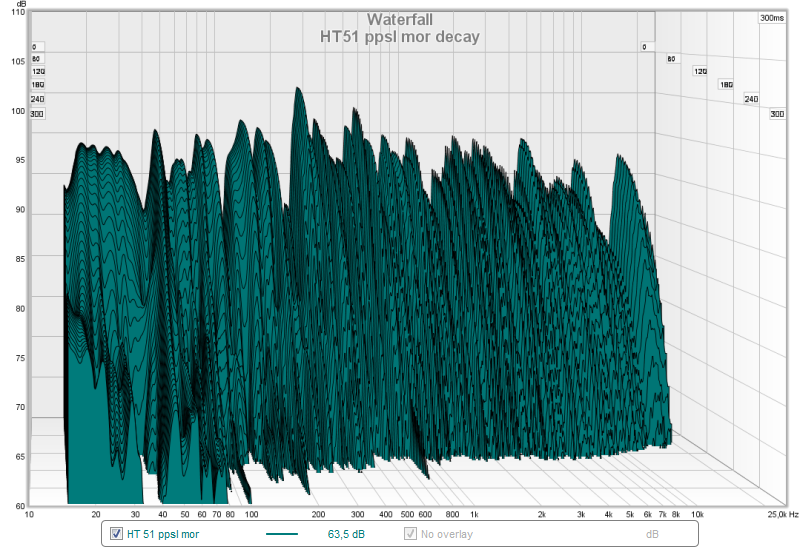

PPSL470 with stereo and AV setups, measured with the microphone in the middle of the room (minimal room modes' effects)
decay waterfall and spectrum
RT
My room has a serious problem with 45Hz. I think I should open up the ceiling and put some insulation wool there and make it work like a resonator or bass trap

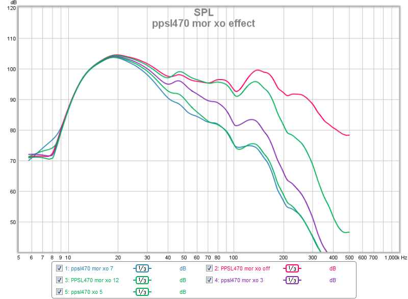

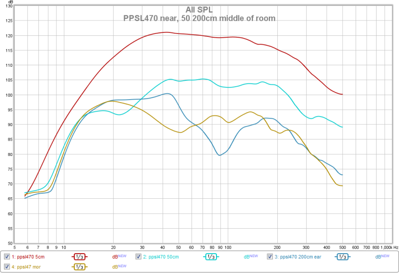

Here are measurements of the PPSL470 sub in nearfield, 50cm (both with microhone on the foor level) and with the mic at my ear and in the middle of the room
and the effect of xo adjustment (with mic in the middle of the room)

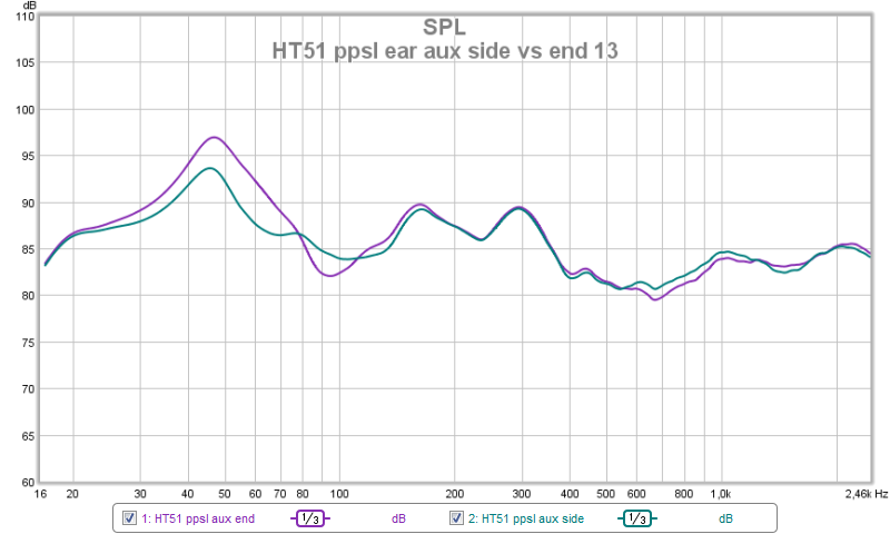

New measurements - I moved the auxiliary sub to the opposing short wall but the response at listenig point was better the other way. New measurement of sidewall position with same xo and level settings in both subs.
I have noticed that when I run the Audyssey setup in Onkyo, it changes the subwoofer xo to 40Hz. This results in bad response because the room problems at 40-100Hz are not treated by several drivers putting out same signal from various positions. So I always change manually back to 90Hz after running Audyssey.
Now i can let the speakers sit where they are and just try to fiddle with xo, eq and level.
The 2ch setup must also get the split signal for 2 subs. It is easy to do with a RCA splitter connector.
