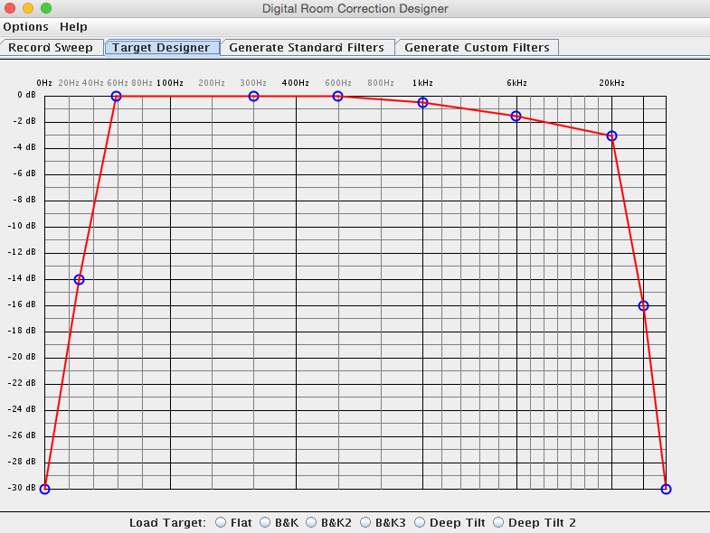

BTW, this is the target curve I play with at the moment

Are you referring to gmad's filter or did you play around with my template as well? My template might give less boost as it has a dip limiter engaged.
But to call this a high pass would be taking tings to far
The dip limiter will prevent boosting deep dips.
DLMinGain = 0.2 #
In the original template the DLMinGain = 0.01. The plot above is made with the template I uploaded. You could try to set DLMinGain to 0.1 which corresponds to -20 dB. I don't want narrow dips being boosted because that could make the sound more strained. But it can effect the boosting of the highs and lows past their natural curve.
You can play with all parameters in the custom tab with my template. And use that target curve.

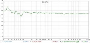

This is good stuff, gmad, Greg (is it?). I tried it yesterday and it did clean up the sound nicely. In the past, I have made measurements and corrected the HF response and also the LF response. But it is always hard to correct the response from 100 Hz to about 300 Hz. I have never been able to satisfactorily correct this range. But the sliding window plus auto correction that DRC offers seems to really benefit this area. Most of the voice fundamentals and instrument fundamentals are in this range.

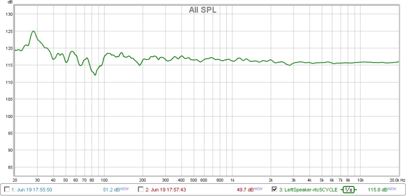

I tried the 5 cycles filter and here is the response I am seeing (from the test.bat output). Crossover to the sub is right around 80-90 Hz. And I had some corrections in JRiver turned on when I did the measurement. What I perceive is lack of upper bass, but lowest frequencies (<40 Hz) are well reproduced. Low male vocals are excellent, which tells me that 100 Hz onwards is also good. It is also a little bright in the HF, but very smooth, i.e., no resonances. Does the soft template target a shelved HF response? I think this is what is needed when I'm measuring in the far field.
How do you create a target that gives a 6-10 db bumped up response from about 100 Hz to 50 Hz and then a slight roll off to 20 Hz?
I'll try some other filters too. I'm interested in what the ERB filter does. Your guide really helped getting things started. So, thanks!

Glad you're having fun with DRC. If you like the ERB template it is a bit different from the others in windowing. Quite loose in the bass, a bit longer up top.

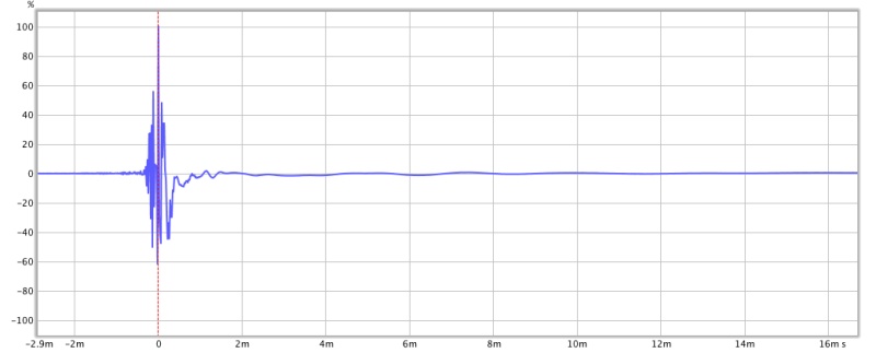

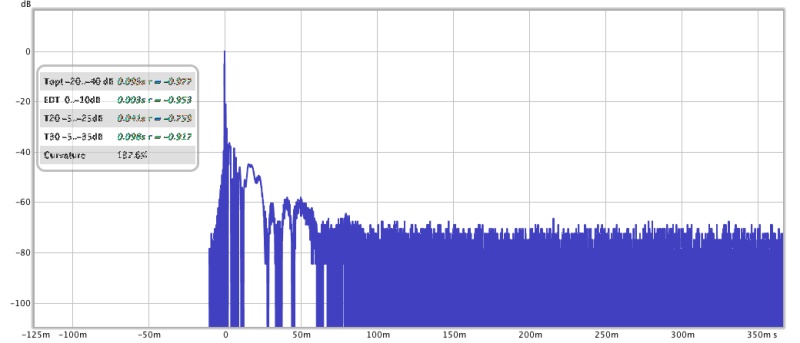

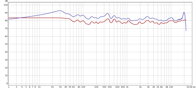

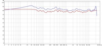

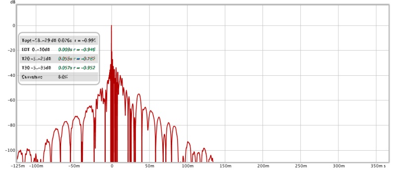

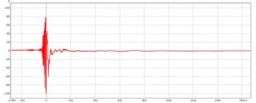

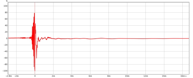

Got to listen to the new B&K filter and it is very close to my custom filter. Differences being that Greg's filter is more focused and a little more clinical with the experience. My custom is a bit wider and has a little more lower mid range, giving it a warmer presence.
I imported both filters into REW to take a look. My custom (blue) versus Greg's (red) has a big boost at 30Hz and a spike at 20Hz. I have no idea how they got there since that was not the target response I drew up. Don't care about the 20Hz as I can't hear it, but I definitely hear the lower boost.
Otherwise, it follows pretty much all the way through.
The big differences are in the Filtered IR plots. Greg's looks great, mine... hmmm...

B&K = bruel & kjaer. Read this paper. Figure 5 is what you want.
http://www.bksv.com/doc/17-197.pdf
Essentially, when you are in the far field, you need a bass boost between about 40 Hz to 100 Hz and then flat to about 400 Hz and then a shelved down response. The amount of shelving depends on the directivity of your speakers, your listening position relative to the speakers and the room abosrption.
