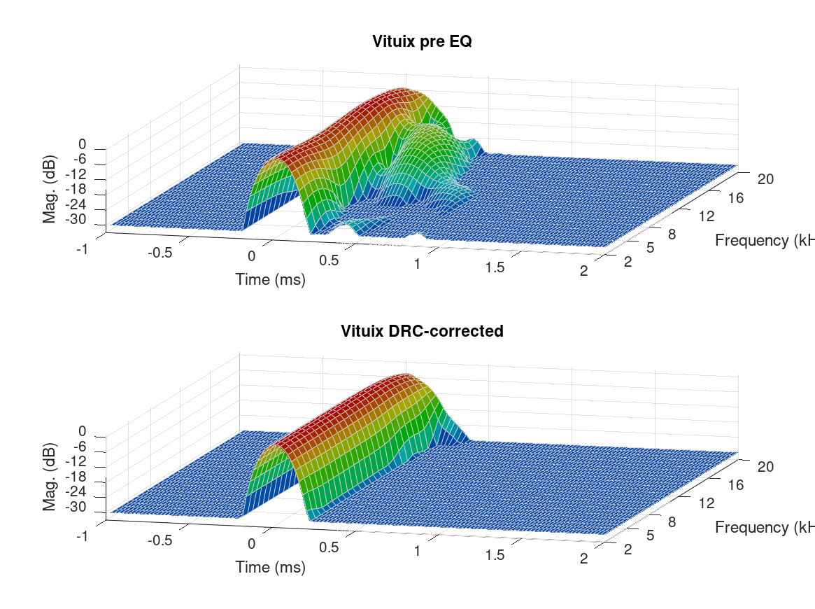

I have been experimenting with colormaps and display issues.
I added a 0 degree plot generation to view the pre/post ringing on both sides at once. Can also see the "linear" alignment of the wave. It now dumps out 3 plots, Formation, 0 degree and Decay.
Each plot has descriptive labels as well.
As resolution increases the mesh color tends to dominate the image, so I am trying to find a ubiquitous solution for that.

What kind of correction do you use here? It seems like the corrected pulse has high levels of pré-ringing. Have you tried one of the various templates linked in the first post of this thread?
I haven't listened to this correction filter. It was created to test the plotting code modifications.

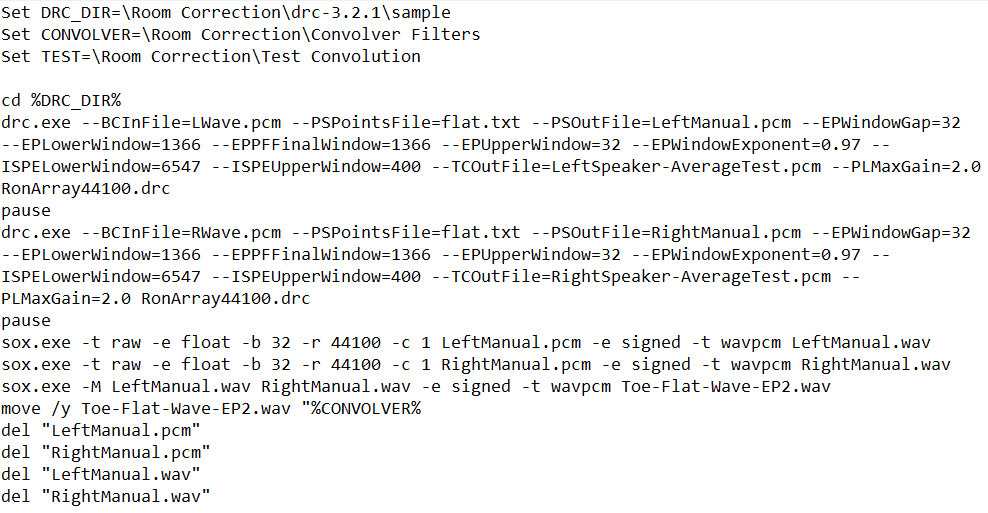

I used DRC-Designer, slammed a few sliders to the extremes to generate the most contrast between the Uncorrected/Corrected test plots. I then generated the test filters in different sample rates to test multiple sample rates plots. The code originally only supported 44100.
I modified the DRC-Designer generated *.bat scripts to capture the intermediate files which required hand editing the soft.drc files to force the intermediate output file creations and switched some of the flags that I read about in this thread to Linear Phase while I was in there.
I added waterfall plots and am parameterizing the code in the attempt to optionally plot 1, 2 or 3 plots per page next. The original code was cut-and-paste rubber-stamped to create each plot which made its size very large and tough to see the pertinent deltas between plots. I am trying to make it table driven with reuseable functions so it is easier to add new plots without copying and pasting a hundred lines of code at a time.
I have not used OCTAVE/MATHCAD before so I am learning the syntax as I go and hopefully learning more about the math/functions/paremeters used to generate the plots in the process.

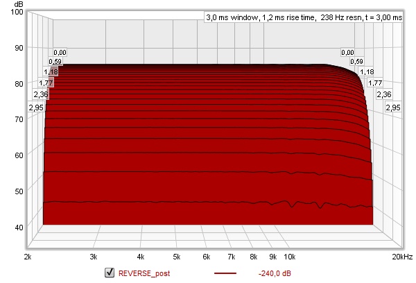

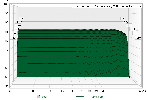

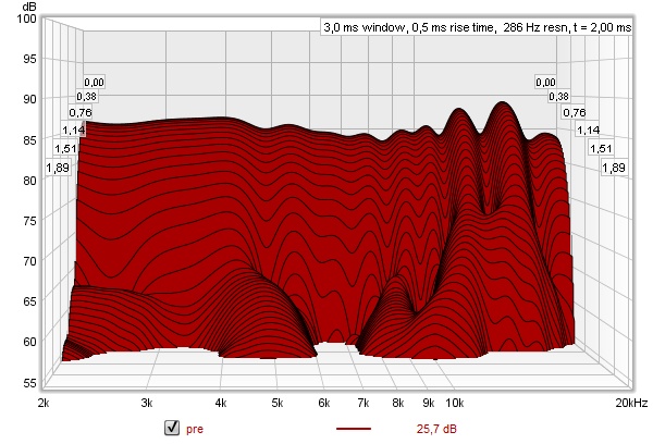

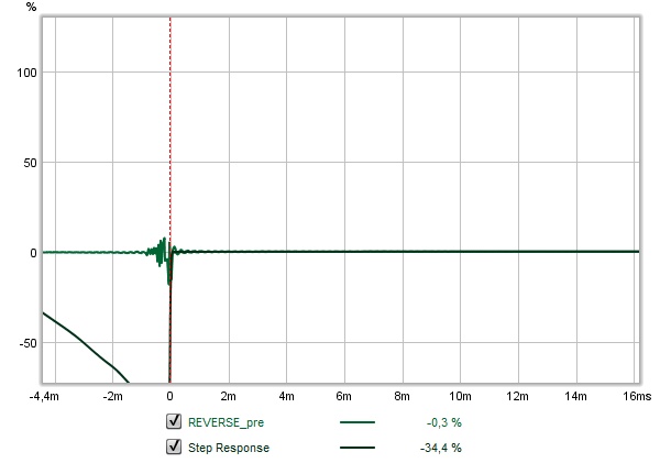

Seek and you shall find (lol)...

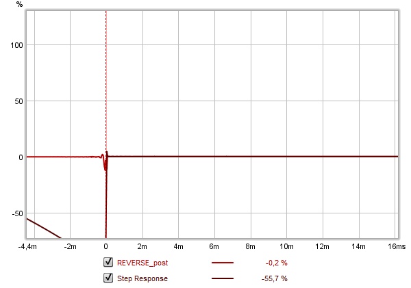

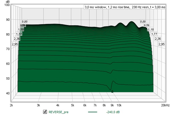

I figured all I'd need is to reverse the audio file and load that into REW. So a quick search gave me this site: Reverse Audio - Audioalter
The reversed Pré IR:
Post IR:
Waterfall plot of the other side of the pré IR:
(notice the 50 dB scale)
And the post convolution IR:
So a simple tool like that would give me all I need...
A clear view of the other side of the impulse. Now why didn't I think about that any time sooner!
Post IR:

Based on those tests I created my own templates and batch files to be able to adjust them for my specific goal to fit the impulse correction of floor to ceiling arrays.

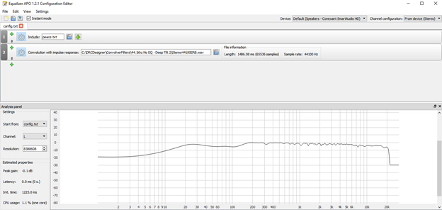

Ok, thanks everyone for all the feedback, I truly do appreciate it! I am vert excited to start toying around with DRC for sure!
Resolved issues:
Mic calibration:
Yes it is very picky formatting, thanks fluid for the guidance. The problem was my mic calibration started at 10db and not 0db and ran to 20,000 not 22,050. So I just had to add the line
0 0 at the start and 22050 0 at the end and it worked like a charm!
Equalizer APO:

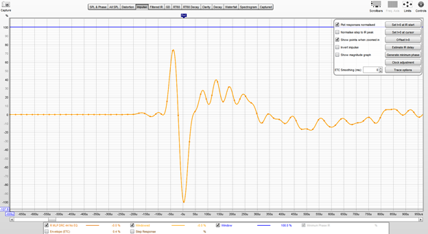

I got Equalizer APO to work I think?!
Below is a screen capture for a very generic response made from DRC Designer just to prove to myself that it works.
I think EAPO has a VST Plugin but I could not get it to work but it seems that the loading the .WAV as the convolution impulse response works fine so no need to tinker with the VST plugin I suspect.
DRC Designer:
I got DRC Designer to start working! But yeah I think I will want the flexibility of the scripts from gmad and others, so I will have to dig into those scrips a bit more.

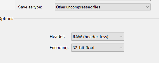

2) Changing .wav impulse to .pcm
I cannot find an easy way for Audacity to export as .pcm and thus am using Cool Edits Pro as that was suggested as a potential program from percevals guide in post #9. So is there any need to use audacity at all?
I measure and export from REW, change impulse .wav to .pcm with Cool Edits and put in the drc “sample folder” and then run various scrips and then load the convolver filters into Equalizer APO as my convolver. Is this general workflow correct?

4) IR Timing
My impulse response is just slightly off from 0 as it identifies the downward component as the larger peak and thus the impulse center.
Will this be an issue? Or should I tell DRC where the impulse center is?
I could not figure out how to make Audacity display the information, so I just used REW to “Show points when zoomed in” and then count back from the sample rate
So 44100 – 2 = 44098 is what I should put in "BCImpulseCenter" and then put "BCImpulseCenterMode" as “M” does this seem correct?

Equalizer APO:

4) IR Timing

That is simple you export the audio as raw 32 bit float and then change the extension to .pcm manually as Audacity uses .raw2) Changing .wav impulse to .pcm

The 100% peak is almost always the actual impulse centre unless somehow you have a very early reflection that is higher than the direct sound. I would check the polarity of the system as it could well be reversed somewhere. If you leave impulse centre as Auto DRC will find it and use it.4) IR Timing
Yes5) Test Filters:

Code:
--EPWindowGap=32 --EPLowerWindow=1366 --EPPFFinalWindow=1366 --EPUpperWindow=32
--EPWindowExponent=0.97 --ISPELowerWindow=6547 --ISPEUpperWindow=400
The above is what I use.
PSOutWindow is the length of the filter for linear phase and
MSOutWindow does the same for minimum phase. You can use both in one file if you want.

I can either change the base .drc file and then just keep the one batch script that runs it, or I can change the batch script and whatever with the "--" before it will override the .drc file correct?
As I am using the first approach (changing the .drc and keeping one base batch script)
Currency my script looks like:
(This is my minimal script)
Set DRC_DIR=\Room Correction\drc-3.2.2\sample
Set CONVOLVER=\Room Correction\Convolver Filters
cd %DRC_DIR%
drc.exe --BCInFile=LeftSpeakerImpulseResponse.pcm --PSOutFile=LeftSpeaker-MinimalFilter.pcm minimal-44.1.drc
pause
drc.exe --BCInFile=RightSpeakerImpulseResponse.pcm --PSOutFile=RightSpeaker-MinimalFilter.pcm minimal-44.1.drc
pause
sox.exe -t raw -e float -b 32 -r 44100 -c 1 LeftSpeaker-MinimalFilter.pcm -e signed -t wavpcm LeftSpeaker-MinimalFilter.wav
sox.exe -t raw -e float -b 32 -r 44100 -c 1 RightSpeaker-MinimalFilter.pcm -e signed -t wavpcm RightSpeaker-MinimalFilter.wav
sox.exe -M LeftSpeaker-MinimalFilter.wav RightSpeaker-MinimalFilter.wav -e signed -t wavpcm MinimalFilter.wav
move /y MinimalFilter.wav "%CONVOLVER%
del "LeftSpeaker-MinimalFilter.pcm"
del "RightSpeaker-MinimalFilter.pcm"
del "LeftSpeaker-MinimalFilter.wav"
del "RightSpeaker-MinimalFilter.wav"
and then I edit my .drc file with whatever edits that I want (so in this case I edited my minimal-44.1.drc file in the Room Correction\drc-3.2.2\Sample folder).
This is equivalent and an acceptable work flow is it not?

Ok I am just making sure that I got this right.You can have one base .drc file and then create different batch scripts to change the parameters. Whatever is in the batch script with the -- flag before it will override the base file.
cd %DRC_DIR%
pause
pause
