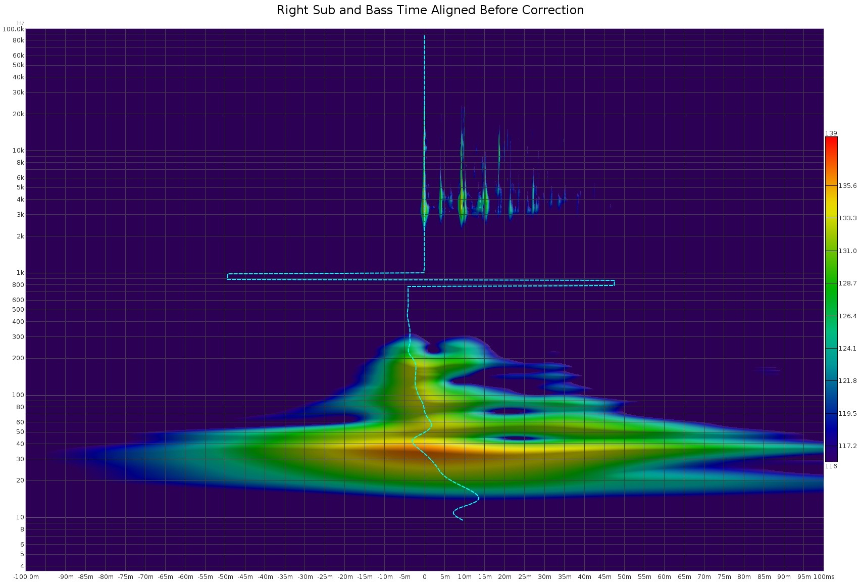

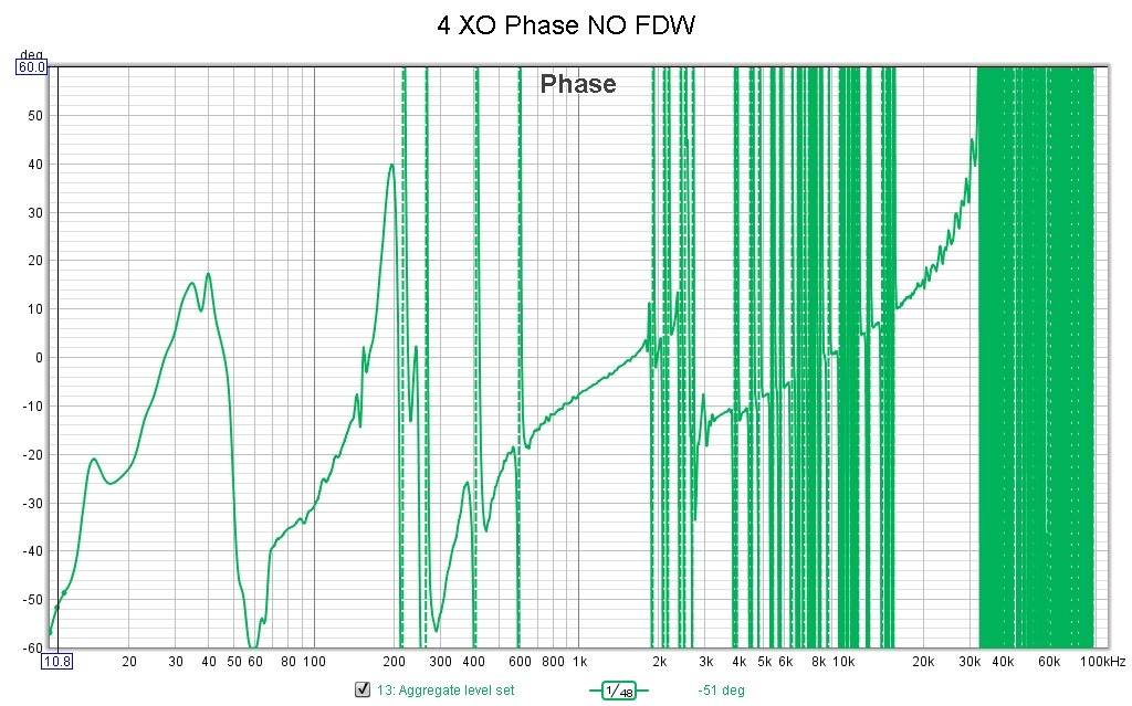

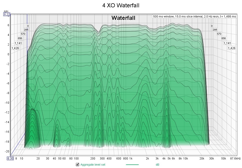

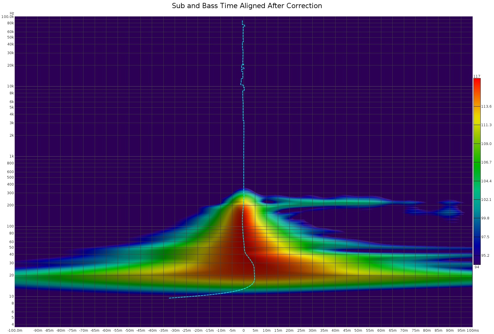

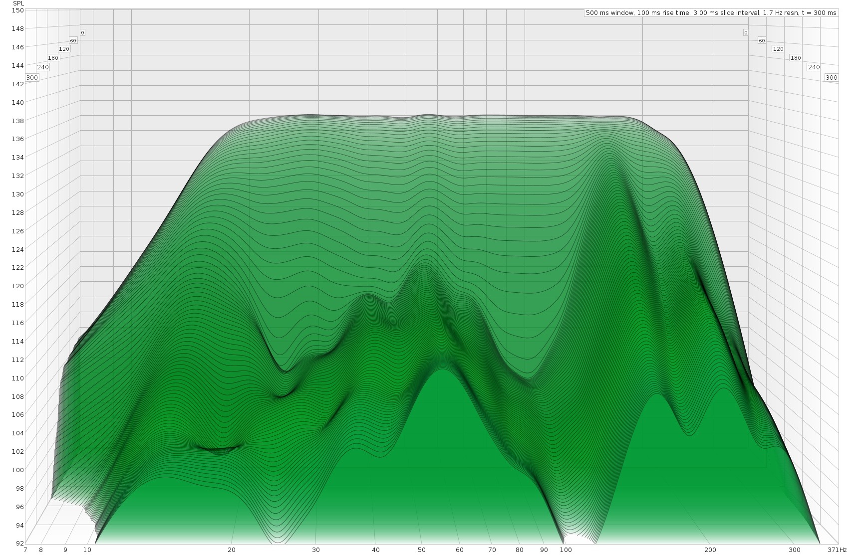

I was getting intermittent results in the lower frequencies (sub and bass) and identified the root cause being the RT (Ringing Truncation) phase of DRC-FIR. Once disabled (will revisit later in more detail), the low frequency amplitude corrections consistently snapped into place.

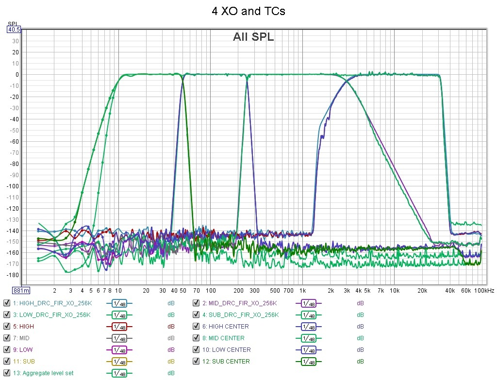

The following are 4 actual sweeps (sub,bass,midrange and tweeter), corrected individually, test convolved individually and merged into an aggregate test convolution of all 4 drivers.
I am working on the better automating the phase integration between the 4 drivers next with current state shown in the last plot (with no FDWing enabled). The phase discontinuity between the bass and midrange panels exhibits itself in a non-flat summing across the XO region (as seen in the waterfall plot at 250Hz) which hopefully will be shortly automated.
Plot windows are displayed with Blackman-Harris-4 windowing, no FDWing and 1/48th/octave smoothing for readability.
176.4kHz sampling rate, 256K taps.
Waterfall using 1/3rd octave smoothing.
Crossover points at 50Hz, 250Hz and 3kHz.

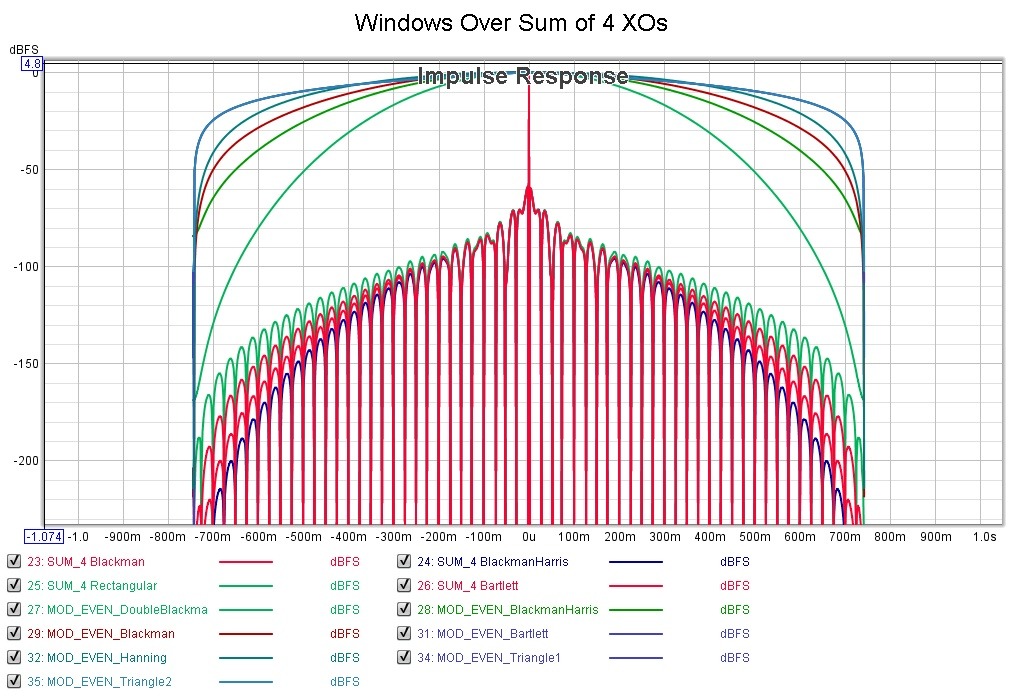

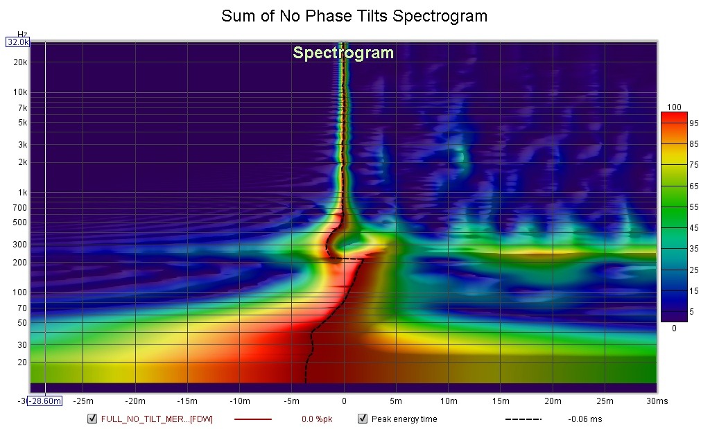

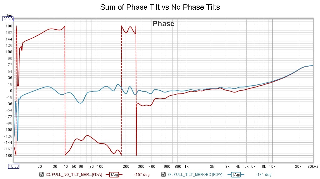

I figured out how to sum FIRs in source code (instead of doing it in REW with the trace arithmetic functions) to make composite FIRs in addition to merging FIRs. I made some general library tools that can be directed to either sum or multiply in the frequency domain to facilitate both functionalities. Wish I would have known how to play with FFTs a long time ago.
The tool can now composite (sum) all XO's/channel into a single FIR for analysis (see cyan plot below) without having to manually do it in REW. It can also create test convolutions of each XO/correction and its corresponding signal and then composite all of the test convolutions/channel into a single FIR for analysis (see gold plot below).
Once the composite XO and composite test convolutions are generated, they can be quickly compared in REW.
My rig is stereo 4-way, so it can composite (4 drivers) x (2 channels) x (N plot) sets in seconds. This greatly speeds up the analysis work in REW. This new composite functionality should feed into the following work.

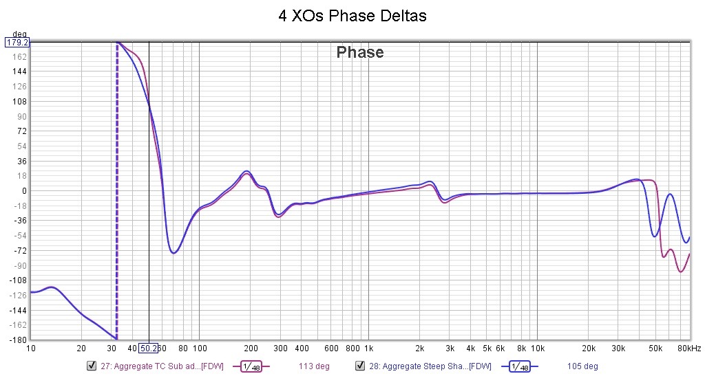

The following plot shows the crossovers, the uncorrected signal and the generated corrections. Note: The purple sub XO has a deliberate 6dB/octave bass boost in it, so it shouldn't be flat.
I discovered that by doing corrections at the driver level, one may be able to achieve a finer degree of control of the artifacts and THD.
In this plot, it became apparent that the bass driver had the most severe corrections (due to room modes) which resulted in elevated THD, but those settings were fine for the other drivers. Being such, each driver could have more or less correction based on its unique situation and characteristics. In my situation, the bass needs a WE of @ 0.7 to get rid of the artifacts where the other drivers are happy with higher WE settings.
Aggregating the individual PS FIRs would be another use for the composite tool and subsequent analysis.

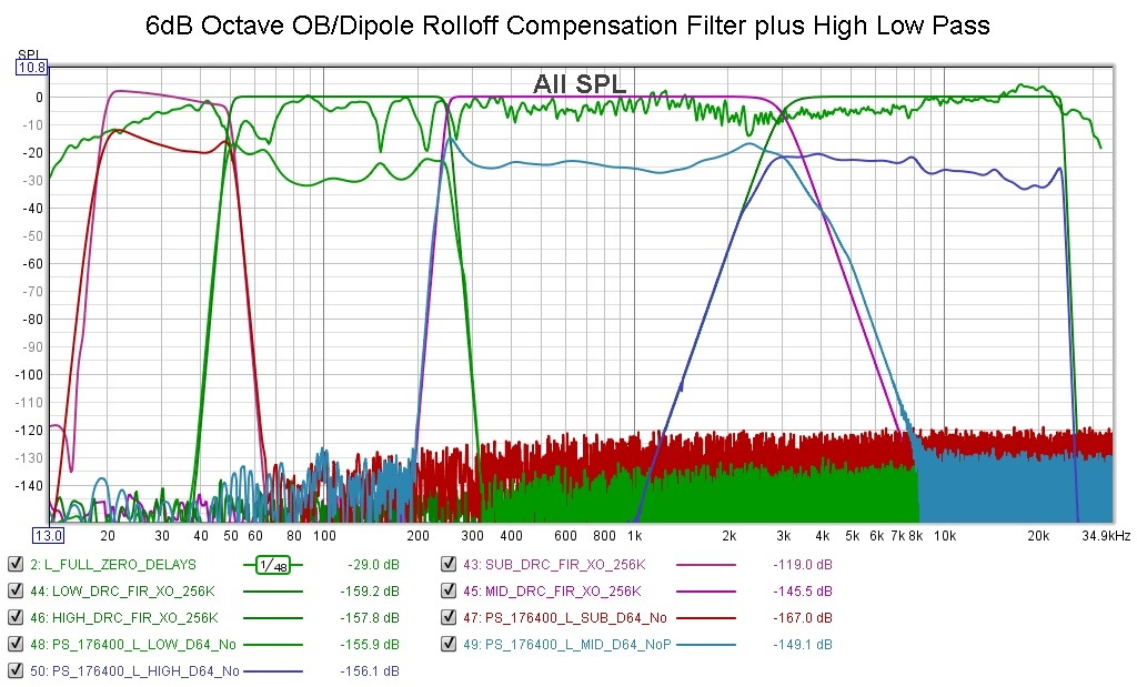

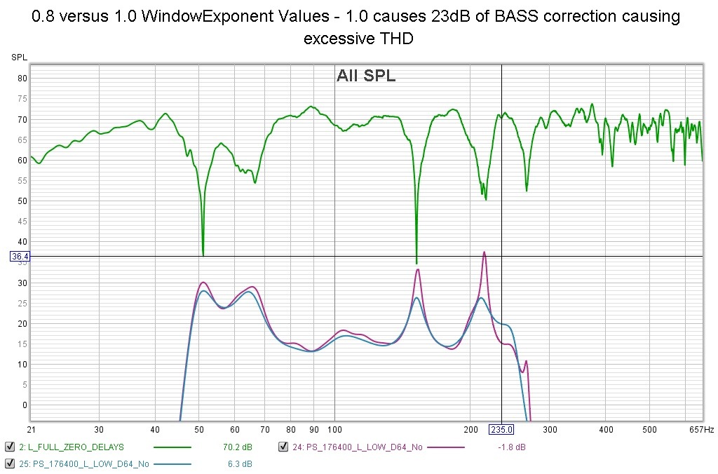

Here is another plot of the bass driver's correction settings (WE of 1.0 vs 0.8) that only cause artifacts in the bass driver but not the other 3.
Note the extended purple "tines" that are attenuated in the blue plot with a lower WE setting of 0.8.

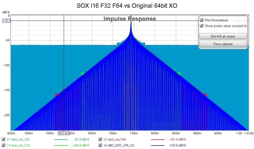

I added convenience shell calls out to SoX after the merged PCM has been written to convert the PCM to a WAV file so it can be fed straight into REW, JRMC and/or CamillaDSP. Actually, it calls out to my wrapper to bypass SoX's 32-bit thunking on F64 files.

I believe you can merge - get the H(f) of several cascaded filters - in Vituix of all places. Draw the schematic with a G(f) block for each filter than export the impulse response of the filter chain's buffer. Vituix has IR to G(f) function at the bottom of its tools menu
I use summation to simulate/predict/analyze/test/debug how the aggregated N-XOs and various stages of processing would perform in unison against a baseline fullrange measurement and solution.I can't quite get the summation of FIR files for a N-Way speaker. As far as I use them (6 channels), I use one FIR file (or a left/right channel of a stereo FIR)

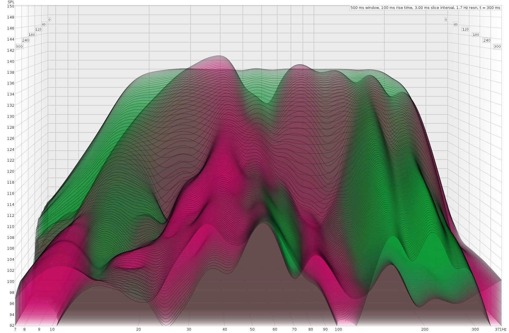

This plot shows how DRC-FIR was flattening out the phase of each driver, but wasn't adjusting the "tilts" (see 50Hz, 250Hz and 3kHz crossover regions). The merge/multiplying of a RePhase generated +/-N phase FIRs improves these phase incontinuity steps by leveling their "tilts" such they line up before being summed.

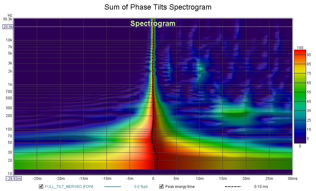

The following plots shows the summations of Test Convolutions of 4 drivers both with and without the Phase Tilt correction functionality recently added discussed above. I tried to drop in Uli's Phase curves for each of the 4 drivers centered at 20Hz, 50Hz, 250Hz and 3kHz. If you look closely, you can see each of those corrections. This is one of the major design goal milestones (especially for multi-baffle systems).
The Sub and Bass had their polarities intentionally inverted 180 degrees in the original measurements. If you look at the code snippets below, you will see 180 degree FIRs being merged to the Sub and Bass results in addition to their respective tilt FIRs (3-way merges). The Mid and High only has their tilt FIRs merged (2-way merges). This is a quick first pass and it looks like the 60Hz dip can be improved upon.
The Spectrograms depict the phase alignments of the 3 separate physical speaker baffles a bit more dramatically.

Added Command Line Interfaces (CLI) to merge and resize/retap (change # of taps) FIRs. The retapping CLI allows you to specify the number of taps, input file format (e.g. F32, F16, INT32, INT16) as well as the final window algorithm to be applied (e.g. Hanning, Rectangle, Blackman, Blackman-Harris, Bartlett, Triangle, etc.).
The following code snippets shows examples of merging (sum and multi) FIRS using NormFactors to adjust the amplitude of the merged output FIR. Global settings are made in the X.drc file (such as NormTypes, SampleRates, etc.) so they don't have to be added on the CLI, but can be if desired. The CLI can merge up to 10 FIRs at once (hope that is enough but can be easily increased).

Was doing some unit testing and wanted to share this plot. I thought I had some precision issues and it turned out to be a SoX conversion that slipped into the mix.
16-bit int doesn't looks so good in comparison.
- Light Blue - SoX F64 to I16 and back to F64.
- Green - SoX F64 to F32 and back to F64
- Red - SoX F64 to F64
- Dark Blue - Original F64 and Alternate Code.
Added the ability to specify which windowing algorithm to use in the modded DRC-FIR code for seasoning to taste.
The upper traces are the windowing algorithms applied to a rectangular/all ones signal.
The lower traces are the same windowing algorithms applied to the summation of all 4 XOs.
This should make the toolkit functions more flexible should someone want something other than the standard Blackman window.

Here is a preview of my sub and bass panels using the aforementioned driver level correction. Much faster than manually correcting and I don't have to manually add shelf filters to extend my DIY sub's bass extension.
This workflow allows you to correct drivers under the Schroeder frequency and use baseline uncorrected XOs above or any combination you choose.
Corrected Sub and Bass drivers by themselves.
Time corrected Sub and Bass drivers before and after driver level correction.

- Added ability to specify windows in fractional # of cycles or fractional # of milliseconds which is sample rate agnostic.
- Example: In section 4.2, Figure 6 of DRC-FIR's documentation shows Normal correction starting at 20Hz/500ms and ending at 20kHz, 0.5ms which is @ 9.97 cycles both stop and start values. You can now specify milliseconds and/or cycles. 500ms and 0.5ms should work the same across all sample rates for Normal correction levels without having to manually convert it for each sample rate.
- Allows each driver's correction to use its own tailored correction intensity profile settings vs just 1 for the whole speaker.
- Example: Sub=Strong, Bass=Normal, Mid=Soft, Tweeter=None, Full=Soft

One of the complaints of DRC-FIR is that it is manually intensive, requires manual SoX format conversions, requires the user to manually keep track of format information that is already stored in .wav file headers, but not raw files and thus is more complex and ripe for pilot error.
After working with SoX, I discovered it uses an internal 32-bit Int format which reduces the numerical accuracy of RePhase's IEEE 64-bit float XO filters using either the SoX's CLI interface and its API interface.
I am investigating using FFMPEG's API interface for both reading and writing files to eliminate the manual conversion stages, thus simplifying use and minimizing pilot errors. The SoX code base doesn't appear to have been touched in years where FFMPEG's code base appears to be actively maintained. If it works, virtually any lossless format can be used with DRC-FIR to bypass the needs to externally convert and maintain the header file information.
Another mod being mulled over is converting DRC-FIR to use the same actively maintained FFT library that CamillaDSP uses. FFTW is supposedly more accurate and 3-4X faster.
Be careful what you wish for, you just might get it...

@wesayso ,
Understood, but matching the target is an indication if the software is functioning as expected or not.
My goal is for it to work with minimum or linear phase targets or a match there of. As to how closely it matches the target is a function of what settings one chooses to drive the DRC-FIR engine and what frequency ranges or drivers one chooses to correct over just using the baseline XOs. The approach should give one wide latitude to do as much or as little as possible including layering on the full range house curve.
Since my speakers are in 3 separate baffles, (like the old Magnepan Tympanies), I wanted something that could handle individual drivers at different physical locations and still match phase over the XO regions. Passive XO's would not do that.
What I am currently running is corrected sub and bass drivers over their driver range to 250Hz with the mids and tweeters running their uncorrected baseline XOs with all 4 drivers time aligned in the convolution engine.
