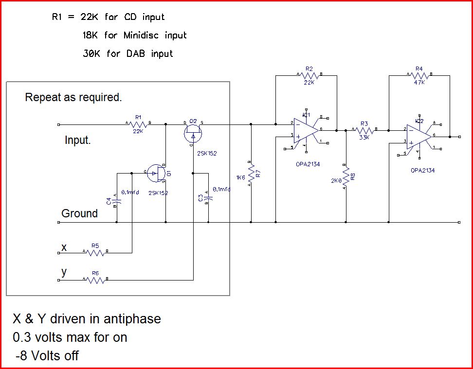

Being so encouraged with the results during testing I have gone ahead and altered my preamp to use this technique and am now in the long process of evaluating the result subjectively.
Experience has taught me to be wary of jumping to conclusions when doing work like this, but here there does seem to be quite a marked difference subjectively.
The initial impression (which has remained) is of a much more "solid" and stable image... the lower and mid registers being where this really stands out. This retains (and seems to build upon) the wonderful 3d presentaion which the amp as a whole is capable of.
Getting the resistors just right was not easy as breadboarding a test set up and even making a "point to point" model showed how stray capacitance affects the final result.
In the end I used pots to get an initial value and then replaced with fixed resistors. R7 and R8 are the new components.
The modified version is here,

I set up two OPA134's as shown in the circuit below.
The beehive trimmer cap was adjusted for good compensation of the first opamp (top scope trace in all following shots) at 40 Khz and 10mv pk pk output.
The resistor Rx on the second opamp was adjusted to give an identical waveform compared to the conventionally compensated opamp above. The value of Rx was 1950 ohms. The traces could be overlaid with no difference showing at 10 mv pk-pk output.
These shots show the output at 40 khz and 10 mv pk-pk and also at 1Mhz and 10 mv pk-pk. As can be seen the results appear identical.
The ringing and instability is caused by too much loop gain combined with too much phase shift.
With the C you correct the phase shift.
With the resistor between the inputs you sqash the loop gain.
So both methods solve the problem.
However, with the resistor you increase what is known as the noise gain, which indeed does what it says.
Also, because the resistor squashes the loop gain, your distortion will get much worse than with the cap solution.

Thanks Jan... I can't argue with anything you say here, and yes, as you say I have thrown performance away and worsened the ultimate distortion and noise level although my ears are telling me it is a change for the better.
Distortion is not everything.
I used to think it was, along with SNR and damping factors and extended frequecy response and low noise... but the last 10 yrs or so have seen me revise my views on this.
I would just say to anyone contemplating or wanting to try this that it is essential to test test and test again along the way. My testing of this showed that the ultimate values are quite critical and you can't guess or approximate. Every opamp type will be different too.

Principally, yes but the presence or not of small amounts of low order, upper mid-treble distortion products has much to do with enhancing the apparent image sharpness - nothing to do with add-on stereo width circuits though. The results can be intentional or serendipitous as any user or sensible modder of old but still popular models will attest..... "sound stage", is related to cross talk between stereo signals......
This is just one strategy for subjectively improved stereo imaging. It can be very impressive and result in big ticket sales if you get it right for your product and target audience.
Does this remain true regardless of the number of channels? For example, mono, stereo, trio, surround, etc. . .? I've found that if I make the soundstage judgements in monophonic first, then, later, when I connect more channels, the imaging is extraordinary. Simply put, that's because it was extraordinary in monophonic.Principally, yes but the presence or not of small amounts of low order, upper mid-treble distortion products has much to do with enhancing the apparent image sharpness - nothing to do with add-on stereo width circuits though. The results can be intentional or serendipitous as any user or sensible modder of old but still popular models will attest.
I wonder what type "small amounts of low order, upper mid-treble distortion products" are generated by resistor (or resistor series to diodes) across the LTP from IN+ to IN-? Is there some specifics on the type?
I didn't know about that. Previously I had assumed that all you needed was phase linear to beyond 1mhz, a "just right" amount of compensation, and a very sharp square wave test with just barely a hint of acutance pattern but never rounded.
