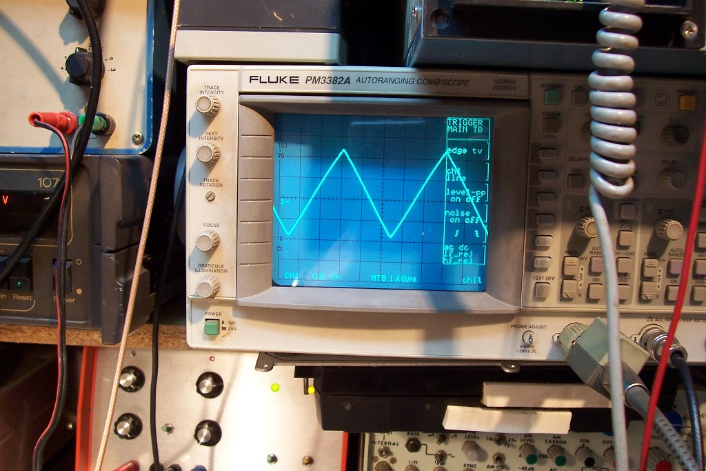

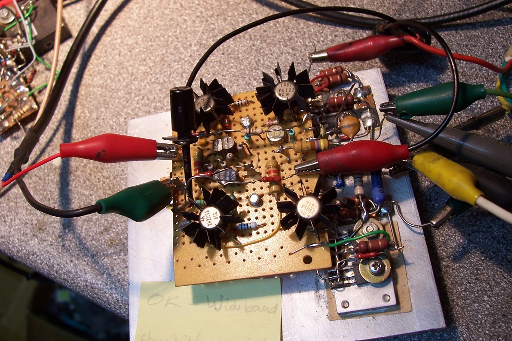

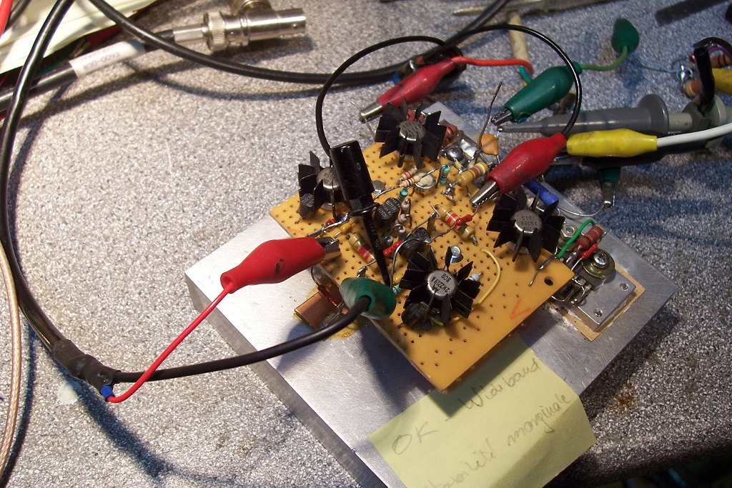

Yet another "fossil": this one is labelled "stabilité marginale", and that is indeed the case: when loaded with 3 ohm, part of the lower half-wave is festooned with VHF oscillation.
Easy to fix apparently: I probably didn't try hard enough the last time, an additional comp cap does the trick.
This one is really wideband: it uses paralleled BDX37's as OP, and it does give results: see the oscillogram (it is a 200KHz triangle, and the apparent defects near the top are not caused by the amp), measured on a 3 ohm load
