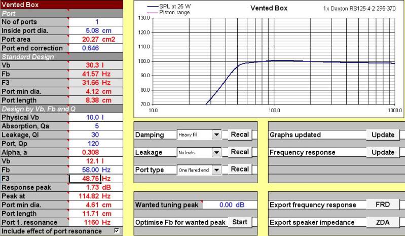

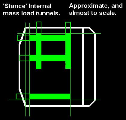

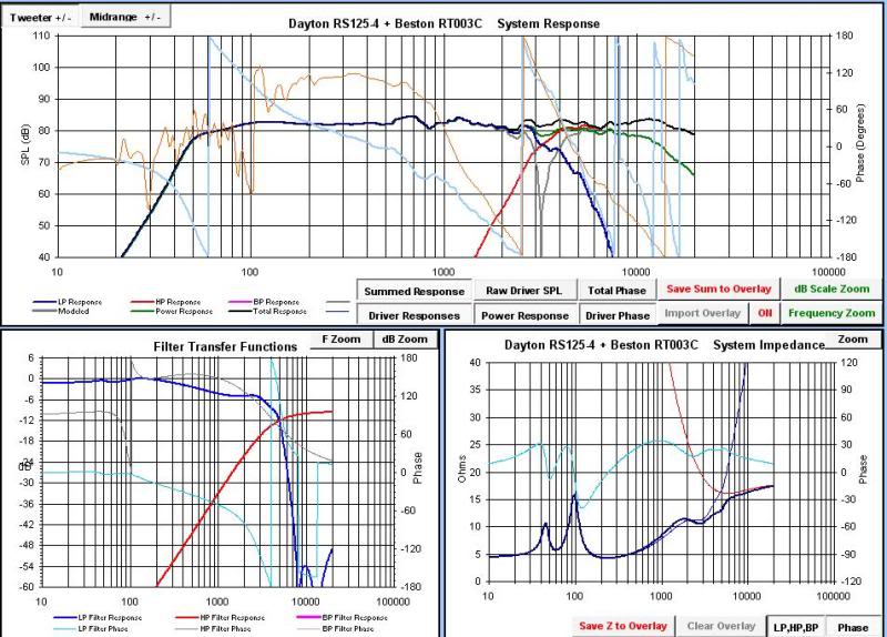

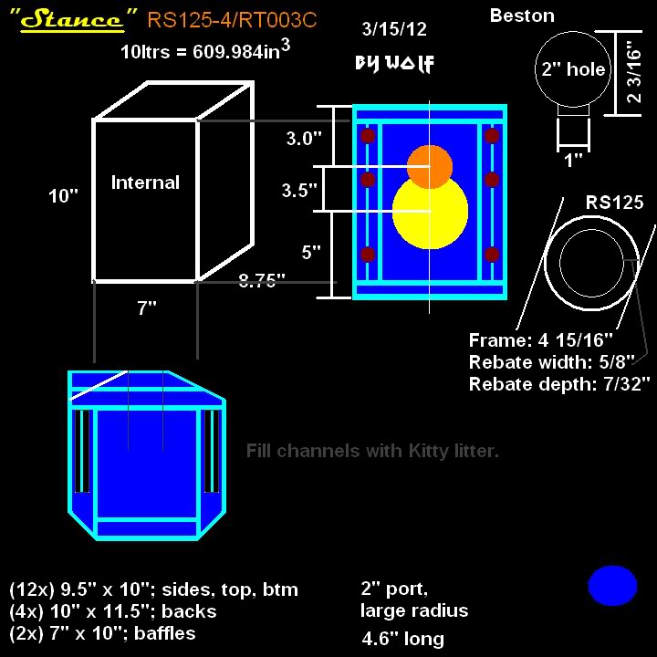

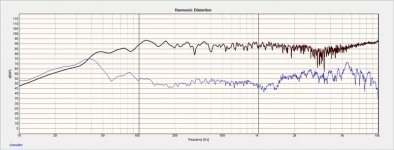

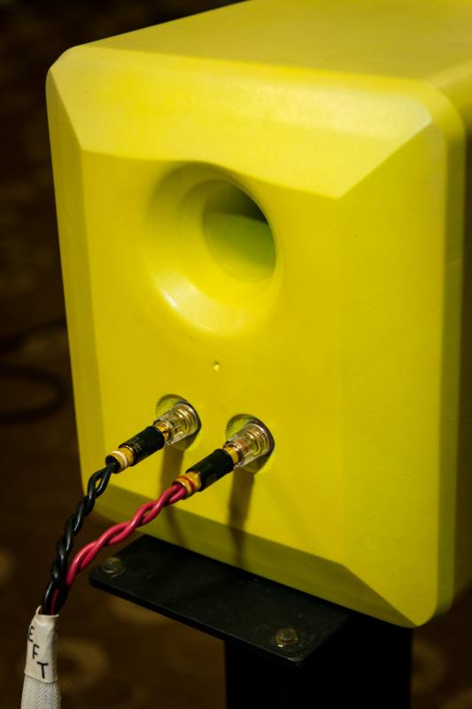

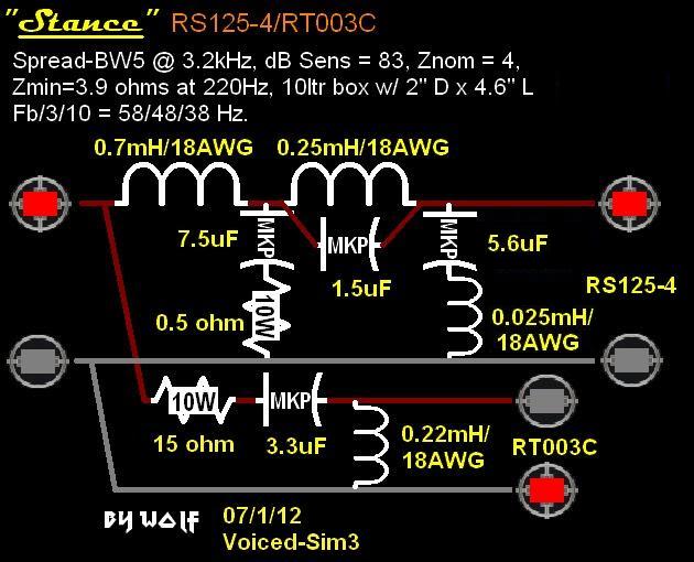

The Stance are excellent speakers. We have built many here in Ontario-io and coupled with a some low-end assistance, they can be lifetime speakers.
Here's a pic or 3 of my build below...
I will note that they are not flat measured, and the tweeter HD fills in the dip to balance it out. BUT- they sound flat and balanced. These I lovingly call the 'baby 'Tudes', as they were built with some principles from the Attitudes design including the same Formica for the baffles. I still use them as surrounds in the HT, and pull them out as mains from time to time.
I've also been told by a few peers that the breakup of the RS125-4 is sufficiently suppressed in this design, and that others did not do this sufficiently in their designs with the 125. Some of these peers did not like the other designs they heard with the 125 for likely this reason alone. The sim takes it down to -50dB from reference, and that is IMO where it should be if at all possible.
Both Paul Carmody and JeffB were enamored with the woofer's sound around that timeframe.
And yes- we did separate the spiders from the triple-joint at InDIYana 2013 playing 'In the Air Tonight' from the Audio Fidelity pressing of the Phil Collins album Face Value when the toms kicked in. PE replaced the drivers as they should not have done that according to the PE staff member that was on site. They sounded GREAT until then.
Thanks for recommending one of my builds, as I am very fond of these.

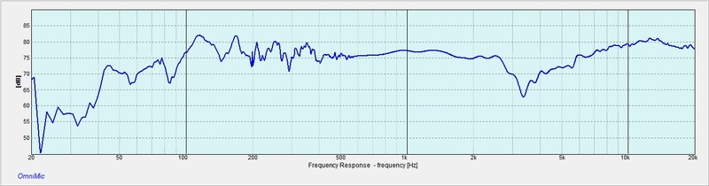

Nice work Ani101. I have used the FR58EX as a tweeter paired with the AC130F1 (same as used in Continuum) in a FAST with a 1kHz crossover. Your crossover is quite complex. I ended up using a pretty simple crossover.
My first generation FR58EX did not have a nasty 10kHz peak which seems to be prevalent with later units (the rubber surround does not seem to cover as much of the aluminum cone). Here is the response with this crossover:
Here is the response with an earlier FR58EX:
Despite that peak, it sounds quite nice, although I may have to take apart the speakers that are holding the older versions and swap them out.
