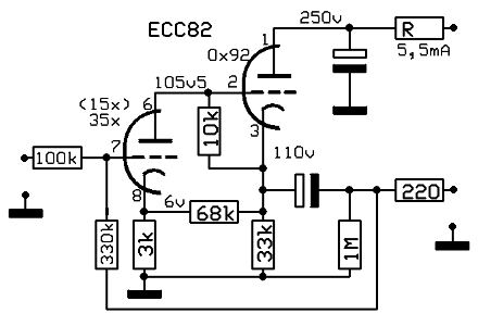

Being that the title of this thread is "A good route to a ECC82 preamp", I figured I'd try to contribute ideas for exactly that.
I agree that the 12AU7 is not the best possible tube to start with, but it's not unusable, nor is its use a guarantee of a bad amplifier. I mean, it was used by Heathkit in some of their classic Williamson-style amps from days of yore, in which the first stage is a 12AU7 used as a plain old, single-ended, common cathode amplifier. I don't know why they didn't use 6CG7 instead. Perhaps it was because the 12AU7 requires half the heater power?

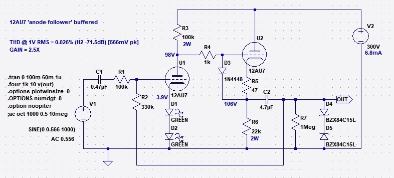

I'm puzzled by the value of R5. If the current (4.81 mA) through R6 would be equal to the current through R5 than the bias of U2 would only be -0.27 V.Well, it does look like ECC82 is not as linear as other types.

This little line stage circuit looks like it should be OK. 2.5X gain, 0.025% THD at 1V rms output into 50k ohm load (THD looks like it nulls into a 10k load, but I don't trust that in simulation).
Granted, this is a mere simulation, but the real life circuit would be quite close, and it looks like it would be a pretty good line stage preamp thing.
It could be made better using ECC81, ECC88, ECC40, ECC99, etc. But if all you have is a sleeve of ECC82...
C1 could be removed if you're sure there's no subsonic garbage coming in and the power supply has very low impedance.
D4 and D5 could be removed if there are no solid state devices downstream.
D1 and D2 could be red instead of green.
But the voltages in the schematic seem to indicate a bias of -8 V (106 - 98). The current of 4.81 mA at a bias of -8 V and a voltage between cathode and anode of 196 V is exactly right when looking at a datasheet for the 12AU7. Since the current through U1 (2 mA) at a bias of -3.9 V and a voltage between cathode and anode of 94 V is also exactly right according to the datasheet for the 12AU7, grid current can't be involved.
So shouldn't R5 be around 1663 Ohm (R = V / I = 8 / 0.00481 = 1663)?
Sorry about my post #46. I see where I was wrong now. The cathode voltage of U2 is just a tiny bit higher than 106 V like it should be.

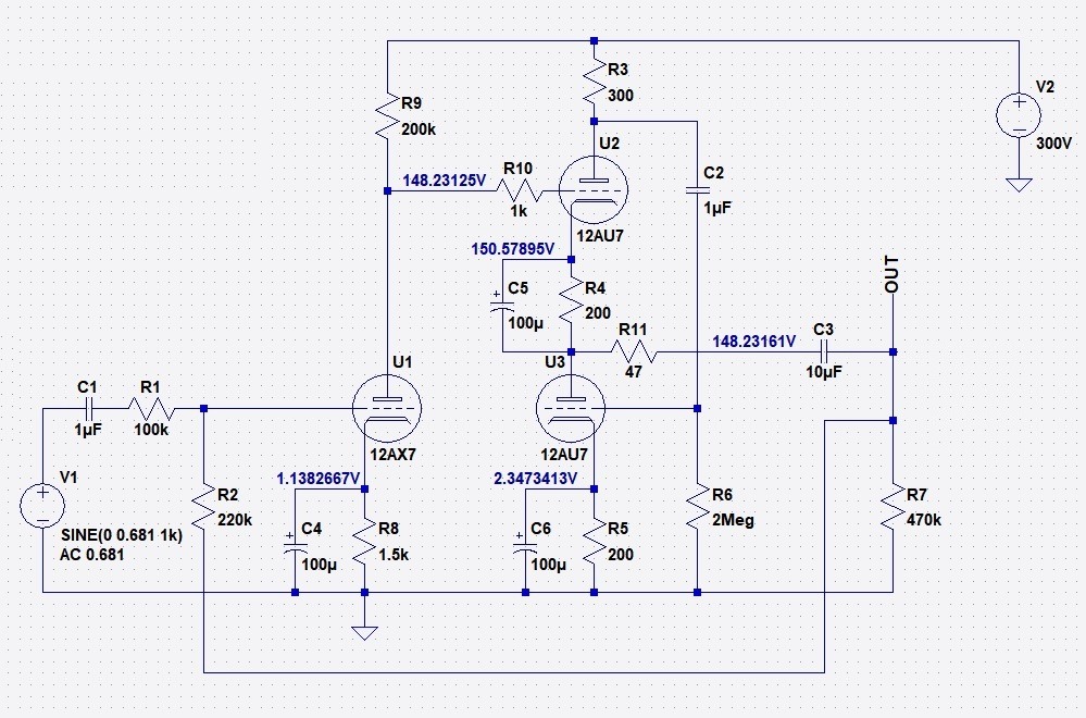

I brought out the White cathode follower as another good circuit that could be made using a 12AU7. I agree that it's overkill.
A variation on your idea...
Use a single 12AU7 as a 'bootstrapped pair', which is pretty similar to a mu-follower, but wouldn't need to have the heater supply elevated to quite as high a voltage.
V1's 47k plate resistor is split is into two 24k resistors, then the output of the V2 cathode follower is fed back through a large-ish capacitor to the center-tap of the two 24k plate resistors on V1.
Then wrap NFB from the output of the V2 cathode follower to the grid of V1.
A Bootstrapped Pair/Anode Follower.

What's the benefit of 1st putting PFB to increase gain, then NFB to decrease it again?

The amount by which NFB reduces distortion and other unwanted effects is equal to the open loop gain in dB minus the closed loop gain in dB. Positive feedback increases the open loop gain. So, for example, a 10dB increase in open loop gain will reduce distortion etc by more than 3 times.What's the benefit of 1st putting PFB to increase gain, then NFB to decrease it again?

I think the problem would be that when the amplifier is driven to clipping (into cutoff) the negative feedback loop will cease to work, so the positive feedback could cause the amplifier to oscillate. That would make for some seriously ugly clipping behavior. However, I may have misunderstood what I was reading. I was reading this:

The maxim I've read is that for a stable and clean result, you first want to make your amplifier circuit as low distortion and with as linear phase response as possible open loop, before applying negative feedback.
It would follow that if positive feedback increases gain, but also causes oscillation without the negative feedback applied, that the end result would be a less stable amplifier circuit (an amplifier that would be more prone to oscillation, overshoot and/or ringing when stressed).

Not per se. It depends on how the PFB is derived and applied. In bootstrapping, for example, its effect is to increase the dynamic resistance of a plate load - much like adding a CCS. This not only increeases the gain but tends to reduce distortion by making the plate load lighter.Yes. But doesn't PFB per se increase distortion?

Of course, badly implemented PFB will lead to all sorts of issues (ditto with NFB)

In simple terms, both positive and negative feedback affect the amplitude and phase characteristic of the loop gain and it is this that determines stability. The key determinant is that when the loop gain reaches unity, the phase shift must be less than 180 degrees to avoid oscillation.I think the problem would be that when the amplifier is driven to clipping (into cutoff) the negative feedback loop will cease to work, so the positive feedback could cause the amplifier to oscillate. That would make for some seriously ugly clipping behavior. However, I may have misunderstood what I was reading. I was reading this:

The question of the effect of negative feedback when one or more stages enters clipping is entirely different - at this point the amplifier is clearly being operated outside its design parameters. For the majority of tube based amplifiers, the reduction in open loop gain caused by the relatively gentle tube characteristics plus the relatively low amount of NFB used, tends to mitigate this. The opposite is true in transistor amplifiers where open loop distortion is so high that large amounts of NFB are necessary to achieve low distortion.

If the NFB is crapped-out, isn't the PFB also kaput?when the amplifier is driven to clipping (into cutoff) the negative feedback loop will cease to work, so the positive feedback could cause the amplifier to oscillate
The PFB/NFB trick was WIDELY used in WWII servo and filter amplifiers. Seen also in Dynaco.
