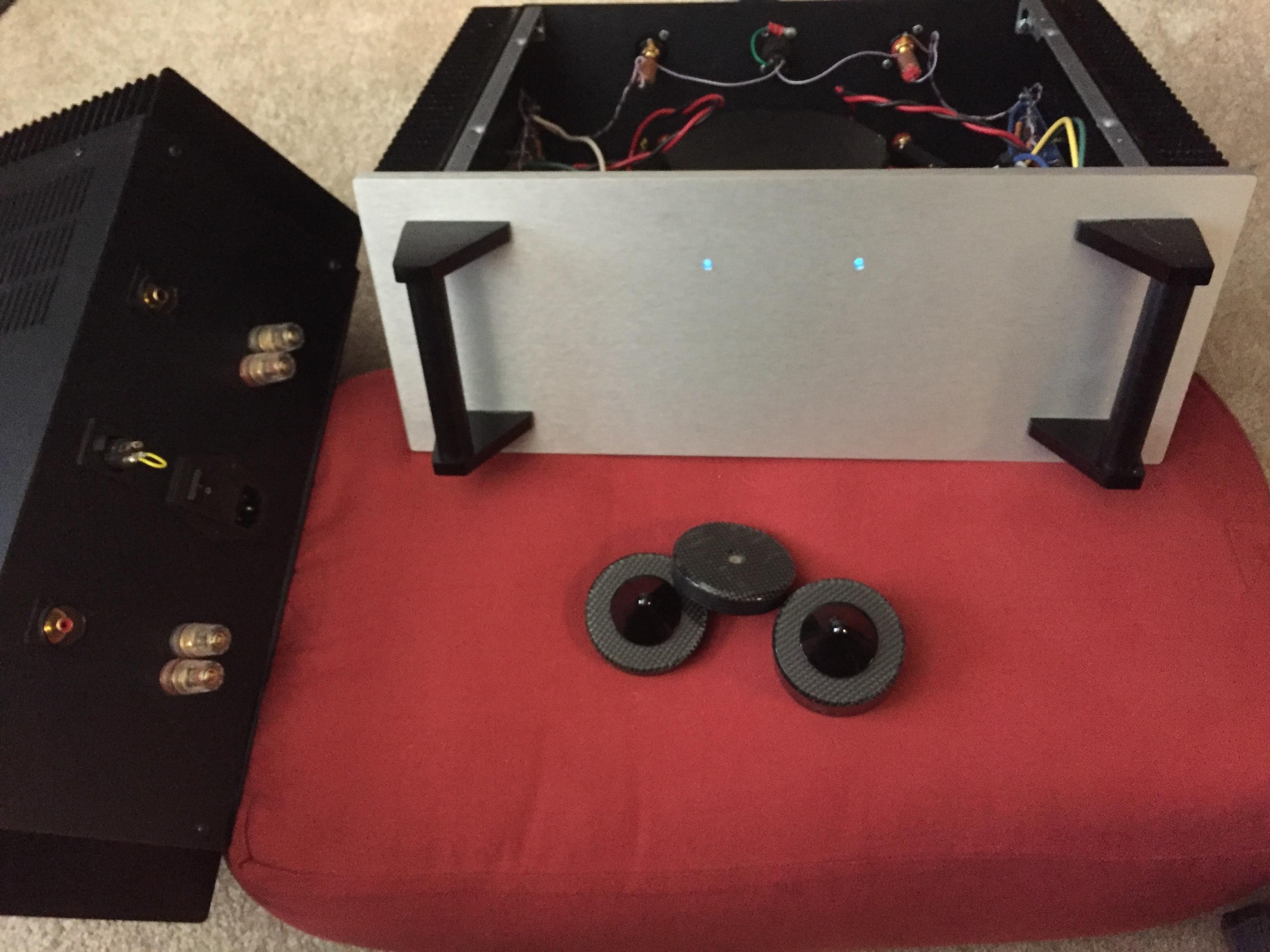

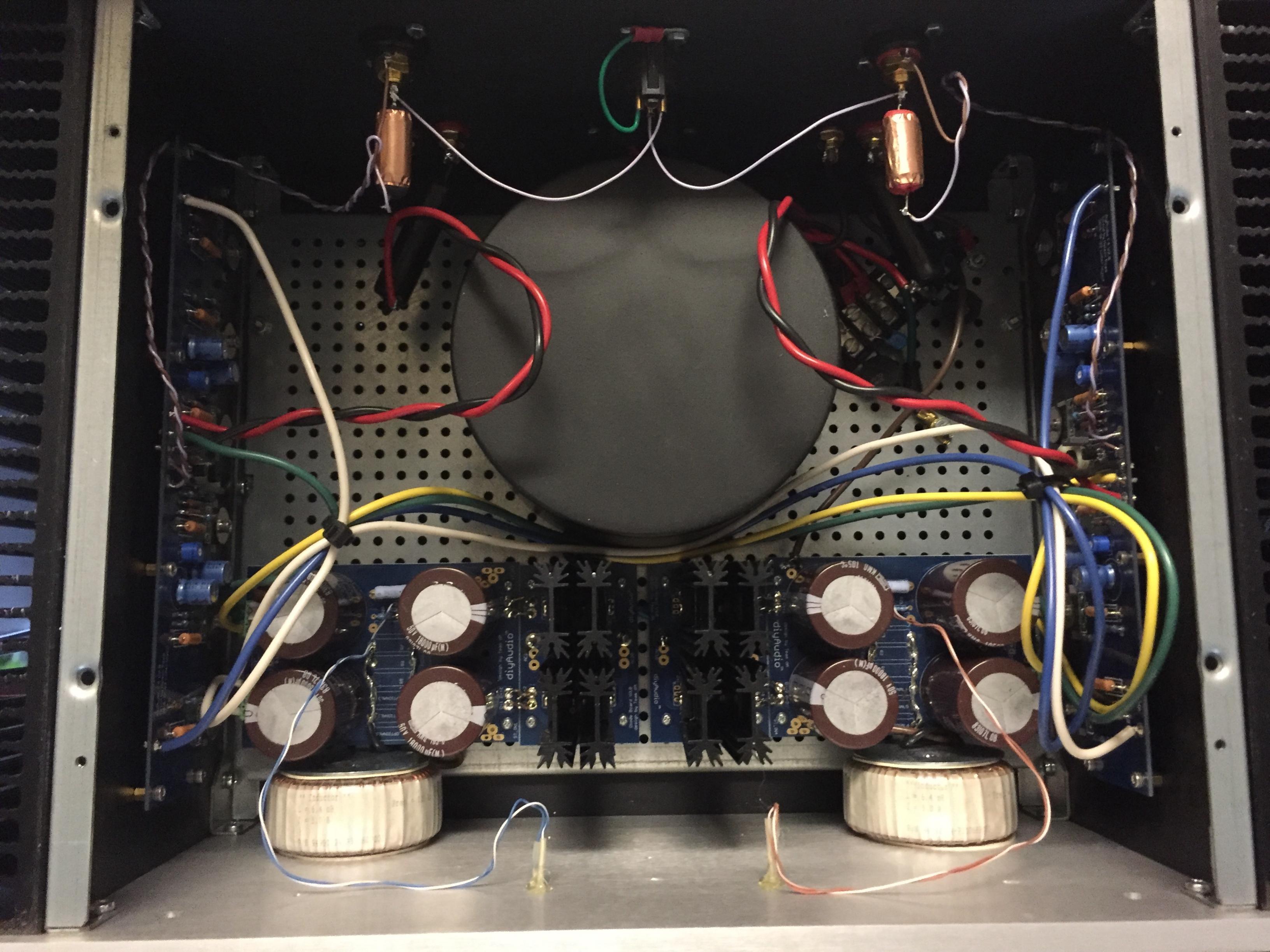

Looking at everyones great work I realized I never posted any pictures of my F4's.
The copper foil covered devices on the inputs and the black cylinders in series on the outputs are Bybee devices. I also added an XLR for easy balanced bridging or as seen with the shorting jumper paralleling the outputs. The other change from stock is a CLC instead of the usual CRC thus the two chokes mounted to the faceplate.
I agree with others here that the size 4 chassis is barely large enough and not a very easy design to work with. I decided to not even bother with the plastic feet and am using Black Diamond Racing carbon fiber cones instead.
Couldn't be happier with the sound driving Quad electrostatic speakers, but in general just too much heat for the summer months when I substitute a Sympatico amp from Twisted Pear. Different sounds for different seasons.

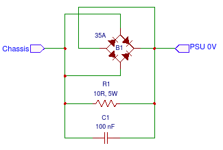

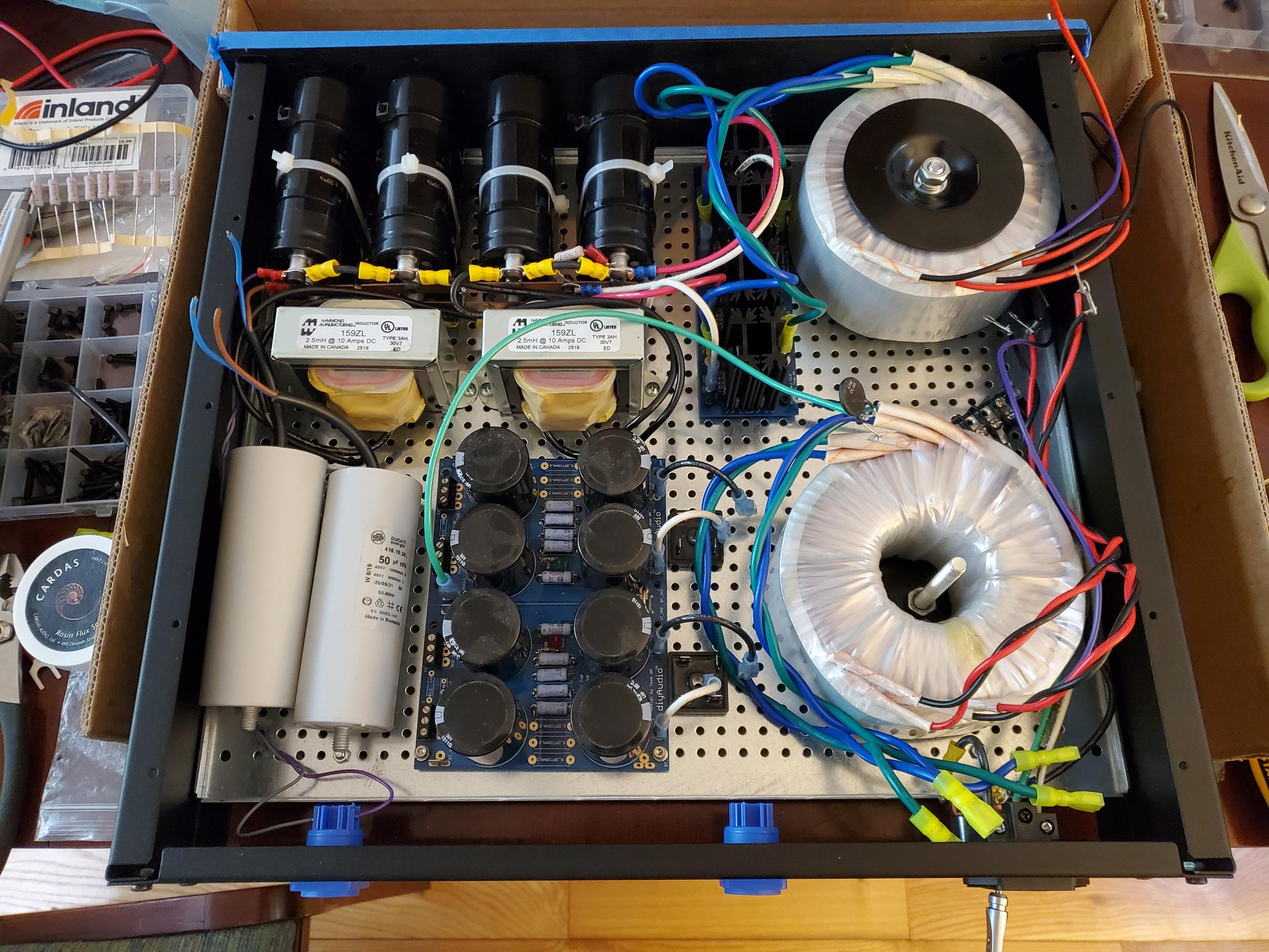

Hi all, I'm building an outboard power supply for my f4s (& sissySITs). I've got two mono-blocks and each channel will have its own power supply (4 total).
As I've seen on here before, I'll have one power cord running to the power supply chassis and will then put separate fuses to each toroid. Two umbilicals then running out to each monoblock.
My question is, do I also need dual thermistors to the common ground, or can I have a single cl-60 between the dual ps ground wires and chassis?
I only have 3 thermistors and would love to have music back without having to wait until next week for another mouser delivery.
Thanks.
Hi stephen1212b
What type of inductors did you use?
Thanks.
cal3713, what are these Ducati 50uF for?
Hi stephen1212b
they are some old Powertronics 6.4 mH, 5A, 120Hz inductors I had in the parts bin. DC resistance measures about 0.17 ohm. If I was planning to slam the amps I would step them up to 7A or so but I'm more about the sound than playing loud especially since the Quads don't do loud, just plenty loud for me.
Who knows what's having the effect, but I can highly recommend the CLC outboard power supply. I've never heard the stereo sound so beautifully clean. Been collecting information for how to do it for many moons, so thanks to all the people who helped by posting their experiences. Especially ZM & 6L6 for the years of volunteer customer support.
Hymn, I do not get the correlation between how "strong" (A) inductor is and how loud the amp plays ... It is class A, so current is constant, regardless of input signal in (V) Or I am missing something ... :confused: Could you explain please?
