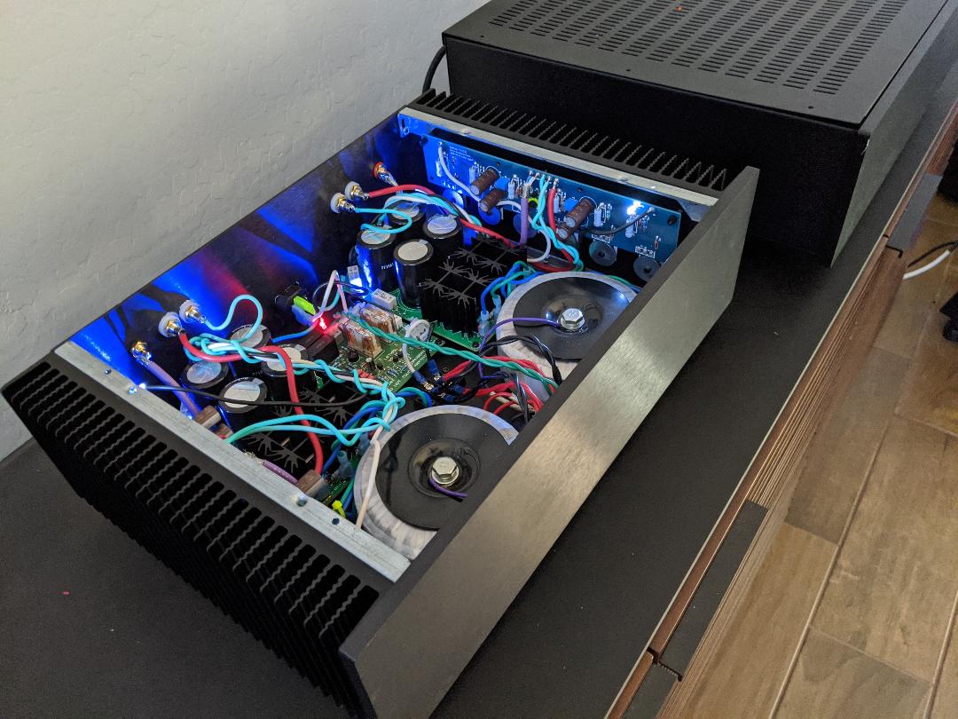

Playing music!! Very nice sounding amp. Worth the investment and more. Yes, it's just "honeymoon period" but my first impression after playing one CD album is that the amp sounds excellent!
Shown with a Type 76 preamp. I also have Type 26, 01A, and Supratek Chenin (I read from the archives that someone was using the same pre and likes the combo) to try
and SET (45, 2A3, and 300B)amps to play with. I am going to be busy!
Thank you very much for those who helped me (6L6,Dneu2011, mcandmar, Dennis Hui, Eric, vdi_nenna, margol, wdavis009, cal3713, and ggetzoff) from answering my inquiries. Starting this project, 6L6's write up made made me confident that I can finish the amp.
Happy listening!
Abe

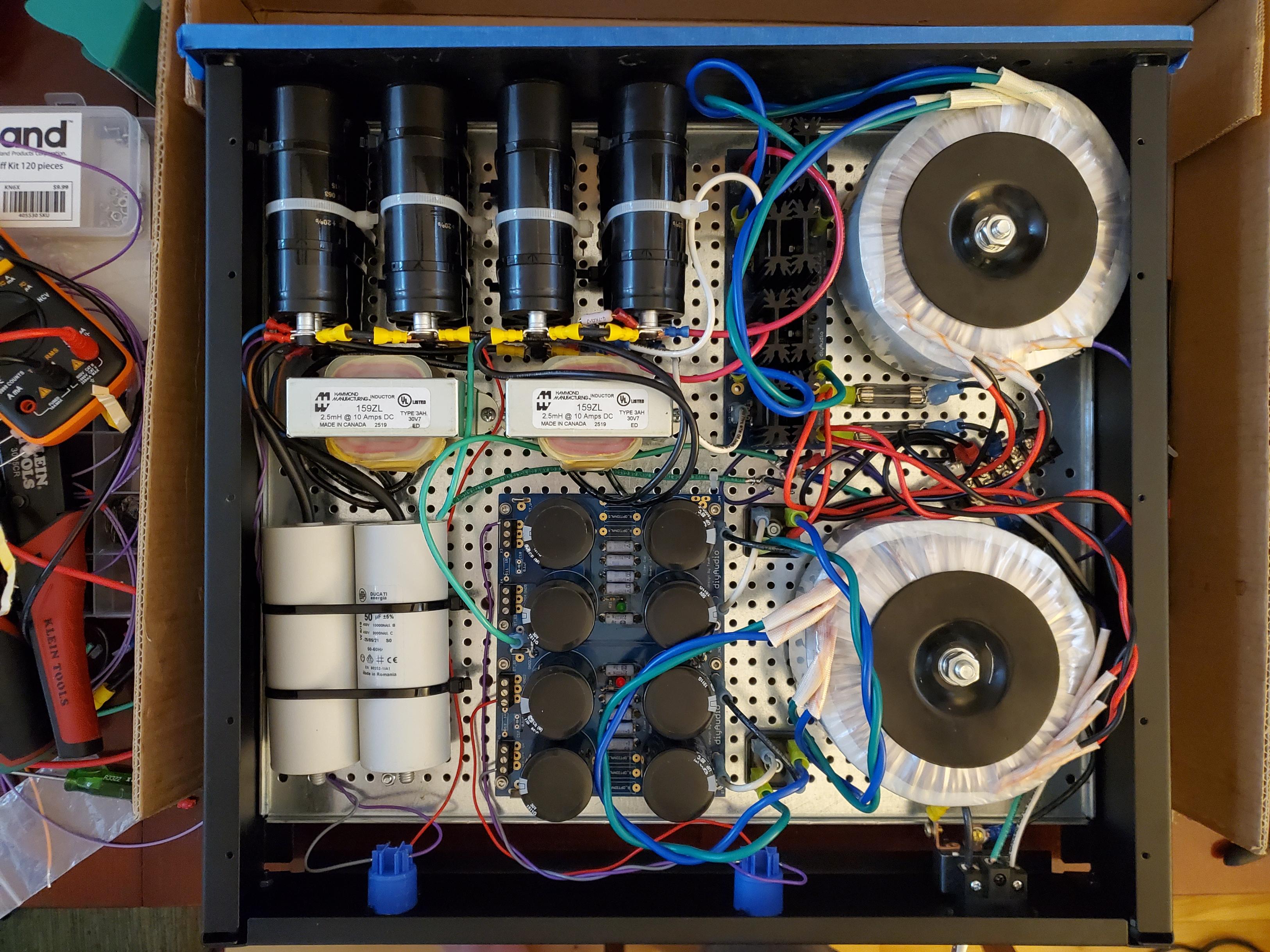

I have a dual-psu in external chassis. You can use a four-lead cable with Neutrik connectors, +/-/0/chassis ground. I use shielded 3x2.5mm and extra ground to chassis. PSU as a general Pass. 0 to PSU ground and chassis ground to PSU ground star. In amp chassis you can boost with caps between rails and ground with short cables. ZM suggested motor runs 65uF or more. If I may add F4 is fantastic with or without external PSU. An external PSU makes me try more amps at less cost.
I also fully support this. My signal quality went up, but I agree that it is not necessary. That said, I do think full mono is a real, very substantial upgrade and it's just hard to fit that all in one case. Those boards both pulling on the same power supply is certainly audible on my system. As I've posted before, I have dual mono blocks with sissy SIT boards on one side and f4 boards on the others. When a/b ing the two amps I had both attached to the same ps and would just short the input of the unused board and switch my speaker cables from side to side. I just left the boards like that for a while after settling on the f4s and I could hear the effect of even having that one board idling while shorted. When I finally got around to disconnecting it from the power supply I got a clear increase in quality.
