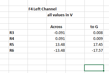

I installed new JFets. Biased up to .17 V
Had readings on all Mosfets.
Regarding the three resistors that I had no readings for yesterday, here are the new values - all V
R1 0.0 V
R3 -0.097 V
R4 -16.35
PSU value 22.30 V / -22.40 V
R6 to G is 17.01 V
R7 to G is -16.23 V
Clearly R1 is a problem and R3 looks very low.
Bad resistor at R1? Nope reads correctly.
Hmmm, something is stilled screwed up.
Appreciate any thoughts.

Assuming your voltages for R1, R3, and R4 are across the resistors:
If the voltage at R1 is across the resistor, zero voltage is good, indicating no DC in the input.
If -16.35V is across R4, it doesn't make any sense.
If -0.097V is across R3, it looks ok - indicates -0.097V/22.1R=0.0044A through the resistor and the SK170.
Please be very clear what your measurements represent.
Please measure again:
- Voltages across R3, R4, R6, and R7.
- Voltages with respect to Ground at both ends of R3, R4, R6, and R7.
Better to have more information so that measurements can be verified.

I assume it's R6 and R7, not R5 and R6. If so, the numbers look acceptable. I did ask for voltages at both ends of the resistors with respect to Ground just as a further check.
At the JFET source resistors R3 and R4, the 0.091V drop across gives 0.091V/22.1R=0041A = 4.1mA, a bit low compared to 5mA expected but it is in the ballpark. Perhaps the JFETs have lower Idss.
But it looks like the channel is working.

Yea, the JFETs he has now should be above 6. but Chip where those numbers given by the seller or measured by you? As Dennis pointed out your method might not be 100% accurate for this purpose. Given the IDSS is that low, I would consider asking for a reimbursement. You might not be able to tell the difference between 4 and 5 mA, but it means they don’t bias to spec, and if the IDSS is too low, you won’t be able to manipulate it up through resistor changes either. But as you pointed out the fets prolly aren’t the main cause of all of this.
Still excited to see what the solution to your issues turns out to be! Or is it all working now?

I meant R6 and R7.
My Jfets are from diystore. they are the Jfets in the 6-8mA range. Should I be using the 8-11 mA instead?
