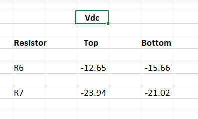

There is not enough current (<0.17mA) through the TL431 for it to be regulating.
The new part kindly supplied by william2001 will address the regulation,
but I think there is a problem elsewhere that is causing the low current
through R6 feeding the TL431.
Can you please check the voltages across R3, R4, R5 and R22 and confirm
the values of those resistors.
Then with your voltmeter ground probe on the ground of the circuit, please
measure the voltages at:
-R6 (both ends)
-R7 (both ends)
Also, please confirm your rail voltages.

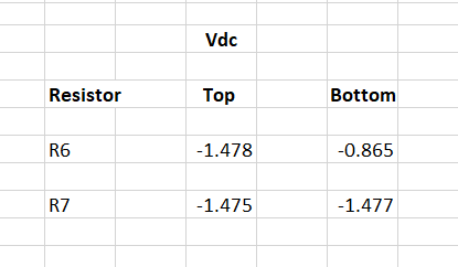

An observation.. we want that input jack (R2) shorted to ground for any setup and troubleshooting of the amplifier. Nothing connected to the outside world and not floating, just a hard short. We would want to see maybe ~100 mV or something ACROSS R3 and R4 (if those are 22 ohm resistors as shown in post #1) accordingly so a reading of zero is concerning.
Another crack at this.
Please check the voltages across R3 and R4 and confirm their
resistor values. You may want to use your meter's mV scale for this measurement.
Check voltages across R22, R6, R7, R5, R8, R9 and confirm their resistor values.
Please include units with all your values.
Some of your previous measurements are difficult to reconcile assuming the
standard part values. (For example, voltage across R22(750 ohm) )
Dennis,
I confirmed all the resistors are in the correct slots.
However for R22. something looks off. It's the right value [750 0hm], but testing it on the board I get very weird reading of ~12.78K.
So I think I will wait for the new TL341 and replace R22 with a new 750 ohm resistor at the same time.
For my understanding what do you mean "include units with all your values,"?

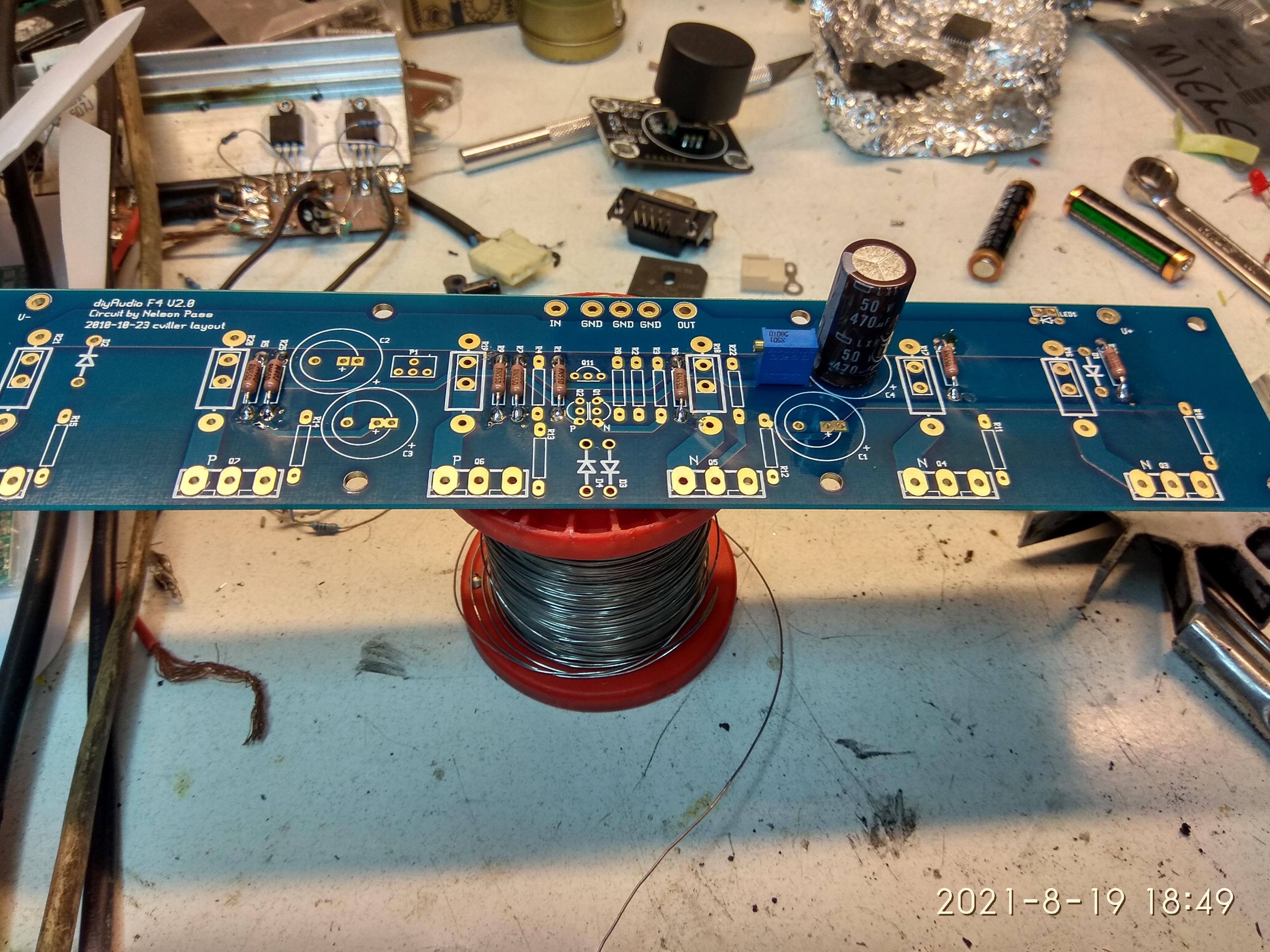

C3 and C4 are decoupling caps, but C1 and C2 are coupling caps.
I'd guess the RC network of R5/C3 needs to be large enough to at least filter out 50/60hz junk, while C1 with whatever resistance makes up its network (R5 + R7?) needs to be large enough to pass your bass frequencies.
If I've got that right, then as designed they're no where near the frequencies we care about, so yeah, the values are not critical (within a reasonable order of magnitude).
