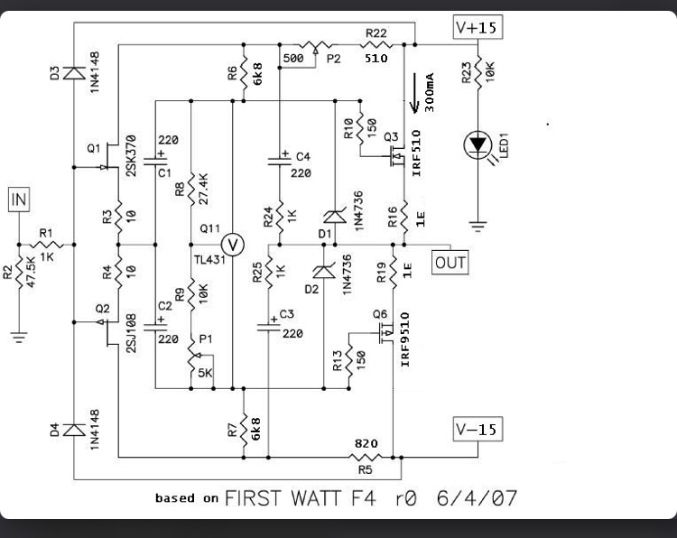

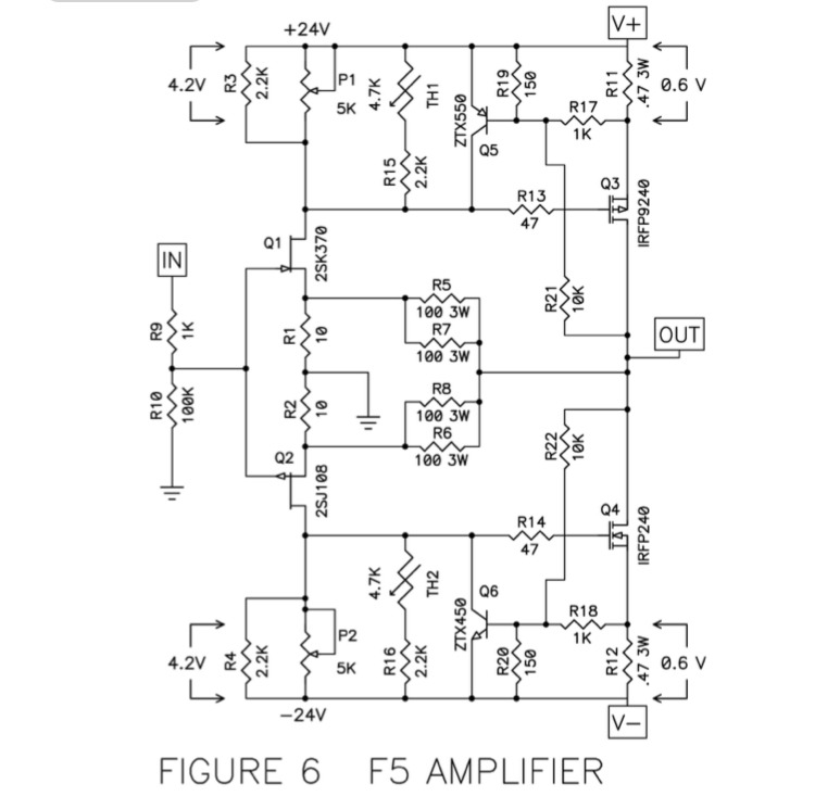

Colleagues, would you be willing to help me with one thing: build F4 with one pair of outputs and no buffer jfets (crippled?) on a F5 board? I have on of those tiny layout board for the F5 circuit thinking if I can make that no-an-actual F4 with that. I know many people are really good in building all sorts of Frankenstein monsters on different boards, but I am pretty slow with that, so you assistance will be huge appreciated.

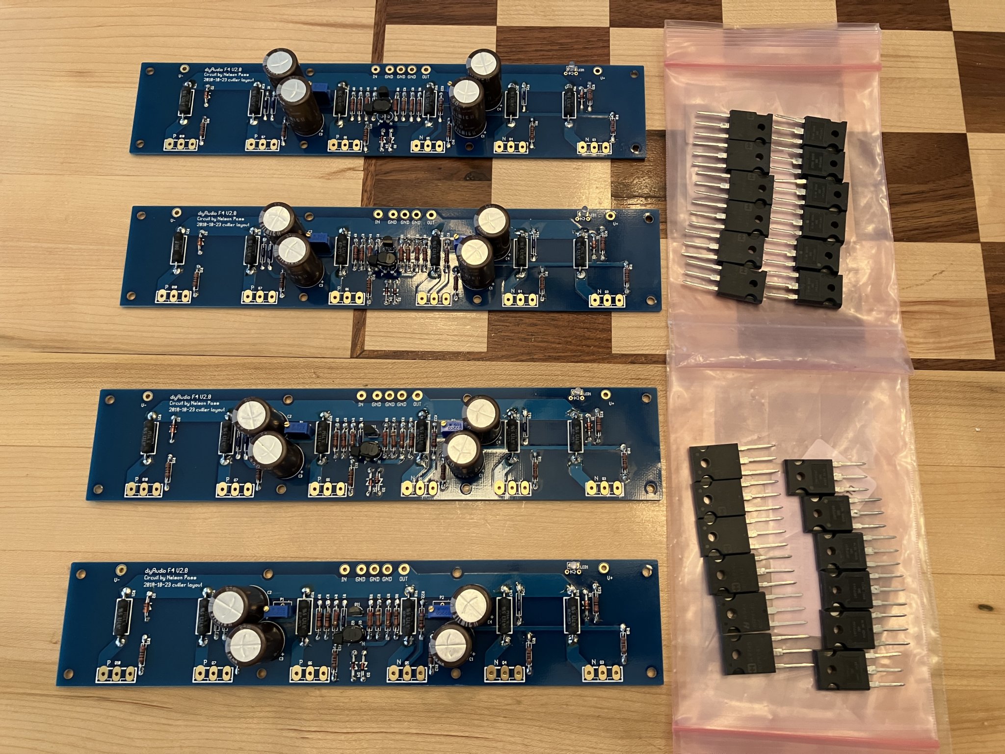

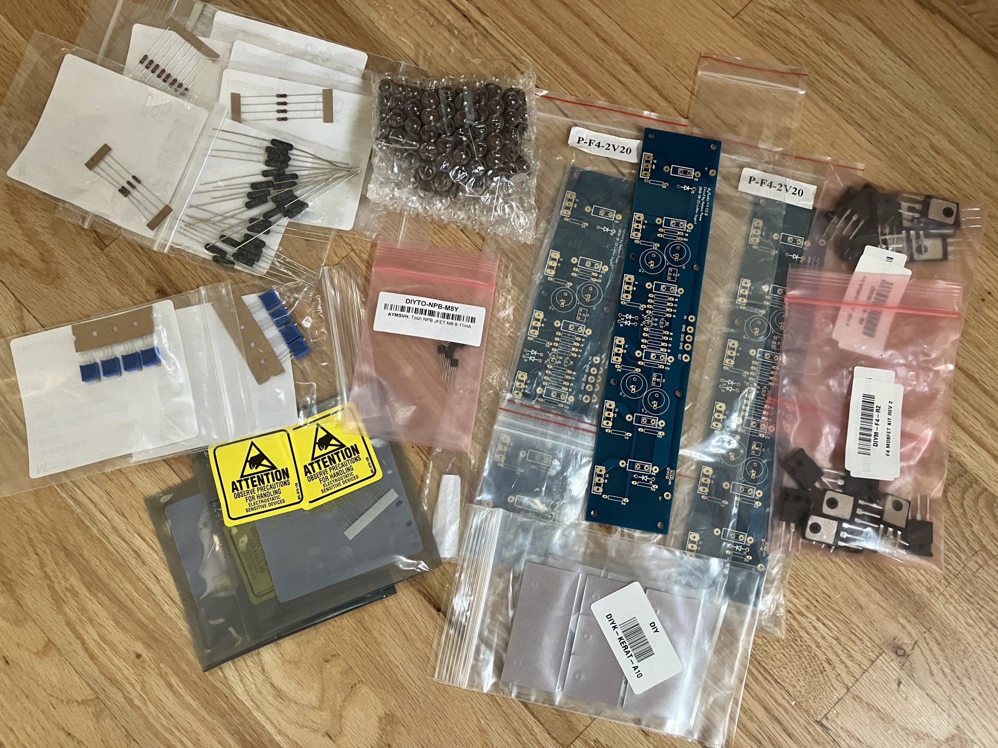

Hi guys - can you tell me which of these PCBs is best for building an F4. Two from China, one from Serbia. Or any others not listed?
https://www.ebay.co.uk/itm/27488193...PTwNswir6BtiiKeD/pqX70AUfg==|tkp:BFBMyp65g_xg
https://www.ebay.co.uk/sch/i.html?_...erential+Complementary+Amplifier+Kit&_sacat=0
https://www.ebay.co.uk/itm/11471401...FbTEE1Ksw2yC/G+7WeIaseTSYx|tkp:Bk9SR6y2vYP8YA
what's wrong with these: https://diyaudiostore.com/collections/power-amplifier/products/f-4
- A guide to building the Pass F4 amplifier
