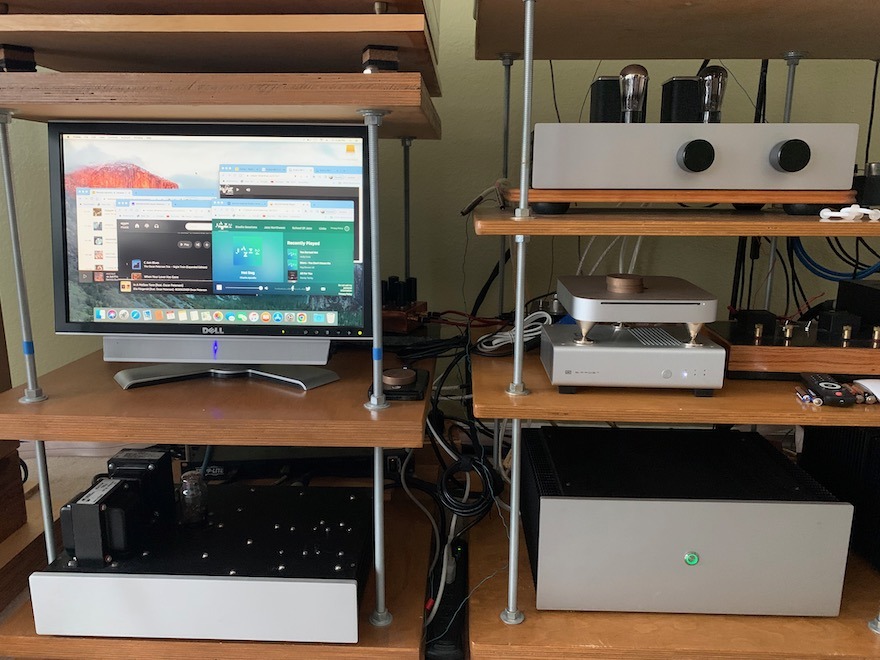

I am listening to a transformer coupled (Lundahl) Type 26 preamp driving an F4 with Macmini as source and Bifrost as DAC and very happy! Yes, maybe not a lot of gain but in my 20' x 22' x ~ 14' cubic feet room, it is more than enough for me (because I have a 98 ~99 dB speakers).
My observation is that I never heard as close to the real sound of the type 26 tube until now. So long type 01A

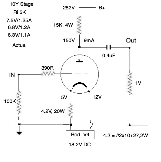

I was just looking at the thread "What are the requirements for driving a 300b"operating point data for tube is having nothing with following stage. you need to optimize those for tube, while tube intrinsic characteristis are dictating is that tube appropriate for task
https://www.diyaudio.com/community/threads/what-are-the-requirements-for-driving-a-300b.35271/
Sy says for instance: "Depends on your operating point. You want to be able to swing something more than the standing cathode-to-grid voltage for class A or AB1. You want a source impedance low enough to keep the rolloff from the time constant (pole) formed by the driver source impedance and the input capacitance of the 300B at least a decade higher than the dominant pole. If you're running the 300B in a greater-than-unity-gain output stage, be sure to account for the Miller input capacitance, too."
So I'm asking "What are the requirements for driving an F4" in a similar way. The input impedance is 47K and the output impedance of the 10Y is around 5K so that's possible. So I want to know how much voltage to swing and if the current of 9mA in my circuit is adequate. And whether Miller capacitance pays a role here. Plus any other factors that are relevant.

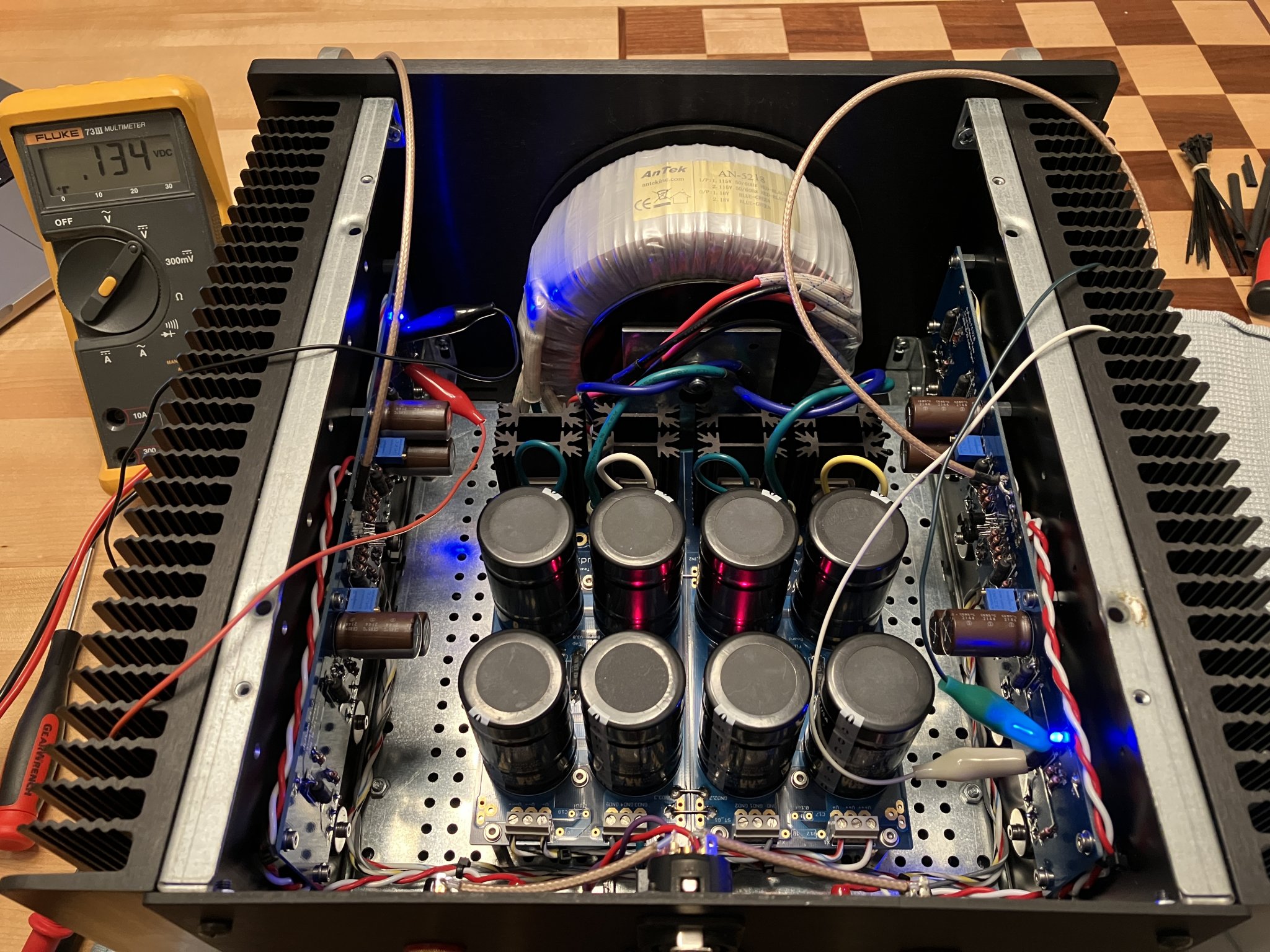

Finally have one of the F6 monsterblocks switched over to F4 boards.
Had it up and running for an hour, watching the voltmeter, checking temperatures. Wasn't getting above room temperature. another hour later, I realized that 0.013 volts is about an order of magnitude too low to get any serious current flowing. doh.
