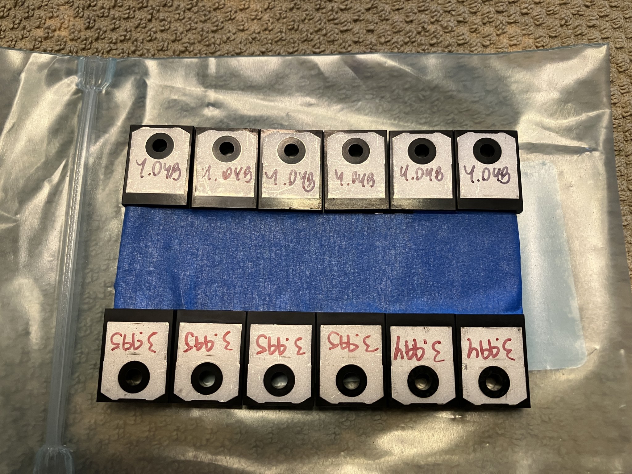

Soldering up new boards. Had the thought that I have matched MOSFETs but not matched source and gate resistors which would cause slightly different operating points across the triplets. How close should I match the source and gate resistors for MOSFET triplets? Bought 1% parts for both but wondering if doing some tighter matching might be worth it.
No need for gate R matching. Source R matching is only relevant if you have really tightly matched MOSFETs. Pass Labs use 5% source resistors. In other words: focus on the active devices. Then think about nescessity for matching resistors.
Andy
Andy
Was recommended this set: https://www.etsy.com/listing/958609584/first-watt-f4-ba2-ba3-mosfet-kit?click_key=eb7f0caccbe331b90a0d8d26a121bf5860f34b0a:958609584&click_sum=40162d72&ref=shop_home_active_5&sts=1
Vgs matching was done at 170mA. Still much to learn. I'm guessing that is where curve traces come in handy.
