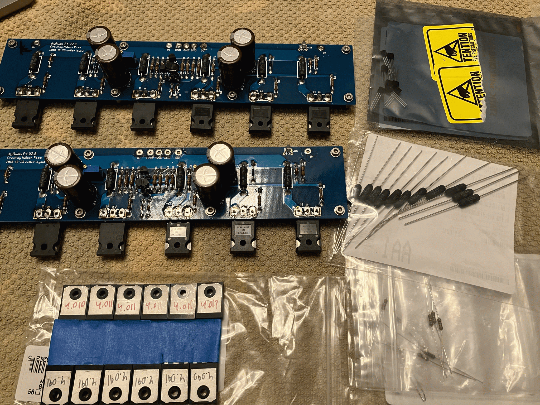

Thanks Nelson - now wondering, in addition to BA3, strapping an F8 to an F4... anyone done it yet?In practice the jfets see less than half the rail and this is bootstrapping to the output, so you can run higher rails safely.
F9 (Axpona?) - exciting times...
The SLB has about 3v drop at max ripple reduction setting. When sizing a trafo, I usually size 2-3x larger than steady current needed. The trafo also has voltage sag due to class A load.- Jan Dickinson superegulator needs 5v drop
- XRK971's Smooth like Buttah power supply I'm using also has a 5-6v drop.
F4 default power supply is 18vac giving typically +/-24vdc. Perhaps I'd be better off running 26vac secondaries, then both the SLB and super regulator (with it's own rectifier and cap bank) would give some 28vdc into both the F4 and BA3?
How's that sound? Probably a gain of about 20dB from BA3?
Assuming you want 24vdc at the amp rail, usually a 22v trafo is needed. Assuming you need 2.5A x 24v x 2 rails - this is 120VA requirement. So 2x would be 250VA to 300VA trafo per channel. So two 250VA to 300VA trafos for dual mono or a single 500VA to 600VA with quad secondaries for two SLBs.
Work out the voltage AC needed going backwards from 24v requirement at amp. Add 3v for SLB dropout. Add 3v sag at Class A or 6v. So that’s 30vdc and divide by 1.41 we get 21.3vac. Always go up in “shoe size” or size 22vac.
You can always burn off a little more voltage with a larger value R in the CRC. But if lacking raw you can’t get enough and amp will be under-powered.
No.How's that sound? Probably a gain of about 20dB from BA3?

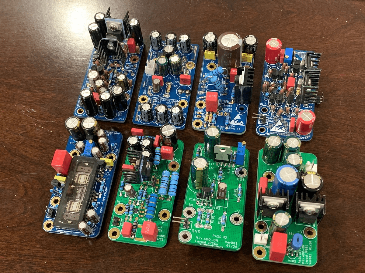

Hi An
That was our thinking when we made the M2X brass stand-off mount compatible preamp line stage. It allows one to swap line preamp modules and choices included among others: Pass ACP+, Pass H2, Wayne’s Burning Amp 2018, Pete Millet Korg Nutube, and several designs by Aksa. Many were Class A designs and more recently the modules include high voltage opamps capable of swinging 70Vpp.
