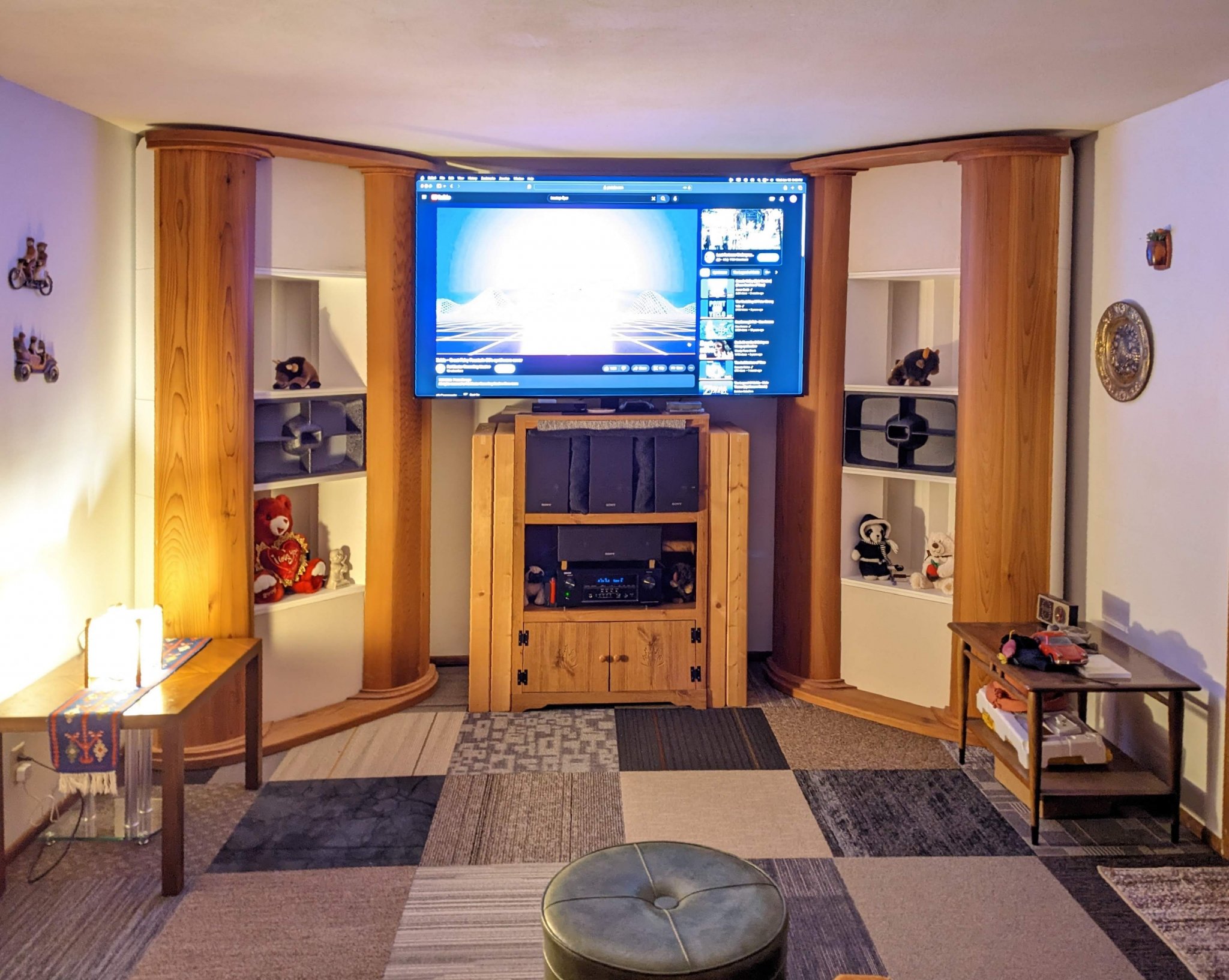

Here's my setup now that I've moved into my new listening room. You can see the three Sony SS-CS5 speakers in the middle, tucked into an old entertainment center cabinet that I bought for my mother decades ago, when CRT TVs were still mostly what there was. There are black towels stuffed between the speakers to eliminate the hollow sound of the cabinet. The center channel speaker below is also just filler for the same purpose. It's not actually hooked up. It needed somewhere to go anyway. Off to the sides are a pair of corner horn speaker systems that are currently serving duty as subwoofers crossed over at 100Hz. They are just being powered by the Denon receiver's surround channels and have to be turned down 15dB with EQ at the crossover to match the Sonys. By 20Hz they're only turned down 3dB. Each stack has four 18" woofers each loaded into its own 6 foot long folded horn. Overkill? I don't know but now that I've got it level matched it sounds great! Way, way better than the pair of 10" subwoofers I was using before. These bass cabinets can play cleanly up to 200Hz but interestingly the imaging from the 3 channel array is diminished unless the crossover is turned down to 100Hz. I'm not sure why that is. They're 24 dB per octave crossovers so even at 200Hz I can't understand a word being said if I just listen to the woofers.

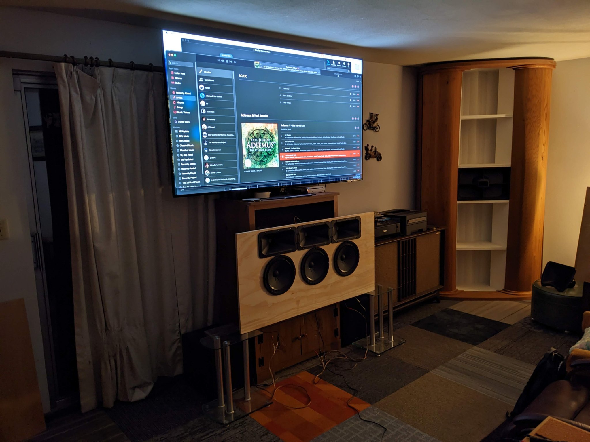

I've built a unified open baffle version of this system using Dayton waveguides and Faital Pro 10 FE200 10" mid-woofers. To start the experiment I just bought a 2' x 4' piece of plywood and cut some holes in it. It's just sitting on those speaker stands, leaning against the TV cabinet. I can't believe how great this sounds. I expected to cross the 10s to the horns at around 1500Hz but experimenting and listening has pushed that up to 3500Hz! The imaging and tone is just amazing. I'm becoming more and more convinced that keeping the crossover out of the range between about 300 and 3000Hz is a really good idea. The last time I employed a midrange driver in this way I used a 4" and I thought that was pushing things at 3500Hz. But it sounded great and so does this. Shouldn't it be beaming up top? Mabye it is, but I can't get those horns to sound any better covering that range. They sound more in your face if I cross them at 2000. Still good, but in a different way. These 10s push the soundstage back and sound sweeter.
I've got them crossed at 300 and 3500 24dB/octave on both ends.
The system works better than ever, producing a beatiful wall to wall soundstage with excellent tone and a rock solid center image. As excited as I am by this unusual arrangement's success, I think I'm just as excited about these awesome 10" drivers from Faital Pro! They do need some EQ to get them really flat, but they go nicely up to about 4K and then drop off fairly gracefully. No really nasty peaks up higher. They're efficient and can handle some power. And they're not expensive.
