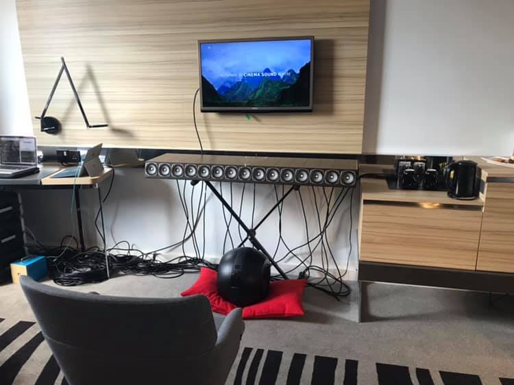

Folks may have noticed that I haven't been posting much lately, and a big part of that has been that 3.1 just works.
Some background:
1) Twenty years ago, I spent fifteen hours a week commuting to work, and I was quite active in car stereo. I became interested in doing three channel, based on an obscure PhD paper that I found, where the author proposed using a single tweeter in the center of the soundstage, and omitting the left and the right tweeters entirely. This was particularly compelling for car stereo, because in car stereo we're often putting speakers up on the dash. So cutting that down from two to one speaker has a lot of benefits. Most importantly, it's very difficult to get a good soundstage in a car without DSP or chopping up the car. And car DSPs in 2003 weren't affordable or very good.
2) That experience note above led me to Opsodis, which is basically just an evolution of the same ideas. https://www.diyaudio.com/community/threads/cbt-with-crosstalk-cancellation.405434/
3) When re-evaluating Opsodis this year, for the first time in ages, all of the simulations looked atrocious. It looked like you basically had to keep your head in a vise, and moving your head even 10cm would signficantly screw up the high frequencies. Another issue with Opsodis is that it's a lot like taking a very very tall multiway array and flipping it on it's side; you wind up with extremely narrow horizontal beamwidth and wide vertical beamwidth... the last thing we could possibly want.
But I'd had good experiences with Opsodis in the past, so I figured "might as well give this a go."
What I ended up with is basically a crude 3.1 setup... that somehow works pretty great.
If you look at the matrix settings for Dolby Prologic II, all of the processing can be done with a $80 MiniDSP:
https://www.diyaudio.com/community/threads/diy-prologic-ii.308266/
There's absolutely nothing "fancy" here. The center channel is mono. The left and the right channel are still the left and the right channel, but their level is attenuated. The only thing that's particularly novel is that the surrounds are reversed and out-of-phase and attenuated.
I did make one significant change, and I think this change is The Secret Sauce:

Perhaps I'm missing something, but for me, the big breakthrough with my funky 3.1 channel setup was bringing the left and the right speakers much much closer. I started out with the left and right speakers about one foot forward of the center channel, and what I found was that I could bring the left and right closer and closer and closer. And you'd expect the sound stage would get really weird or too close, but that wasn't the case at all. As of today, I have the left and right speakers immediately to my left and to my right, and the center directly in front of me.
This next part is super important, and it's another 'trick' I learned from car audio. Basically, you MUST use DSP to get all three speakers to arrive at the same time. In car audio, you can use DSP to move the soundstage to left and to the right, and even a time delay of a fraction of a millisecond is audible. In MiniDSP, you can literally increase and decrease the delay to one of two speakers, and hear how the stage shifts accordingly.
With this 3.1 setup, this is absolutely necessary. Unless, of course, you have the freedom to place the speakers exactly equidistant. And I'm not exaggerating here, a difference of even 5-10cm is audible.
This next idea might be controversial, but here goes:
Obviously, I've long been fascinated by the Danley speakers. I once rented an SH-50, and one of the really peculiar aspects of that speaker is that it's not easy to tell where the soundstage begins and ends. I've told this one a hundred times: I had the SH-50s playing at a fairly high volume, and our daughter was seated on the couche, literally less than a meter away. At one point she asked "is it on?" IE, the origin of the sound in an SH-50 is so nebulous, she was getting blasted by one less than a meter away and she couldn't figure out if the sound was coming from the speaker or somewhere else. Remarkable.
The reason that the SH-50 can do this is because it's possible to produce a wavefront that is IN PHASE even if the loudspeakers aren't physically located at the same point in space. Ideally you'd perform this trick inside of a big horn, like the SH-50. But you can get "in the ball park" using conventional speakers and delay.
End fire and gradient subwoofer arrays work off of this concept. But the ideas work at all frequencies; there's nothing stopping you from making an end fire midrange array.
In the current implementation of my modest 3.1 setup, I'm leveraging these ideas, by placing the left and right speakers closer than the center and then "fixing" the pathlength difference with DSP delay. YMMV but I find the effect to be pleasant; it makes the depth of the stage more nebulous. Because DSP can "fix" pathlength issues, but the sound is still coming from three speakers that AREN'T equidistant. At some point I might move the speakers so that they ARE equidistant, but if memory serves, when I did that, the sound stage depth wasn't as good. Obviously this is a subjective thing, because you're trading pinpoint imaging for a deeper soundstage.
