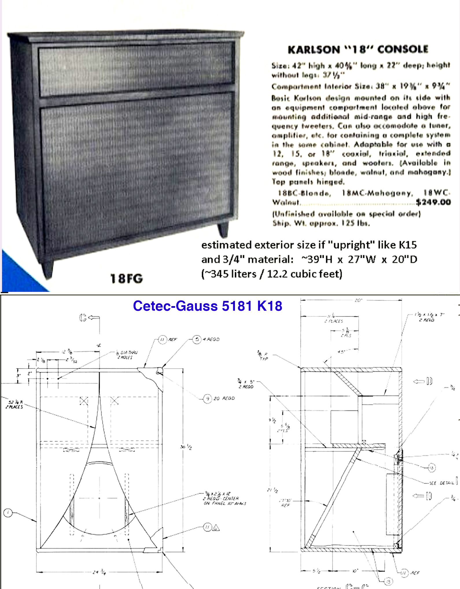

No - assume its scaled directly from K16. (roughly 1.2X) so ~39" tall by 27" wide by 21.5" deep - which pretty much matches
the dimensions given in the brochure. - - I goofed on the depth on the image below as gave the scaled internal depth rather than
external.
K18 can be made about the bulk of K15
The only person who may know, if still living, is Alan Weiss who had the last "Karlson patent" and a company which sold a little klam8.
You can check the given dimensions minus the upper compartment.
Gauss's president said they developed their K18 empirically ("by ear")

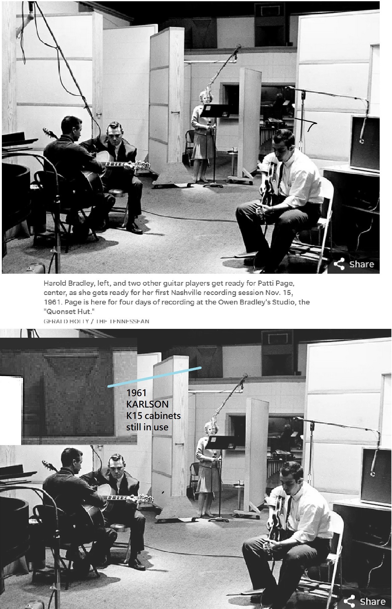

Its an easy thing to figure out. I found a picture of Bradley's studio in November of 1961 and the Karlson enclosures were all in use. In 1962. Columbia Records bought the studio and replaced the K's with Altec Voice of the Theater cabinets.
So many hit records prior to 1962 were monitored and mixed using K15 Karlson cabinets.
