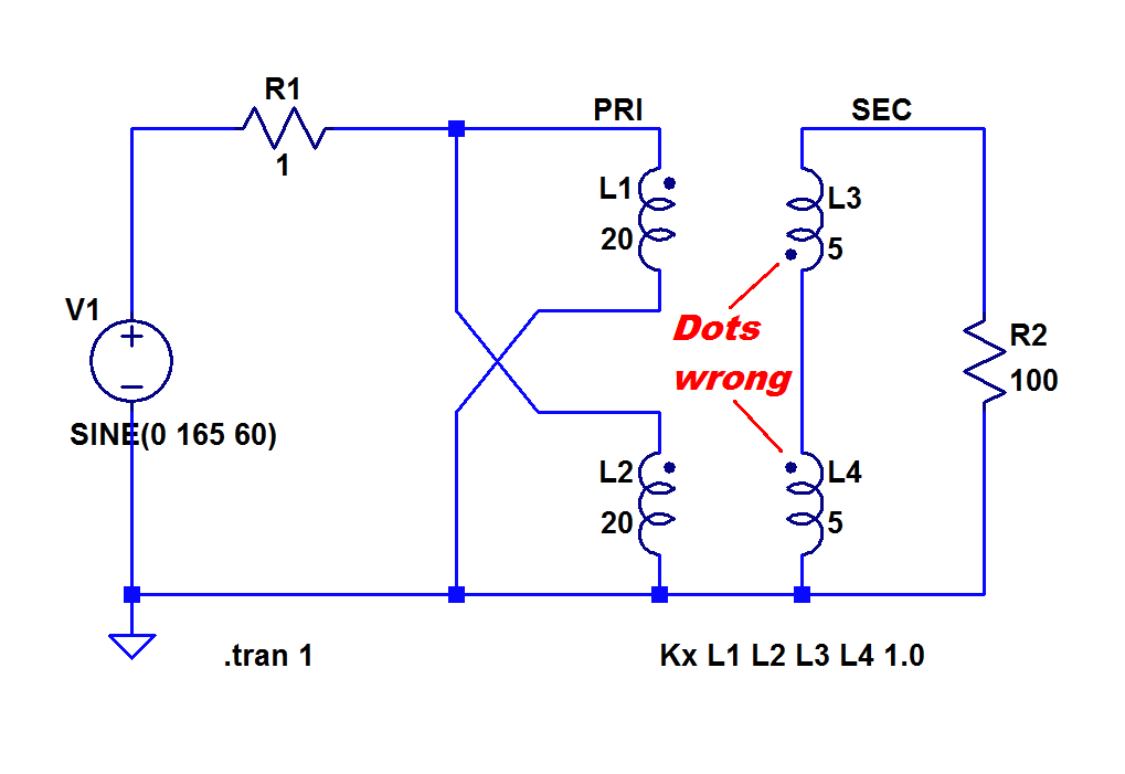

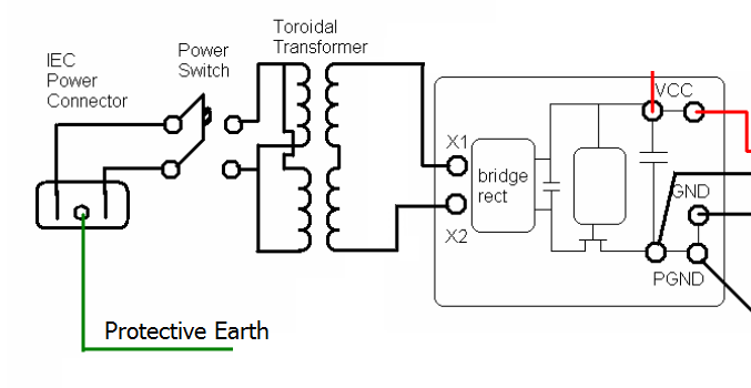

This is the power supply wiring diagram from the Akitika GT-101 audio power amplifier, when used with 115VAC mains such as in USA. The transformer has two primaries, each 115VAC. It also has two secondaries, each 35VAC. The goal is to deliver 70VAC to the bridge rectifier.
For 115VAC operation, the primaries should be wired in parallel and the secondaries should be wired in series.
However, if you accidentally connect the secondaries incorrectly and test it with your mains bulb tester, you get no indication that anything is wrong. Try it in real life. Or try it in simulation. The mains bulb detector has no idea that the secondary windings are out of phase; it doesn't tell you the dots are wrong.
(if you try it in simulation, remember to install a teeny bit of series resistance in each winding; I used 100 micro-ohms)

One can wire the dual primaries out of phase and the Bulb turns ON.
Or one can wire the secondaries out of phase and shorted and the Bulb turns ON.
Or one can wire both the multiple primaries and the multiple secondaries out of pahse and the Bub turns ON.
All transformer wiring errors are protected from damaging the transformer using a correctly wired Mains Bulb Tester.
BTW, your right hand diagram will not damage the transformer.
But once you measure the output voltage you will find near zero volts across the 100r resistor. The resistor will stay cold.
Ah ! one thinks and rewires either one of the primaries or one of the secondaries.
Powering ON this time either brings on the Bulb or gives one the expected 100r voltage. i.e. it gets hot.

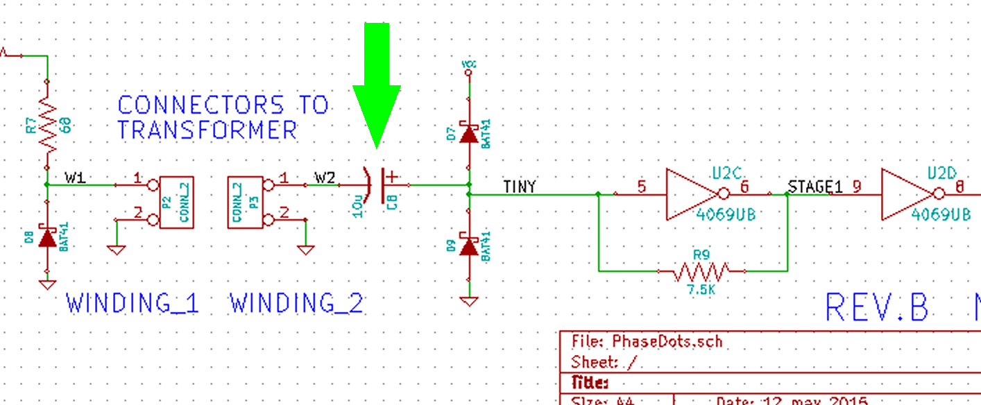

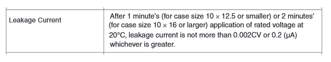

The PhaseDots Bill Of Materials specifies that C8 should be a "low leakage electrolytic." People buying their own parts to solder into a PCB have asked: (i) why?, and (ii) how low is low?
Why? If C8 leaks, the leakage current will disturb the input bias of the first stage of amplification (these stages are CMOS inverters operated in their linear region). Suppose we're measuring a transformer with a voltage stepdown ratio of 230-to-3. Then the 8V square wave in the primary becomes a 100mV square wave on the secondary, at node TINY. If C8 leaks 10uA then node TINY is offset by (10uA x 7.5K) = 75 mV, and the input signal is almost obliterated. {obviously this analysis has been oversimplified for brevity}
How low? I'm shipping a 10uF, 25V capacitor from the Nichicon KL series, in the Phase Dots kits. This is probably excessive overkill, but my feeling is, it only cost twenty cents so why not use parts that are too good instead of not good enough? The leakage spec from the Nichicon KL datasheet (link here) is shown below.

Mark,
thanks for that link to the low leakage electrolytic.
leakage < 0.002CV is roughly 10times better than ordinary electrolytics.
I find that reforming a good but ordinary electrolytic can improve the leakage from a specified 0.03CV to between 100times better to 500times better.
After reforming and then exposing them to a low bias voltage will allow them to degrade slowly back to their leaky state. Shortly after a double reform the leakage ~0.0003CV to ~0.00006CV
Tantalum is slightly better.
BTW, I need to use reforming resistors of ~50k to be able to measure the leakage. And leaving a fully charged newly reformed cap on the bench for a month loses <30% of it's charge.
I wonder how good the Nichicon KL is after reforming and how well it retains the super low leakage when stored at low voltage?
Sounds like an experiment you could try in your lab!
Maybe you'll also try inserting a shorting bar into the "Winding_2" connector of your PhaseDots board, thereby establishing a bias of (Vcc/2) = 4.5 volts across the low leakage capacitor C8. Then make a plot of (C8 leakage) versus (number of seconds at 4.5V dc bias). You could also experiment with plugging various resistor values into the Winding_2 connector; after all, a shorting bar is nothing more than a zero ohm resistor. Maybe a one megohm resistor would give amusing and instructive behaviors.
Perhaps you will be able to gather enough data to confidently suggest a lab protocol that minimizes capacitor leakage. Maybe something like (a) insert a resistor across Winding_2 connector whose resistance is less than 220 ohms; (b) turn on PhaseDots box for at least 15 seconds; (c) remove resistor and use box normally; (d) repeat (a)-(c) after each 50 hours of continuous PhaseDots use.
But remember - leakage is only significant when testing gigantically huge transformer stepdown ratios. Specifically, single 230V primaries (not dual primary 115V+115V) and super low voltage secondaries. I expect this to be less than 0.1% of the total usage of PhaseDots boards.
