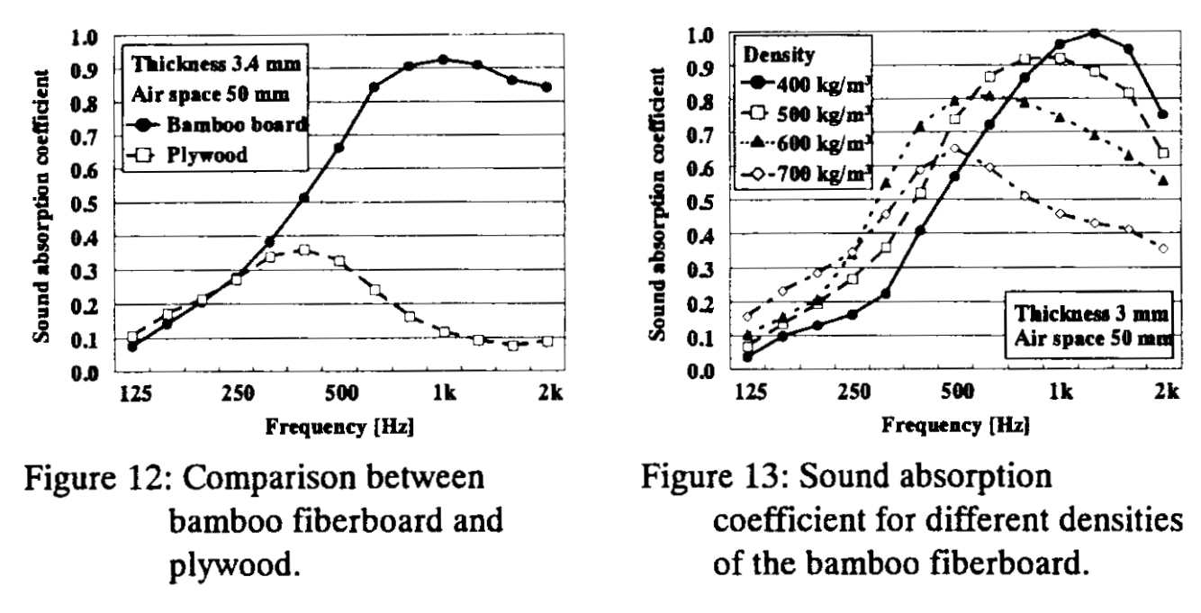

Found "paid by the industry" paper on bamboo.
The Development Of Sound Absorbing Materials Using Natural Bamboo Fibers
Could be interesting to try. I see it has been mention a couple of times in the thread. Here is some data.

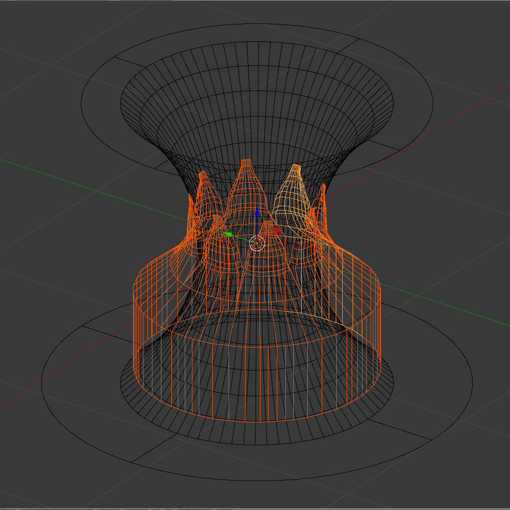

If you are having turbulence issues in your taps maybe you should explore low turbulence/drag inlet/outlets. A lot of solutions to this in aerospace. Probably the easiest to go with is is something like a "NACA duct". The other thing to keep in mind is that large discontinuities in flow area will cause issues. Just sketched something up to consider.
8 NACA ducts near the throat of the port with a smooth ducted transition to a large volume. You would want to avoid stuffing to closet to the duct inlet.

I have a feeling tap location will be pretty critical, need to try before after and right at the throat at least.

I think the longitudinal slit will have less of a chance to 'whistle', whereas the other is setup like a whistle.
Holy cow ducts in your ports? (Last I knew, countach translates to holy cow.)

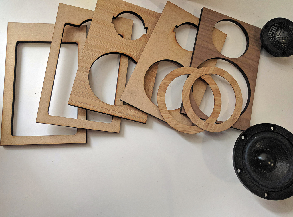

Hell yeah! Didn't have the skills to pull off Sin Phi's example, but mine might be functionally similar in that they flare out on the backside.
Thanks. I'm getting there slowly.I see you are getting closer... your multi-layer baffle cutouts look very clean.

It seems there are a few types. The one I am using has 3 layers of bamboo with the middle going the opposite way as far as grain. I have seen 2 layer too.
a) rockler
b) etsy
c) use a laser cutting service for the part.
Lowes has some bamboo butcher block too.

ah, you are talking about bamboo plywood, I thought there was a fiberboard
Oh, dang. Bamboo mdf seems like it should be sold next to unicorn horns. I had lots of empty searches. The closest I got was finding a company name from a bamboo mdf making patent but that turned up nothing. I am sure someone will find it if it exists.
