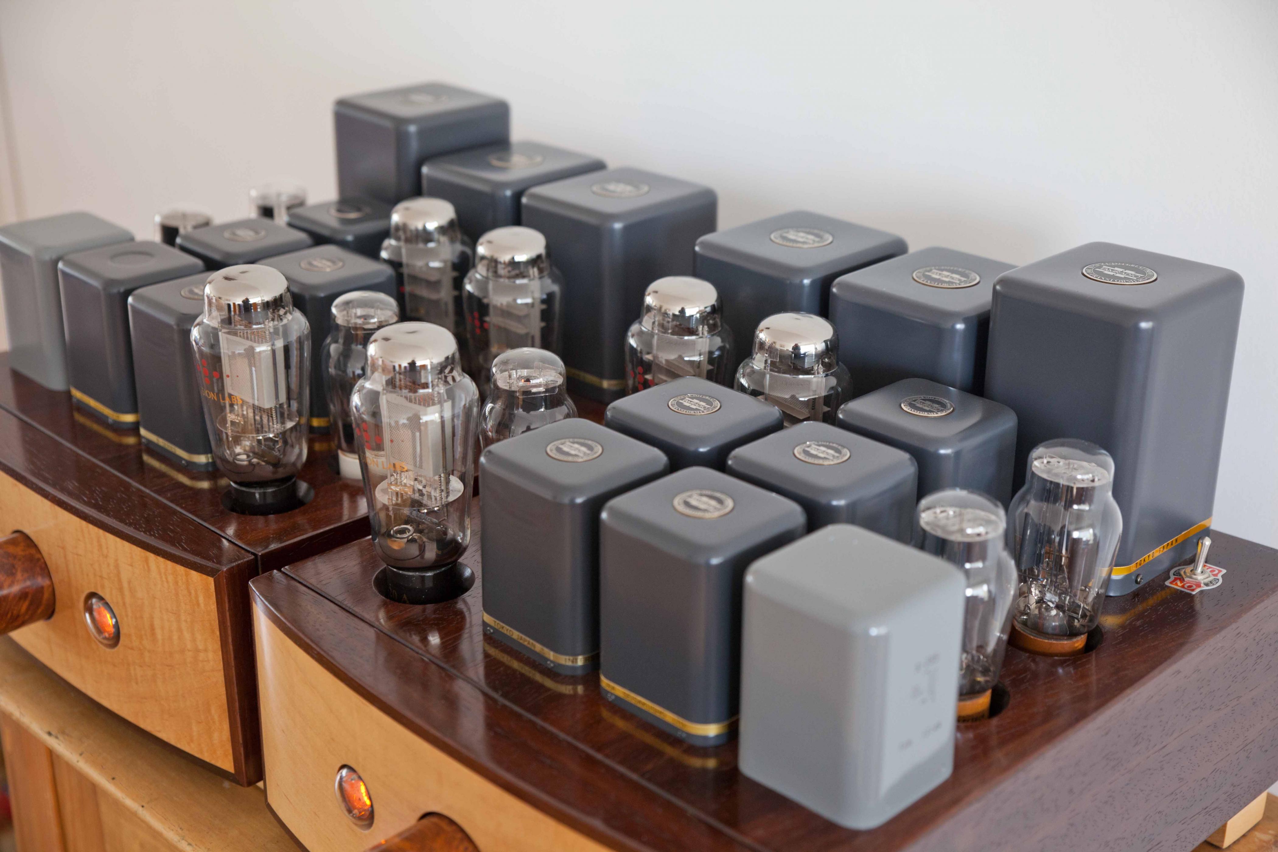

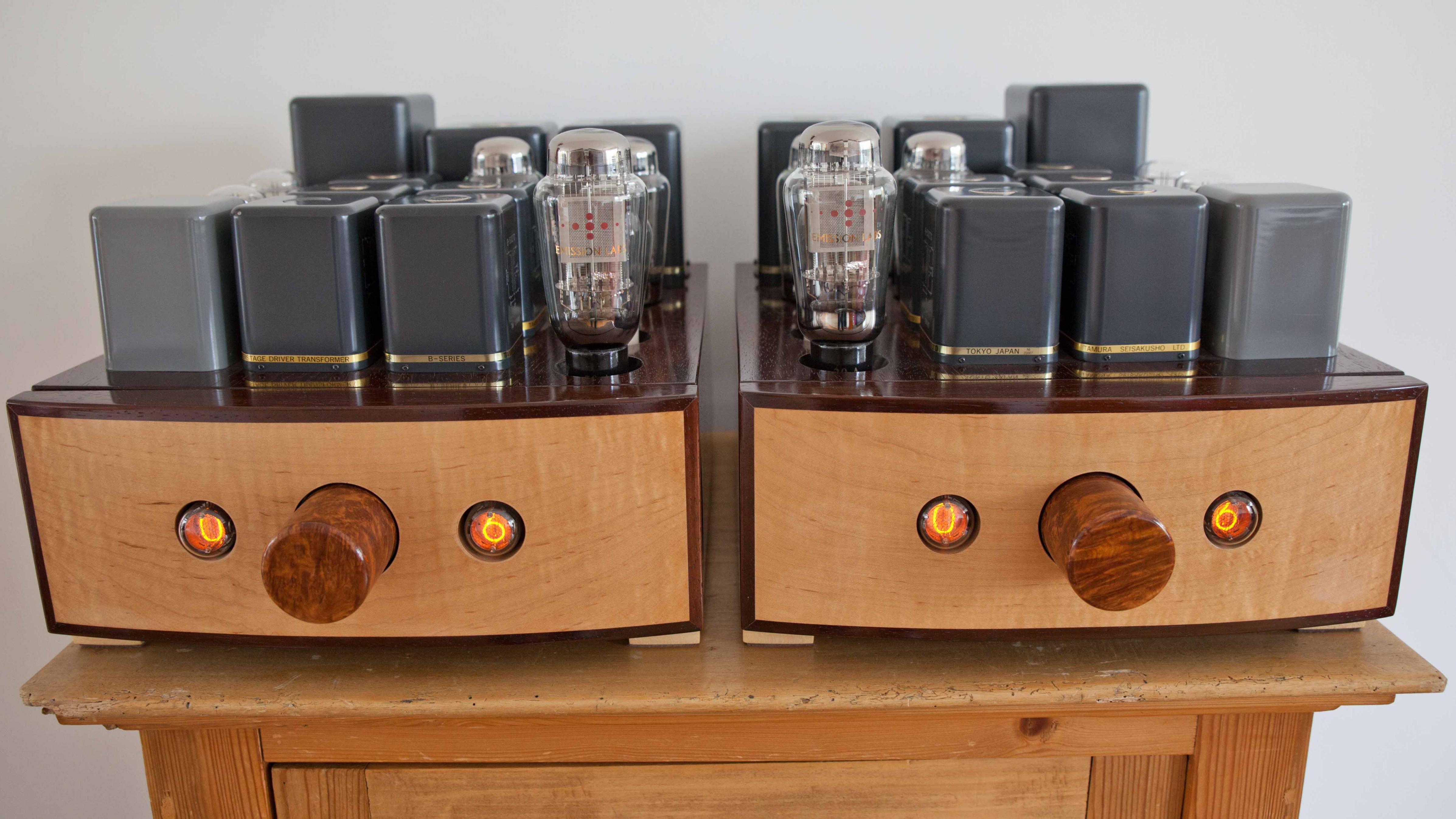

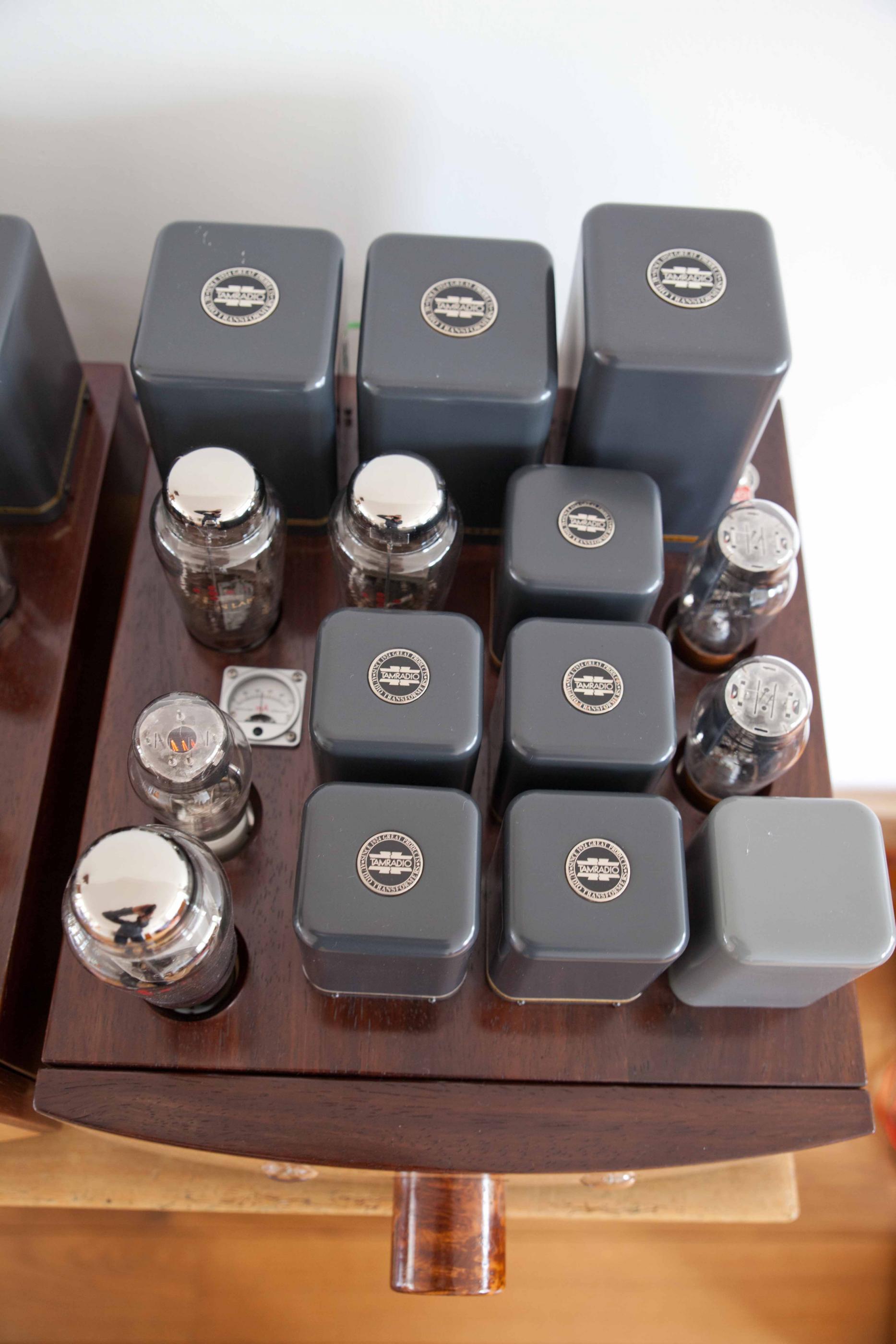

These pair of 300845 sound fantastic!
A bit off topic but what the hell
All directly heated triode tubes.
EML AD1 two channel amp outputs (Sakuma style), WE VT-25 driver, EML 20A input tube, packed with interstages and chokes.
Nixi shows volume setting.
