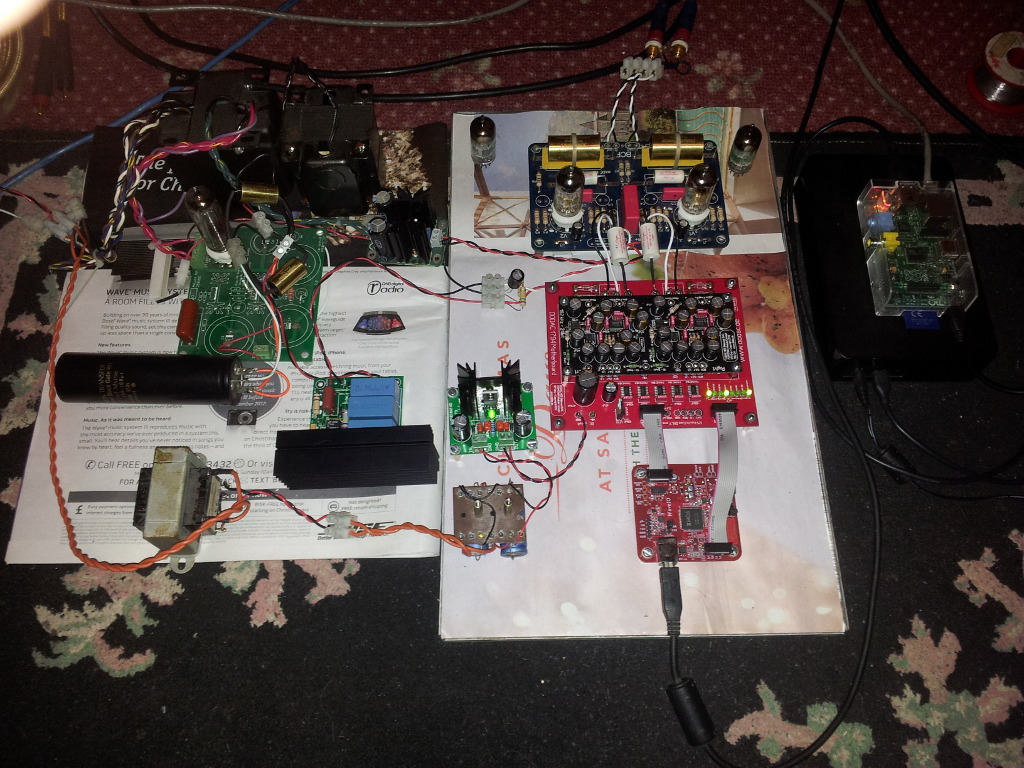

Having had the chance to fiddle with various output stages for the DDAC1794, I've decided to stick with the Broskie Cathode Follower. (I make no apologies for being a tube guy.)
One thing I have found is that there is a benefit to be had using the +/- output from the DAC. Although I have not tried a transformer, (don't have anything suitable to hand), I expect that the benefit would be the same. You could even consider the BCF to be a sort of poor mans "active" tube transformer, converting a balanced output to single ended, but step-down, 2:1. (So if you had 1.2V single-ended from using one of the outputs, you'll still have 1.2V SE using both of the outs via the BCF.) Aside from any on-paper arguments about CMRR and noise cancellation, the bottom line.... more focus and less grain combining the outputs, as opposed to just using one single ended output. (Of course, if you prefer opamps......
Although I was using a differential gain stage in front of the BCF, I've gone back to the 133R I/V resistors and am just using the BCF to obtain a SE output from balanced.
200V HT from Tom Christiansen 21st Century Maida Regulator to the tubes. Heater supply is regulated too. ECC88's, 220R cathode resistors.
50k grid stopper and feedback resistors. That's all there is to it really.
I also swapped my original "junk" 7812 reg that was powering the main DAC board for a Salas shunt. To be honest, I couldn't hear any difference. Then I tried an eBay reg module based on the LT1764, claiming 40uV of noise. Couldn't hear any difference with that either. So it has stayed in by virtue of being last into the circuit. (I've ordered another to power the WaveIO board.)
I'll put it all into a case over the Christmas holidays.

PS. your temp setup looks really interesting Clive. How does the tube rectification/output stage compare to the standard passive IV output? Do you use a valve preamp as well? IE. will I benefit from going an active tube output stage like yours if I already am using a decent valve preamp?

Well, the BCF I'm using although active, isn't really active in as much as it doesn't provide gain. It just combines the balanced outputs into a single output for SE use. In your case, where you'll be using both +/- outputs into your pre, there is no need to add anything if you are happy with the concept of passive output from the DAC board.
The problem with adding active tube stages to DAC's is that without feedback, they better be very low distortion, or you end up in the situation, where the passive out has reasonably low distortion to start with, that you increase it just by adding a tube stage. And without using very high transconductance tubes, you'll probably be adding more noise to the output than is there with the passive out.
IMHO, there is a benefit from using the balanced outputs from the DAC. Without getting into any audiofool clichés, eg. "it seemed like a veil was lifted", I didn't find it subtle. If you have a balanced setup to start with, you don't need to do anything. If you are single-ended, then it is worth thinking about transformers or the BCF.
