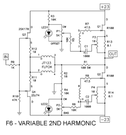

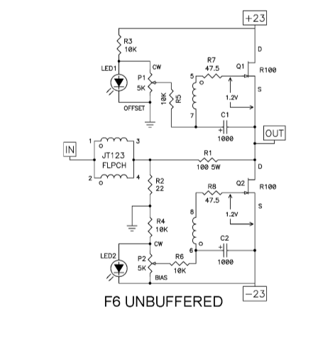

You can use the Sowter also as splitting Phase transformer - it has a center tap (normally not used, but here you can.
my 2 cents on your question If want to keep the transformer in the F6 doing the job:
just put a resistor at the F6-primary of say 100k and a 10k at the output of the Sowter. (both in their respective chassis of course)
ok, forget my comments… i did not knew the F6 in detail - good I had a look.
this is not a phase splitting setup - it is a d2 reducer….
you can omit the buffer it seems (maybe), but than you go in single ended. I am not 100% sure on the whole thing and this goes beyond this thread, so please check google or the Pass forums?

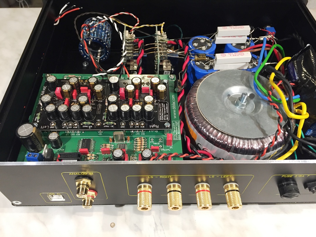

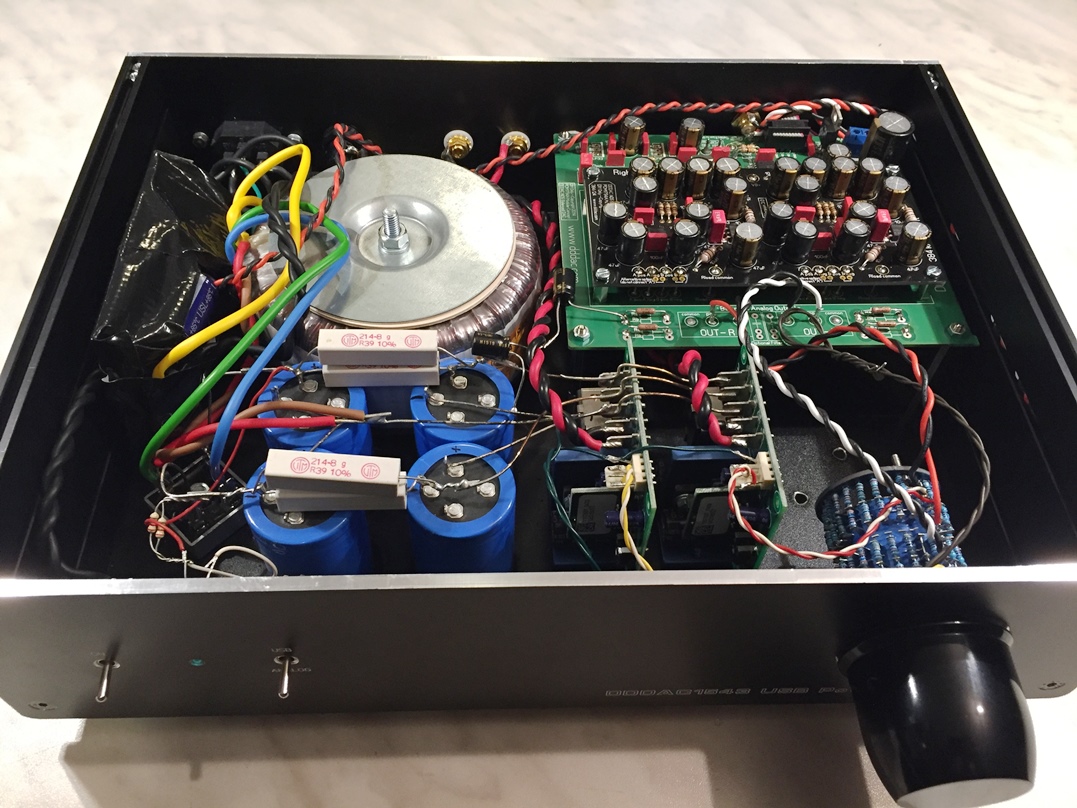

Still a work in progress, but getting there.
Last week I got the second deck to make and put it on.
But also got me thinking of using a display, but did not want de RaspBerry screen, because of the lower resolution.
So I ordered this on, it has the instructions to make it work on a Raspberry, so just copy past this in de config and![cheers :cheers: :cheers:](https://files.diyaudio.com/forums/images/smilies/cheers.gif)
7“ LCD Display - Joy-IT
And the second deck
When you do not have 68R resistors, just use the original 133R parallel to 3 parallel 390R to get "close enough"
![rolllaugh :rofl: :rofl:](https://files.diyaudio.com/forums/images/smilies/rolllaugh.gif)
And now with 68R 1W Takman Carbonfilm resistors
