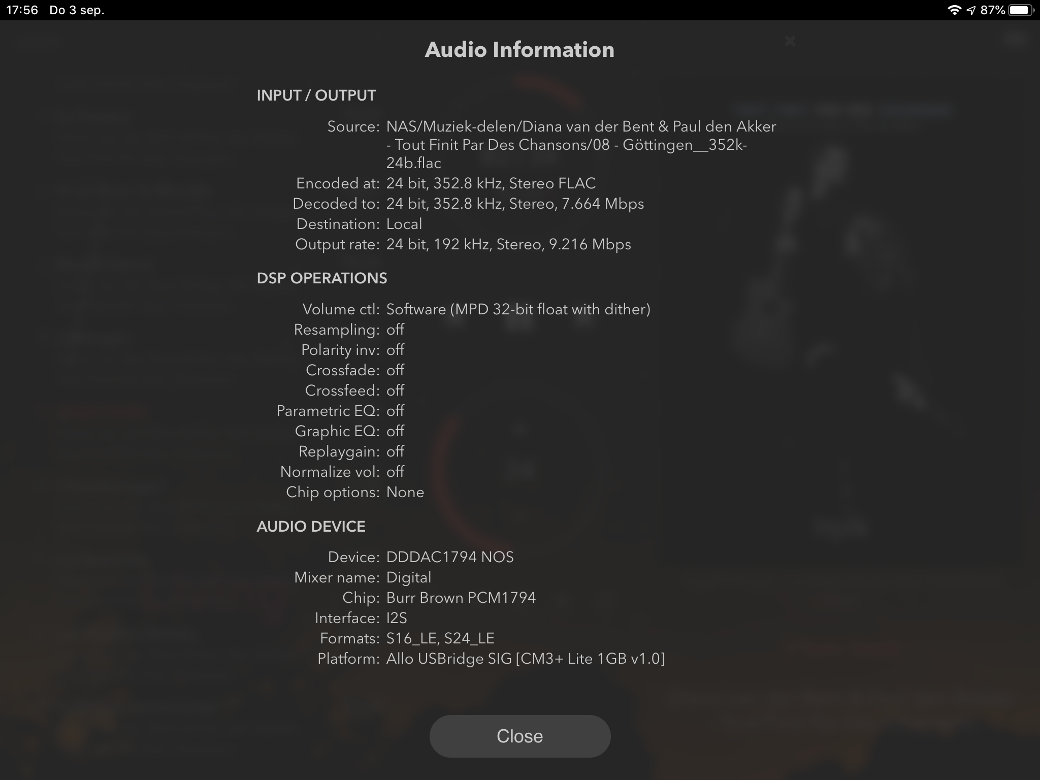

The dddac is able to play files up to 384khz. Why does moode audio convert my 352khz files to 192khz?
I use an usbridge sig with I2S out to fifopi and to the dac stack and the latest moode software.

The software that handles the audio with the moOde distro is MPD.
Assuming you have a stock 6.7.1 distro without mods.
Because the outputrate differs from the decoded rate, the output device has informed MPD that samplerate isn't supported. Thats why MPD downsamples.
First place to check is what the command alsacap tells about the device capabilities.

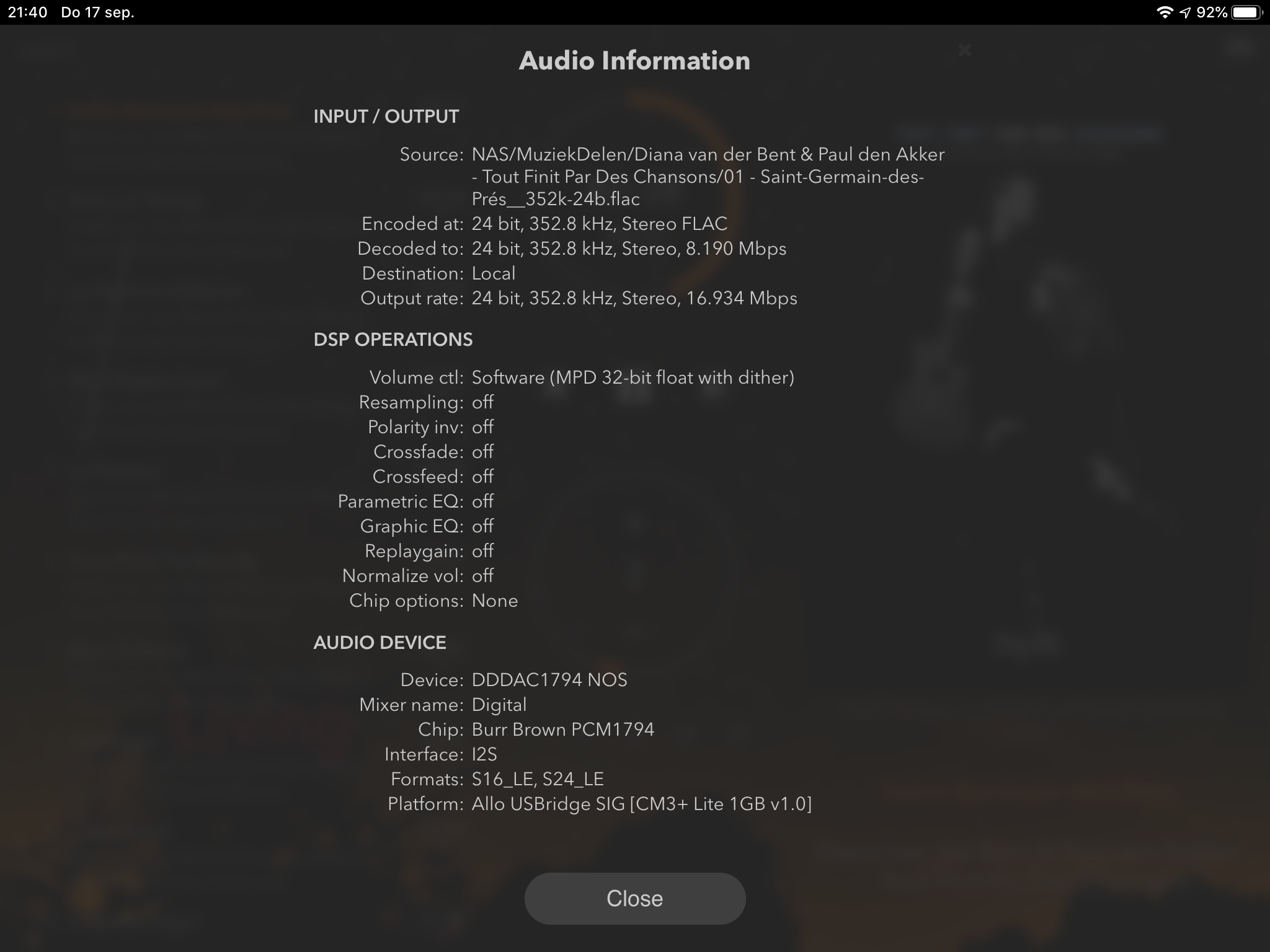

Based on @Supersurfer issue I have created a patch for the stock raspberry pi linux kernel that will support 384k for rpi-dac driver. And yes it works fine:
The kernels guys now only say that according spec it only goes to 192kHz, only that is with the 8x oversampling and filter active.
Does anyone have for me a reference that it 38k4 is indeed supported and that I'm not misusing the pcm1794a ?
