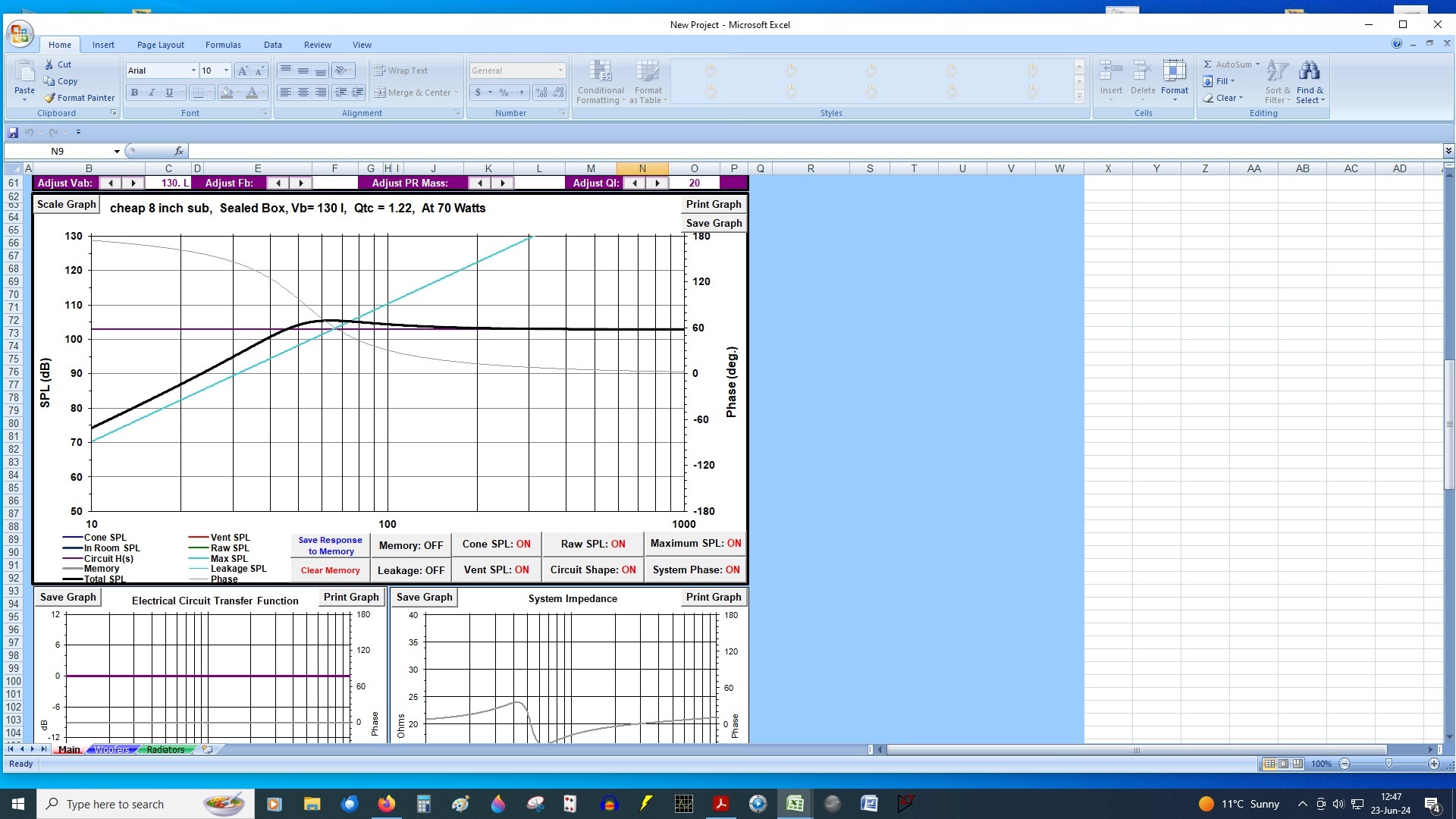

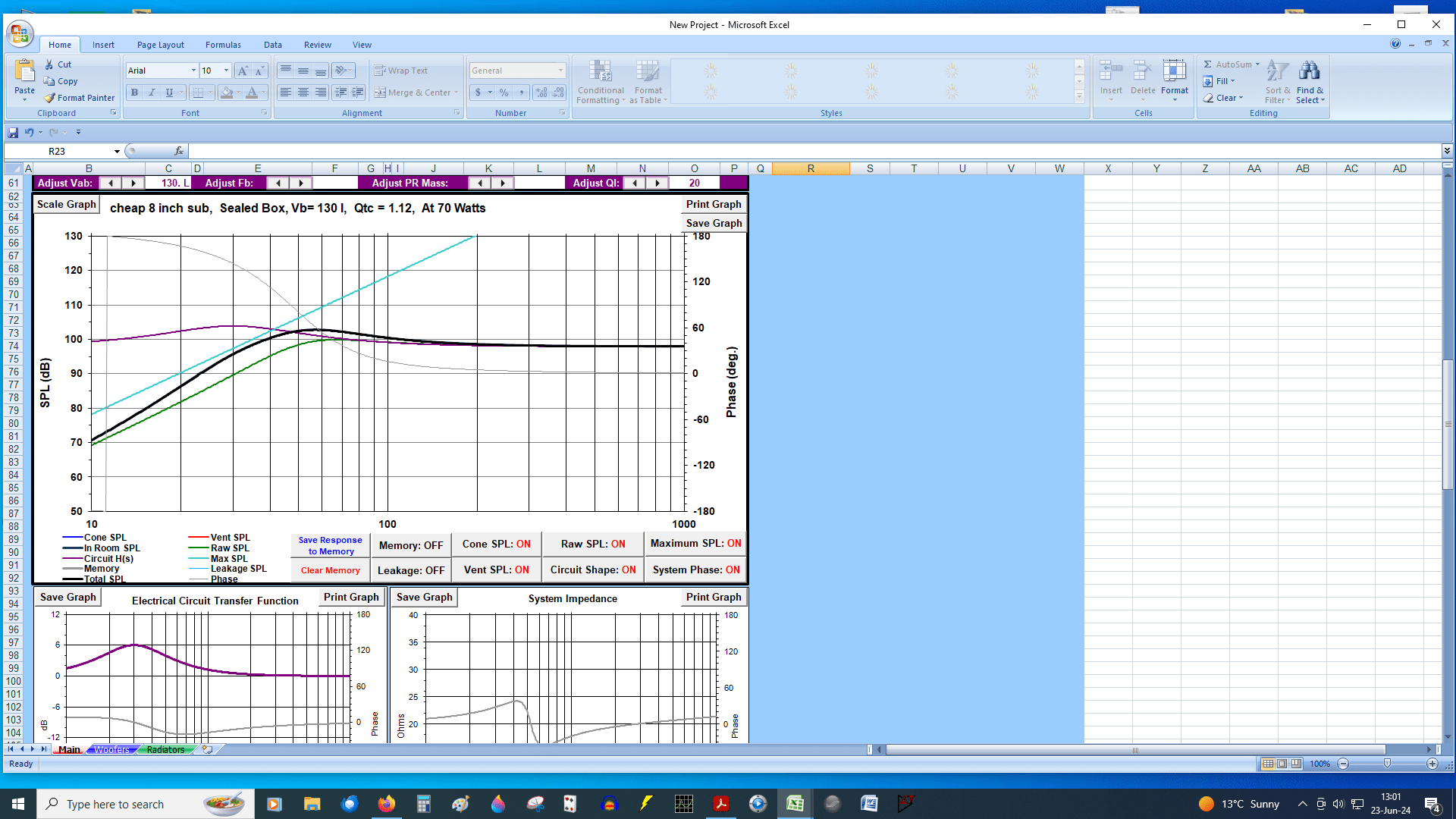

Just for fun I put this into the partially working program and I get this if I put 4 of them into the same size box as the 18 at 70Watts to a single woofer but I could probably push these to 7mmX-Max rather than the 4mm I input
1 Watt gives ~ 86dB at 60Hz so lots of manipulation needed
If I increase X-Max to 10mm [ extreme IMO] and add 6dB of boost at 30 with a "Q" of 0.5 I get the second graph at 70 watts. Would most people find this acceptable? Do I get +3dB for wiring the 4 in series parallel too?

At most count 1/2 the surround towards the Sd, 1/3 may be closer.
Puts Sd in the 240-283 range x4 is fairly close to an 18".
Not sure how you are framing the question.
For mutually coupled drivers, each doubling of Sd and cabinet volume gains +3dB sensitivity (sensitivity defined as 1w/1m), so four speakers are +6dB more sensitive than one.
1 Watt gives ~ 86dB into one speaker, 92dB into four speakers.
Each doubling of power adds +3dB, so four speakers in four times the cabinet volume with four times the power of one give +12dB total over one, 98dB from 4 speakers driven with 4watts.
Four 4 ohm speakers in series parallel is a 4 ohm load.
2 volts into a 4 ohm load=1watt.
2.83 v into a 4 ohm load=2 watts.
Four 4 ohm speakers in parallel is a 1 ohm load.
2 volts into a 1 ohm load =4 watts, +6dB over one watt.
