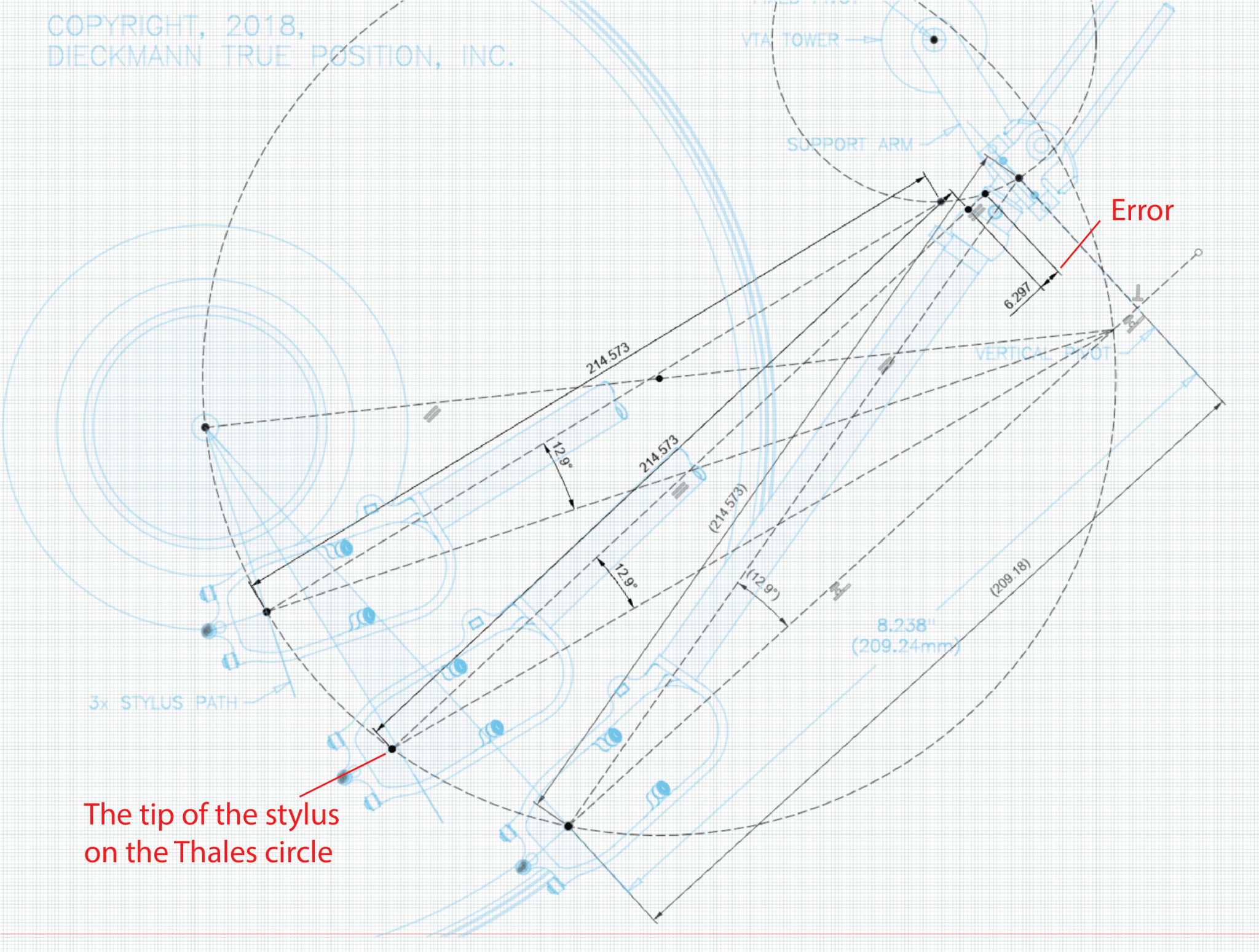

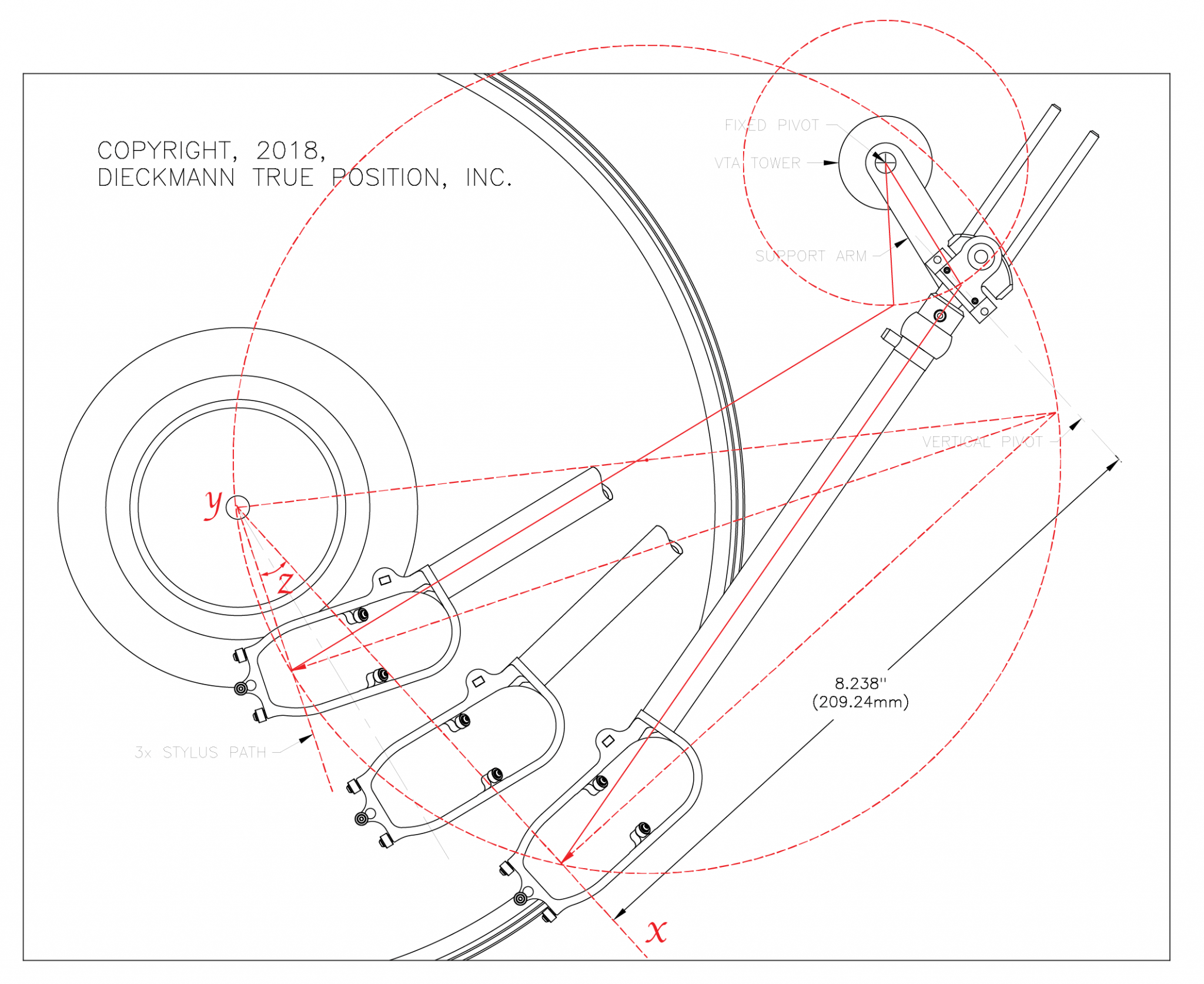

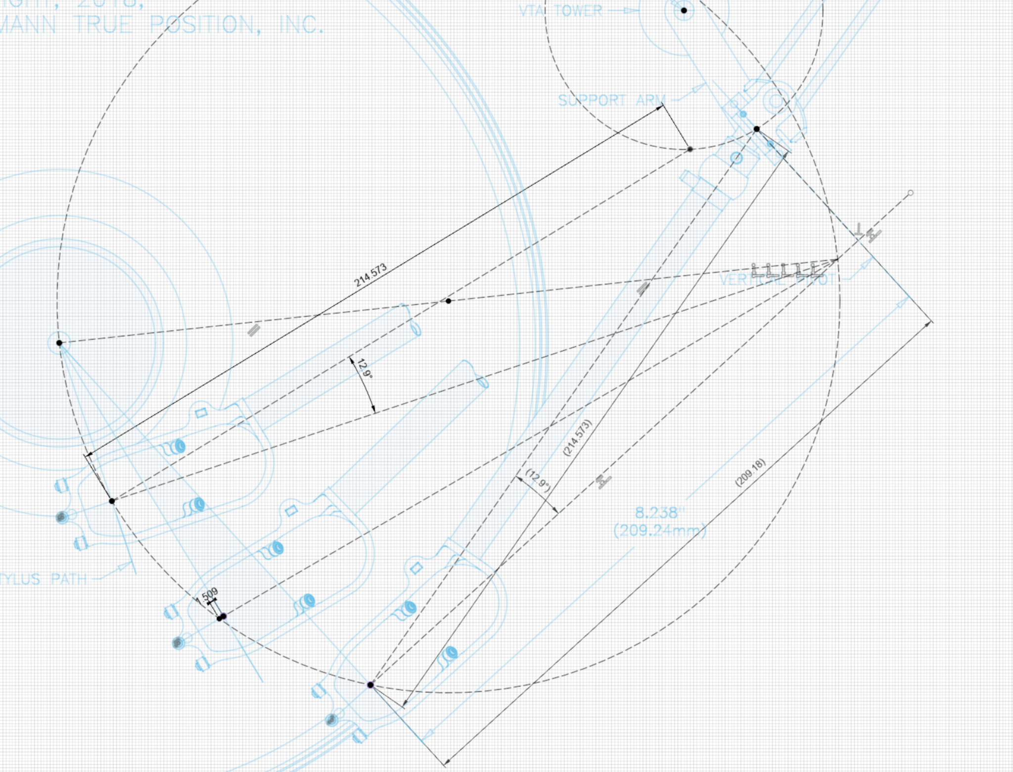

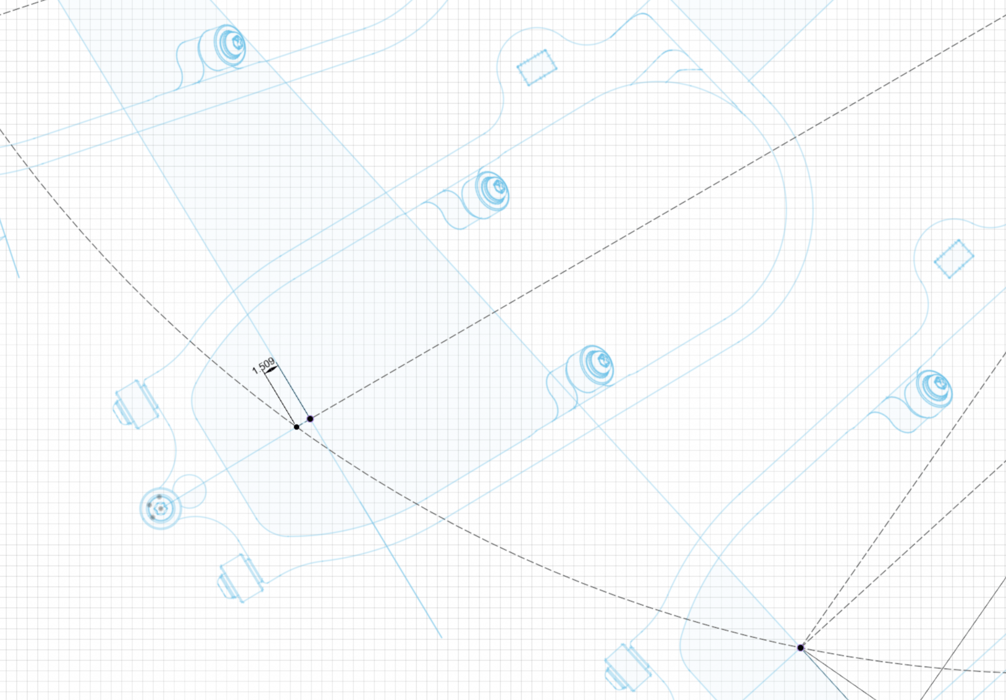

I found some blank space left over on the back of your coaster and did some more calculations. Let’s say the servo skipped a 0.12mm beat on one revolution and resulted in the 0.045 degree tracking error. That’s still way better than the $53,600 arm on its best day. Record eccentricity does come into play by challenging the servo, but the eccentricity also causes an intrinsic tracking error due to the eccentricity itself. As the eccentricity vacillates left and right 0.12mm it plays games with the servo. As the eccentricity vacillates fore and aft 0.12mm the tangency point of the groove will skew under the stylus. At an outer groove radius of 146mm the ‘skew’ tracking error will be +/- 0.047 degree. At an inner groove radius of 60mm the ‘skew’ tracking error will be +/- 0.114 degree. This eccentricity induced tracking error is not tied to the servo action of the LT and will add to the mix of tracking errors in a conventional pivoted arm. True linear tracking arms such as passive mechanical arms and air bearing arms are also not immune to this ‘skew’ tracking error. The eccentricity induced tracking error is not a fault of any of those arms, but it’s there.
Very good, I hadn't thought of it in those terms, yes, any overhang/underhang caused by the eccentricity when it is orthogonal to the cantilever will give a relative skew to the cantilever axis. The thing is that all of these tracking errors are far less than what can be achieved even in the best setup and alignment of a TT. I very much doubt that anyone could pick the errors. The question is: can the variation in these parameters be heard? I would wager not, but then, I used to be an engineer - skewed thinking...
Interestingly, Ralf's tonearm will always maintain tangency, thus eliminating the tracking errors from all sources. Not the eccentricity wow, but nevertheless, I think a very worthwhile contribution.
As to audibility, well I get high def recordings where possible not so much because I believe there is an audible difference between PCM768 and PCM88 but to put it beyond doubt, also, the higher def recordings generally have far more care taken with the original source material.
I would feel a lot better knowing that the tangency is beyond doubt.

Ralf,
I would like to get your answer about the following geometry. If it is correct, we may continue. Otherwise, the discussion will be different.
I used your diagram as the template. Please see following diagram.
The following diagram is an enlarged version of the above diagram to show the detail. You can the tip of the stylus for the middle arm is not located on the Thales circle. It means there are tracking errors.
As long as you agree with my statement that your arm is a variant of Birch-style arm, tracking errors are inevitable.
Jim
Ralf,
I did error analysis again, but this time, I did it differently. I forced the tip of the stylus for the middle arm exactly on the Thales circle and kept the offset angle 12.9 and arm length 214.573 mm for all three arms. You can see there is an error in the rear pivot for the middle arm. It is 6.297 mm. It means tracking errors do exist.
Hi super10018,Ralf,
