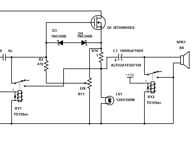

Here is whole idea from De-lite thread using mosfet and lamp, just used Bjt instead of mosfet.

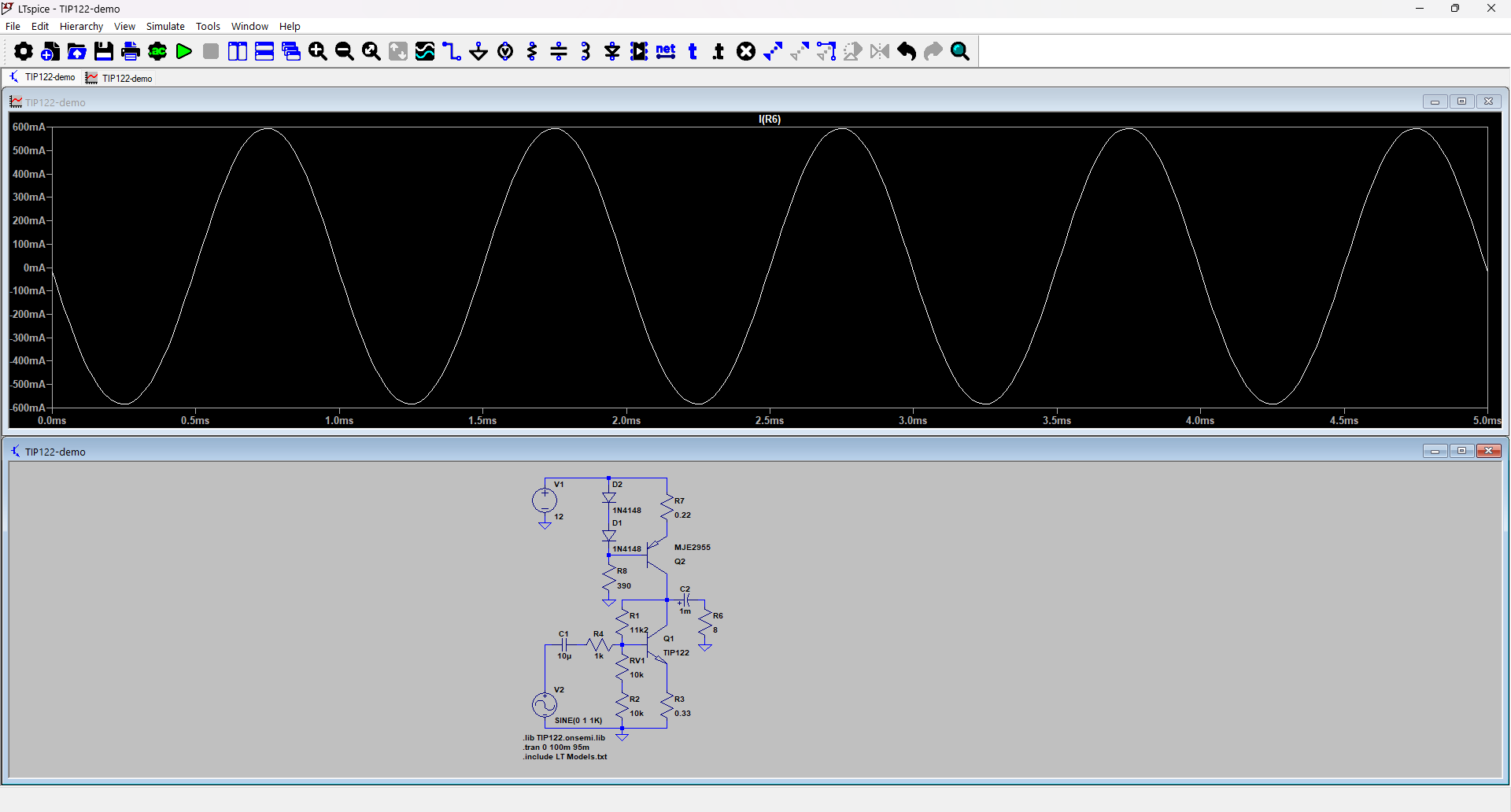

Adding two transistors more (amp from message #322) is much better. Also two 12V/10W lamps in parallel, but best solution is inductor loaded BJT. All this is just a simulation, not a working amp yet.
This one is like upper half from Hiraga's Le Monstre, nothing new.
I will try later this original Pass De-lite, just found these 300 watter 120 volts light bulbs and they are huge. McMaster-carr still sells some 264W bulbs (made in China) these older 300 Watter are made in Mexico.
My point was to try what can be done with one jfet and bjt with cheap automotive bulb and it was not good , so there is a reason to use more trannies. This four transistor version with inductor load behaves quite well in simulation. Could be useful if ready some day later.
