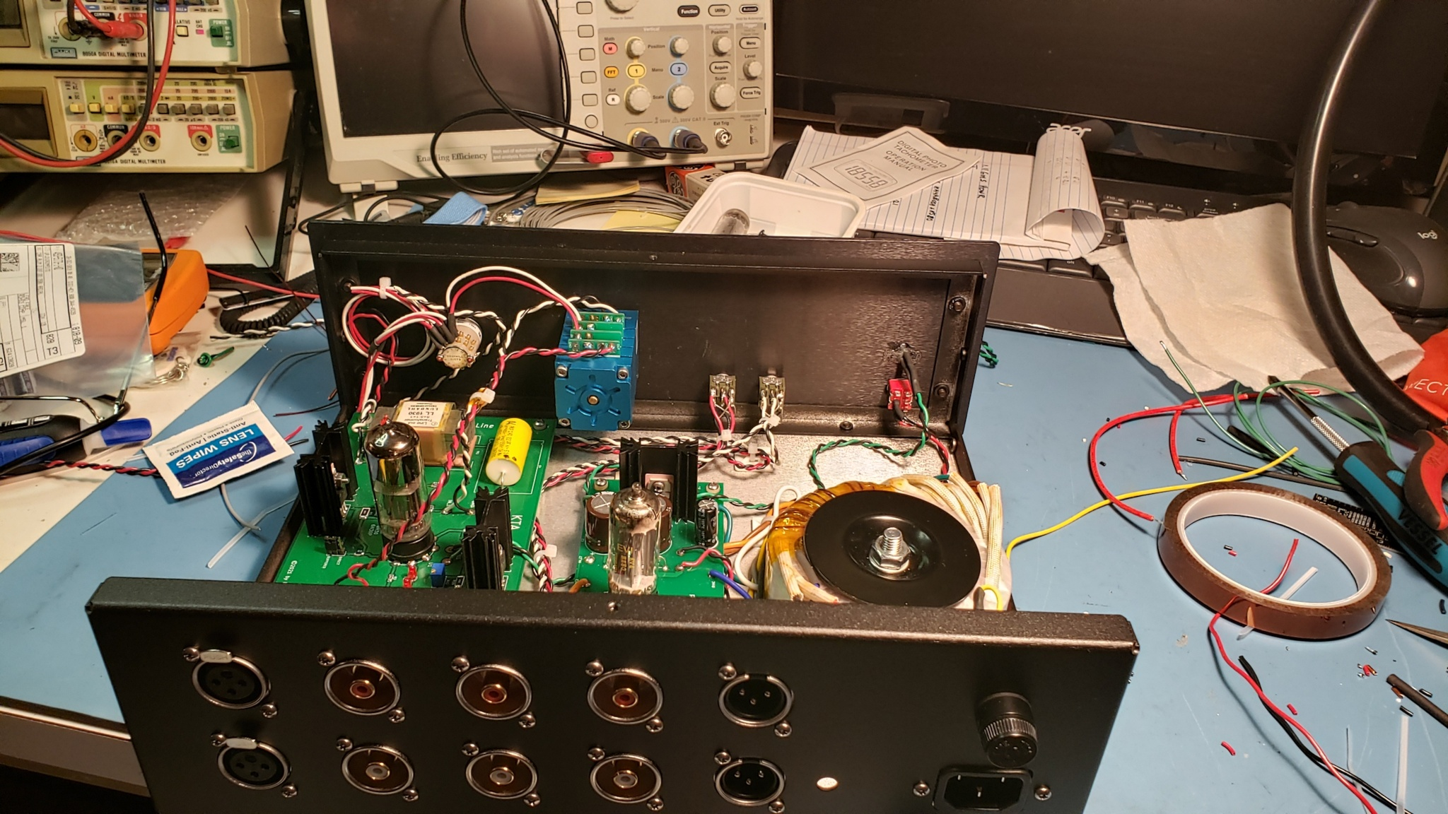

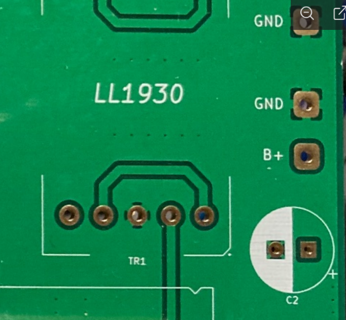

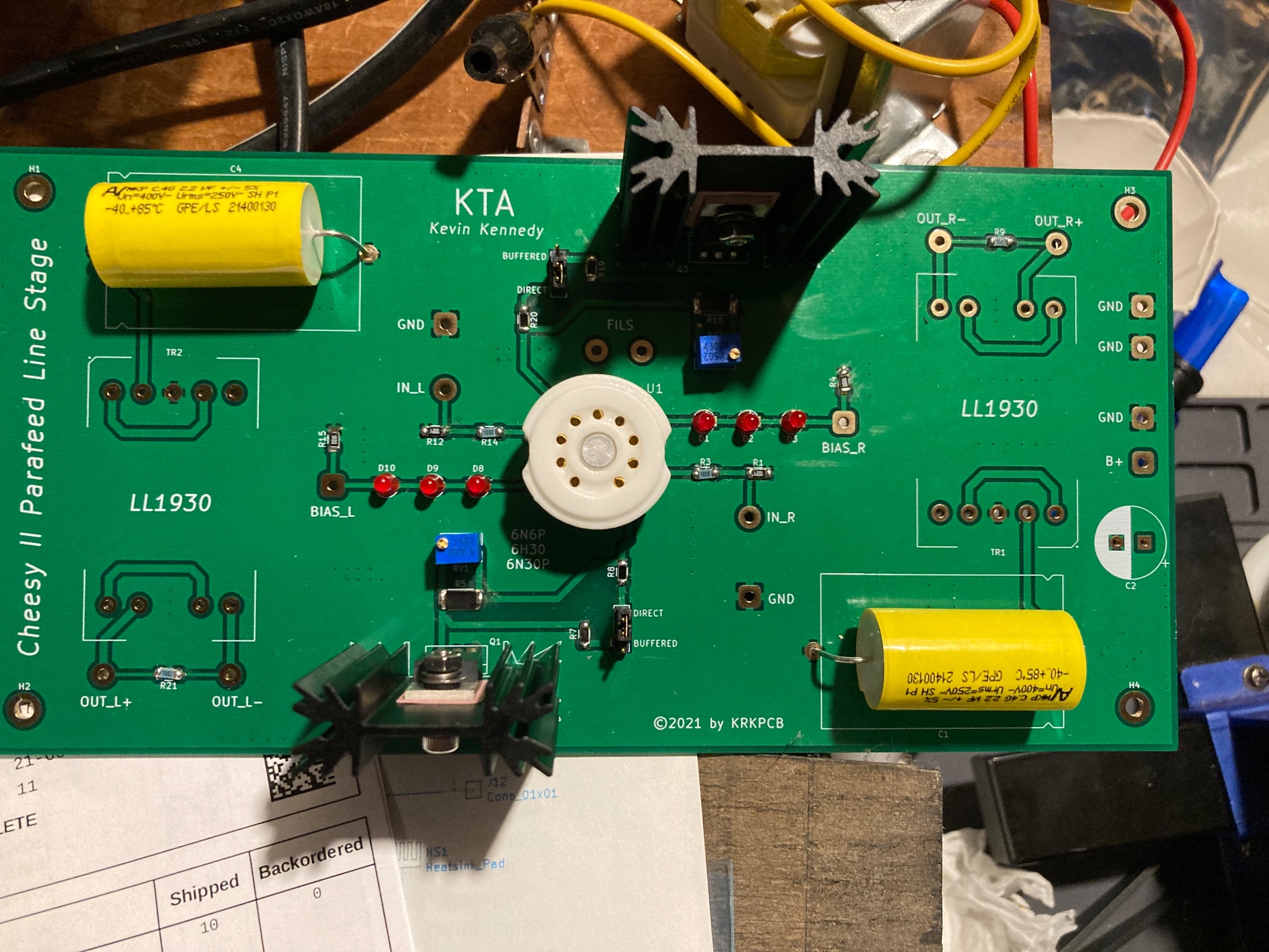

Hey Kevin. Thanks! Unfortunately the C2 I was talking about is on the signal board, not the PS board. I have the two 47uF/350v caps on the PS board (C2 and C4). That board also has a C5 which is the 4700uF16v cap for the filament supply (somehow I got that as a 1000uF but will fix that). I am going to experiment with chokes in place of the resistor (R1) between the two 47uF filter caps. So for all that I'm OK. But the signal board shows a single C2 cap right at the input (see attached image, to the right). If that is redundant to the C2 on the PS board, I can leave it out (should work fine with out it other than any filtering/decoupling it would provide).

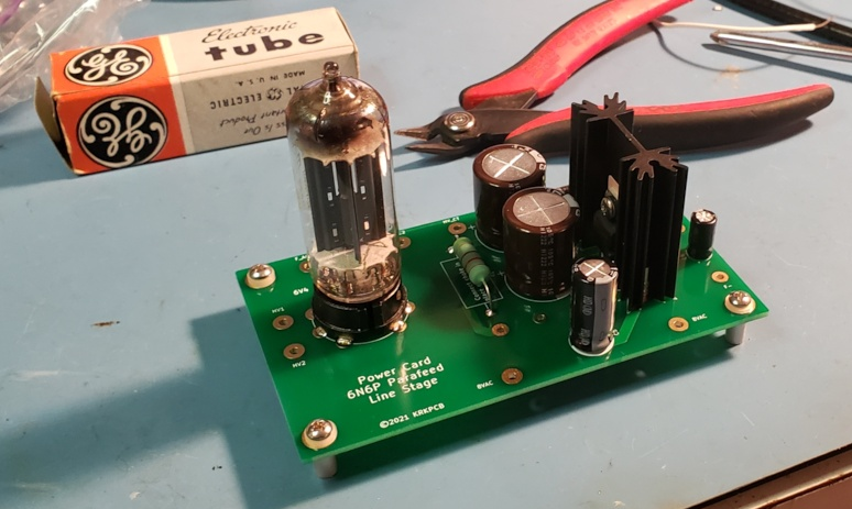

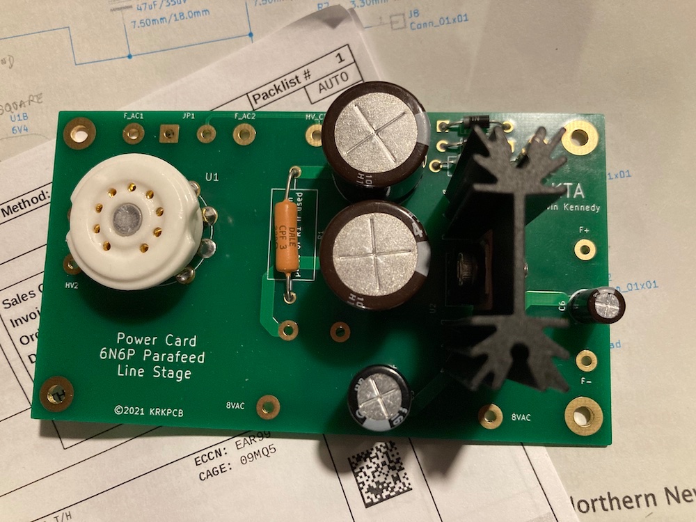

BTW, here's the PS board with the C2 and C4 filter caps in place already, on either side of R1 and to the left of the L7806 regulator with heat sink. Below that is the 1000uF I have in C5 which I need to replace with an appropriate 4700uF cap. I hope this illustrates my question.

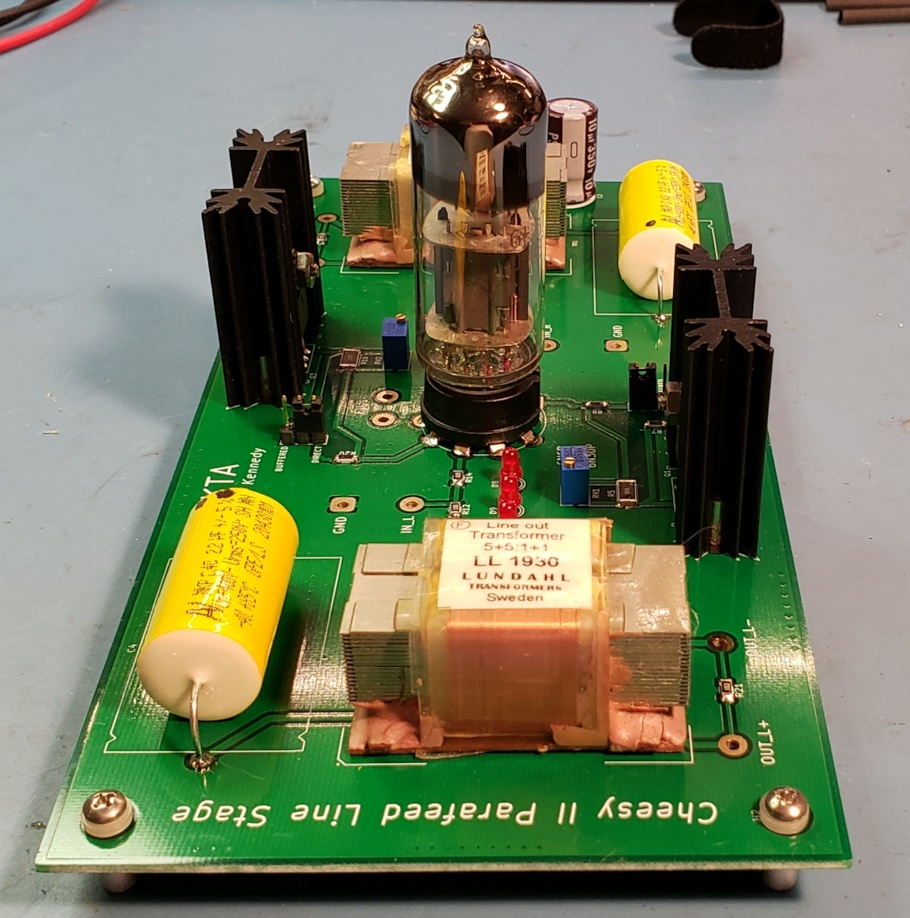

One last question (for you or others who have built it). In the schematic I don't see a POT on the input. I see a 100R at the grid (what I THINK might be a "grid stopper") and a 1M which seems to be a "grid leak" resistor. I see no indication of a POT, but I admit I may have missed something in the discussion leading up to this point (on or off of this thread). In any case I'll use a 50k as you suggest above. I think I have something decent to use. I think I'm getting closer.
The pot is on the front panel and is not part of the board. Some interpretation of design requirements is required. The 100R is indeed a grid stopper and the 1M resistor is there to keep the grid circuit from going open circuit in the event of an intermittent pot wiper or in the event that a stepped attenuator is used with break before make contacts which would make a very bad pop sans that resistor.

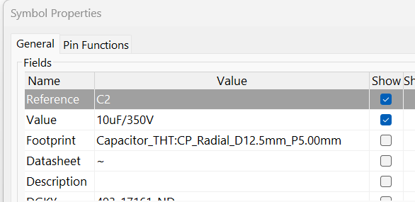

On the line stage board. Note that C2 is not redundant and should not be left out, it provides local decoupling on the board which becomes more critical as you plan to mount the supply outboard and connect with some length of wiring. You don't really want to see what sort of oscillations you might get from the CCS without it due to wiring inductance.
C2 Lead spacing 5mm diameter up to 12.5mm

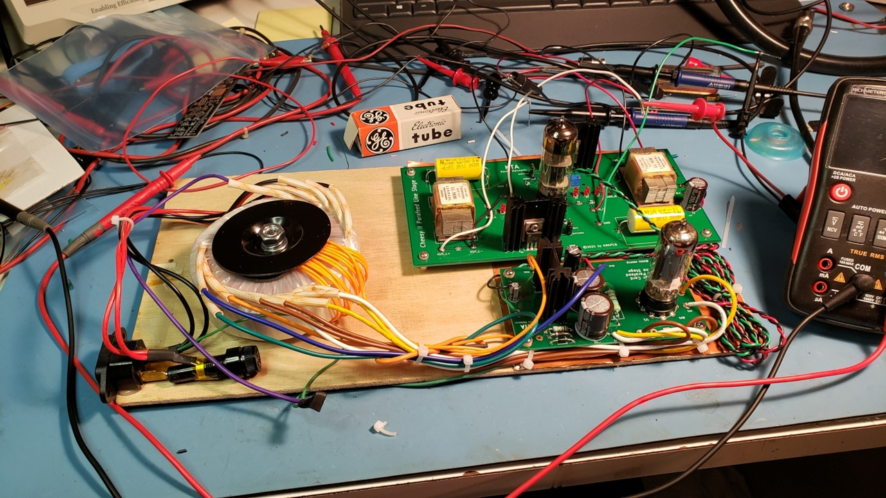

Note that R1 on the PSU is definitely cold soldered, neither lead looks good. Might want to check the others.

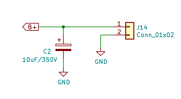

I don't have any schematic showing J14 and C2, and my BOM from you doesn't have anything for this C2 (at least that I've seen). As for R1, the back side is nice and shiny on both joints, and on the front no solder is visible (even with magnification I don't see any).The pot is on the front panel and is not part of the board. Some interpretation of design requirements is required. The 100R is indeed a grid stopper and the 1M resistor is there to keep the grid circuit from going open circuit in the event of an intermittent pot wiper or in the event that a stepped attenuator is used with break before make contacts which would make a very bad pop sans that resistor.

Kevin, I meant to add my thanks for providing the info about C2 and it's too late to edit now. I appreciate it!I don't have any schematic showing J14 and C2, and my BOM from you doesn't have anything for this C2 (at least that I've seen). As for R1, the back side is nice and shiny on both joints, and on the front no solder is visible (even with magnification I don't see any).
The classic definition of a cold solder joint, you do know that the solder is supposed to flow through the entire joint from bottom to top or vice-versa? So half soldered.I don't have any schematic showing J14 and C2, and my BOM from you doesn't have anything for this C2 (at least that I've seen). As for R1, the back side is nice and shiny on both joints, and on the front no solder is visible (even with magnification I don't see any).

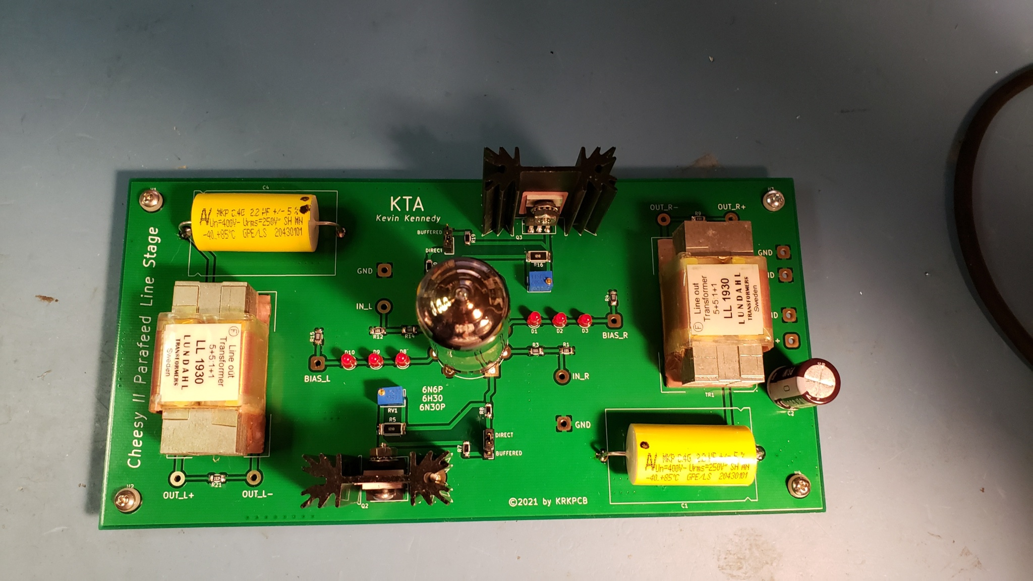

Please email me a copy of the documentation I sent you since something is wrong. This is the problem with waiting almost 3 years to put something together.. J4 is solder pads.

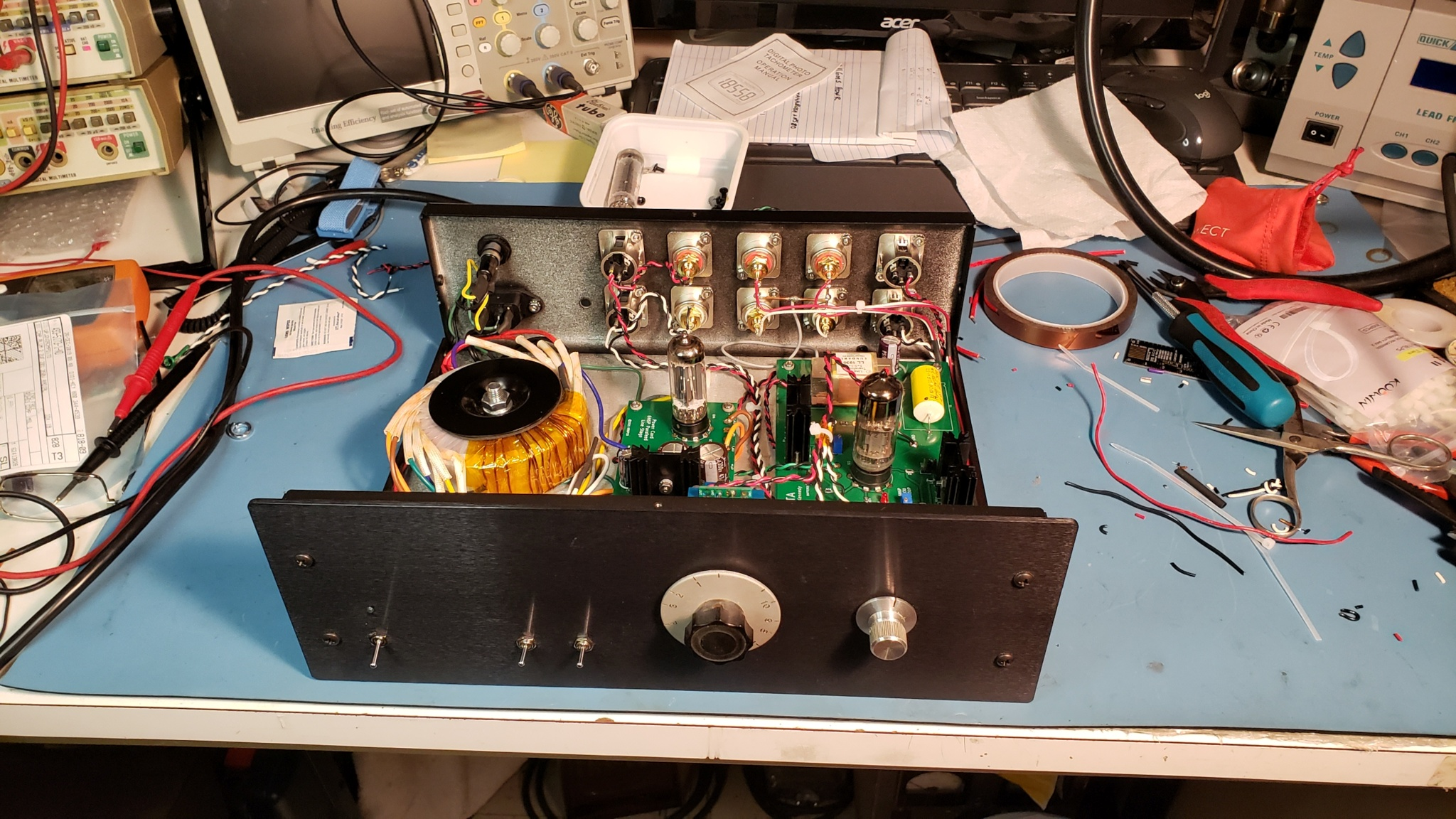

This is what the built up board should look like.

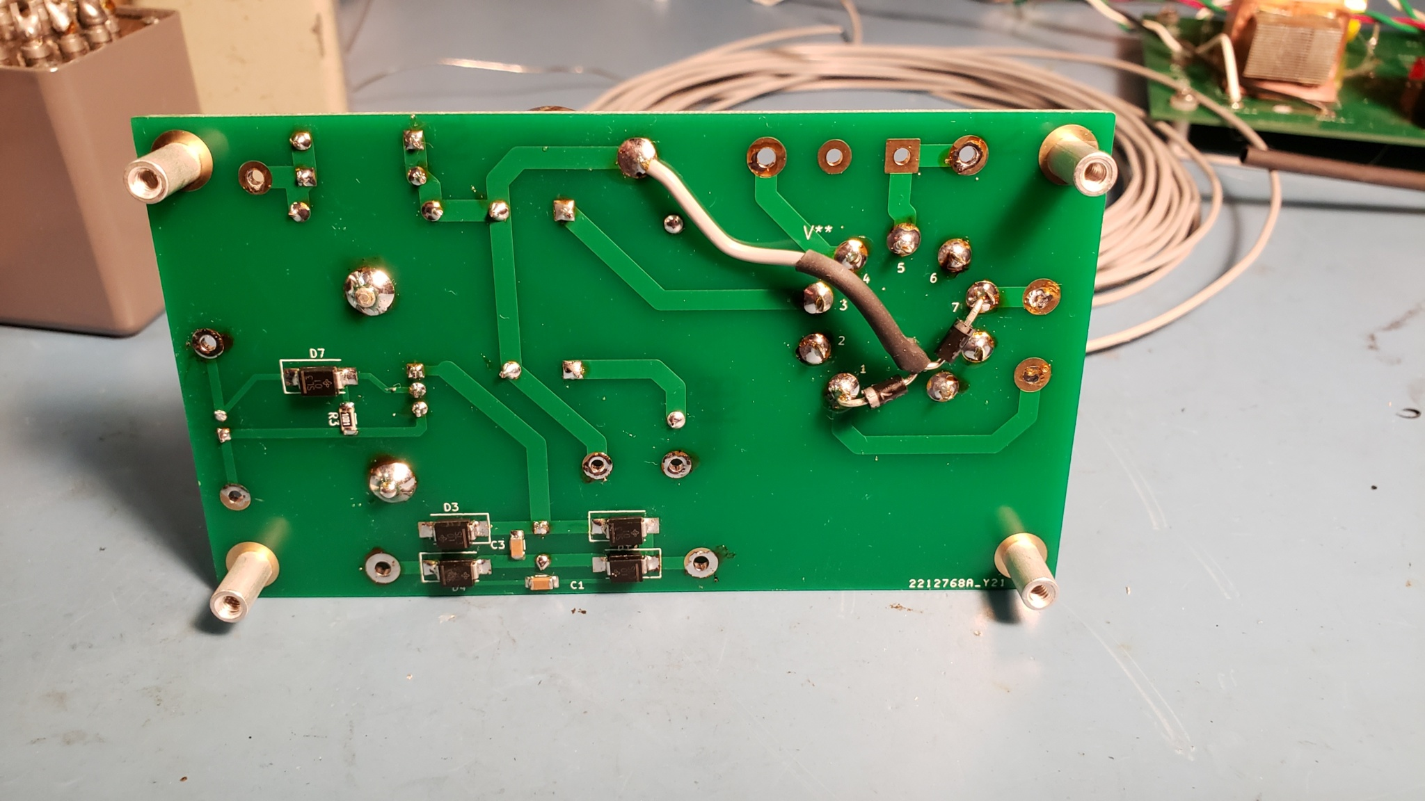

PSU rework for graetz bridge (for power transformer without center tap)
I did not know that it had to flow through. Hadn't really thought about it. I'd always just looked for good shiny joints well flowed around the lead and pad. I'll look back through the boards. I'll try to email you the materials I have. I think I have them from a few versions.The classic definition of a cold solder joint, you do know that the solder is supposed to flow through the entire joint from bottom to top or vice-versa? So half soldered.
