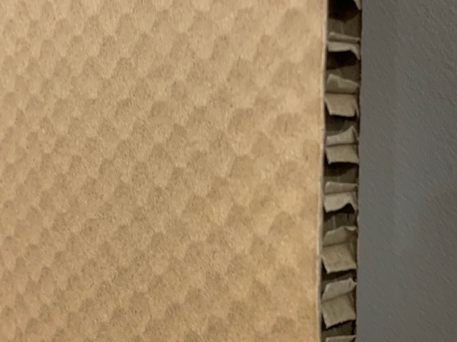

I think I just scored a major find on a potential DML panel material. I got a large mirror delivered the other day. The box had a 76in x 32in x 15mm thick brown paper faced honeycomb core material to protect the mirror inside the box. It is huge, very stiff and light weight. If we like the sound of paper cone drivers, this just might be the thing. I want a pair of stereo panels. Should I cut length wise for two 76in tall x 16in wide panels for a "Tall Brunette" speaker? Or the other way at 38in x 32in pair of panels? I think the tall ones will get deeper bass from what I have read. Has anyone else tried cardboard honeycomb?

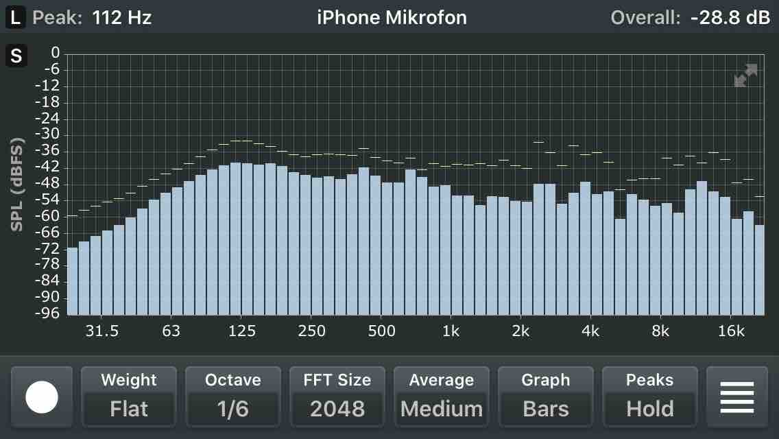

Did you made any tests and work with your boards?
this week I've worked on a kind of honeycomb board like yours. It is not that stiff as my other cardboard honeycomb boards. One difference is the type of layer. It is made of Craft/Kraft paper. The cardboard honeycomb with screw mounted exciter sounds in mids and highs very detailed and super clear, it remembers me of the old Quad ESL, but lacking the body. The paper honeycomb lacked in details but tonally is much better balanced for me. So I decided to work on the softer sounding board.
After trying to make them stiffer with a kind of 'papier mache' (modified rice glue), I decided later to take away the layers and made one side with paper and rice glue (mixed with paper and cardboard), because a bigger part of the before soaked layer did not make good contact with the honeycomb structure.
I've now one side open (with the honeycomb structure) and one side with a new layer (picture). The exciter mounted on each side and listening tests of all four sides showed the exciter on the layer side and the ear on the open side as best for me. The sound has some details, voice is again in front as well instruments with percussive sounds. Electronic Organ, acoustic and electric bass has a good body. The efficiency overall is much less than with the cardboard panels but still no problem with an 8 Watts amp.
I think there is a good potential for me to work and improve stiffness on the layer side and partially on the open honeycomb (esthetically a must as you can see;-)

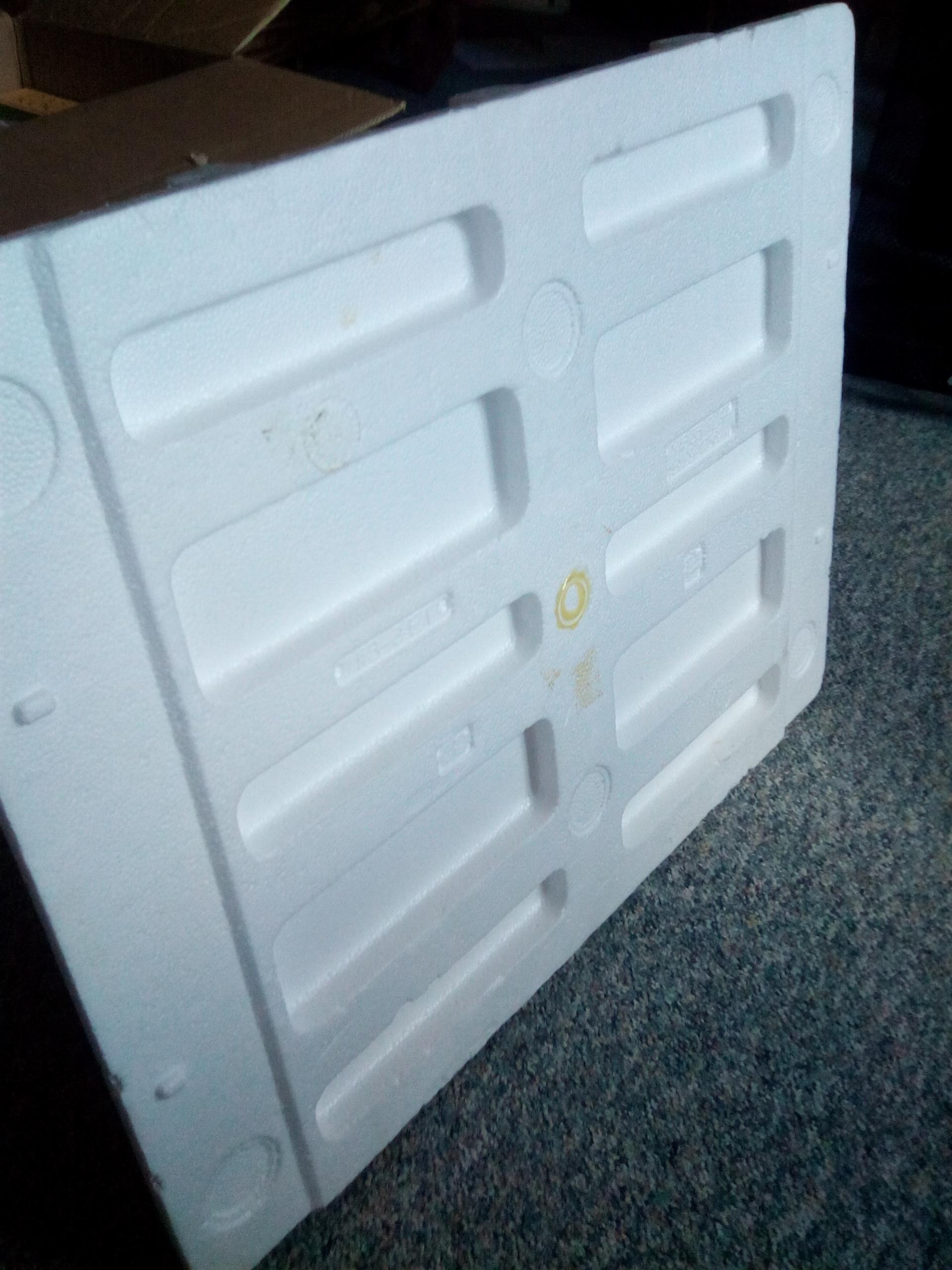

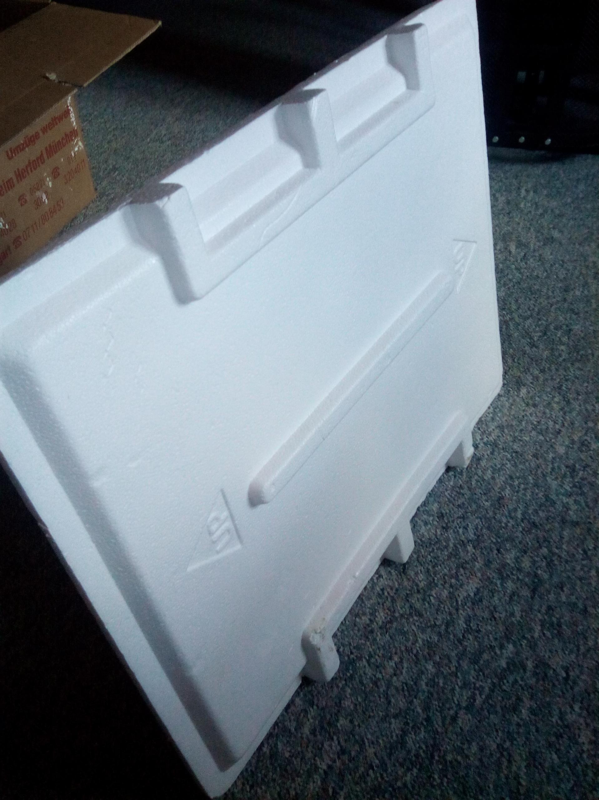

Another thing I noticed, then I tried the packing styrofoam panel in the pictures, is that even though the over all sound wasn't that good it had significantly more LF output than a similar sized styrofaom panal with just a plain shape. For the people using XPS or EPS it might be worth trying to cut additional structure into the panels to see if it improves the output. Kinda like the bracings in for example a guitarr.
