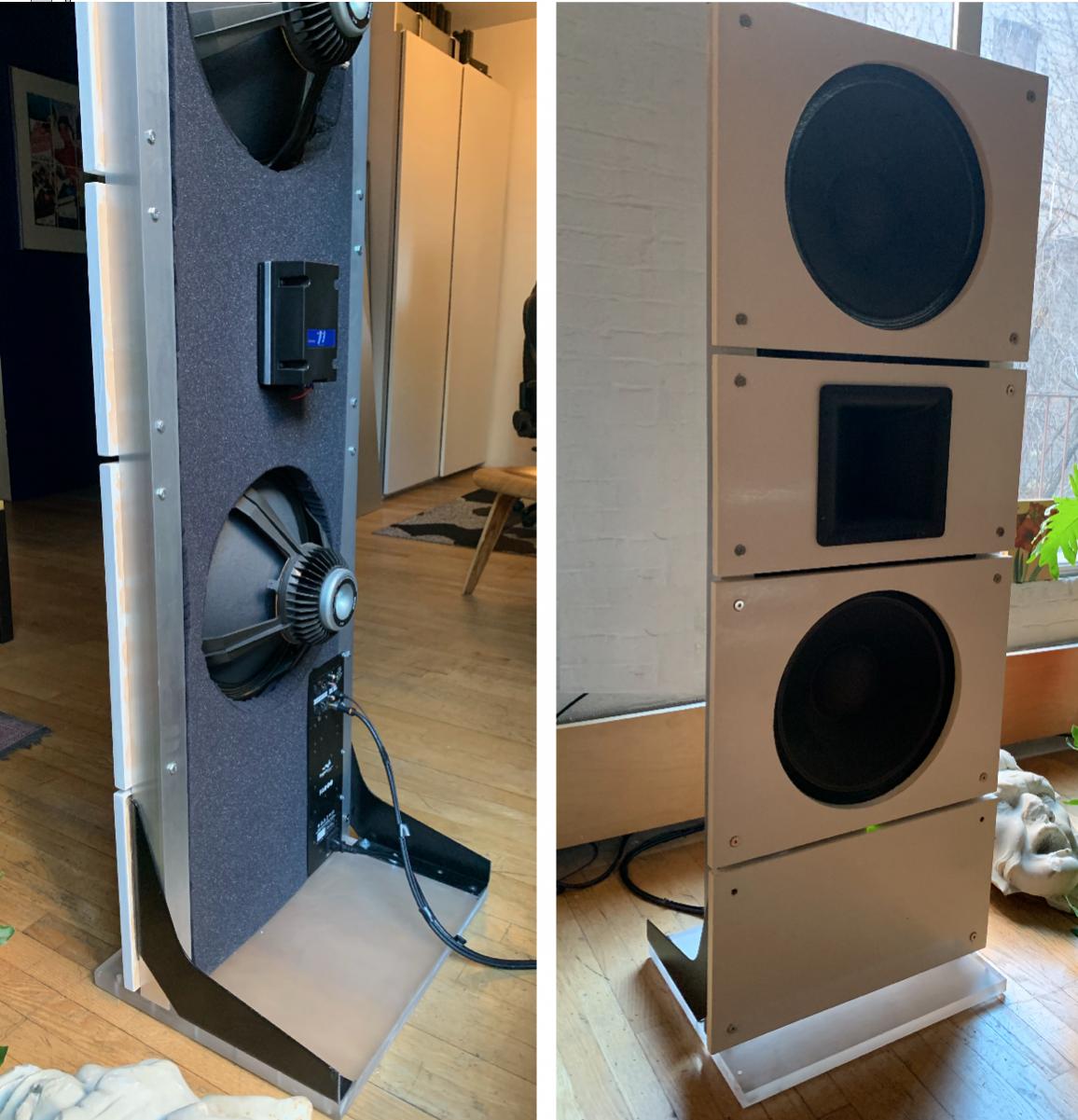

Thanks, I will try this method with just applying adhesive to the honeycomb first to make up one more CF panel with the leftover CF and buy one more piece of nomex honeycomb. I’m tempted to try aluminium honeycomb, but thinking about making some lxmini +2 for my living room and use the CF panels as monitors for my digital piano. This was what put me on my original DML quest, as the piano doesn’t sound that great using Mackie 824 mk2’s. If they sound good on the piano, I’ll sell the mackie monitors to buy a sub for the panels.
Eric --
Thanks for the thoughts. The synergies of this discussion thread and the panels leaning against my wall have me thrilled in a way that I first had when I started building my first Nelson Pass A/40 amps from the Audio Amature article back in the 1980s or so ;-)
Some thoughts
With panels 70 3/4" high x 20 1/4" wide I've got 13.88 square feet of surface area.
I conjecture that this should push a lot of air and give me pretty extended low frequency response.
The rigidity vs weight should give me speed of response to get the higher frequencies.
Progress
I've already started taking apart my main system to start modifying it to hold the aluminum panels.
It uses 2" x "2 aluminum square tube uprights that have 1/4" think walls and liking composite materials, I forced 1 1/2" poplar into the tubes. Super rigid. (see attached)
Still working out the suspension/mounting of the panels.
Exciters on their way!
I think I have everything else I need.

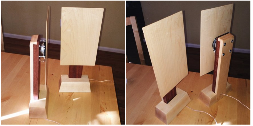

Also, I came across this desktop sized DML project on a woodworking site: Wooden Speakers - by TheFritz @ LumberJocks.com ~ woodworking community
See attached photos.
This project hangs the panels from the exciters. No other suspension of the panel required.
Likely unworkable for anything much larger, but someone might take the idea somewhere.
