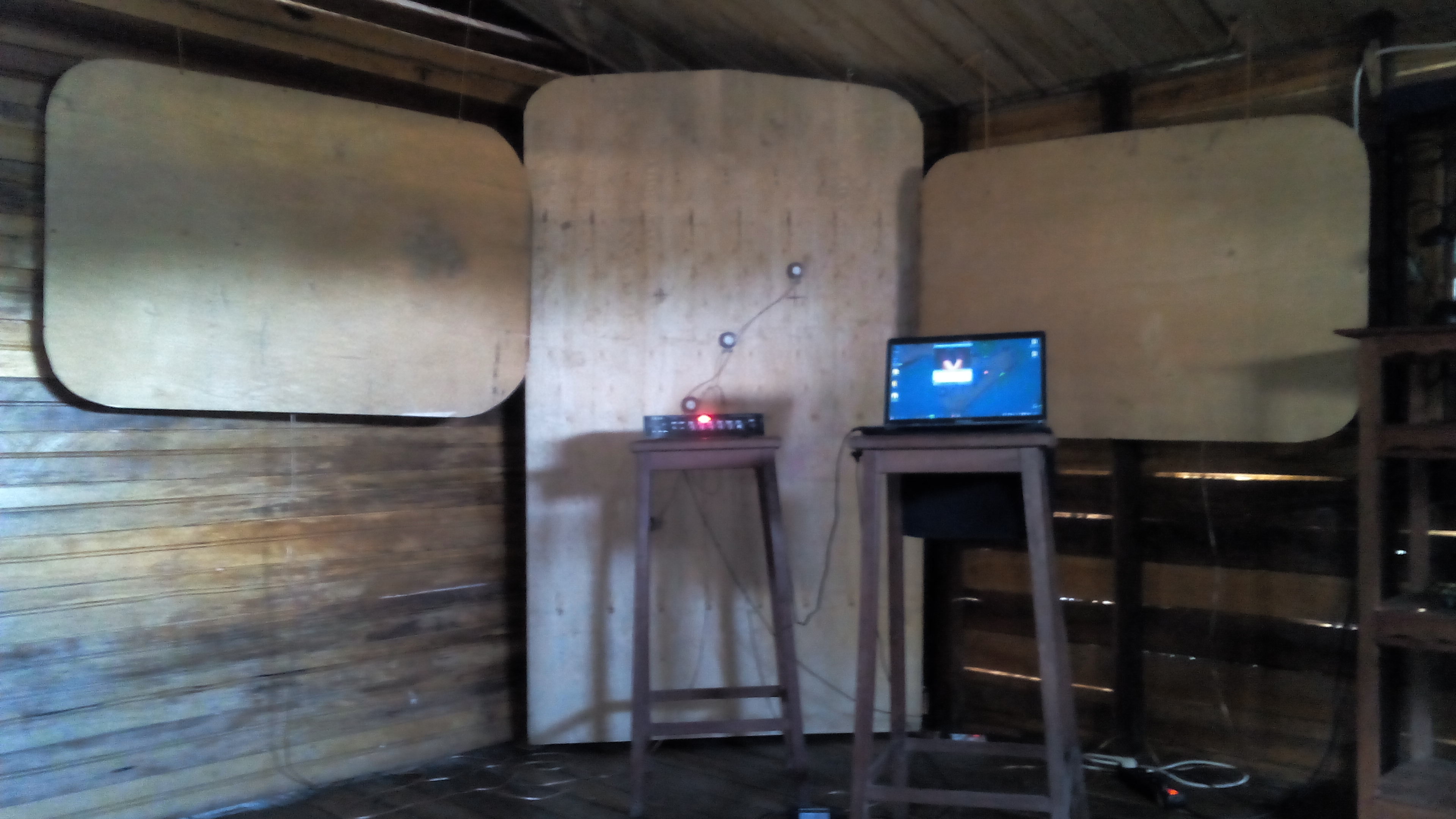

After having my interest in DMLs rekindled on another thread, I began to wonder if we know much about the frequency response of these panels at the extreme ends of the spectrum, which I define as below 100 Hz and above 10,000 Hz. Some have noted that larger panels give better bass response, but I have not encountered any generalizations in regard to high frequencies. Can anyone point me to references which show the measurements of DML panels?
From my experience it works following: heavy panel, thick panel, flabby panel, heavy motor, motor with large contact to panel won't do highs.
On the other side: small panel, resonant panel will sound awful, any cheap PC speaker could do a better job.
There is also a question of adaptation to air impedance, a small surface cannot have a low acoustic impedance, thus efficiency stay low. (=zero bass). As the surface of radiation increase, say above 1 or 2 m², you get full benefits of DML, more modes, more bass, less directivity, better efficiency.
I am now around the 5m² range, waiting to find bigger panels up to 8m², the maximum surface allowed by my listening room. When the radiation surface comes close to the section surface of the room, the room begin to work as a wave guide, less reflexions, less distance attenuation, huge sound.
If I were to build a DML panel I would need to use it against a wall due to space restrictions. Should some kind of acoustic damping material be placed behind the speaker to limit that back-panel energy? And, is it best to terminate the edges of a DML in a stiff frame to limit the motion of those edges as well as provide mounting for the panel?
Thanks to all who can help me with these questions.
you can put a panel quite close to the back wall if you pay attention not to do it parallel to the wall. And NOTHING should touch the panel (wires, frame, damping material)
It"s far better to make inequally rounded corners of your panels or make them "random" (sawtooth) in order to reduce standing wave inside the panel.
I would avoid the stiff frame who needs lots of care to avoid any parasitic vibration, no frame=no problem.
My panels are suspended from ceiling with small gauge nylon ropes, (yes, I'm single, in a wood cabin, in the wild)
Last important thing, you can put the motor(s) anywhere on the panel, you'll always get some nice sound, but don't name it "Distributed Mode Loudspeaker". I mean central placement and equidistance, as many have done, have few to do with DML. DML is a very special kind of beast.

5m2 ??? With that amount of surface area any thing should sound good. If I where aloud to make 5 m2 I would make an Esl![]()
yes, but 5m² of ESL would cost you an arm and an eye,
5m² with DML is about 100€...
