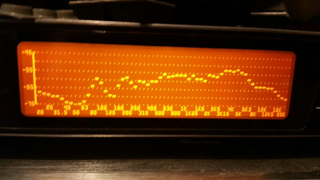

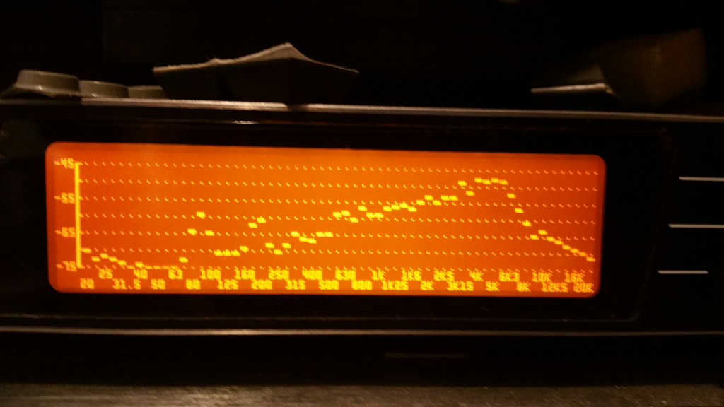

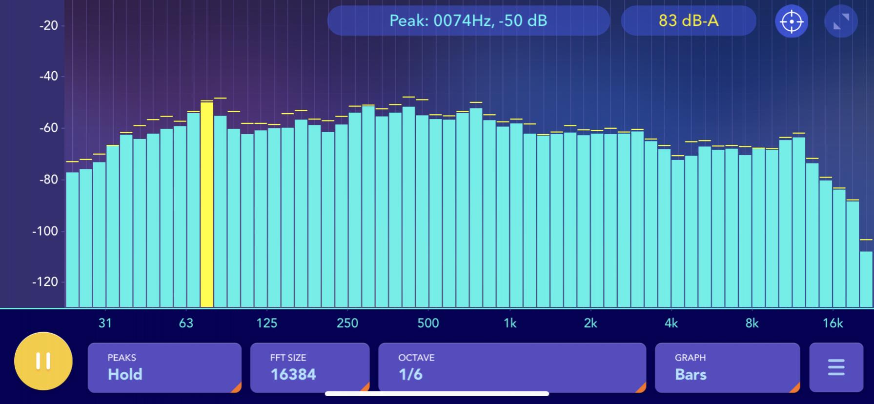

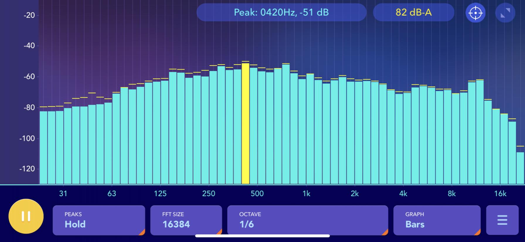

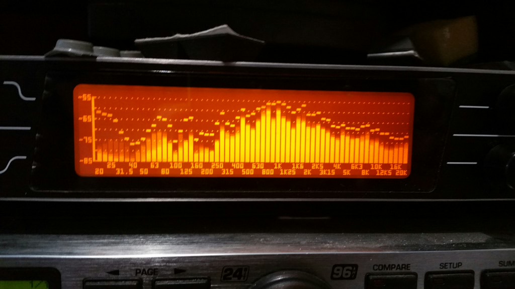

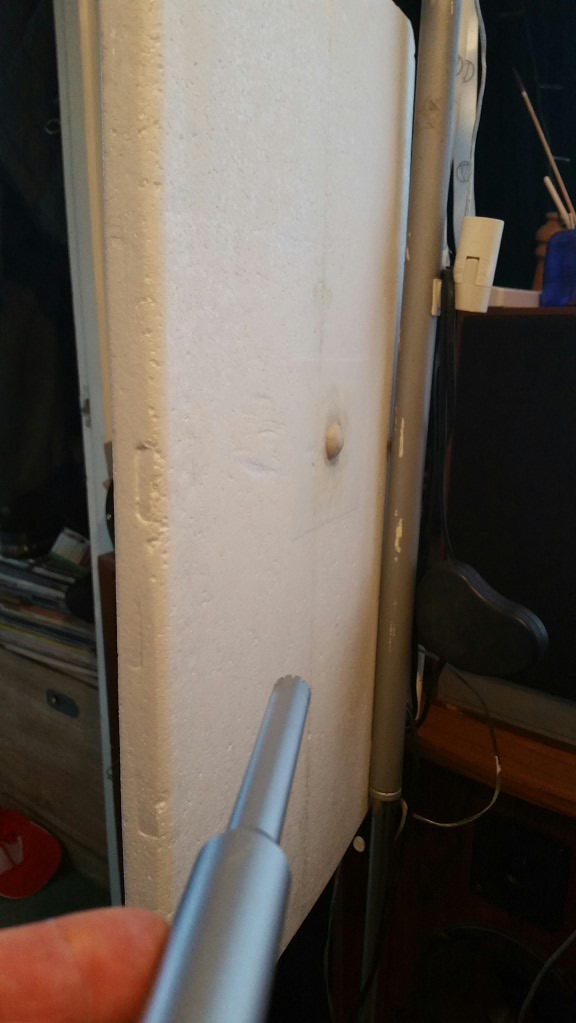

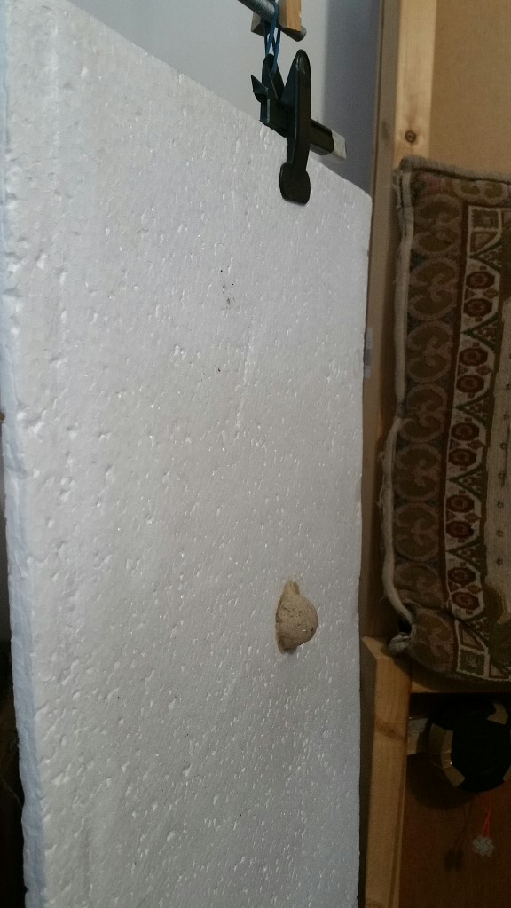

This is my latest test dome , I used an old 1cm x 23inchesx 14inches low density eps panel with some 50x50 eps coating.
I got a little carried away with the dome but I was trying to fill a large hole that was in the panel.
So the dome Is an inch and a half ,which covers the hole nicely.
Sorry i don't have the original response of the panel.

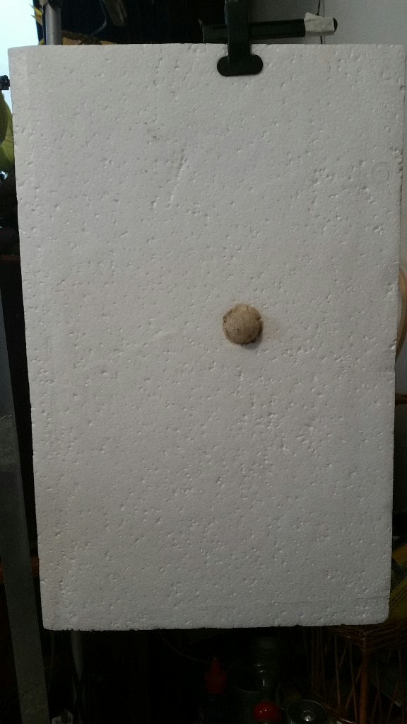

The first two pics are of the eps panel and large dome.
The third is the full range response of the eps panel and dome with a midrange hump, the dome is less efficient than the eps so I used a little EQ.

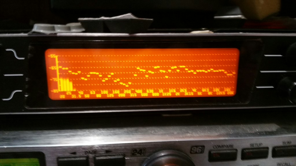

The fourth pic is the response after EQ .

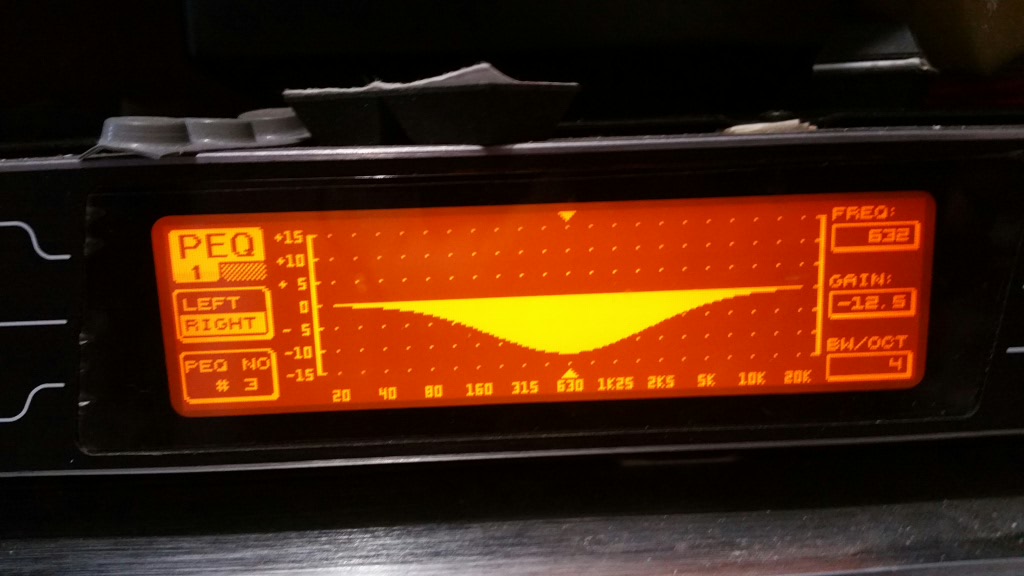

The fifth pic is the simple EQ used.
Personally I would not use this much EQ as I prefer a little more umph in the lower midrange to give more warmth.
I just quickly took a photo of the veneer panel with dome response which has no EQ for comparison, this will be very similar to the eps panel when the 200hz cross over is applied.
All measurements are taken from 3mtrs into the room in my seating position so this is the worst case scenario.
Steve.
The dome by the way is a very fine muslin cloth coated in my 50x50 pva mix which is breathable but also stiffens the dome.
I have not done tests on other types of panel's with the muslin yet , but would expect better results as the efficiency of the dome would match them better.
For me it's not about the hf so much as what it prevents.

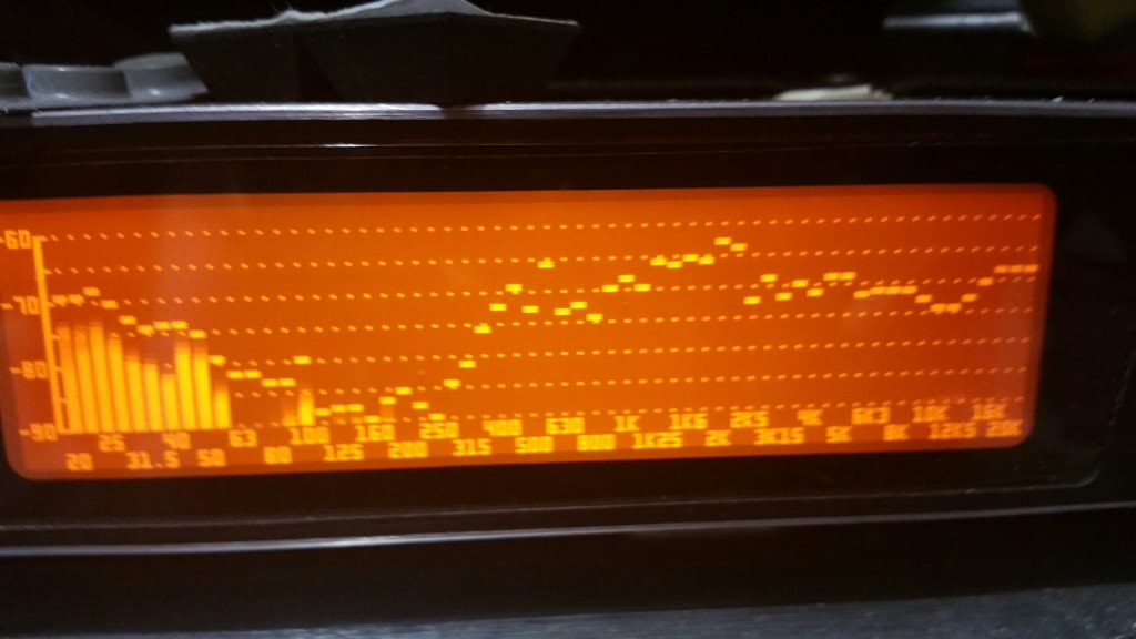

Coming back to an old problem, these pics are of a 1inch thick eps I made out of two smaller panels.
I mentioned at the time it was beaming heavily to the sides , so I had to place pillows on the wall to stop the reflections.
My 5mm panel of similar size does not suffer this problem?
The first pic shows the offending panel and the angle at which the microphone was placed.
The measurements were taken at 2ft, but they were very similar in the middle of the room.
The second picture shows the front response.
The third picture shows the response from left angle.
As I said in my previous post, this response from the side can be very painful sometimes,especially if the panel is placed near a side wall.
I intend to do a little more investigation into this problem in conjunction with the dome.
I was hoping the dome might help cure this problem and smooth it out a little ,although there seems to be very little cavity noise , but I have not looked into this as yet , as I said I've got a little side tracked again😀
This is the reason I prefer to take multiple point microphone measurements to make sure I get the whole picture of what is going on.
But usually I just wave the microphone around the panel and watch what is happening in real time.
It's so much easier.
Steve.
Ps.
I forgot to mention that the peak from the side angle is about 5db higher than from the front ,this could be because the the side of the panel is close to the microphone?
Although the peak happens 3mtrs into the room as well (just measured it)

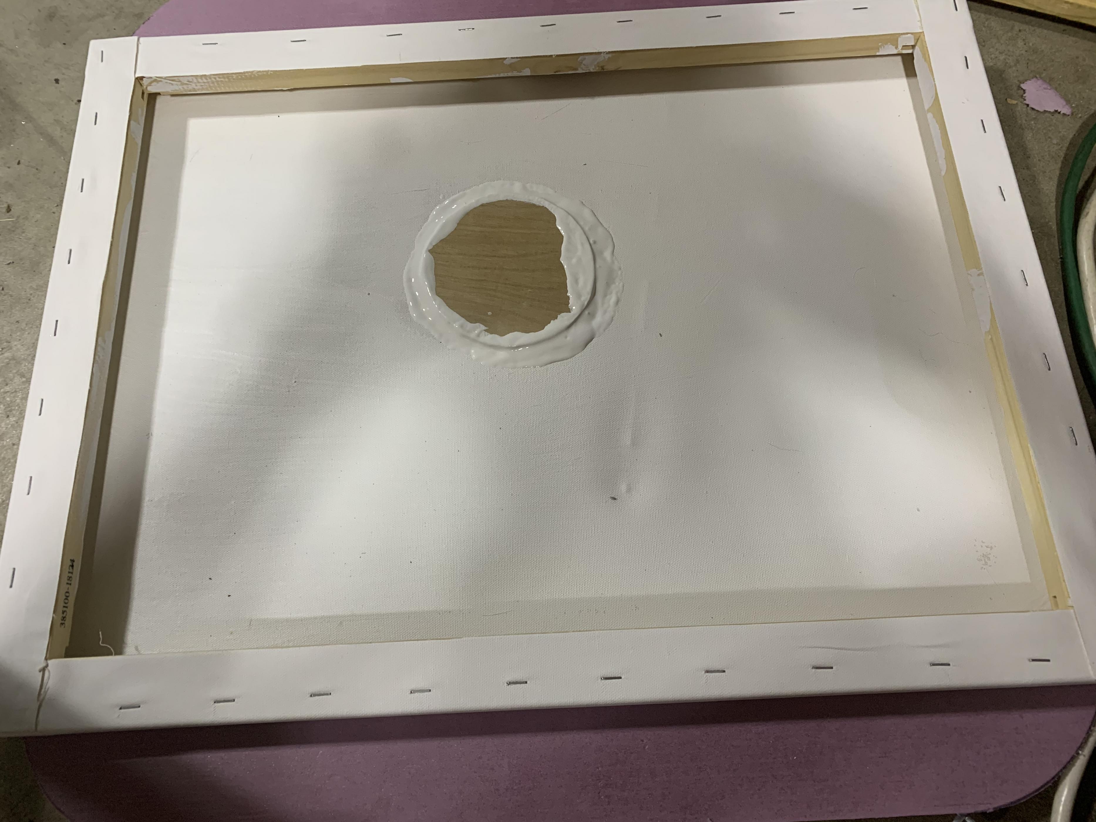

I love the sound of picture canvas speakers they are 18x24 and sound amazing with a nice flat response curve. Now Im thinking of doing the same thing with some much larger canvas that are 30x46.

Is a standard dayton 40w exciter gonna be enough for these large 30x46 inch canvas?
First pic is the response with no sub and the second response is with the sub turned on, I coated the back with pva primer and a small balsa wood panel for the exciter to mount to.
Hi 57Buick,
That measured response looks really good! I don't think 30x 46in is too big for 1 exciter but it doesn't hurt to have two. Position them according to the standard practice guidlines for multi-exciters. (at 1/5th increments along each axis?)
Ceiling mounted is an interesting 'big brother' talking to you concept. You should try it.
My receiver is capable of running 8ohms or set it to 6ohm which the manual says I can run 4ohm speakers on that setting fine. SO trying to decided whether to do one or two. But I guess 2 would give it a little more power for those larger canvas for sure.
Honestly after listening to these canvas made picture DML I see no reason to ever use any other medium. They sound incredible and look good as is.

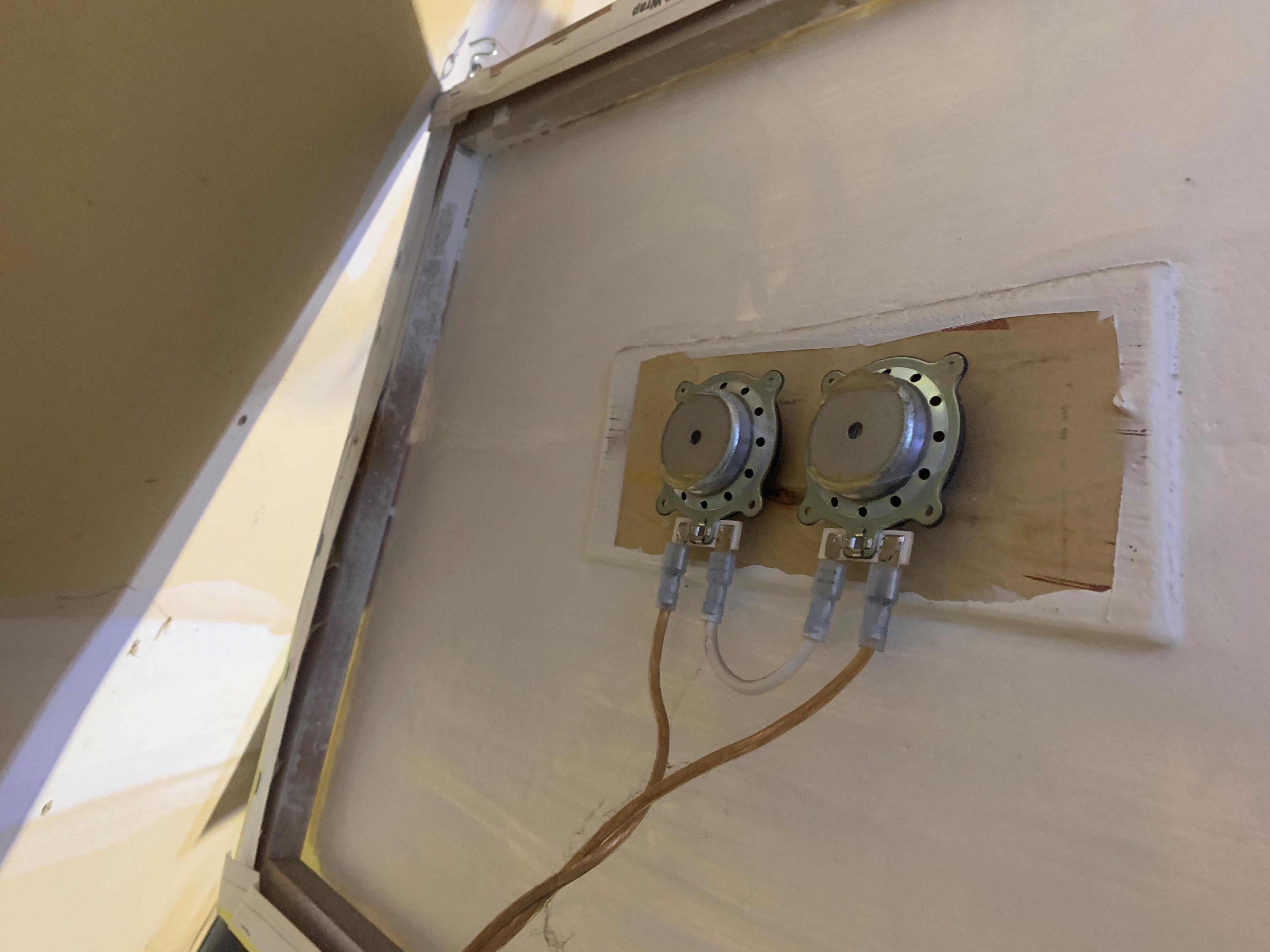

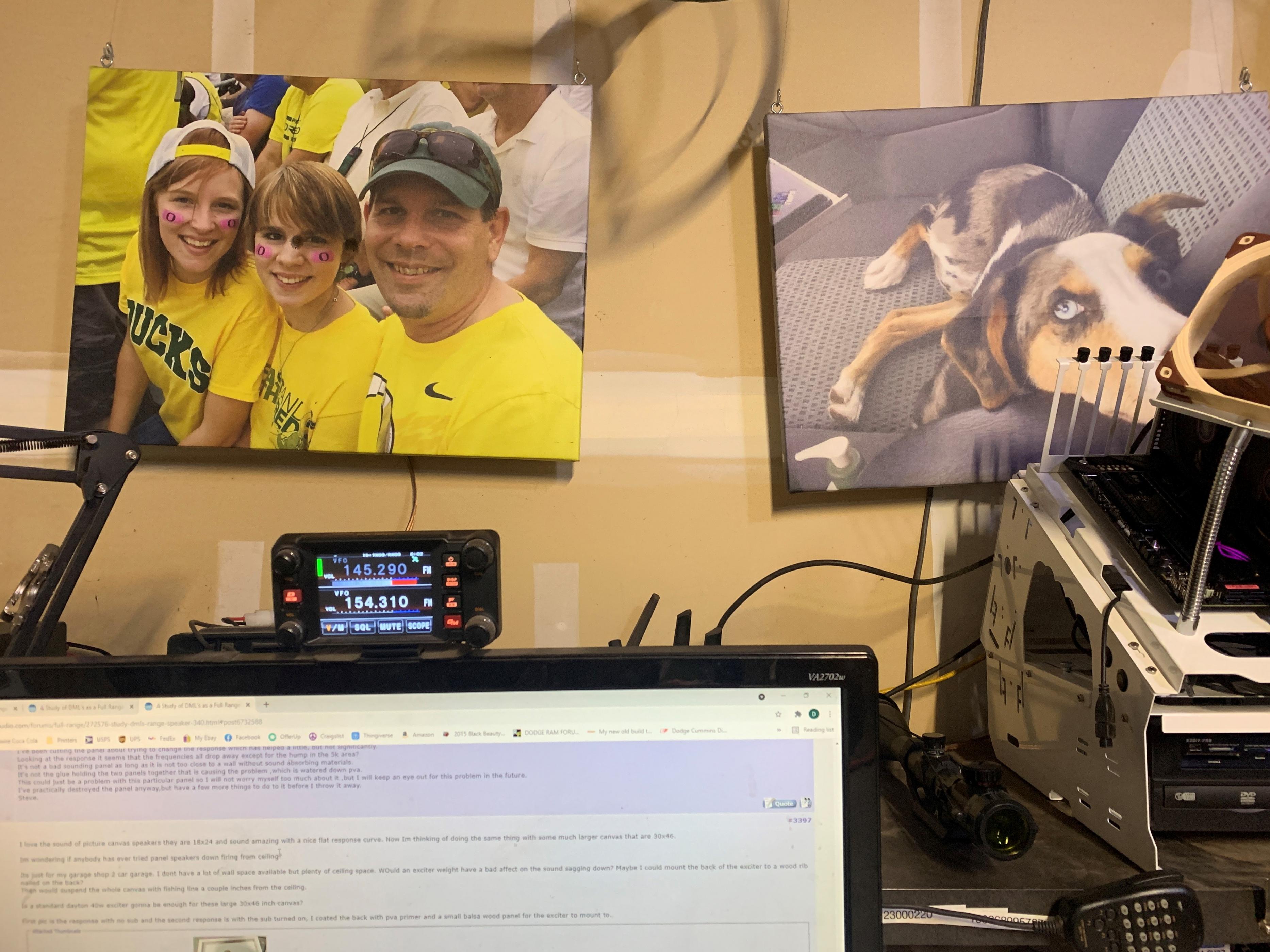

I used two exciters on these 18x24 canvas mounted to a thin piece of ply and coated the back with PVA primer
