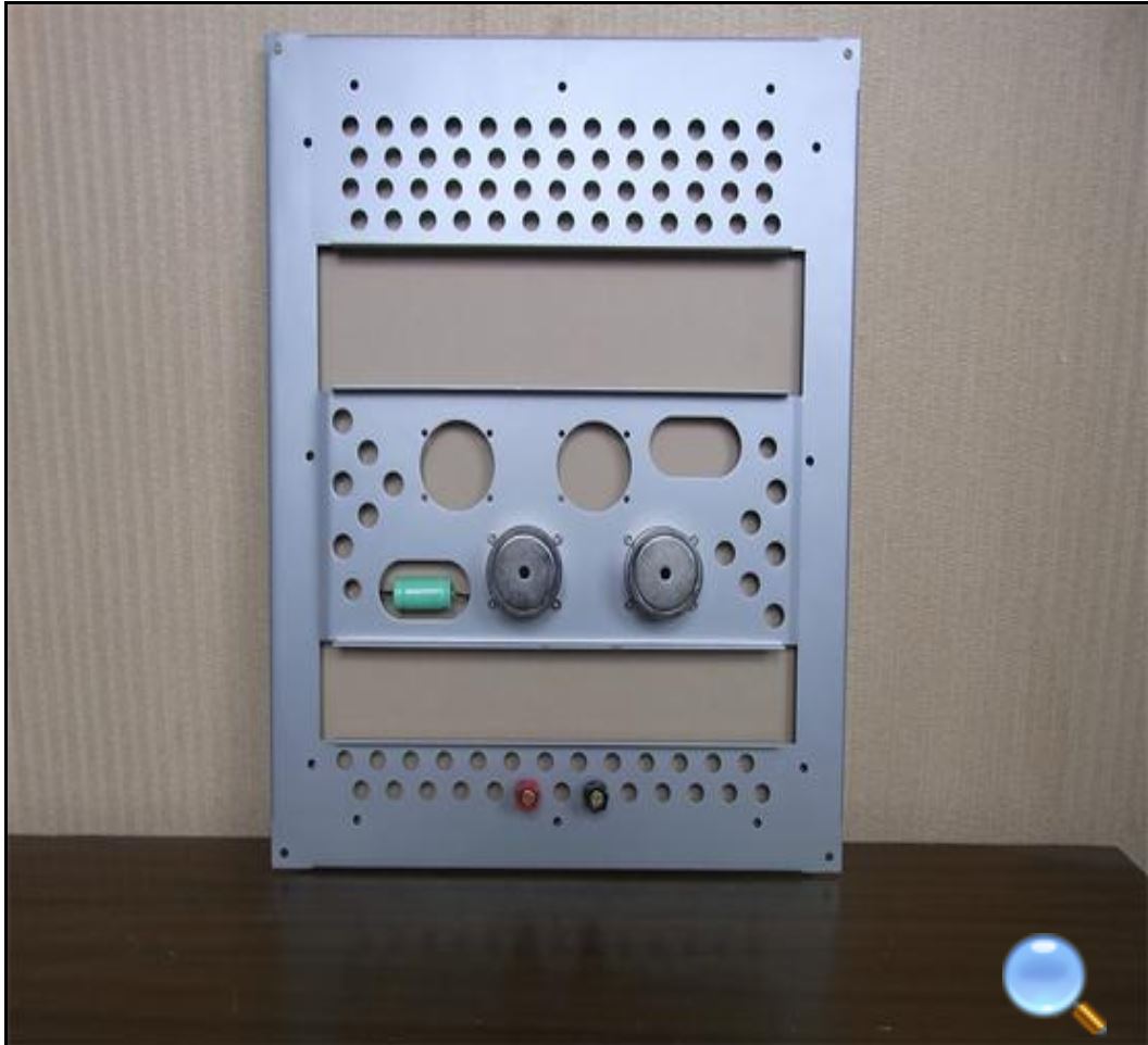

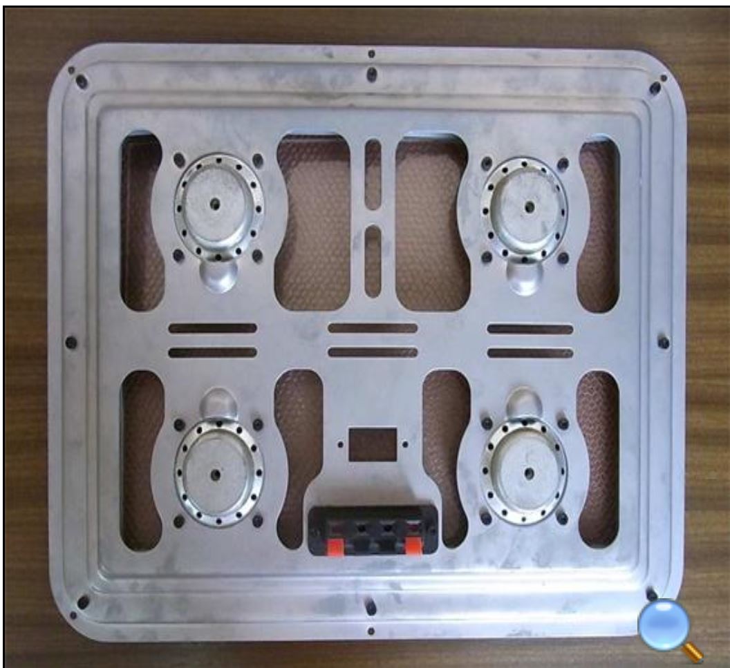

People can be happy with there results of not using a frame or spline. I never said otherwise. I am assuming you are talking about Rich M's P.E. DML project? Rich's design is a "beginner", intro into DML's. He does not use a frame nor a spline but he does not use strings either as his panels are suspended by stands with damping. I am curious as to what made Tech Ingredients hang his panels by strings even though he got the concept from Rich's design in which he mentions in his video since Rich's design does NOT use strings suspended from the ceiling.
Dayton just makes (PARTS) exciters...They DONT make (splines/brace) "DESIGNS", for the exciters as that is up to the DIYer.
No, you are mistaken as you are confusing the legs on a exciter to the mounting holes on certain exciters as they are two totally different things. Legs on the exciter act as extra support while the mounting holes are meant to mount the exciter to a brace or spline the same way one would mount a conventional cone speakers basket to a wood box. Mounting holes on certain (heavy robust) exciters prove that certain exciters are meant to be used and mounted on a spline/brace because they are using larger magnets and in return will have greater voice coil sag. Larger more heavier the magnet on a exciter will result in greater sag. Voice coil sag causes a lot of distortion as well as unevenness of the modal modes.
What other evidence? All the evidence points to and supports the use of a frame and a spline/brace both by DIY enthusiast and Commercialized DML manufacturers. Ive yet to HEAR the explanation/reasoning of the advantages of hanging a panel by a string. Exciters haven't changed much since NXT made them popular in the 90's.
Now you are speaking my language as its all about HANDS on EXPERIENCE and trying out all different types of ways and methods. What ever way sounds best to you is the way you should go. Good luck with your journey.
Billionsound makes the actuators for Dayton. If you look at Billinsound's web site you'll see they don't use a spline on their subwoofer. They use six of the RMB002511H13-BS exciters with sticky feet.
Subwoofer: http://www.billionsound.com/products_detail/productId=379.html
11H13 Exciter: http://www.billionsound.com/products_detail/productId=269.html

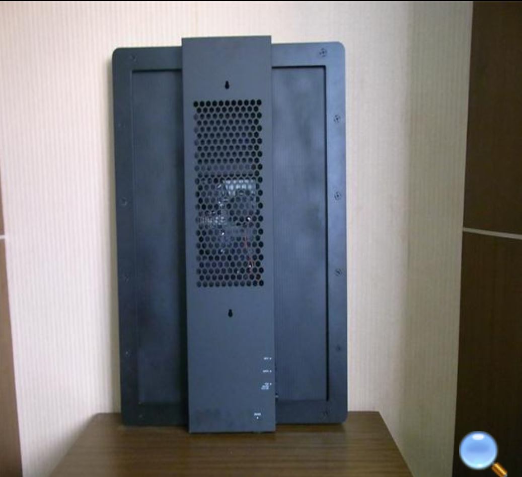

Their flat wall speaker RMF130913D16 uses a design with a spline.
Flat wall: http://www.billionsound.com/products_detail/productId=359.html
Exciter 12K09 (Dayton DAEX25FHE-4): 睿门企业有限公司
And this is how they use the 12K02 (Dayton DAEX25SHF-4)
http://www.billionsound.com/products_detail/productId=360.html
Here's their ceiling speaker with two 11L24 (DAEX25TP-4 Tripod Feet)
http://www.billionsound.com/products_detail/productId=453.html

If you have a question about how to use a Dayton exciter you can usually figure it out by checking Billionsound's web site.

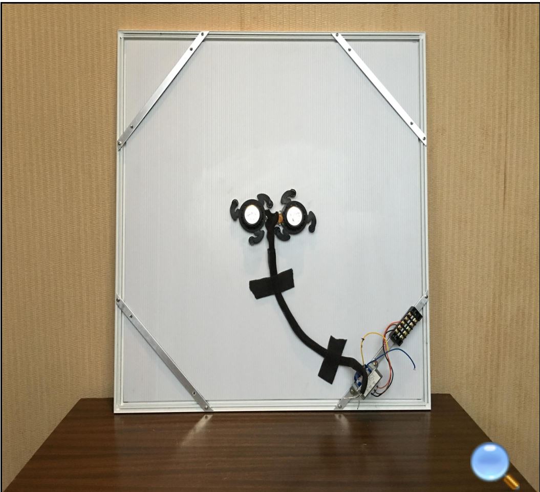

My Dayton DAEX32U-4 Ultra 32mm 20W 4 Ohm exciters arrived yesterday. I ordered four, with the tentative idea being to use two in each panel, wired to give 8 ohms resistance since my amp is designed for 8 ohms. I also ordered 4 of the cheaper DAEX25FHE-4, just to see if there was really much difference, but those are still on back order.
So, obviously I had to start playing around. I wired up just a single exciter and pressed it up against a bunch of different "panels". So far, I have not actually bought any materials to use for panels, but I have a bunch of stuff in the workshop to play with. The materials I tried included XPS (foamular 250), plywood (various sizes, types, thickness), aluminum sheet (about .030" thick) and foamcore, and corrugated cardboard. Most of the panels I tried were in the neighborhood of 2'x4', though I also tried smaller plywood and XPS panels too.
Without proper suspension for the panels and not wanting to actually attach the exciters to anything just yet, I had to figure out how to hold both the panel and exciter against each other without interfering too much with the interaction. What I settled on was placing one long edge of the panel on a foam covered seat, tilting it back slightly and letting the panel's weight push against the exciter (which I held in my hand). This worked pretty well for the heavier panels like plywood. For the lighter panels, I had to create a little more force to keep the panel and exciter in good contact. Initially I pushed against the face of the panel, opposite the exciter. But later I found that pulling gently toward the exciter on the top edge of the panel worked better.
With each of the panels I tried playing pink noise, doing a sine sweep, and playing actual music.
My intention was to look real time SPL spectrums while playing the pink noise, but unfortunately my "lab" (i.e. basement) is too noisy due to the HVAC system, so I gave up on the pink noise.
Here are my observations:
First I was really surprised about how similar the various materials sounded. Yes, there were big differences, but not nearly as big as I expected. Especially when playing the sine sweeps, and most especially above about 500 Hz. For virtually every panel, somewhere in the neighborhood of 500-1000 Hz, I stopped sensing the vibration of the exciter in my hand, but the sound really got loud and clear. And it was very difficult to tell where the sound was actually coming from! It was a strange feeling. All of them gave what seemed to me to be decent output up to about 11 Khz, where I stop hearing.
I was also surprised at how little difference the exciter location seems to matter. Sure, it mattered, but not like I expected. I've done a lot of experimenting with windchimes, and I know that striking a windchime at even slightly different locations can dramatically change its response. I thought the panels might be similarly affected. Rather, it seemed to make very little difference in the case of the panels. Yes, as the exciter got close to the edge, the output fell. But otherwise, it seemed like if the exciter was anywhere near, say, the middle third of the panel, it pretty much sound the same no matter where it was. I suspect the reason for the difference (between panels and winchimes) is because windchimes have far fewer natural frequencies and are virtually undamped, compared to panels.
I was also surprised at how little it mattered how I actually supported the panels. No matter whether I held on to the of edge of the panel near the center, or near the corner, or just let the panel rest against the exciter with no hand on top at all, the sound was pretty much the same.
Under these conditions, the panel whose sound I most preferred was plywood (0.2" thick "Sureply" underlayment). Thicker plywood was too quiet. Foamcore was my next favorite, and was louder than the plywood. The XPS was certainly loudest, but it sounded too much like it was coming from a tunnel. The aluminum wasn't as terrible as I expected, but did have some annoying ringing.
Next, I'm kind of eager to select a panel material and make a crude pair, just to see how they sound in stereo. I'm tempted to just try a pair of the plywood ones, but I may try some other panels first. Gatorboard seems really interesting, so I may try some of that first.
Any and all comments and suggestions would be appreciated!
Oh, and yes, DMLBES, the Ultra exciters indeed have a threaded hole in the center back, which I must assume is for mounting to a spline. Curiously the specs don't mention it and the drawing don't tell you what the thread is!
Eric

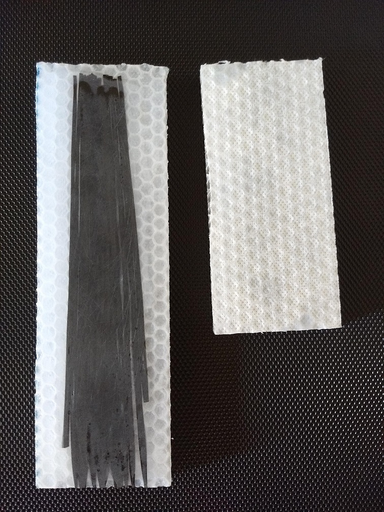

Billionsound uses different types of panel materials. Some are honeycomb core resin infused paper. Others are corrugated plastic sign board material. Two part resins will give you a hard surface. Glue gives a less hard surface. Panel material and treatment is relevant to the type of dampening you're trying to achieve so the right choice always depends on what you're trying to accomplish. I wanted a lot of internal dampening in my panels so I placed resin on only one side of a cloth covered poly-honeycomb core. But there's no right or best material for all panel designs. Just as you have flexibility in frames vs splines vs panel suspensions, you have flexibility in panel materials.

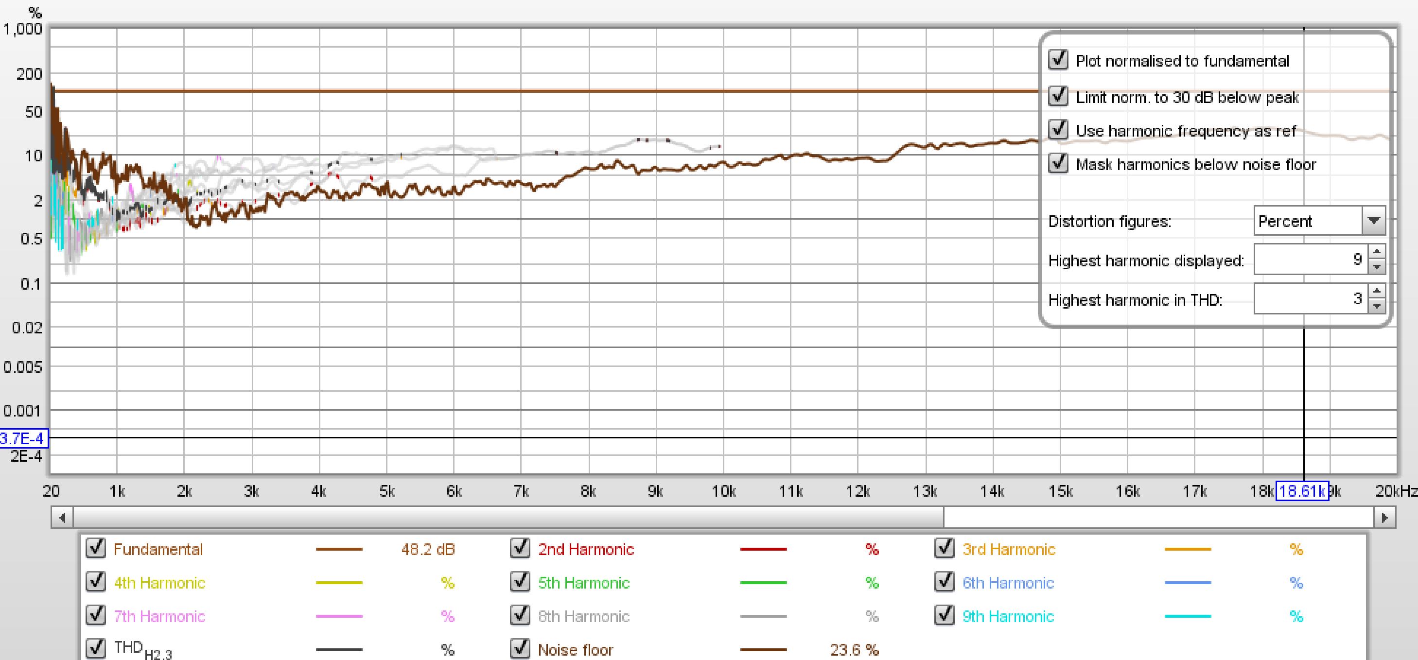

Distortion seems to be a common issue with DML speakers. And while I have not measured distortion for any of my panels yet, I'm pretty sure all my attempts have pretty high distortion, including panels of plywood, XPS and foamcore.
I just came across this patent application below, which claims much reduced distortion for panels made with aramid polyamide skins (Kevlar, etc), rather than carbon fiber, purportedly due it's higher damping qualities.
Anybody tried (DIY or commercial) panels with Kevlar or similar skins?
Eric

To reduce resonance/distortion use "DAMPING".
My method as mentioned before is using some sort of damping material like Frost King weather strip foam to adhere the panel to the frame all around the edges of the panel. This method reduces resonance/distortion the SAME WAY a conventional cone type of speaker uses a foam, rubber, and cloth surround on the "EDGES", of there diaphragm material using some type of adhesive (PVA water based glue adhesive) to attach the diaphragm material to the (frame) basket.

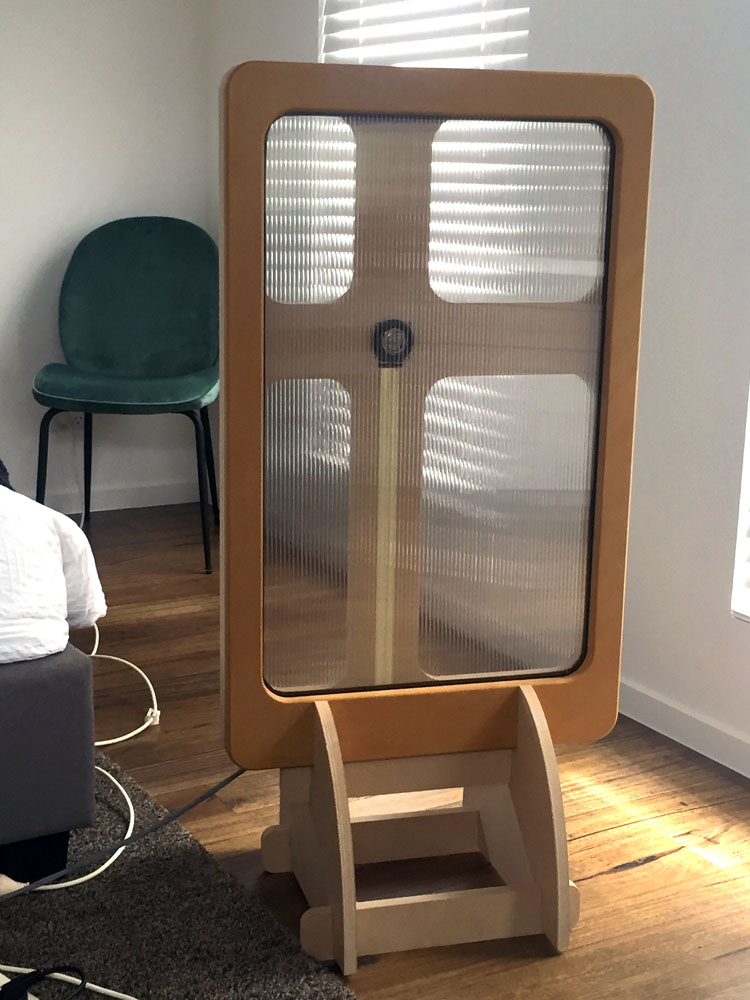

These are working well for me.
I gather there is a lot of (audio) science working here that I don't fully understand as yet, and probably never will. I have tried to follow the Golden Ratio with the design, but I am not sure if it adds anything or not as these are the only DML's I've heard. You can change the frequency responce by adding blobs of bluetack around the diaphram and I am still experimenting with this, and other things.
At the moment they are in the guest bedroom to give some space between the speakers and rear wall. In my usual listening room, due to WAF, they had to be placed too close to the rear wall to work their 'magic'. I am not sure if the bed between them is adding or subtracting anything from their performance. I gather it is damping the sound though. Will try in another location soon.
How do they sound? I think their characteristics are summed up, better or as well as I could, in these two reviews, which might already be referenced here.
