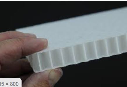

Posible panel material
Not sure if this is of intrest but may be worth a try, cheap and available on line in the uk 2400 x 1200 size
ThermHex - Made from a Polypropylene Honeycomb Core

![Thermahex.JPG Thermahex.JPG](https://www.diyaudio.com/community/data/attachments/722/722741-1beee0e516d31f23ca9fa9736c825f55.jpg)
