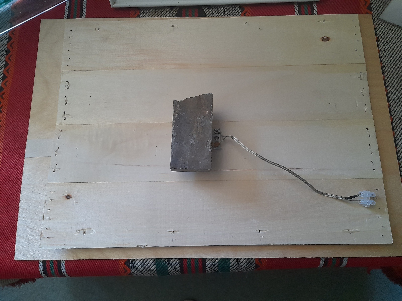

i just did another recording but with the larger 17x14inch crate ply.
with a more similar response ,it is not as strong in the low end, but is there.
I could make an even larger crate ply panel, but i think we are going to need more crates :D
both panels need a little work to bring up the performance a bit more .
i have an idea how to do this with the ply panels but am not sure what can be done with the proplex , as i am not used to dealing with flutes ?
luckily the proplex is pretty good sounding, to start with, maybe a little too soft and warm sounding for me ,but i am sure many will like that ?
it is all a matter of taste.
the crate ply has a little of the EPS sound I like , which is what surprised me about this material.

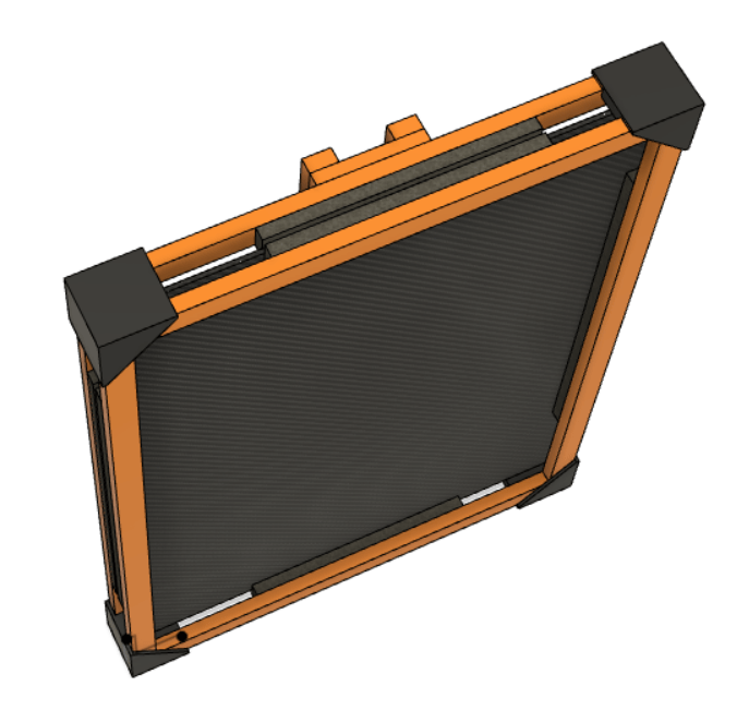

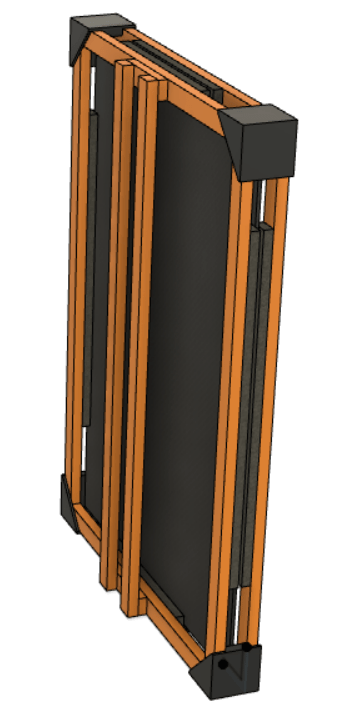

Started designing the frames that will hold the panels. Since I'm aiming for making 16 plates in quite a short time, I want something cheap and quick to build. Plan is to use use wood ribs with 3d printed corners to hold the frames together and space them apart enough to press the plate between foam strips:
Also have to figure out a way to mount 4 plates together with amp, preferably on top of a pole screwed on the subwoofers, but will anyway make protection tents for the stacks so could possibly hang them as well.

Leob,
I like your design. I built something similar when I first started DML's and wanted to test a lot of different panel materials. The sandwich frame made that easier. I just used four screws to squeeze the sandwich.
Are you thinking that you will build the individual frame halves first, and that the corner pieces will simply serve to squeeze the sandwich together? Or are you thinking that the corner pieces can also serve to connect the 4 ribs of each of the two frames too, so that you don't even need to glue/or screw the ribs together at all?
My only suggestion for now is that you may want to run the exciter support spines in the opposite direction (i.e the short direction) so they will be effectively stiffer and perhaps less likely to resonate as much on thier own. But whether or not that works for you may depend on your exciter placement.
I'm eager to see your progress, especially when you start actually making plates!

Thanks Eric!
Yes, the idea is that the corner pieces should be tight enough to only need small screws to hold them in place. I'm at least hoping that the compliance of the foam in combination with sufficient precision will hold the plates in place without needing screws for tightening, but I realize that can be a bit optimistic. But I will give it a shot and add a way of clamping more if needed.
Good call on the direction of the exciter support! Stiffer, lighter and cheaper :)
With many plates, every bit counts. It doesn't seem so much with 4 stacks with 4 plates, but then for example you look at buying corner brackets and think €2 a piece is not that much...until you realize that with 8 per plate you will need 128 of them in total.

Leob.
Your panel design does look very nice, but I would be very concerned about its rigidity.
for pro use, You are going to be putting a lot of energy into the exciter, panel and frame.
Any part of the frame and mounting that can vibrate , will vibrate.
Even the stand you mount the panels too, will vibrate if you are not careful.
I have problems putting 10watts into a panel , you will be using hundreds of watts.
Luckily I don't normally use frames (except for the canvas and rigid ply panels) but for pro use the exciter and panel need the protection and stability.
Your results will be very interesting.
Hopefully my thoughts are of some use.
Steve.

Yes, that is the major concern with how the design will hold up. I'm trying to find a good balance between weight, cost, speed of building, effect on sound and sturdiness. I should be getting machined parts really, even lasercut plywood would be a lot better, but that would become quite expensive. So a thin wood frame seems like the only reasonably easy and cheap option, and the printed corners should provide relatively good stability being very tightly fitted I hope.
And while it is for pro audio sound levels, it is not a system that will be used often for many years by different operators and has to hold up to that kind of stress, it will be only me carefully transporting and rigging.

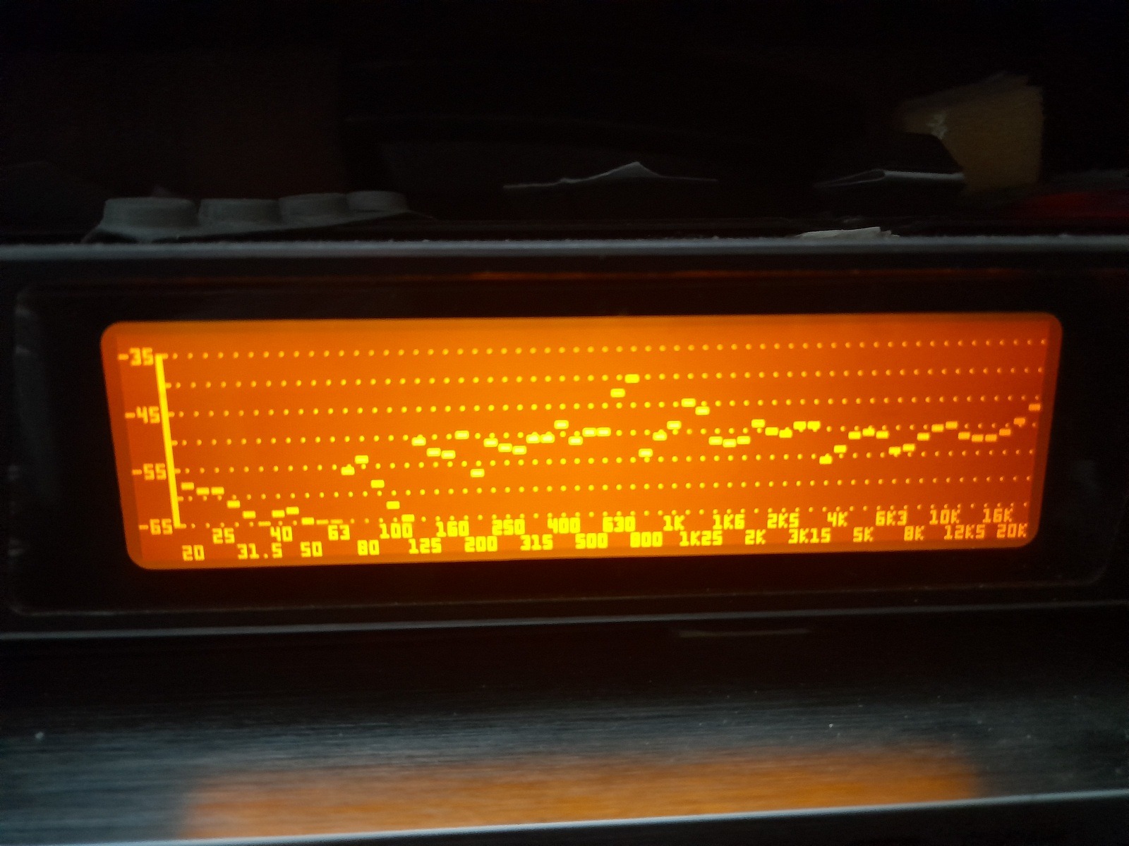

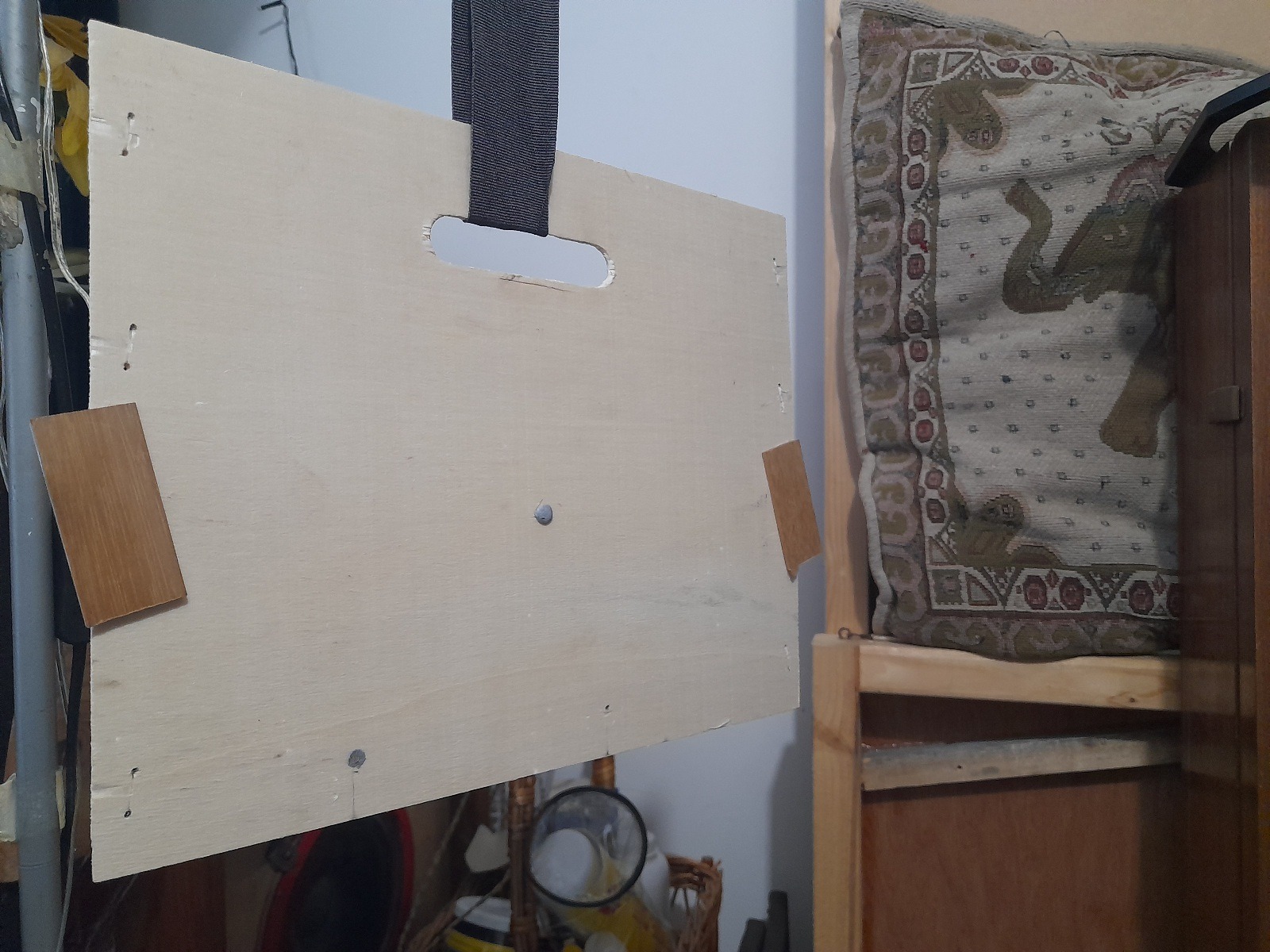

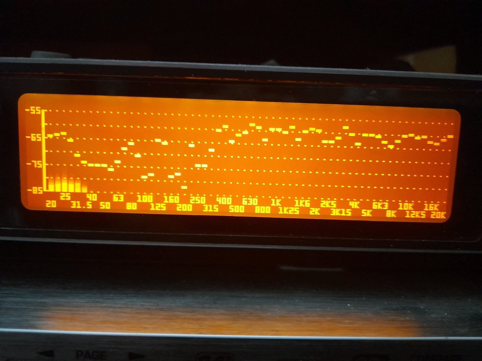

I have just mounted the crate ply and taken some measurements.
There is a sound I am trying to get rid of.
I have tried different types of damping, but they alter the sound too much.
The closest I have so far got is with the arrangement in the picture.
This breaks up the early reflection from the two edges.
But as can be seen in the 30cm measurement ,the noise is still there with the peak at 630hz and 1.25k.
Pic 1. panel.
Pic 2. 3m.
Pic3. 30cm
Steve.

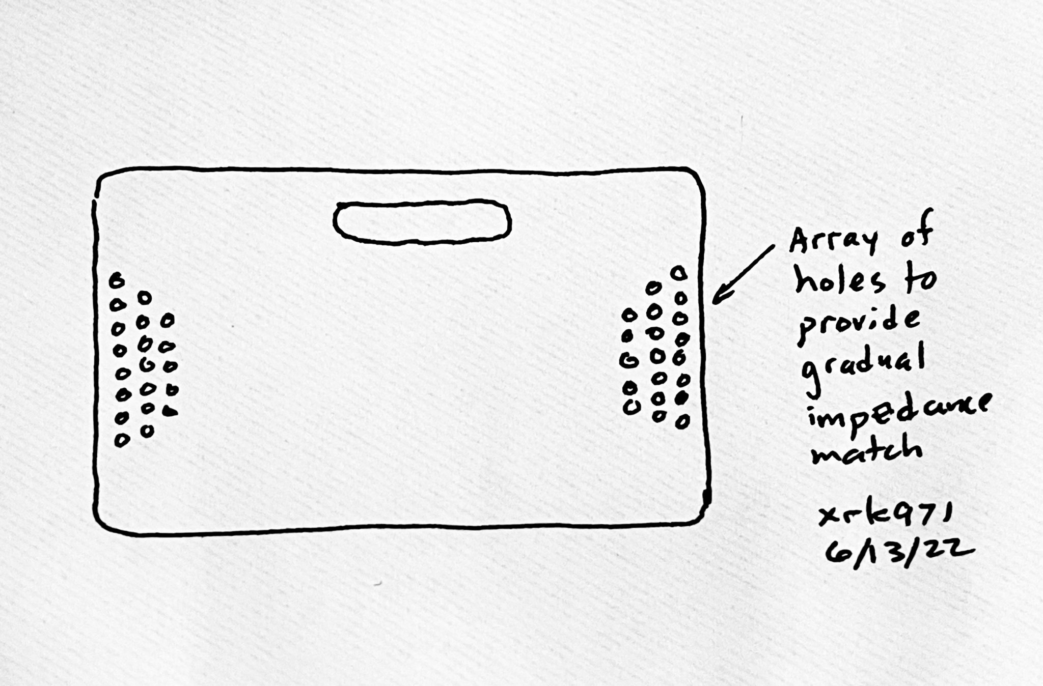

XRK.
I was going to explain more in my last post but I had to rush out.
The noise I believe is the exciter cavity problem, which is quite loud on this material.
I think I will have to use my fabric dome technique to stop this noise.
Or should I call it a dust cover ?
The main reason is to vent the coil cavity ,but it does also act as a tweeter to some extent , depending on the efficiency of the panel.
This should kill the noise at source ?
In the picture of the panel you can see a small blob of blu-tack in the centre of the coil area, in an attempt to dampen this noise.
Interestingly the 3m plot shows the peaks have dropped below the pink noise , but it can still be heard .
The idea of the strips of wood stuck to the panel edges at an angle was to deflect the reflection .
The left side reflects the the waves upwards and the right side downwards.
I will hopefully glue some angled ply strips on the side similar to other panels i have made, that is if I am still having problems ?
Even though the strips of wood are only stuck on with tape , the panel is sounding very nice, so it is promising.
Have you yourself tried that method of drilling holes in panel to stop reflections ?
How does it affect the panel response ? Sound ?
I have not cut off the handle part at the top of the panel yet as I am thinking of gluing 4 of these panels together at a later date when or if I get more crates ?
Steve.
