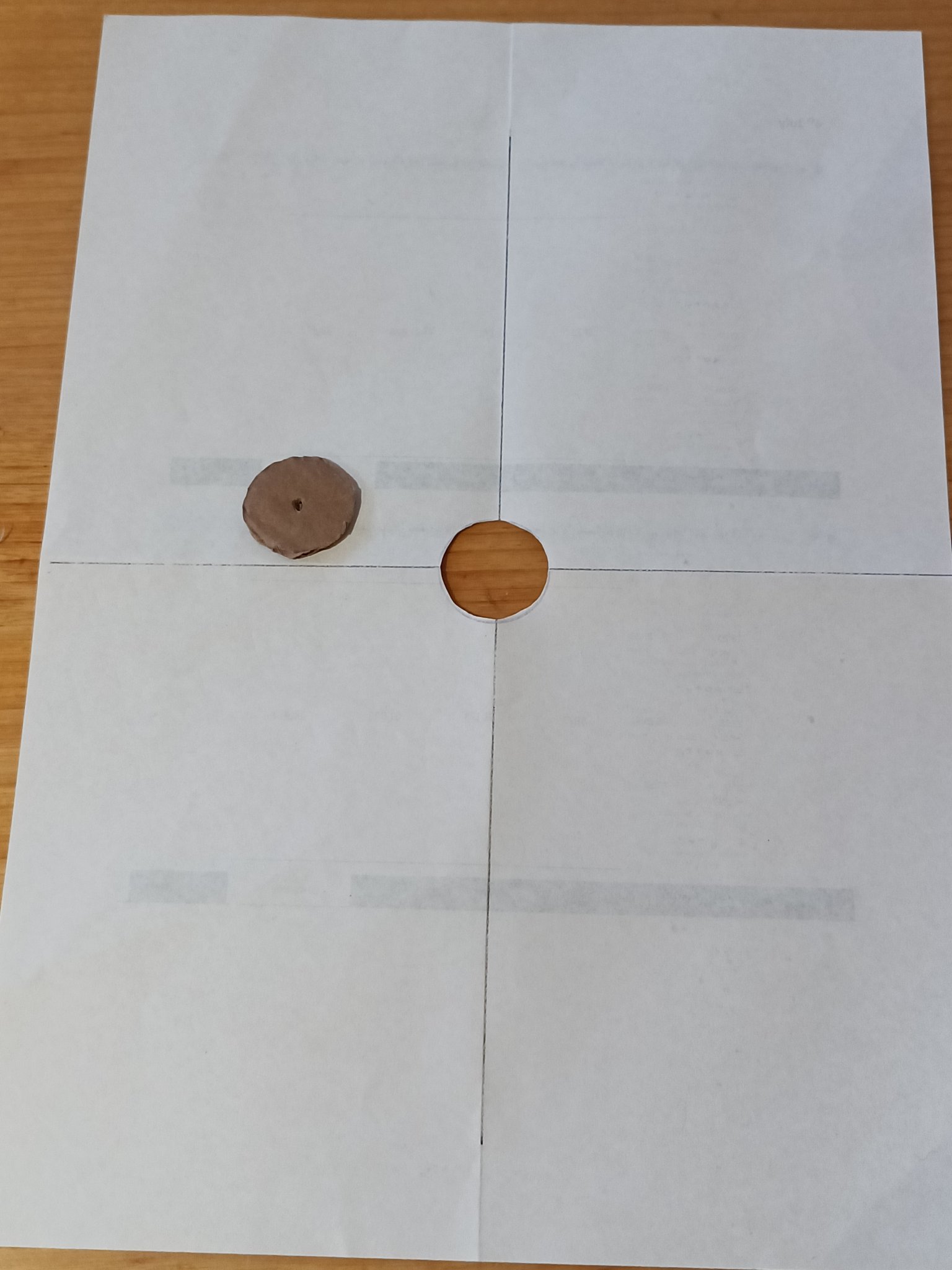

EucyDome Episode 4
You will need to accurately measure your exciter voice coil diameter. Some exciters have quite wide mounting flanges so try and discern the actual bobbin diameter. Usually the specs will tell you the diameter but check anyway.
Then you need to make an accurate male template to the coil diameter from cardboard or other object matching the required diameter.
You will also need to make a female paper template cutout approx 2mm bigger in diameter than the coil with axes marked... The easiest way is to fold an A4 piece of paper in halves both ways, ink in the fold lines, scribe the circle and cut
Like this:
Eucy
Like this:
Eucy

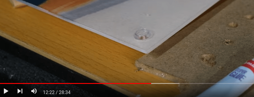

Thank you Toddincabo.Typical Ben finished his hybrid build:
The link to TypicalBen web site.
600x400mm 3mm thick acrylic with printed pictures
Mounting method : grommet at the corners + side foam

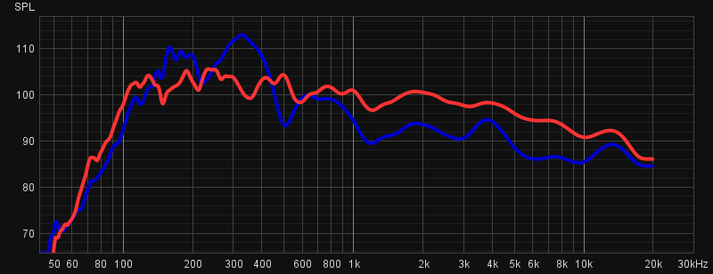

Finally dug out the laptop with measurements of the panels for the PA system.
In the rush I had not labelled them too well, but I think this is the correct responses.
Blue is pre-eq and red after.
I think I ignored the very large swings in the mids, since they where sounding really good with some EQ and I was in a hurry, but looking at the curves now it is actually nice to see what a disaster it is pre-eq, considering it still sounds really great
It means there should be plenty of room for improvement when tweaking them to even out the response in 250-600Hz region. I'm hoping I can get decent results by modifying the suspension more, which is very easy to do.
Thank you Leob for those additional information.Finally dug out the laptop with measurements of the panels for the PA system.
The possibibility to EQ DML is really an interesting property of those speakers.
About the suspension, there are so many possibilities... which way to take? Why not known if the EQ can do the job?
It would be interesting to see the FR with only one exciter working to see the role of the network of the four exciters
Christian
Leob.
Where was your microphone for these measurements?
The higher response below 1k could be from the mutual coupling of the 4 exciters.
Which is handy for you as this will give you more power handling when EQ'd.
For the higher frequencies 2 or more exciters are just as likely to be fighting each other , than in mutual coupling.
So you do not get the efficiency you would normally hope for.
But I personally like a bit of a sloping response in my room, this seems to balance the sound well when blending in the subs.
Steve.

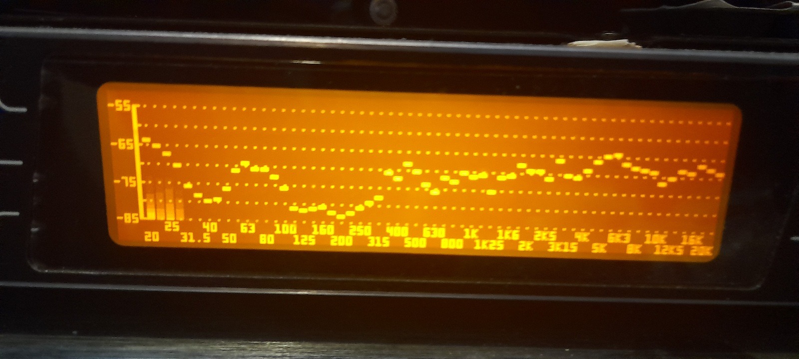

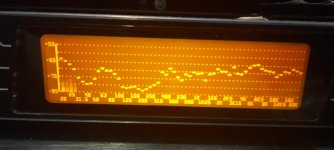

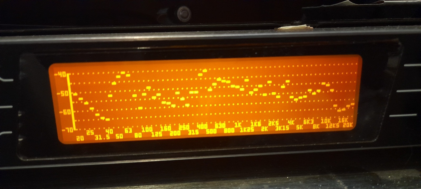

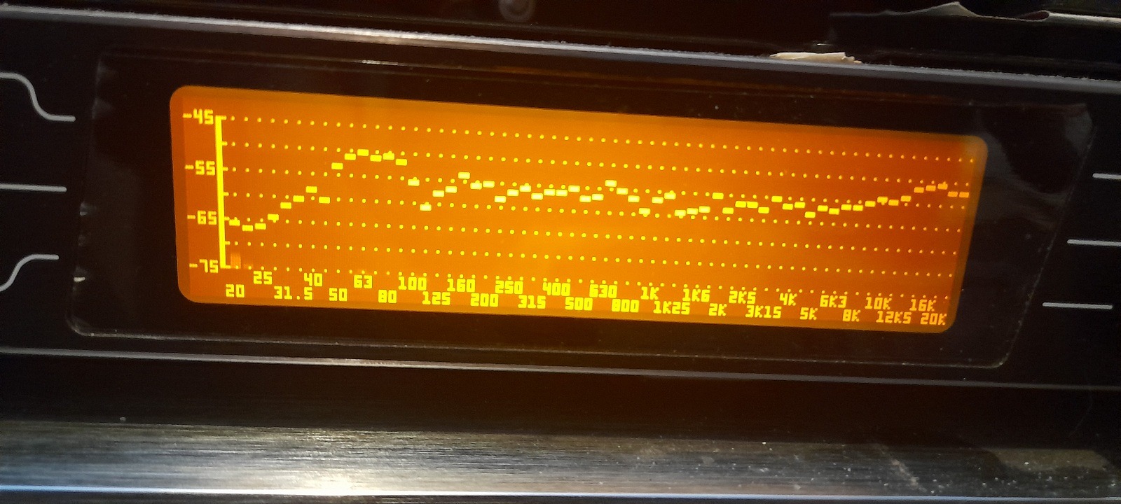

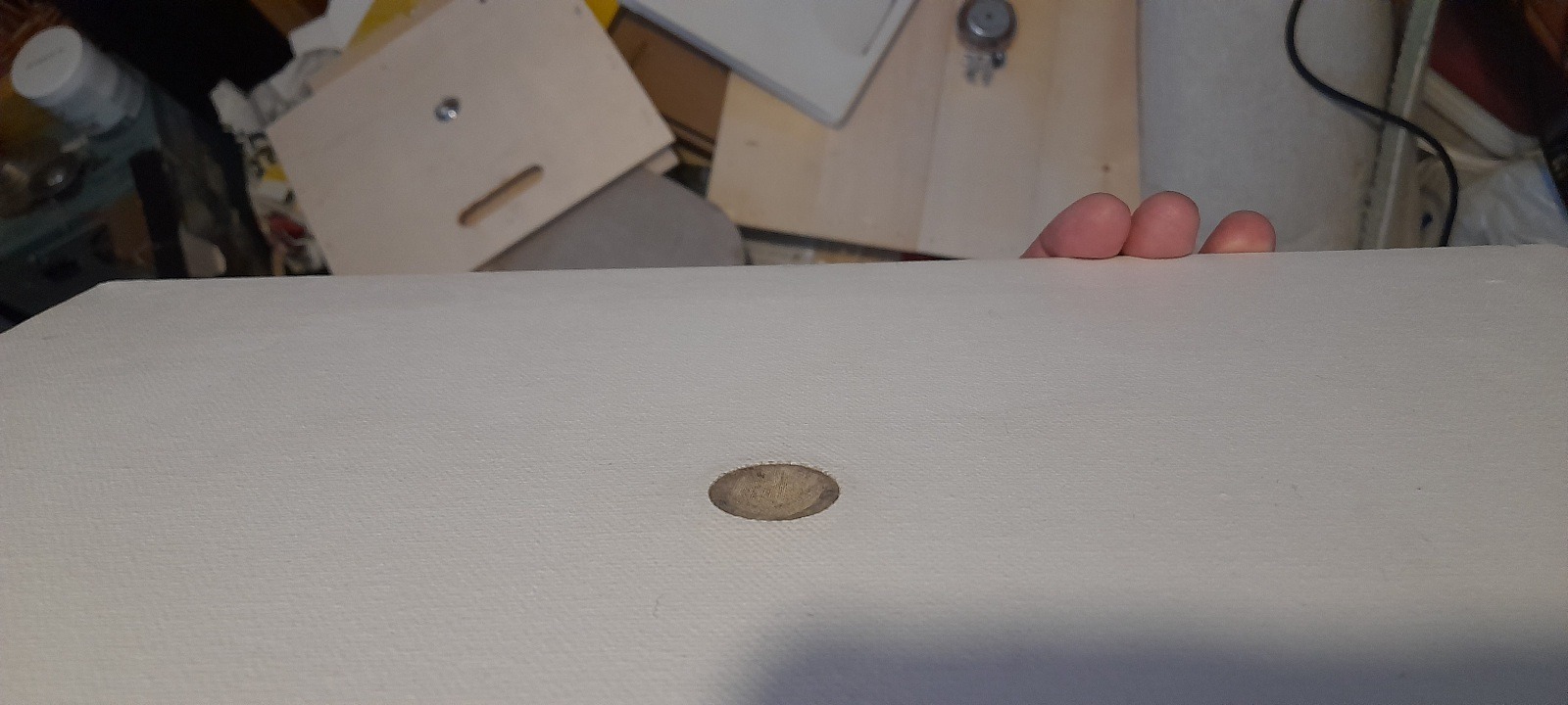

I just found a 14x20inch 3mm ply panel behind the wood burning stove, it was put there to stop drafts and dirt coming down the chimney.
It still had the exciter attached to it !
So I hooked it up and measured it.
I had already painted it in white vinyl paint.
It is still coated in cobwebs and dust.
First pic.
6inches.
second pic.
1m
Third pic
3m with room suckout in the low end.
Steve.
First pic.
6inches.
second pic.
1m
Third pic
Steve.

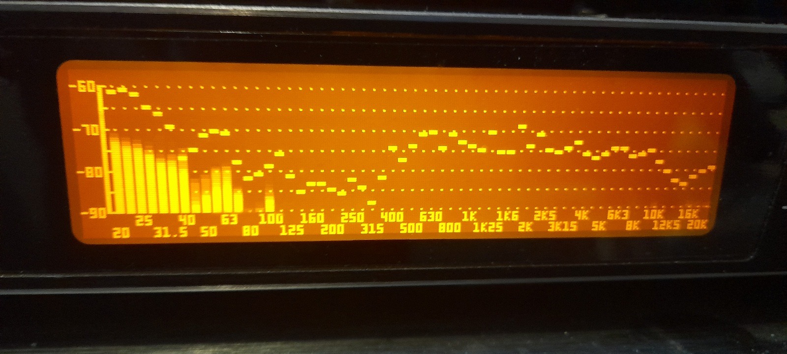

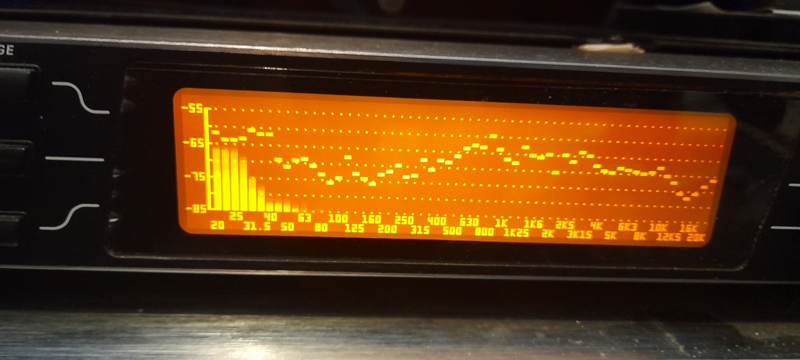

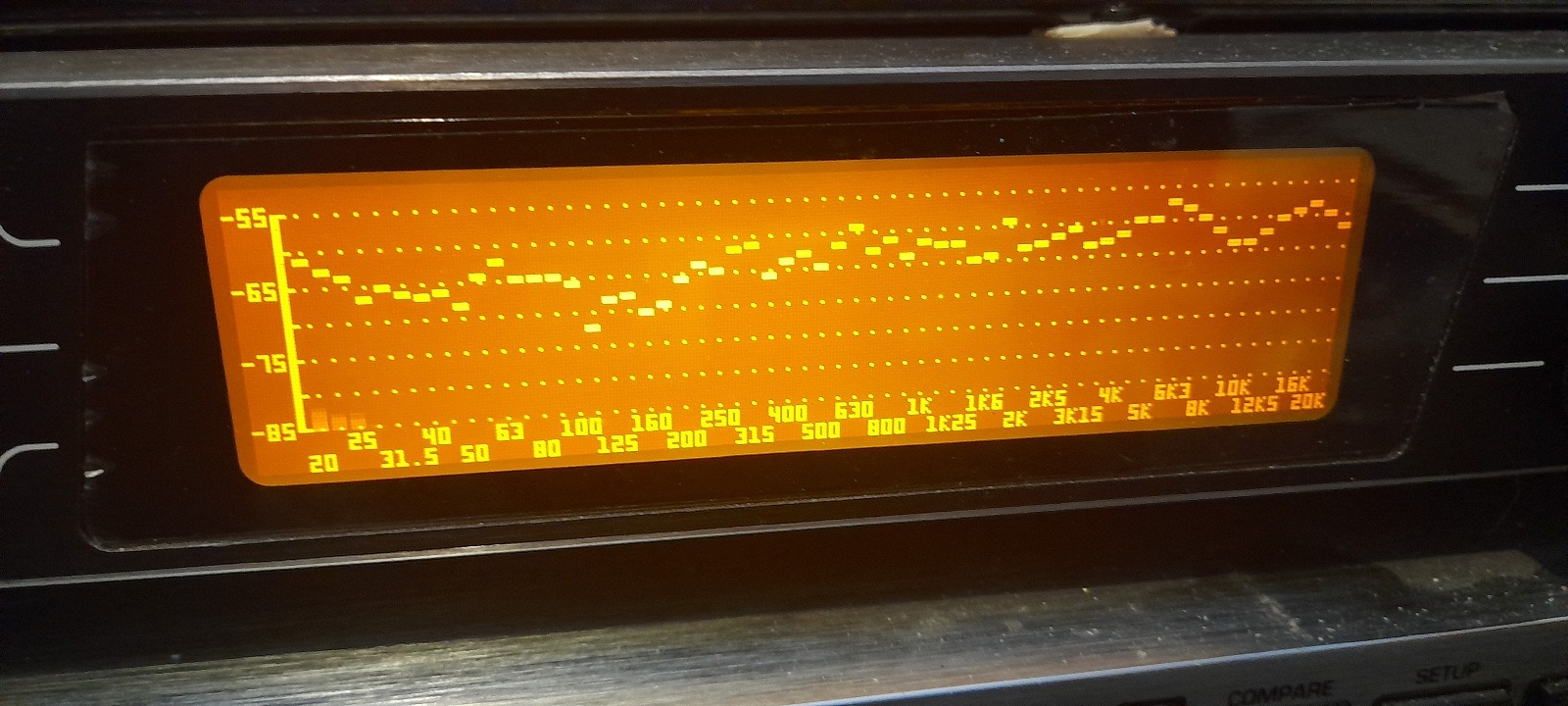

Leob.

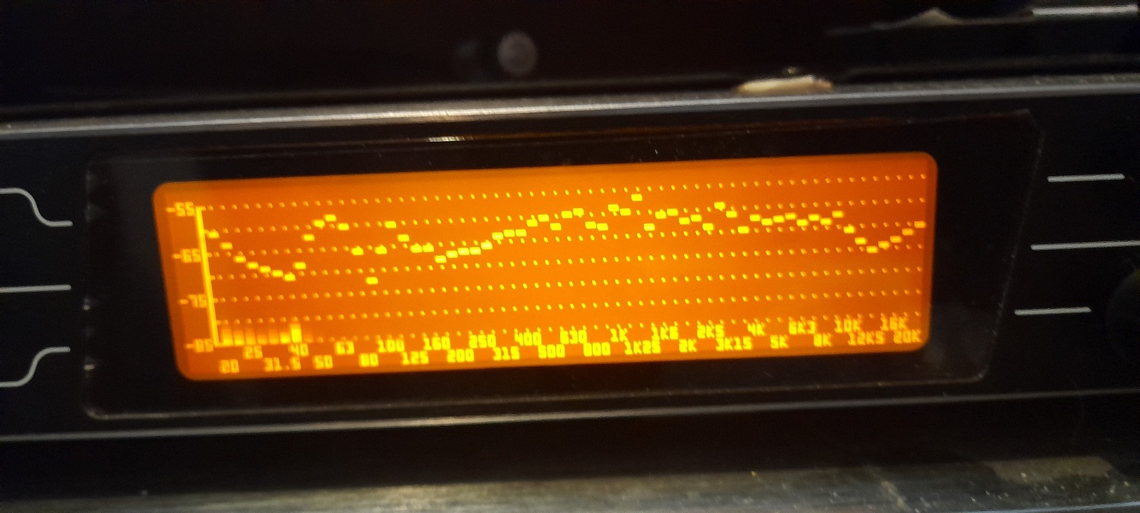

Some pics of my 2ft grey 20mm eps.
1.
At 12inches
2.
At 1m.
3.
At 3m
And 4.
Playing large drums and percussion, peak hold.
The room suckout is a big problem for this panel ,but it does still have a strong output down to 40hz.
Steve.
