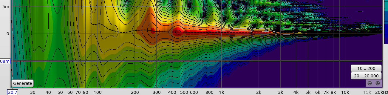

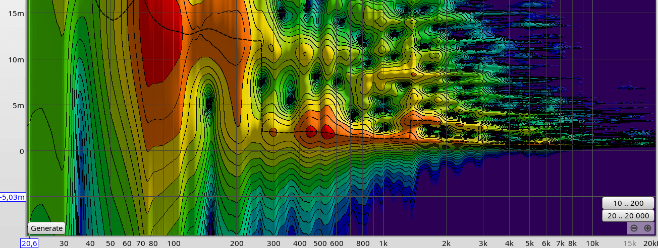

Yesterday, I made some measurements of this type with a more simple setup :
- iMM6 mic at about 5mm from each point of the panel to measure (reference being the exciter)
- REW with the external time reference (loop back timing reference)
Here is the spectrogram at the exciter (all the frequencies almost aligned near 0)
Here some 40cm from the exciter
So some delay depending of the frequency appears (more delay at low freq, look 300 to 600Hz which is more readible)
Some data treatment is needed do see if we can quantify something.
Nothing for now says the mic is "selective" enough to show what is just in front of it...
Please consider this as raw data.

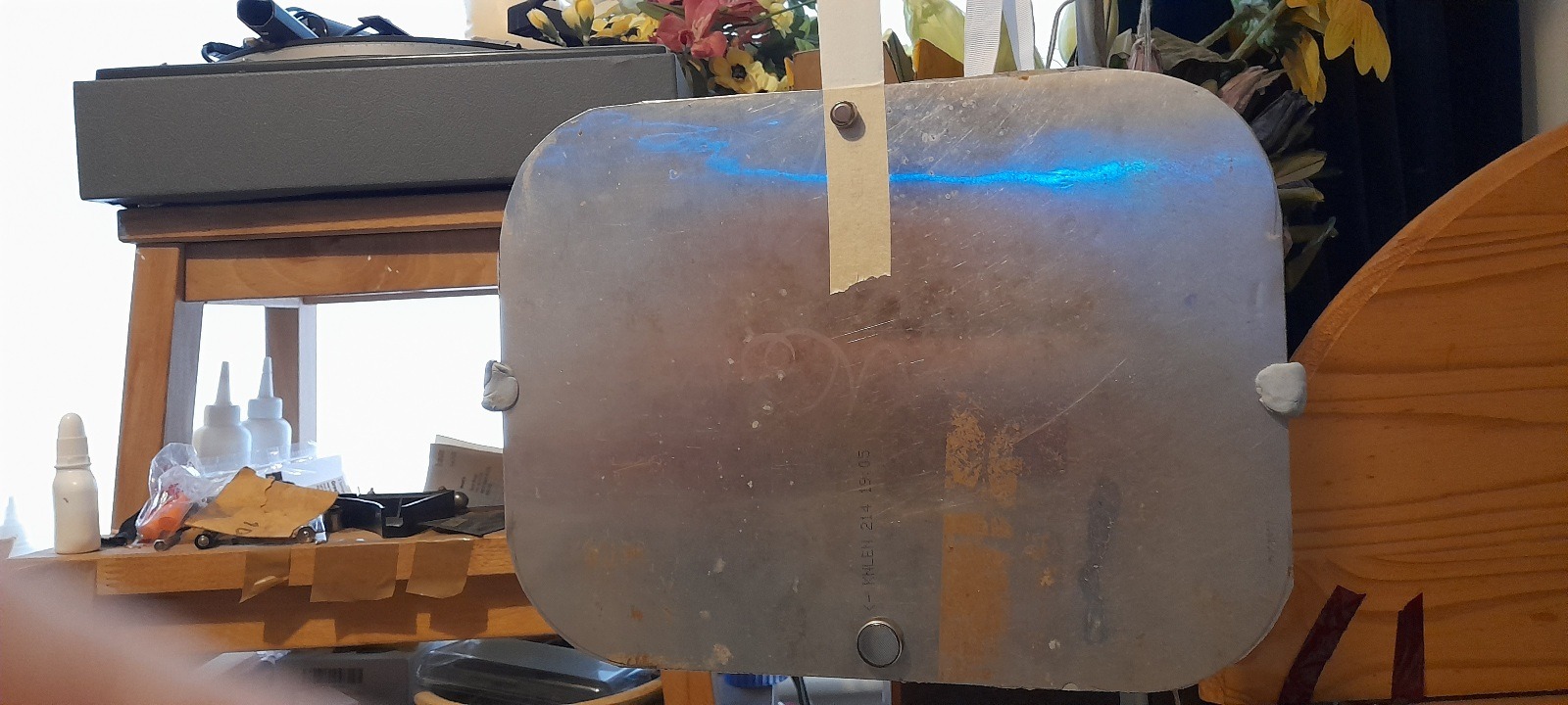

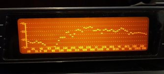

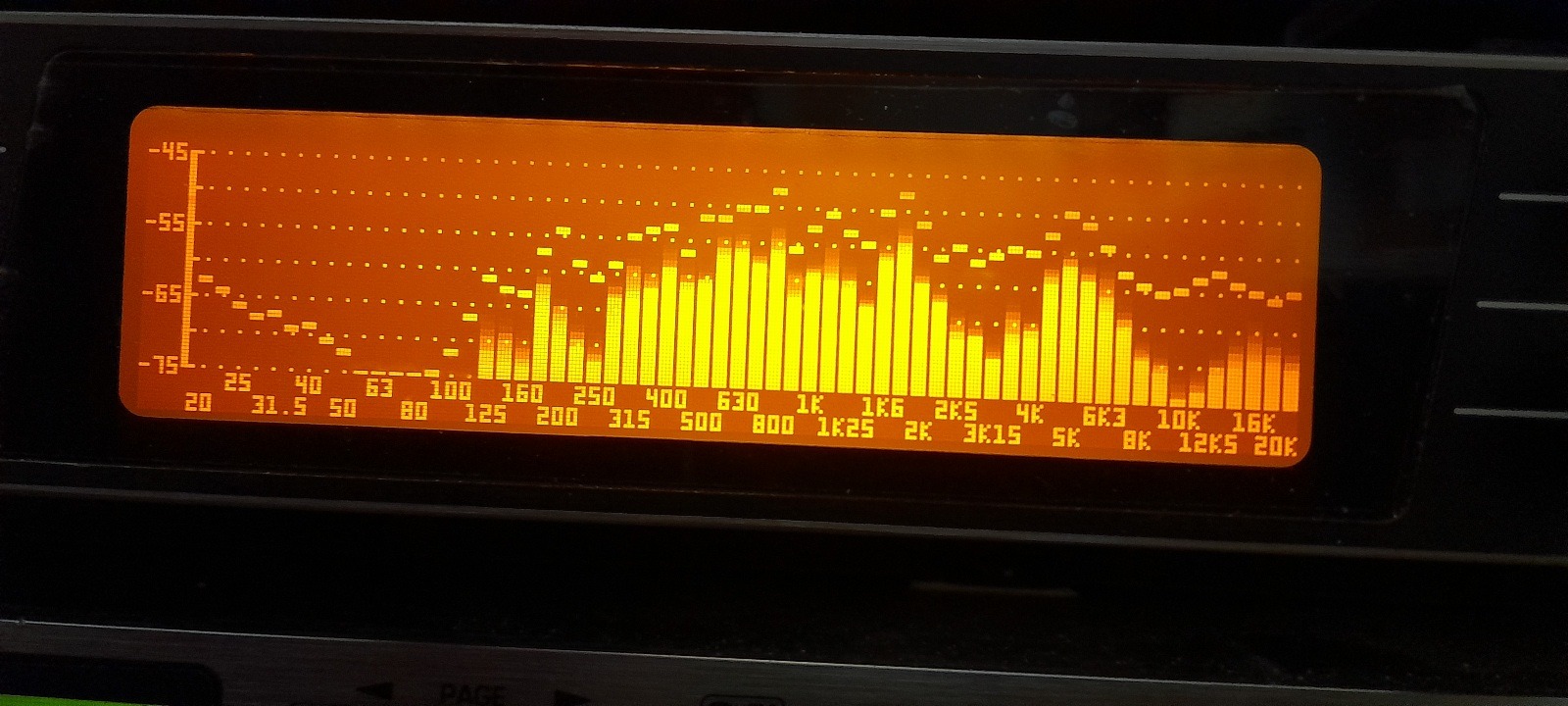

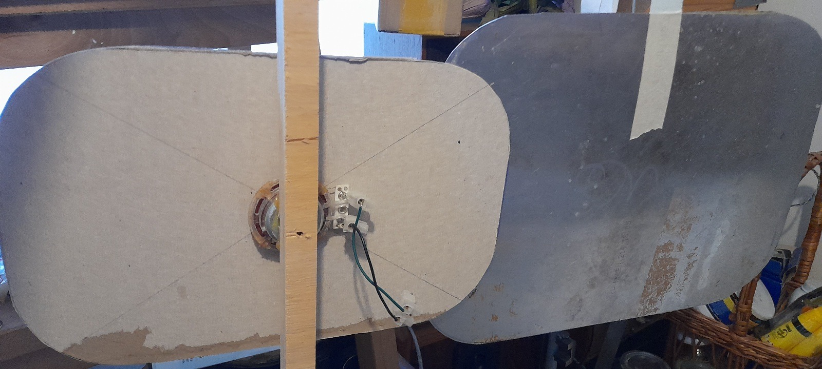

I just made a recording of the 2ply aluminium sheet while moving the microphone around the room.
I was then going to cut the panel down another size to match the size of the card panel.
But while I was measuring, I noticed the slight peak at about 5k.
I was a little suspicious of what this was, so turned the panel around.
As you can see in the third picture of the reverse frequency response, the dips either side of the 5k peak.
It does not sound too bad in my room , but if up against a reflective wall this could be a problem.
Also I added some weights to the edges , which improved the output in the 90 hz to 200hz area.
This aloud me to turn the volume up a lot higher, although the exciter is now getting hot 🔥 .
This aluminium panel might actually sound better with some sort of frame or damping?
It does wobble and flex a lot, and when holding the sides the sound does not alter too much higher up in frequency range.
So I am going to play around with this one for a little longer and see what happens.
Pic 1 with smaller 12 x7 inch card panel.
Pic 2.
Frequency response of aluminium panel at 1m.
Pic 3.
Response form exciter side of panel same microphone position.
Pic 4.
Panel With the small weights attached.
Steve.

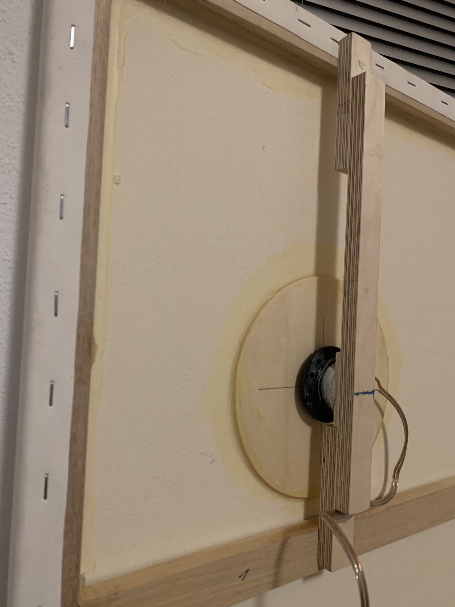

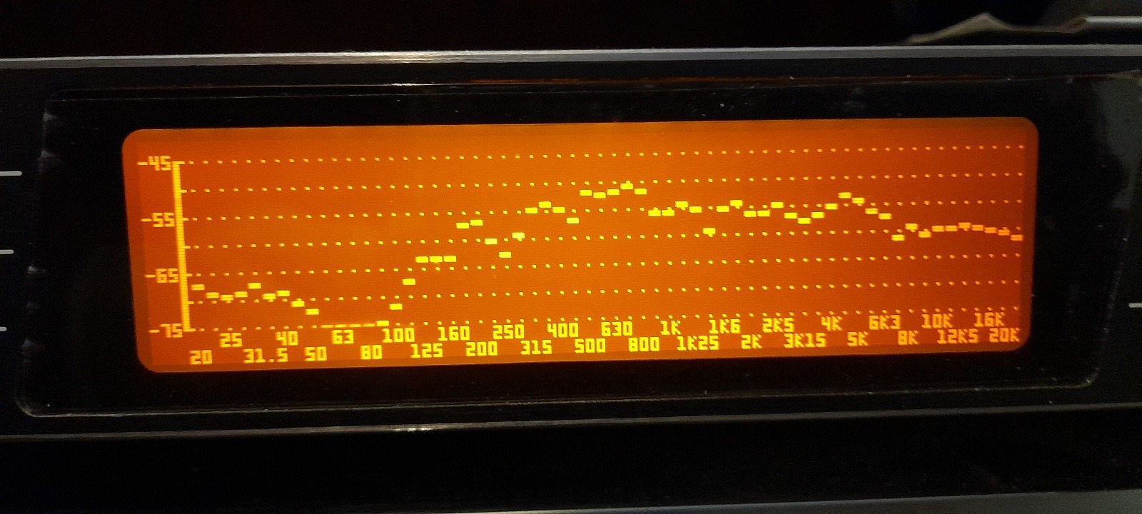

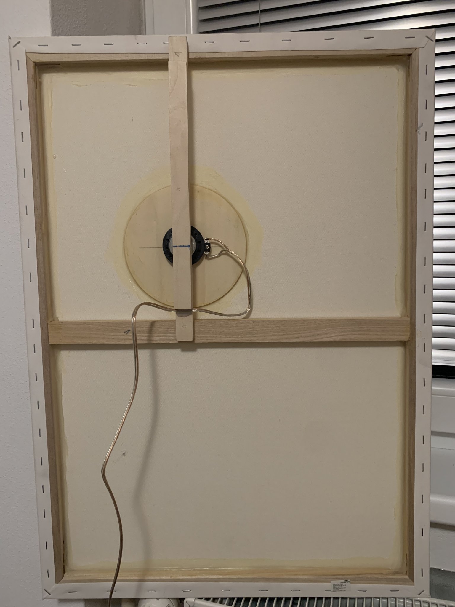

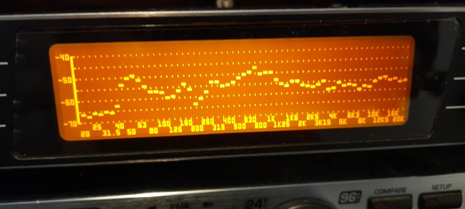

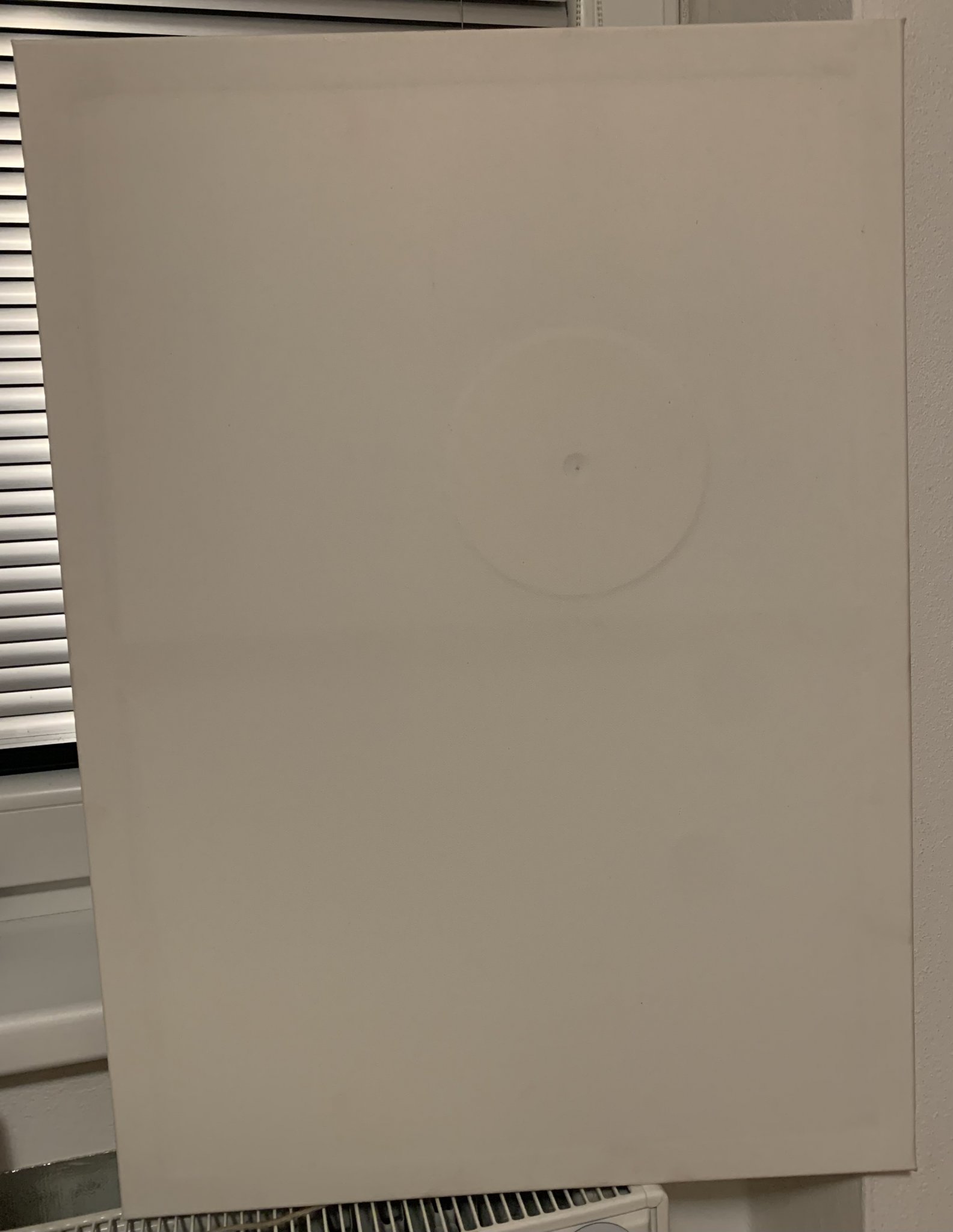

My panels are 50 x 70 cm, exciters DAEX25VT-4. There is a 15 cm diameter 4mm poplar plywoid disc with a 10 mm hole. Glued with silicone, the edges are also glued to the frame with silicone. The plates are offset around 2/3 in both directions. I do not remember exactly, I made the panels long time ago and only yesterday mounted the exciters. The spine is made of 12 mm birch plywood leftovers, exciters are glued to the spine with gel CA glue.
Some pictures are attached. I found the source of distortion - one of the exciters was not glued properly by the double sided tape and fell partially off. After a mighty push, it stays in place fine. I am running these now with a mini class D amp with Bluetooth. Just placed on my desk near a wall. Maybe I will hang them properly one day
I get surprisingly low bass at low volumes.

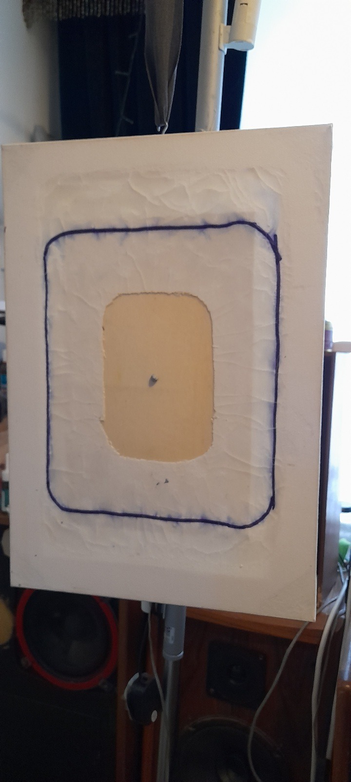

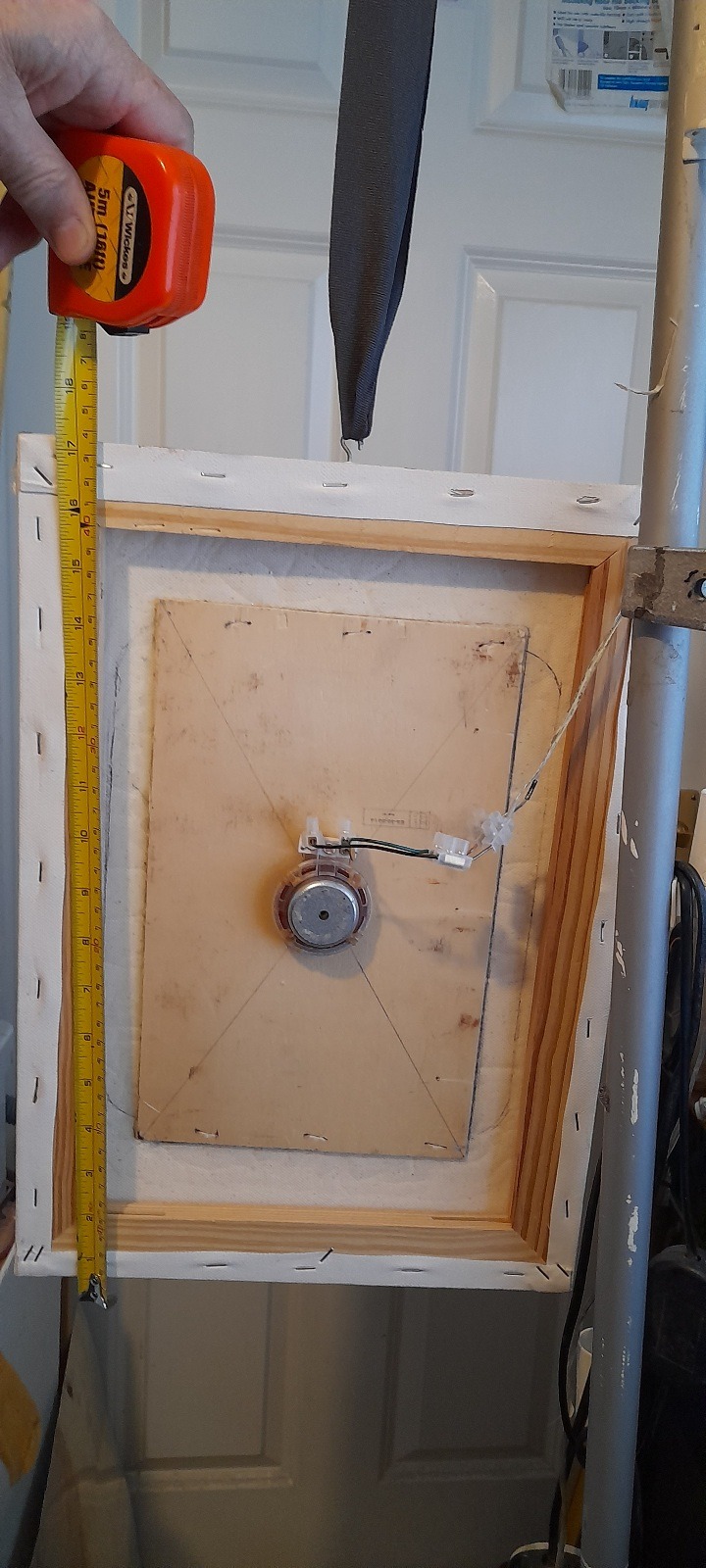

I have 4 size of canvas total 12 pairs of panel on hand.The result encouraged me to experiment further with higher powered multiple exciter panels.
30" x 40" was give up because lack of efficiency and bad tonal balance. However it does has very good sound stage, layers separation.
60" x 80" was almost give up. Sound quite boring and didn't see any advance on canvas this large. Even with 1 to 4 exciters I tried.
50" x 60" I have to spend more time to test. This has bigger imaging size of instrument then the 40" x 50". But have problems here and there waiting to solve.
40" x 50" linen canvas is my favourite. Lively sound and even more musical then my beloved EPS. Just the efficiency not so good, nothing else to complain.
All canvas use 40W PUI exciter and without spine. Hard mounted (G clamp) on a diy stand.
