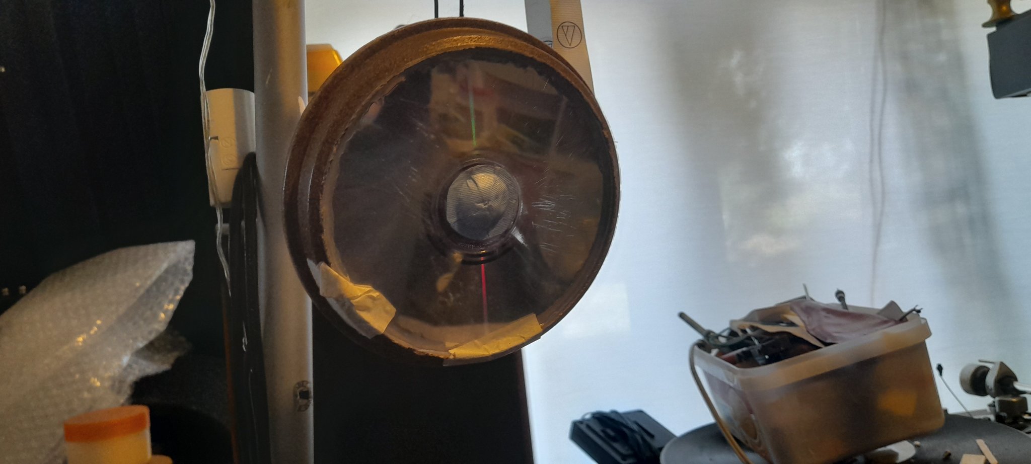

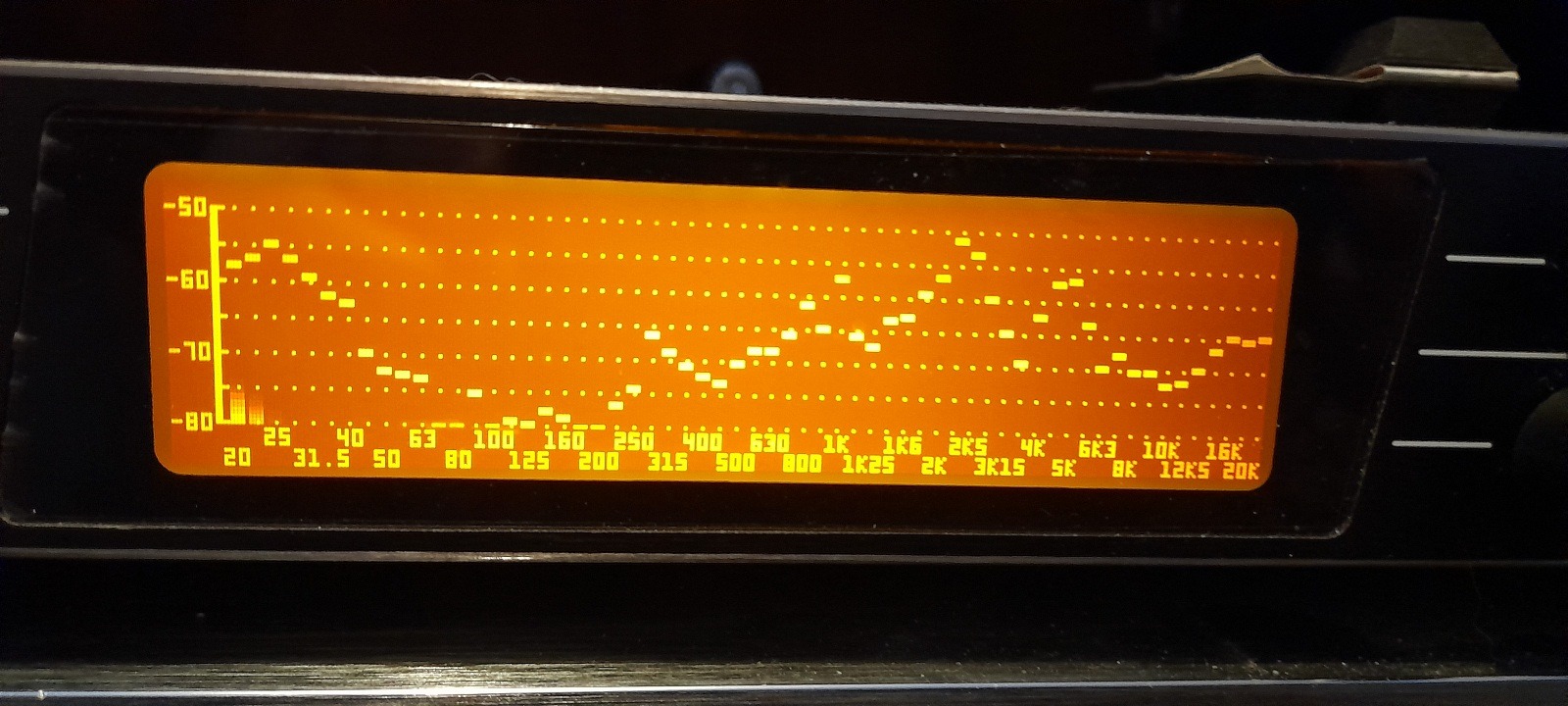

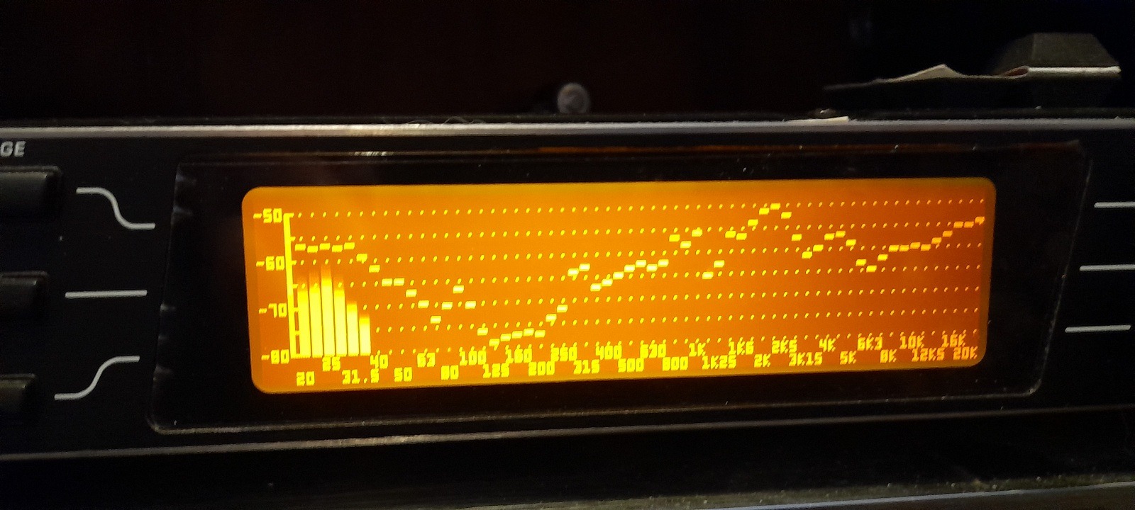

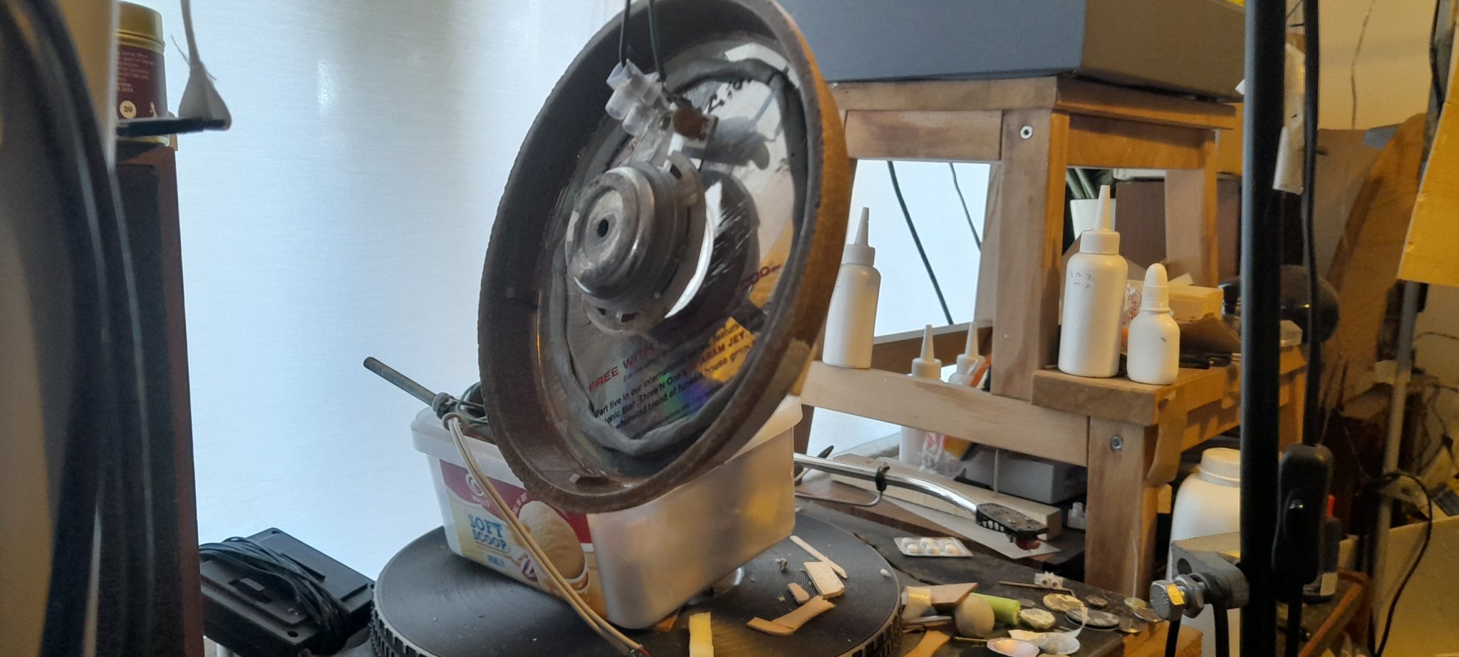

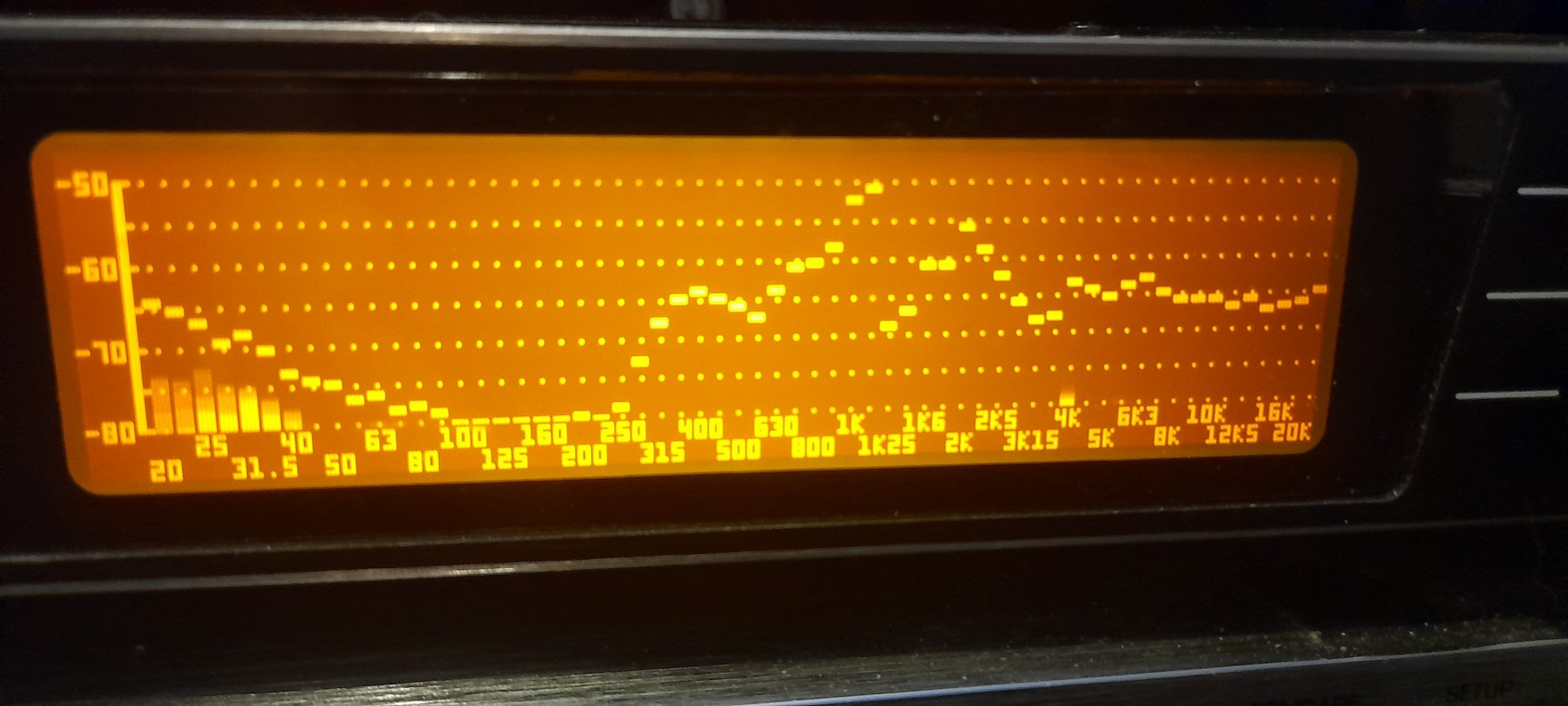

I have some plots of the CD panel.
The first two were of the CD with eggshell dome.
The first from the front, probably at about 2ft distance.?
The second from the back.
showing the exciter noise coming through and around the CD.
The third is with a paper dome plus in a rigid frame , the response is much better down to about 2.5k at 1m.
I also used a large bluetack ring to reduce the exciter noise.
I am going to try a fabric dome to see if this helps things a little more?
The last two pictures are front and back of the CD panel.
Even with the lumpy response below 2.5k it still sounds pretty good considering.
I will make a recording before continuing.
Steve.
