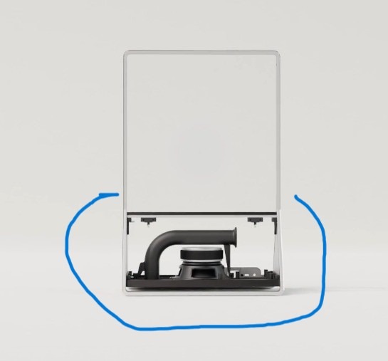

The most interesting part of Ammos product is the triangular down-firing woofer box, rather than the glass sheet protruding above, when I think about it more and more. True, the up-firing two actuators/transducers firmly touching 4mm glass sheet became the subject of interest due to our DML interest here, so few experiments with up-firing transducer with different materials. Sony, by the way, showed that a top closed glass (or similar) tube gives omni sound with at least 3 up-firing actuators under the edge. Two actuators connected to two stereo channels gave quite full room filling sound when a tall drinking glass was held tightly over them at opposite edges. I placed a heavy book over the drinking glass, so I can take my hands of it, so walk around. Well, anyone who has two actuators can do this experiment. Tall drinking glasses and heavy books are normally available. :)
Now, as I mentioned above, the triangular down-firing woofer box became the subject of interest. You see, instead of "actuators" there could be two smallish tweeters placed just under the open groove, and that triangular box becomes a speaker. The space below the tweeters can be sealed so whatever back sound would only go through the curved bass-reflex tube.
The Ammos people were trying to prove that a vertical glass sheet would transfer sound out from an up-firing actuator. This is true, but it also becomes a sales gimmick -- you can put some LED lights underneath, like Sony. I know for sure that up-firing tweeters doesn't change the sound you hear, in a normal room that most of us have. Mine is 4.8m x 3.8m, 3m high. Contrary to the general belief, I think the thinner sounds come at you (attacks you) faster than the boom sounds.

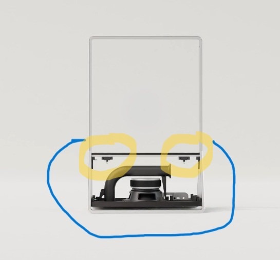

We are presuming that the actuators are upwards firing, but they could just as well be rocking motions actuators ?
And how well does the thicker rear glass prevent sound passing through?
Helium in this air gap would be interesting.
Steve.
Ammos said so.
Anyway, the idea is to find omnidirectionality of sound in one's living room.
Chdsl.
What they actually say is the actuators are placed invisibly close to the edges ?
Whatever that means?
We do not know what type of exciter or method they use to excite the glass.
Hitting the side of the glass seems a very inefficient way of exciting the glass ?
Steve.

They say,
The actuators are placed invisibly close to the edge of the glass, putting ample force on it.
That was just an entry for an award, not yet a commercial product. If it ever happens, we'd know, that is, until someone takes them apart. Or, you have to contact Martin Steffner for details.
chdsl,
The Ammos speakers use a PLZT element to drive the glass and the Glass becomes a SAW transducer (Surface Acoustic Wave). Since the PLZT is a piezo-electric element it needs a voltage amplifier to drive it rather than the usual current amplifiers used to drive voice coils. One should note to that the piezo-electric is pretty efficient in driving the glass. so the voltage will be in the 12-24 volt range. The PLZT element is most likely from TDK as the produce the piezo-listen elements and I have had them make special elements for a Acoustic Optical elements for a laser project.

It's interesting how we all see different things of interest in their design. For me, the thing I'm most curious about it why they chose to put a thick glass layer on one side. What did that actually achieve, beyond blocking (partially) the sound on one side? Is the gap small enough to get some effect like in the NXT patent for sealed enclosures?

In the exploded view of the Ammos panel you can see the actuators screwed on to the bottom of the top aluminium bar.
The class slides down onto the bar and is held in place by the frame.
Is this the only contact the actuator has with the glass, through the aluminium bar?
Although to me it looks like there is a pin in the actuator that could go through the aluminium bar (or not) to the glass?
Which would make the actuator a type of solenoid?
This is why I an a little suspicious when they elude to the actuator being subtly close to the edge of the glass?
