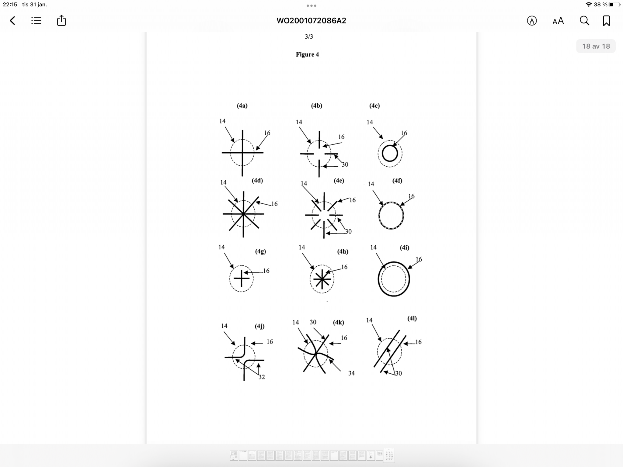

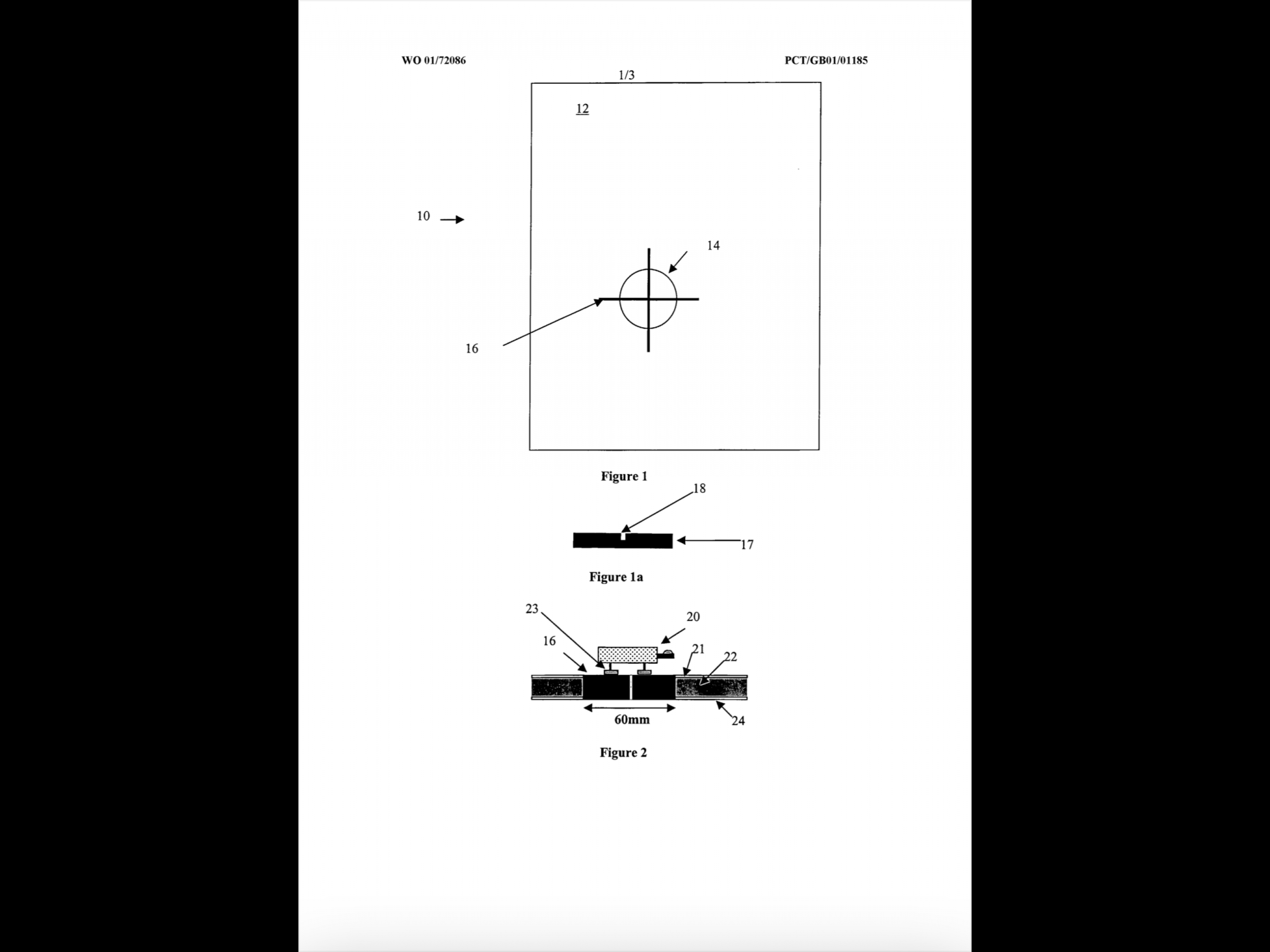

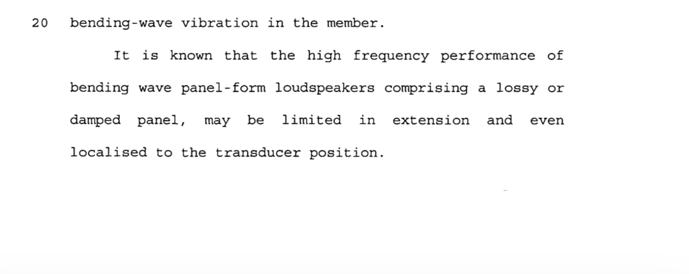

I have tested one of the solutions included in this patent application. I have included in one of my sandwich (carbon, balsa, carbon) a piece of homegenoius carbonfiber piece that is of the same size as the voice coil of the exciter 25mm. The CF piece is of the same thicknes as the balsa core 2mm. It’s Connecting the front and back CF skin with the exciter. It did help to extend the frequency range to 20k.
There are some more ideas in the application.

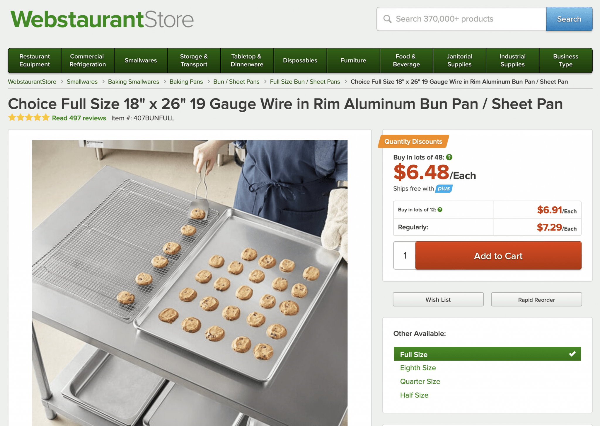

Light weight thin aluminum sheet pans.
Turned up edge with a rigid rim.
Rounded corners.
Cheap.
Readily available.
Maybe pour some whipped up PVA into the pan for dampening.
Available at restaurant supplies on the Bowery in NYC.
Gets one wondering ;-)
Update ... found one in kitchen cabinet. Looking for an unused exciter in the shop.
Sneaking around so my wife doesn't notice she doesn't have anything for her cookies ;-(
It's a trade.

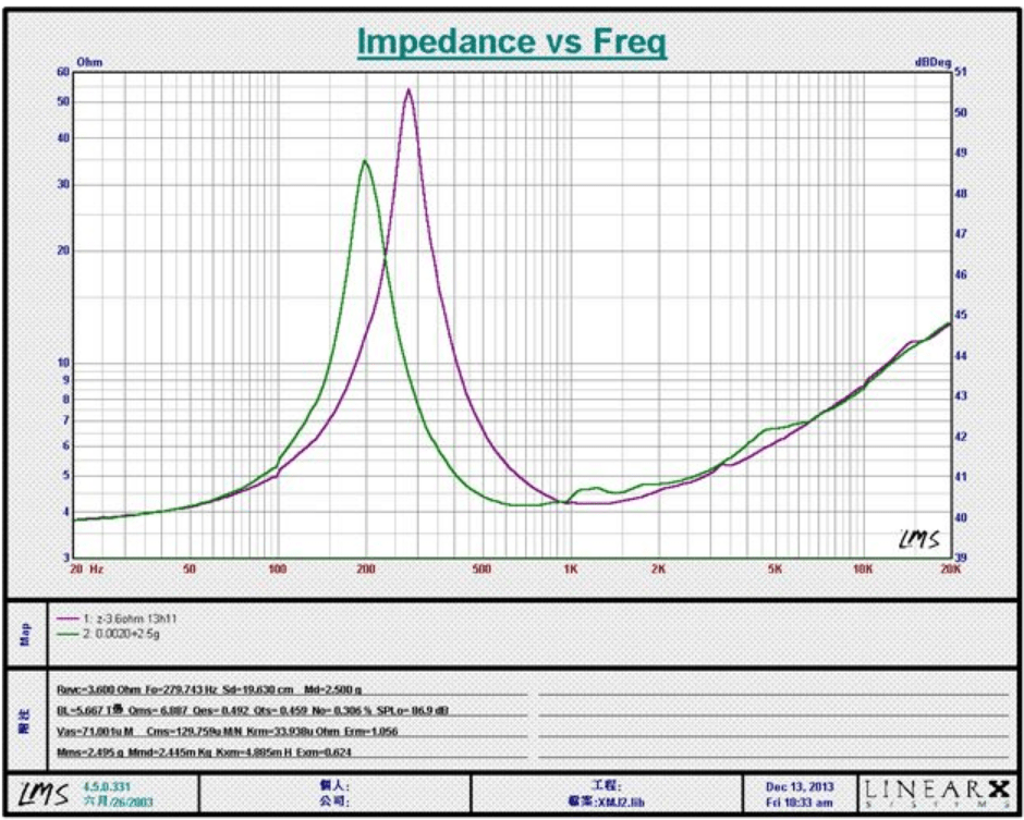

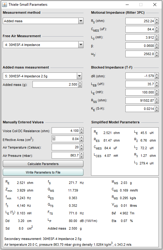

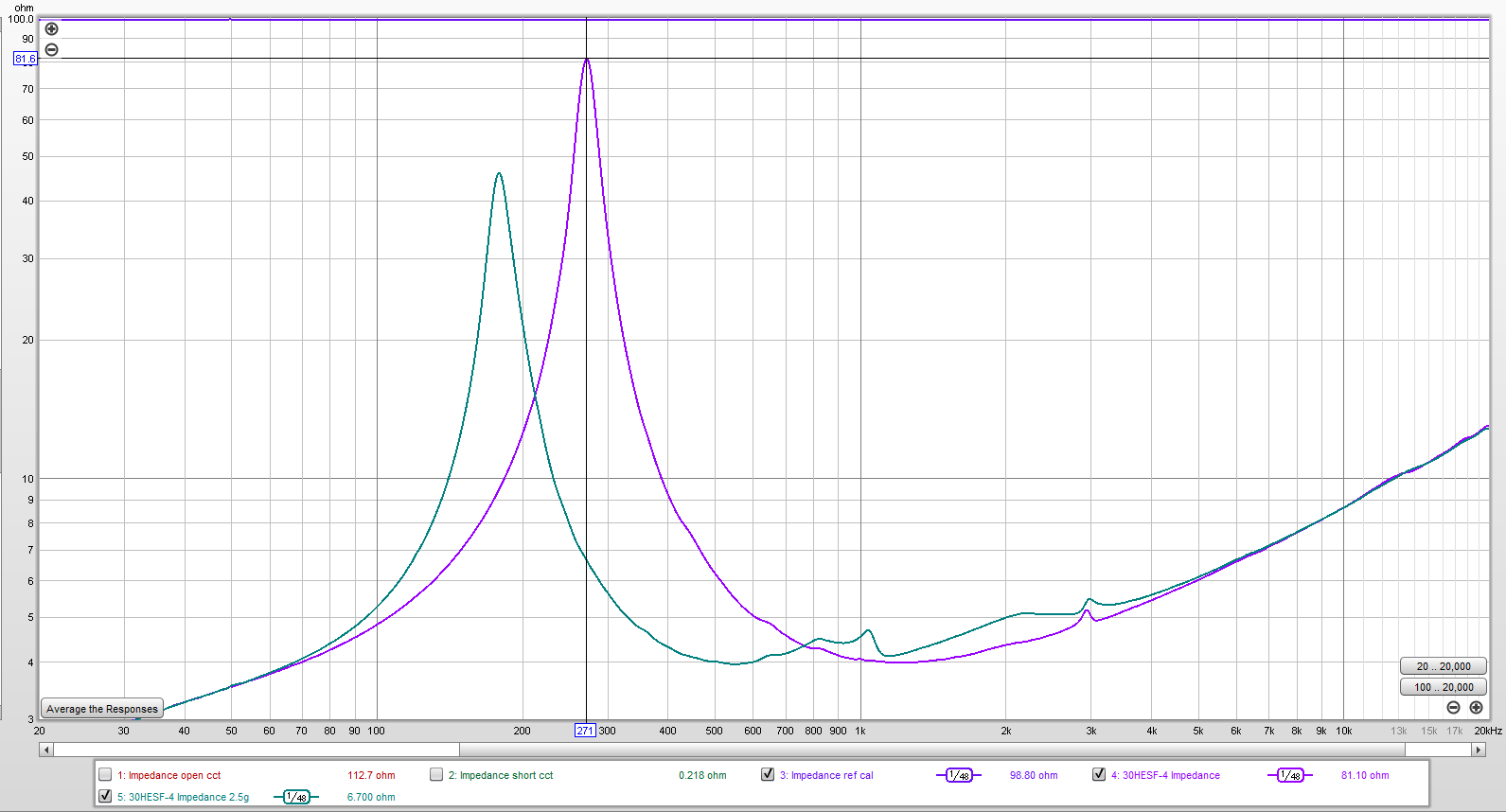

As promised, Christian,
Notes:
This is TSP's on the Dayton DAEX30HESF-4 driver. I'm measuring these HESF's because they are the only ones lying around at the moment.
I've used 2.5g added mass which seems to be the same as what Billionsound uses in their measurement of this driver.
Impedance axis is logarithmic.
Note Re=2.5ohms?? Yes, I did check my reference resistor a few times.
Note the F3 and Le-at-F3 numbers... o_O
Here's what I think is the OEM driver from BillionSound. https://www.billionsound.com/product/177.html?productCateId=18
Their curves are virtually identical to mine.
The numbers below their graphs are almost too low-res to read...
Comments?
Reactions: 1 user
Definitely the same unit imo, but their numbers differ from yours?
..and here's the equivalent for the 25SHF-4: https://www.billionsound.com/product/175.html
- In this case the numbers match those published by Dayton but the impedance graph differs, and the Dayton graph appears to be at odds with the stated values.
The Billionsound version of the 30HESF states a BL of 5.667 Tm and yet as you say, the SPL is lower than that quoted for the DAEX25SHF even though it's a 40W exciter vs 20W (nominal - but appears to comfortably go higher without apparent stress )

Im not that familiar with ts params but I doubt they’re directly comparable for an exciter. If the exciter was not loaded (not on a panel) then it’s not doing work pushing air, and I guess that would explain a low Re?
Yes you're absolutely correct. Thiele and Small never had DML drivers in scope when TS params were first conceived. I would bet a good Gilroy's Serious Porter on that. TS params were originally shortcuts for calculating dimensions and bass alignments for woofers.
However, REW does provide a simple facility for measuring TS parameters very easily by loading a naked, unloaded voice coil with added masses, and not necessarily with different-sized sealed boxes, and therefore we can use those resultant TS params to get a good idea of other driver characteristics as well (such as coil inductance, Bl, moving mass, compliance etc. etc., et al, ad nauseum.)
I still do suspect that there's something wrong with that Re reading. It should line up with the DC resistance reading of 4.3ohms on my meter. Maybe my meter must be calibrated...
