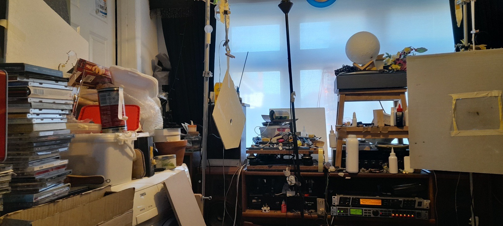

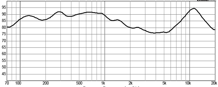

I found an old battered about 5mm hd eps panel ,it seems I destroyed both 5mm panels😩.
I glued on the exciter yesterday , basically just stuck it on anywhere.
first pic is of the panel from the front, with a magnet attached to show where the exciter is.
second pic is the response, with the peak in the 10k region ,this is easily sorted without blu-tack.
third pic is the panel from the side angle used for the response plot.
The fourth pic is the response plot from the side angle , the microphone was behind my seating position where I took the pictures.
The response from the side angle looks better than the front, the peak at 10k needs getting rid of.
Not bad for an old battered panel, with the exciter stick on just anywhere.
If placed on a proper hd eps 5mm panel my exciters would give a very good broad frequency response .
Steve.

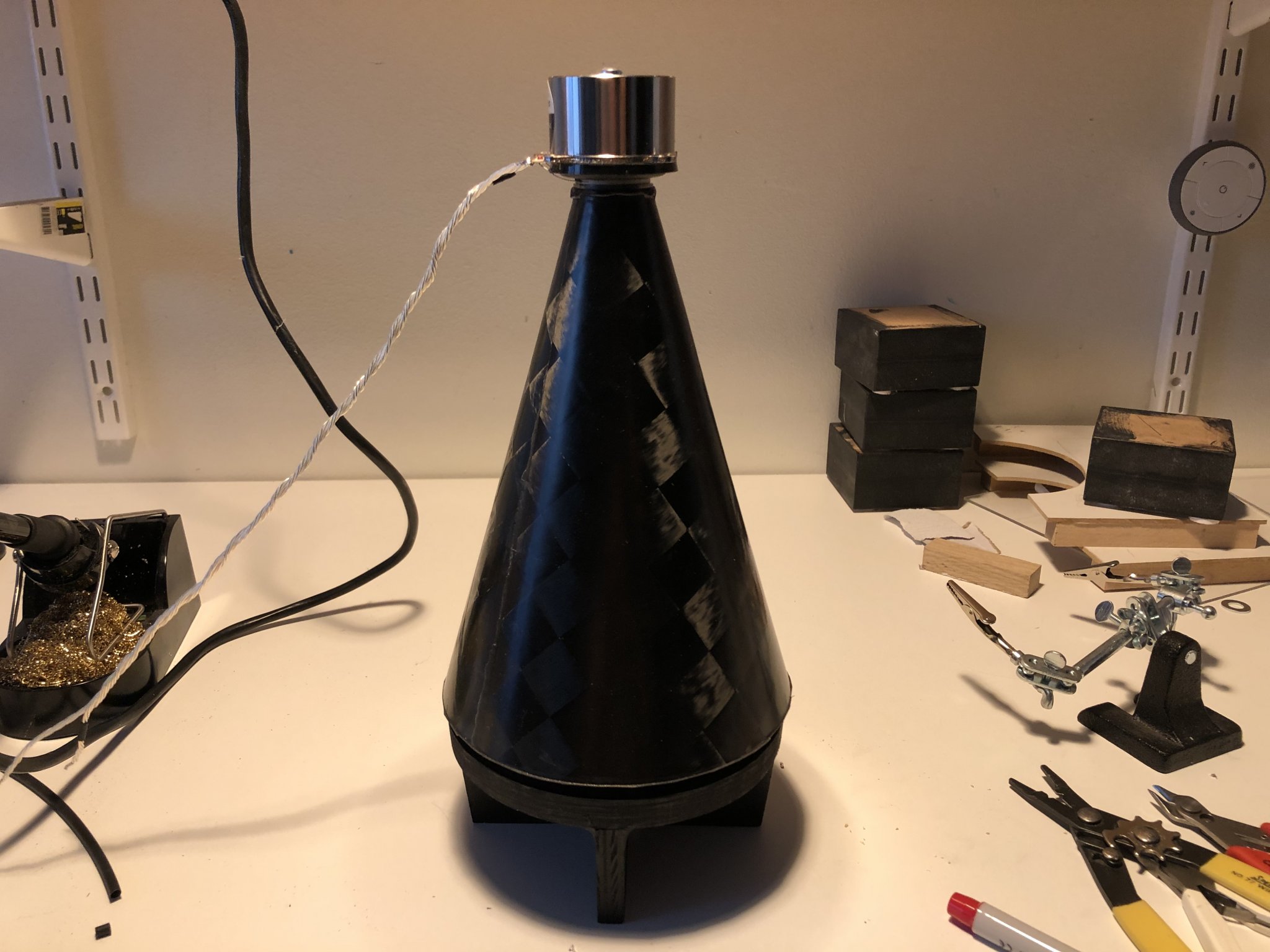

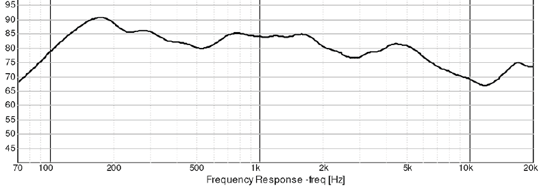

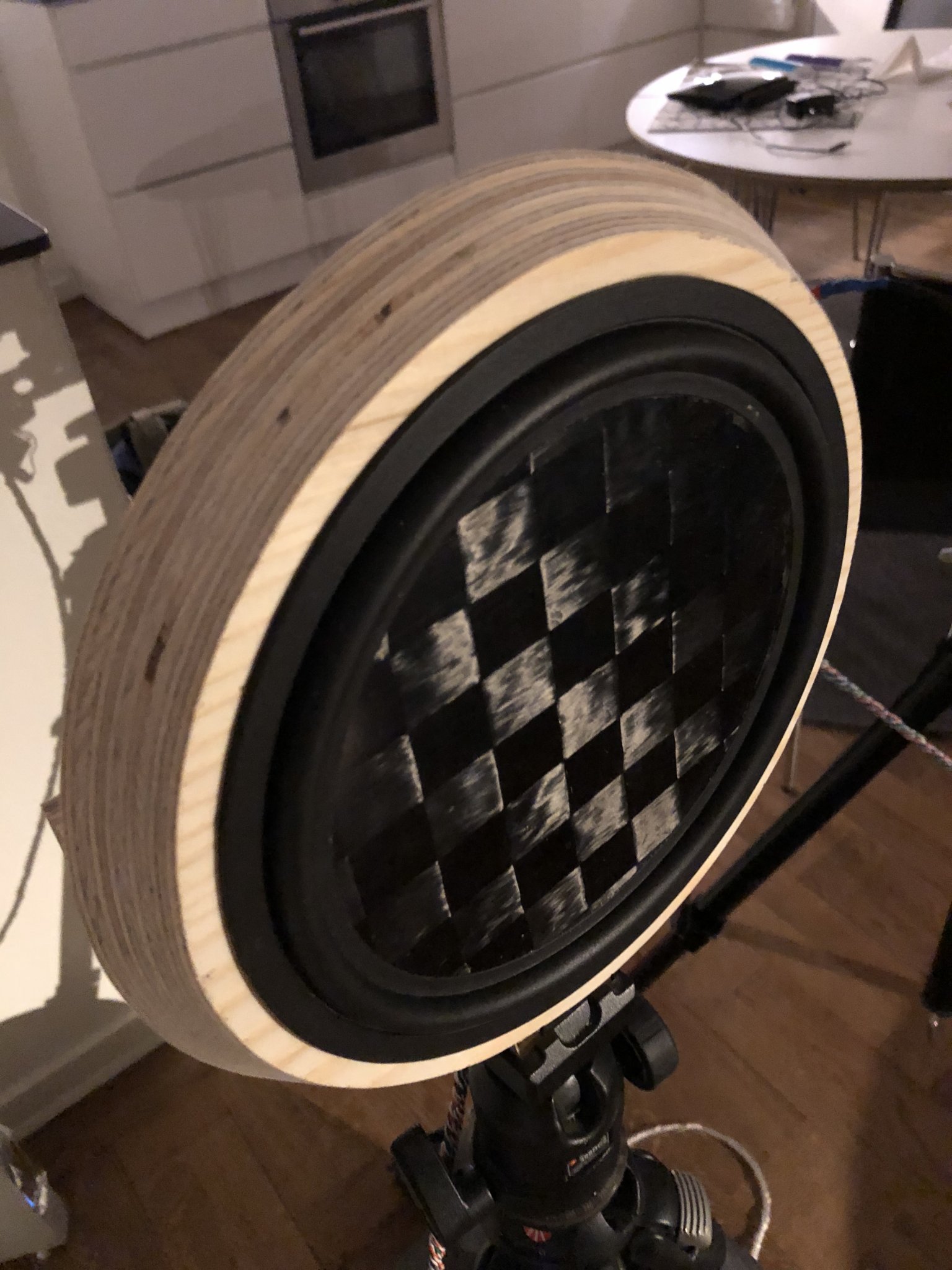

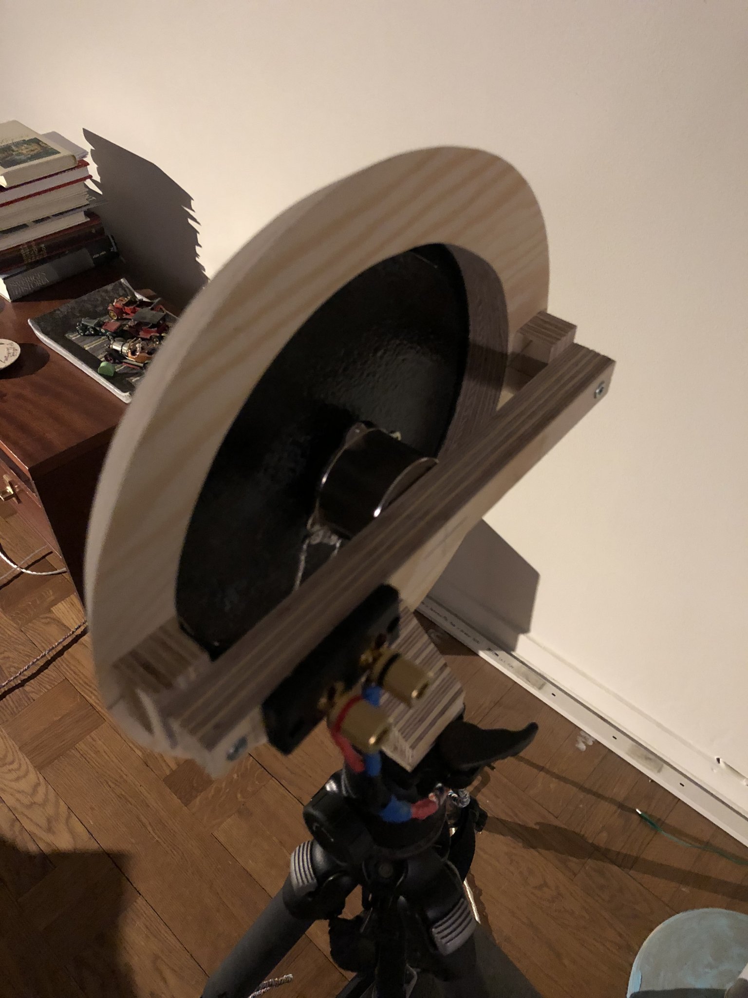

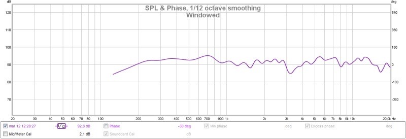

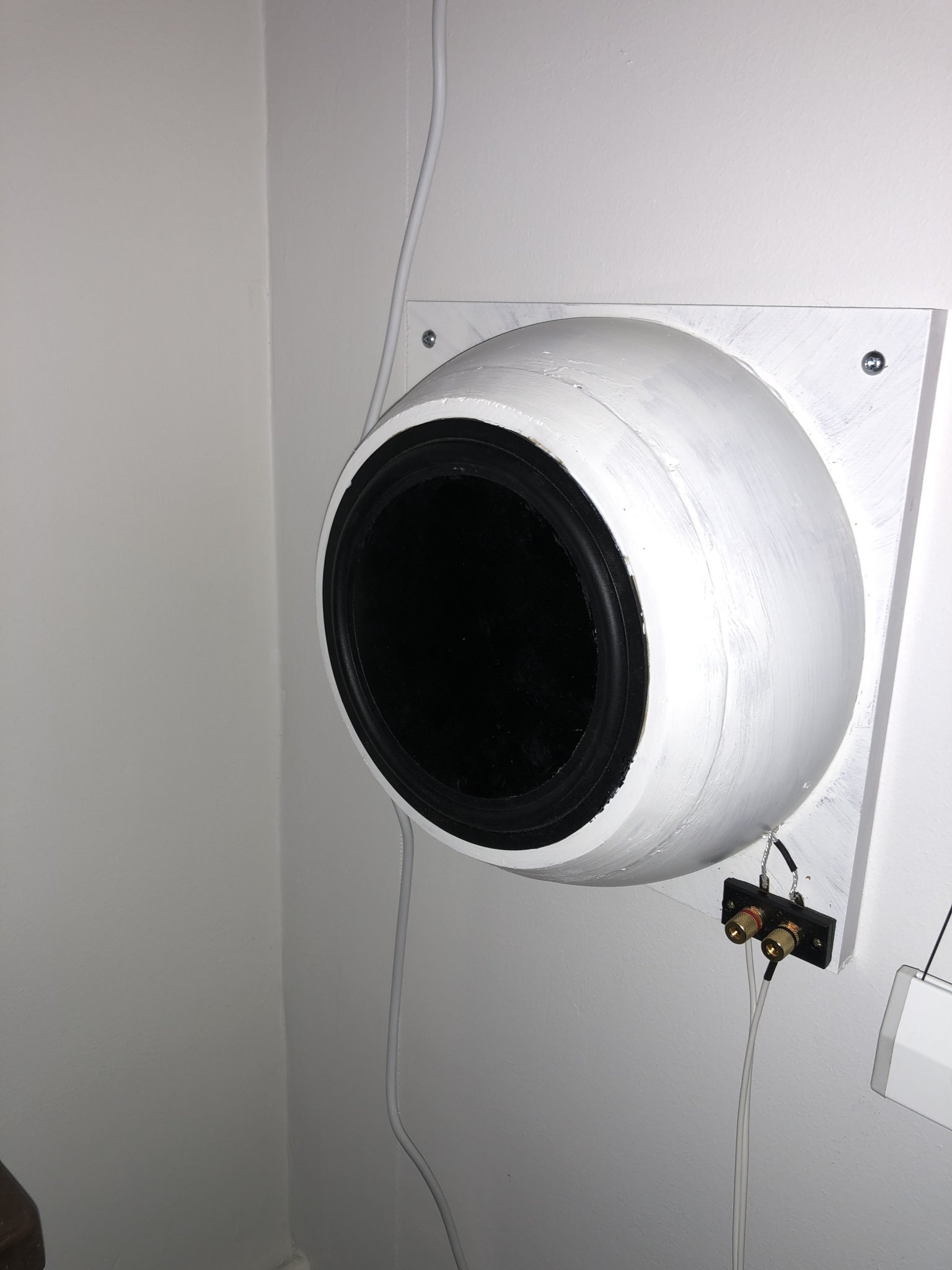

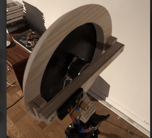

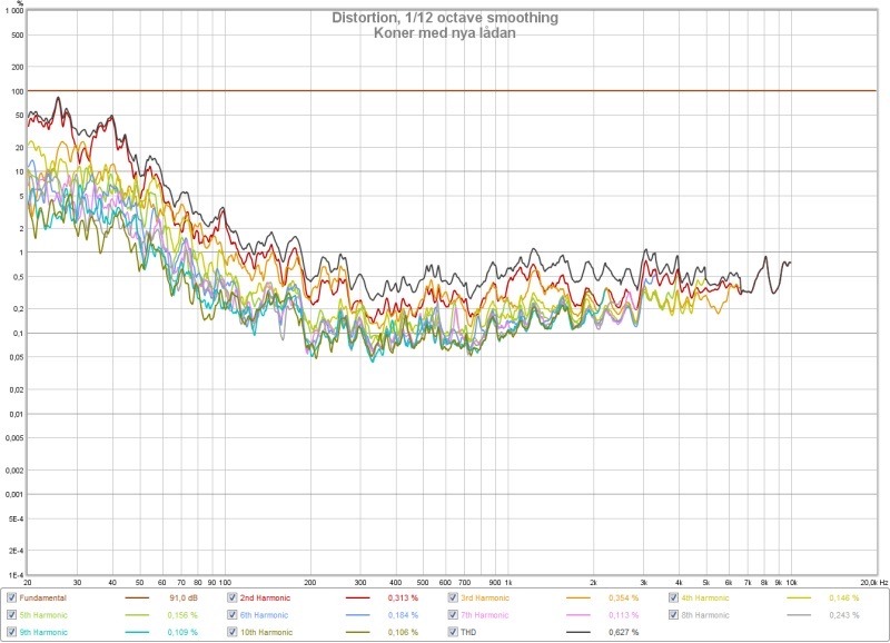

I have used DAEX25SHF in a number of different projects. It’s powerfull and generates a clean sound extending up 20k.
The measurement is from the white round one. It’s an 8 inch panel playing both as DML/bending wave and pistonic i.e. a bmr.
The smaller round ”woodcoloured” is used as center speaker and lying flat on a bench which work very well due to the DML sound dispersion.
The measurements are from 1m.
It is a really nice exciter!
thomas

Thomas,
Are those BMR's as simple as they appear? Round CF sandwich panel with a normal surround, attached to round frame, with exciter mounted dead center via a spine? In the image below, the back of the panel looks different from the face. Is it just a different CF fabric, or is there more to it than that?
Very cool, as always.
Thanks,
Eric
Thanks,
Eric
Thanks!
yes, they are. It’s my ”standard composite” cf balsa cf. They rough backside is from the breader when I vacuum press it.
And they are in a closed ”box” which is a sallads bowl from ikea…
thomas
thomas
