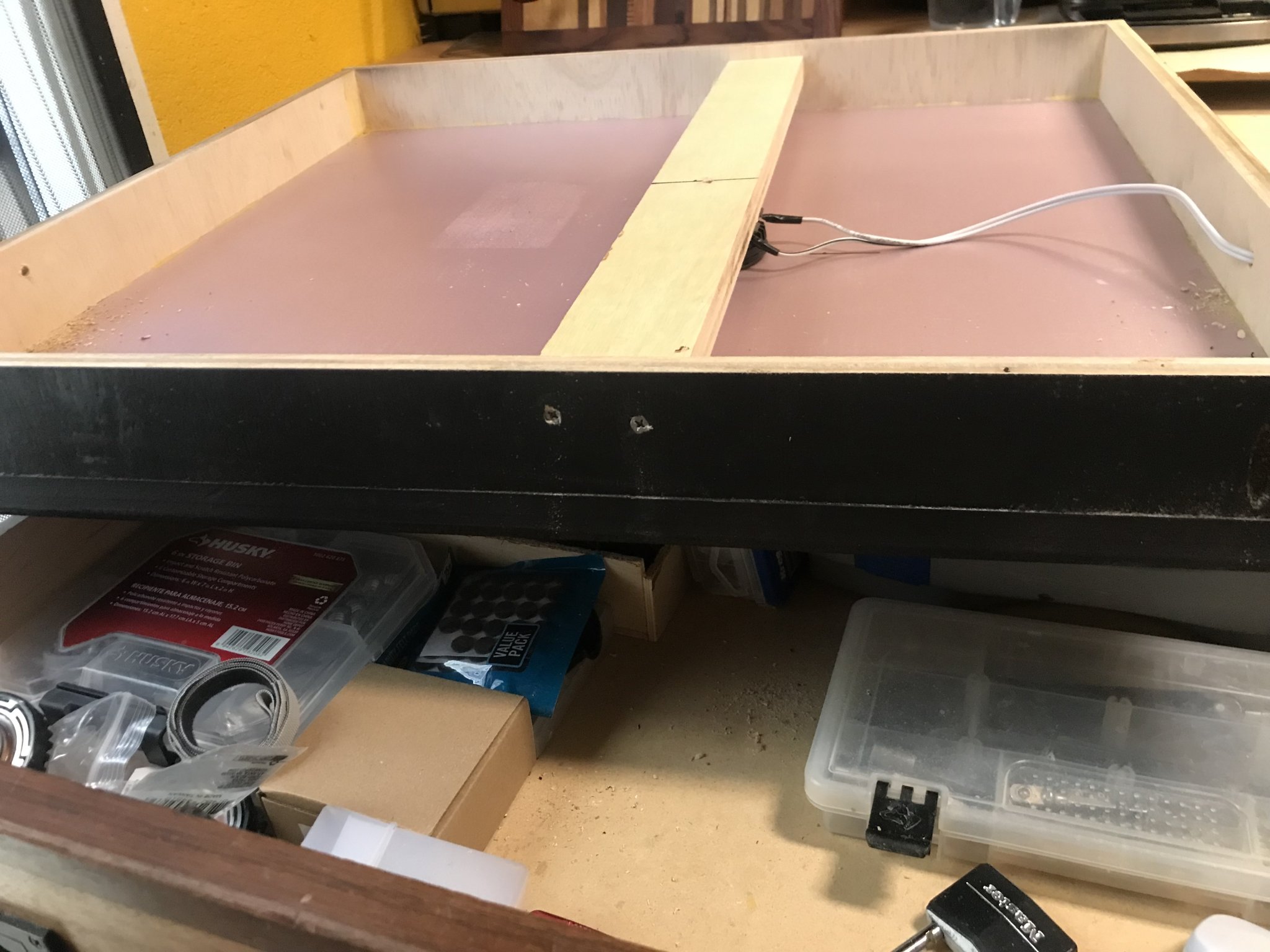

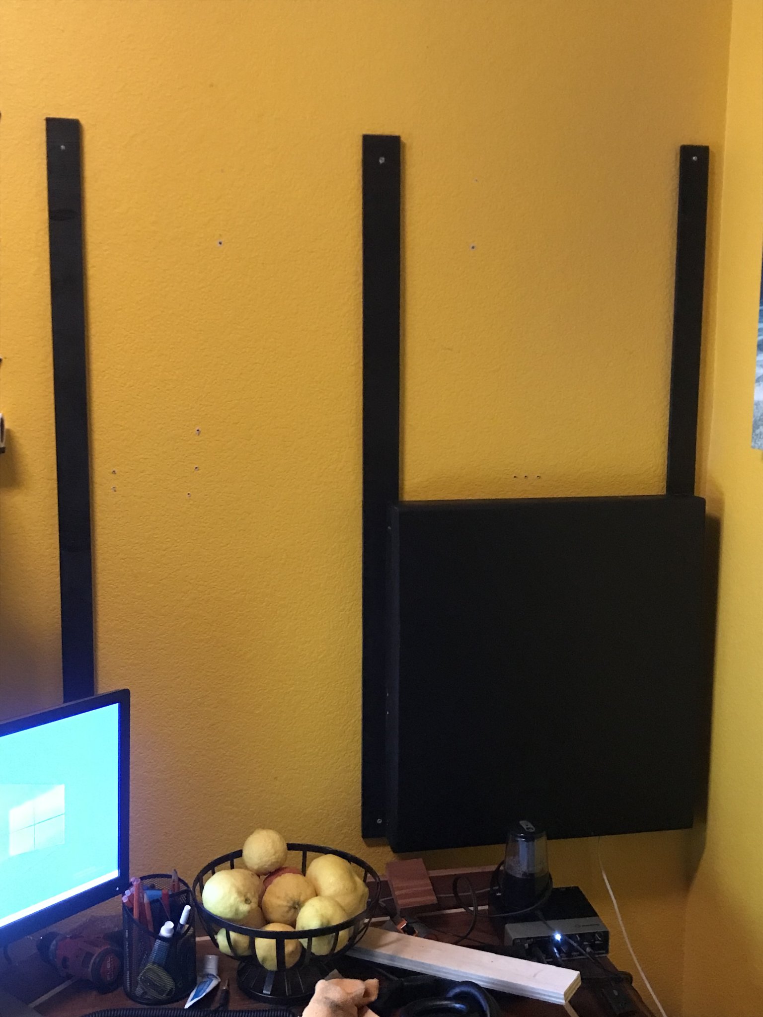

Been a heck of a week, but making some progress. Speaker one of four is finished and mounted. I ended up using the threaded hole, and inadequate as that screw is, with soft double-sided tape on the other side it seems to hold together pretty good. I'm attaching the frame to the strips on the wall via pocket holes in the frame.
There is one big problem mounting the panel up close and flush with the wall.
This will cause heavy cancellation and compression of the sound, this will reduce (remove) the response somewhere below 500hz.
This is easily solved by pulling the far edge out from the wall a few inches or more.
Similar to toeing in a speaker towards you.
I would put stiff hinges on the left supports and do away with the right supports.
You could then move the sides in and out To your preferences.
Believe me the sound will be 100 per cent improved, even with the side wall so close.
Steve.
It will, or it should in theory? 🙂
I have the second one up now, that first one may have a construction issue, it sounds fine, but the second one, to the left, is the best I've made so far. The bass is fantastic (compared to my others). I haven't measured with my limited phone app, but when testing the original quick and dirty frame model, it was hanging on the wall and 80hz - 120 hz was pouring off of it. I may get a mic for the purpose later and do more technical testing, and if I find a problem I will try moving it out a little, but that would be just for a test as there isn't room to bring them out. I've considered filling the box with insulation or something to dampen the back waves, I've actually experimented with that prior to the boxes but couldn't hear a difference. well, that stuff would be a second improvement round, I can see my biggest issue for now is getting 4 speakers all of roughly the same quality going.

I did make a recording of me moving the panel in and out from the wall so you could hear the difference compressing the rear wave makes.
But if you cannot hear the difference, never mind, it is your setup, not mine.
Happy listening.
Steve.
Spedge,
I didn't say I can't tell the difference, and I hadn't stumbled across your recording in this sprawling thread. My third panel is done, glue dried overnight and tested it this morning. It sounds better than my second panel (mounted), was leaned against the first panel and I had it in mind that it is a few inches out from the second, and has panel one behind it. The bass is better; or at least, thicker. So I did the test of picking it up and moving it to the wall. It definitely does make a difference, but doesn't make it sound like speaker 2. Then I dismounted speaker 2 and put (unfinished) panel 4 behind it. Speaker 3 still sounds better to me, speaker 2 is a little punchier though and at about the same volume level. I don't think there is anything wrong with it, my guess is that they are two versions of the thruster exciter, the newer version that twists off the base sounds a little better. I'll confirm that by sundown as I have a final panel to build with the newer thruster version.
So yes, distance from the wall definitely made a difference in the test this morning, I will have to do some experimenting with damping once I get other factors under control and see if a little space is worth sacrificing.
