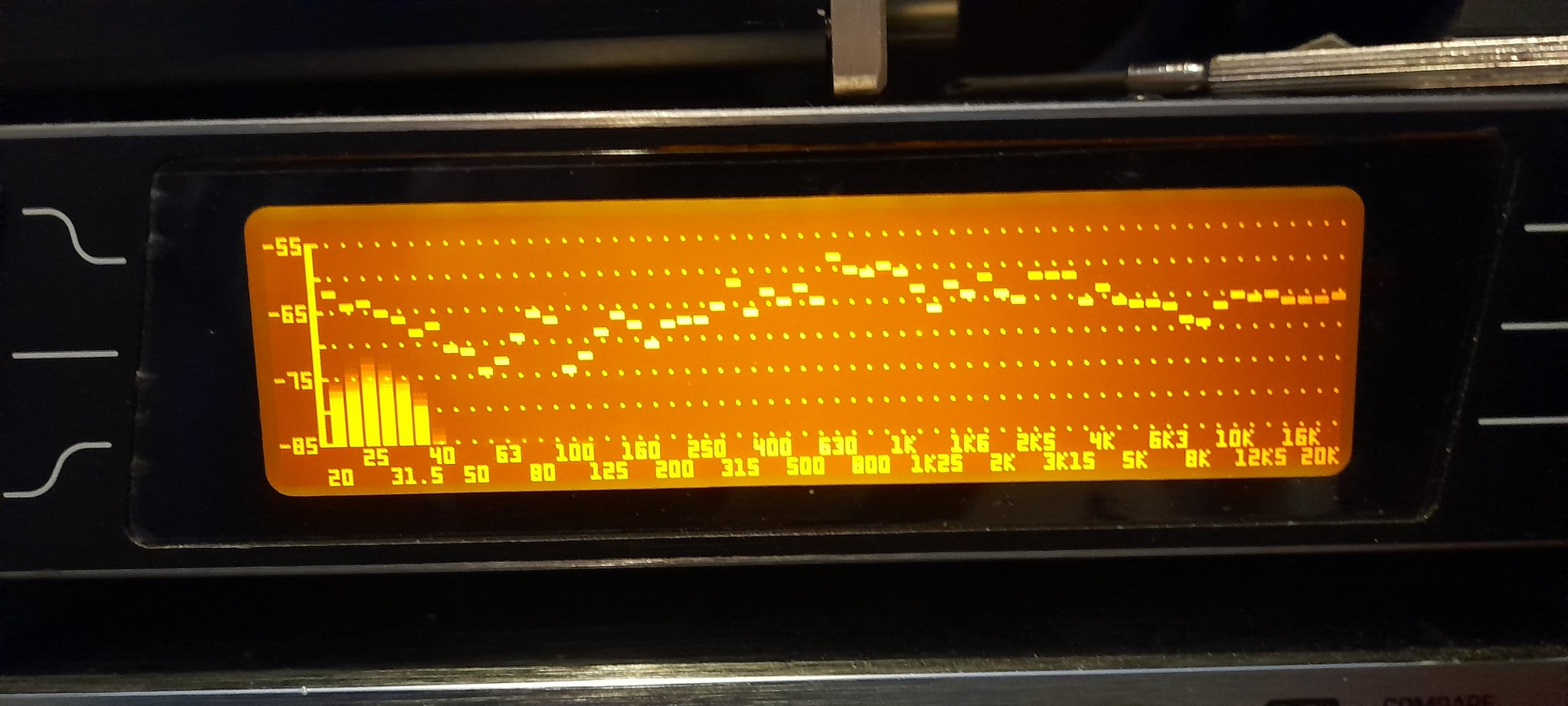

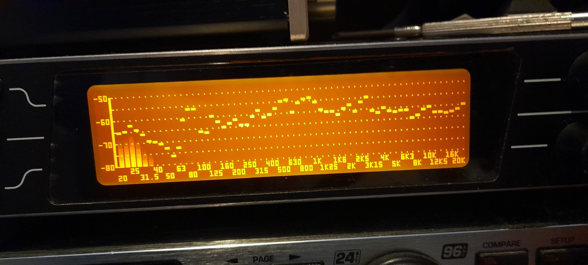

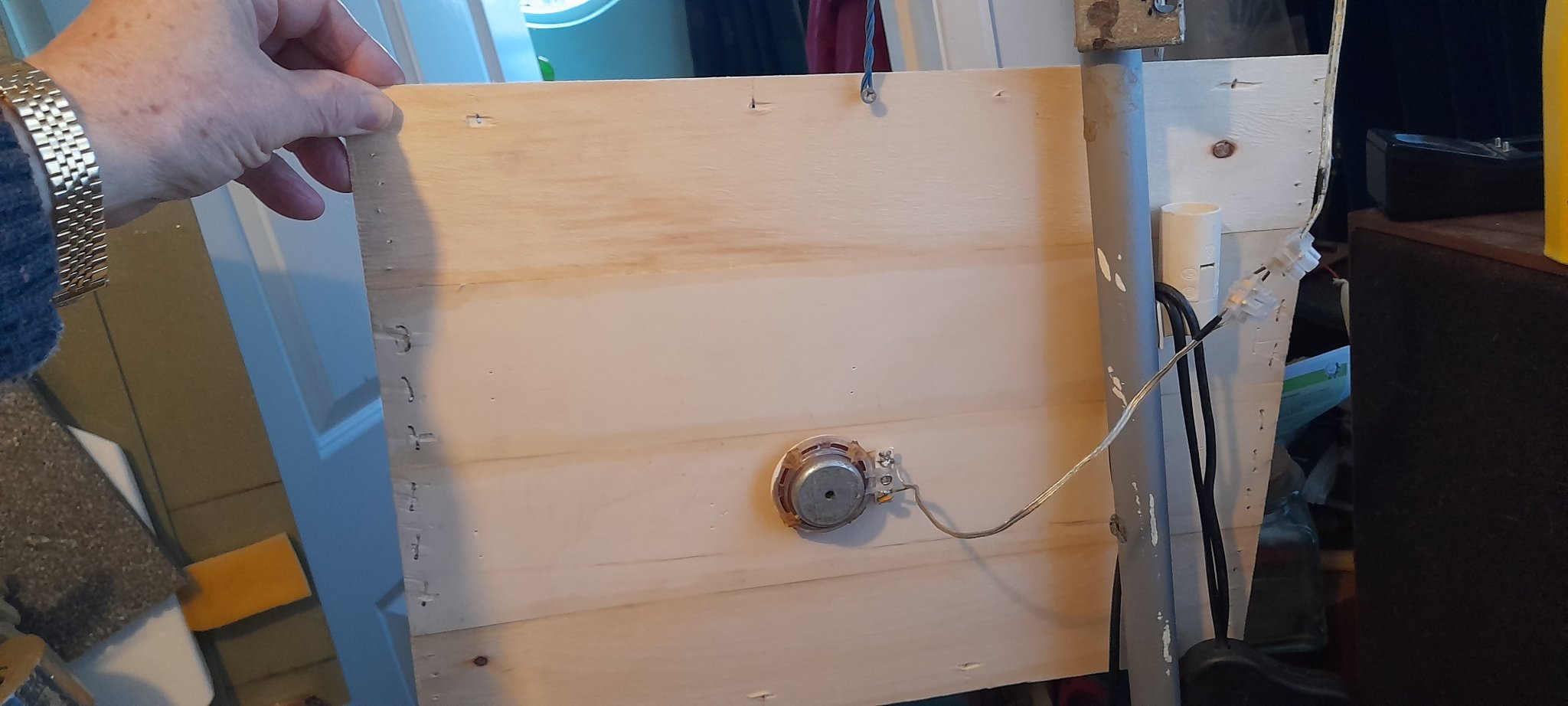

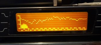

The closest panel size i have to the one you mention is 17inches 13 inches I made this from strips of 3mm ply from crates .
The second picture is from 3m into the room I believe and the third is at 1m if I've got them the right way round.
Everything below 50hz is traffic noise and my big feet 😁

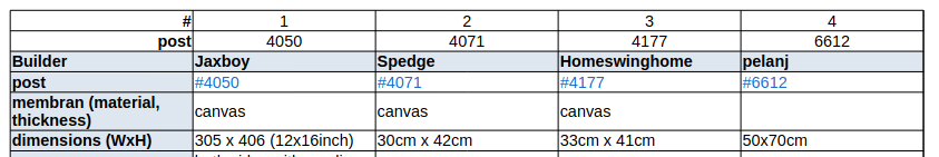

- What size and shape of canvas should be used? For DMLs made using materials such as XPS it seems to be common for them to be close to square, however all the examples of canvas DMLs I've seen have been more rectangular. Is there a reason for this?
Have a look here Github DML page. The first document is a kind of history file. There is a table summarizing some canvas realizations. Extract :
Not sure it was the result of deep design investigation but more obviously copies... Canvas for painting are also mainly easy to find in rectangular shape. The canvas being identical in both directions, a square shape is not a good idea leading to have modes with the same frequency.
My current choice is DAEX25-4FHE. It is 4 ohms. I would have preferred 8 Ohms not because of the amp but because of the cut off frequency due to the inductance with the voice coil inductance. I won't worry about the impedance viewed by the amplifier. About the legs, no experience. What we read here is they are generally cut.I think I've settled on using the DAEX25 exciter, both because of price and because they are 8ohms which means they are above the minimum impedance of the AV receiver I plan to use them with. I've seen some people cut off the legs from these exciters, should I do this?
As for the proportions, there are not so much variants of this design so few experience. In mine, it is rectangular. The variant is to be with real balsa. It works but the others are light plywood. In posts with Spedge, we understood what he thought to have bought balsa was in fact basswood... probably a good choice.What size and shape should the piece of balsa between the exciter and the canvas be? I've seen both small circular pieces and larger rectangular pieces being used, does it matter?
