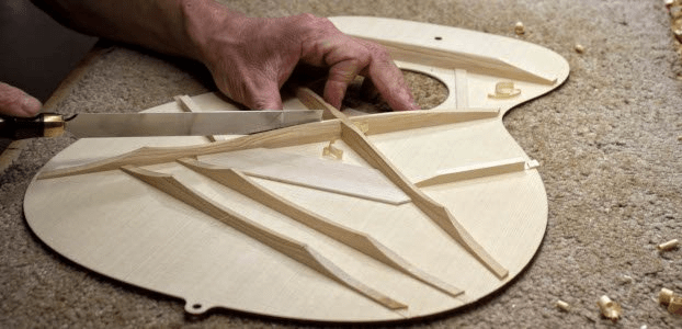

The braces in a guitar or violin or piano, or almost any other acoustic instrument, are shaped in such a way as to completely kill the reflections from the end of the brace.To be sure I understand it, by spines you are referring to the support for the back of the exciter, and not panel bracing correct? I saw some discussions about trying to tune the panel response with classical guitar style bracing but I don't think that is what you are referring to.
Note that those braces are applied directly to the vibrating panel.
I've seen experiments (I cannot locate the videos! 😭) where an aluminium square rod, cut off square, will ring like a wind-chime when struck with a hammer.
But when shaped to look like the guitar braces above, the same size bar does not ring at all. It's completely dead! Like a piece of soft wood. I've messed around with braces shaped like this extending from the drivers to the panel edges, but did not spend enough time to get conclusive results.
Those spines or supports not touching the panel, attached to the frame, are used for supporting heavier drivers (with M3 or M6 threaded holes in the magnet under the stickers) because of the voice-coil sag factor. Smaller drivers will have plastic legs to support them, and the smallest drivers depend only on the voice-coil adhesive and the strength of the spider to support them, and don't need anything else.
Larger magnet/driver structures usually resonate at extreme low frequencies (10-35hz depending on the weight of the magnet and the stiffness of the spider material) and it actually makes no measurable nor aural difference whether they are supported or not—DML panels rarely perform well at sub-bass frequencies. I prefer to fix the magnet to a spine whereby I can limit the excursion of the panel and get control of the panel movement at low frequency and high SPLs (+/-3mm @100Hz). This would be analogous to blocking the port on a vented speaker cab to limit the speaker cone excursion below port frequency (usually around 45Hz) to prevent the cone tearing itself apart at high SPL.
