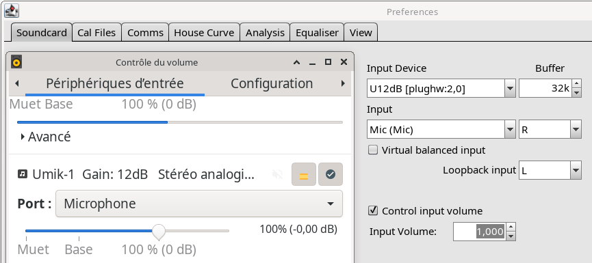

I don't have a clear understanding of the complete software chain working in a laptop on the audio chain so I am just cautious about how the different possible software volumes can be adjusted or even modified from one day to another one by the different apps calling them.REW mention no need to calibrate usb mics to do spl measurements in the section where they go through mic calibration.
In Manjaro there is as I think for most of the distribution a mixer available but since recently, it seems it no more operates on the selection for REW. I am not expert enough in whole structure but changes occurred (like to new library like pipewire?).I'm using OpenSuse 15.1 and that has been offering sound device selection on the desktop since 2019
Nevertheless, it works. Just not sure about the full volume chain is Odb. The useful tool might be an USB mic in calibrator. Something like a mic from USB point of view but sending a fixed defined signal.

thank you for this exchange AJohnL. Thanks to it, I have verified what is in REW manual for USB mic (long time without going into it...) and so the "volume control" option that would set the volume chain at the desired value. The effect is visible in the desktop mixer but also in the alsamixer window that seems confirm REW is connected directly to the Alsa output not any additional software layer.

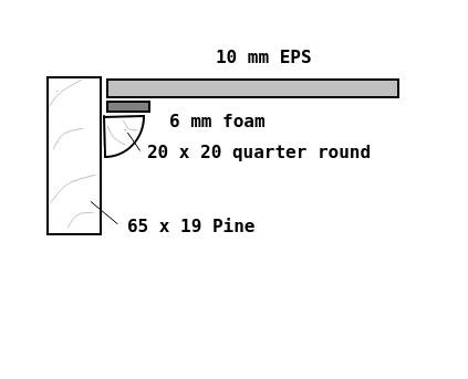

Do you have a clear assembly strategy with the 28 kg3M EPS or still in the stage of manual evaluation so you can map out the design around the initial performance ?
My anticipated framing method for the EPS to get a reasonable visual aesthetic as per sectional drawing below , 6 mm foam glued to the EPS and the quarter round pine trim , quarter round glued and nailed to the 65 x 19 framing.
That framing should work well and will look nicer than setting it on the top edge. And if you decide to clamp both sides of the EPS later on (some do) you can still do it. Be sure there is a nice gap between the edge of the EPS and the inside face of the pine. I'd want something like 3-5mm. I would also make a couple of minor tweaks to the wood, like rounding the edges in red (see below). It is not necessary, just a hedge against edge rubbing and splintering/flaking.
I would also recess the EPS well below the top edge of the pine so the pine frame can be wrapped with speaker cloth later on without the risk of the cloth interfering with the EPS.

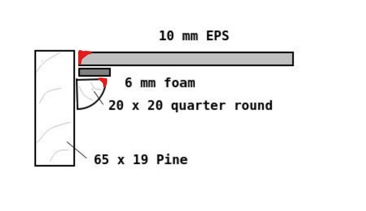

Earborne,My anticipated framing method for the EPS to get a reasonable visual aesthetic as per sectional drawing below , 6 mm foam glued to the EPS and the quarter round pine trim , quarter round glued and nailed to the 65 x 19 framing.

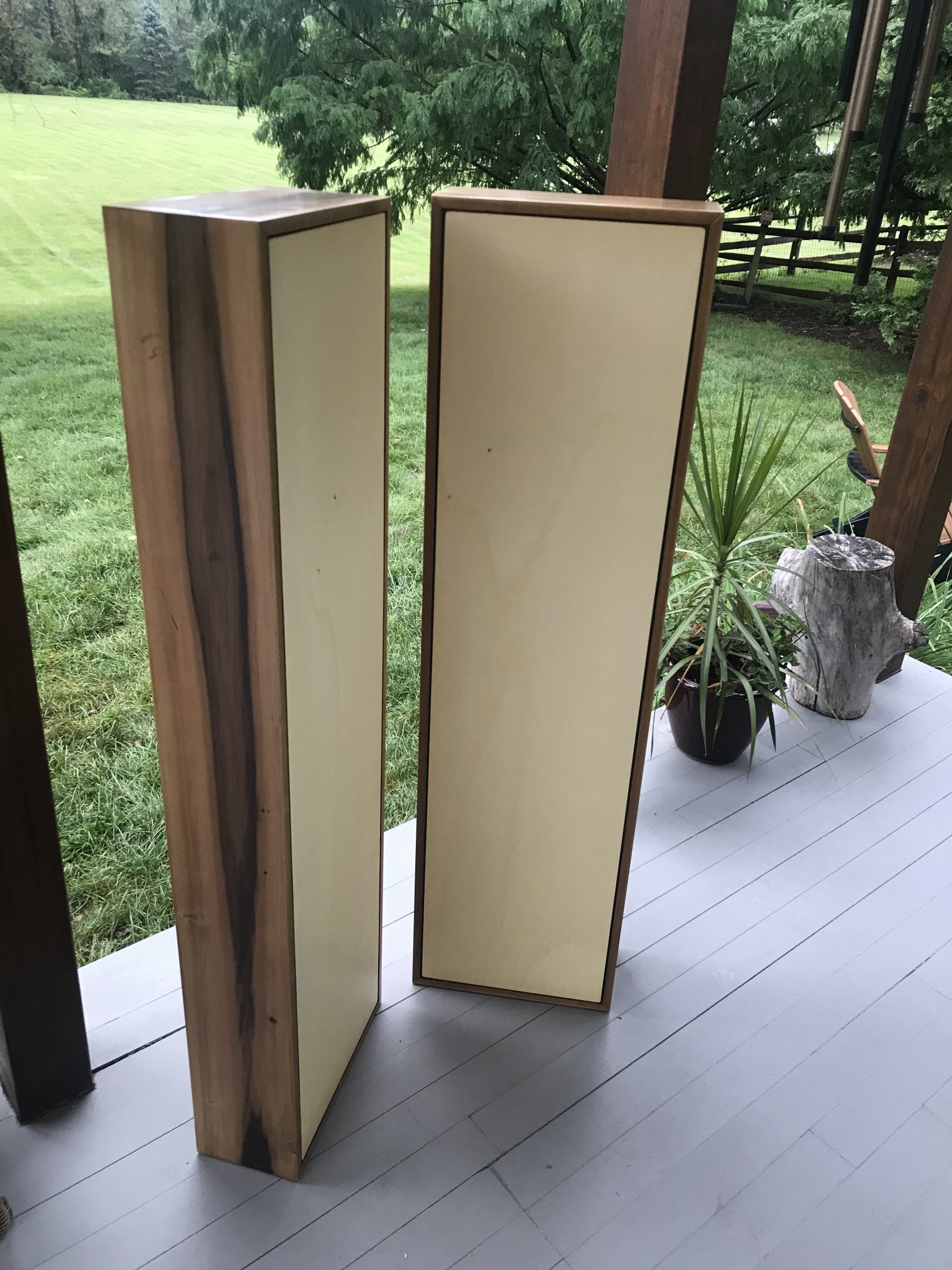

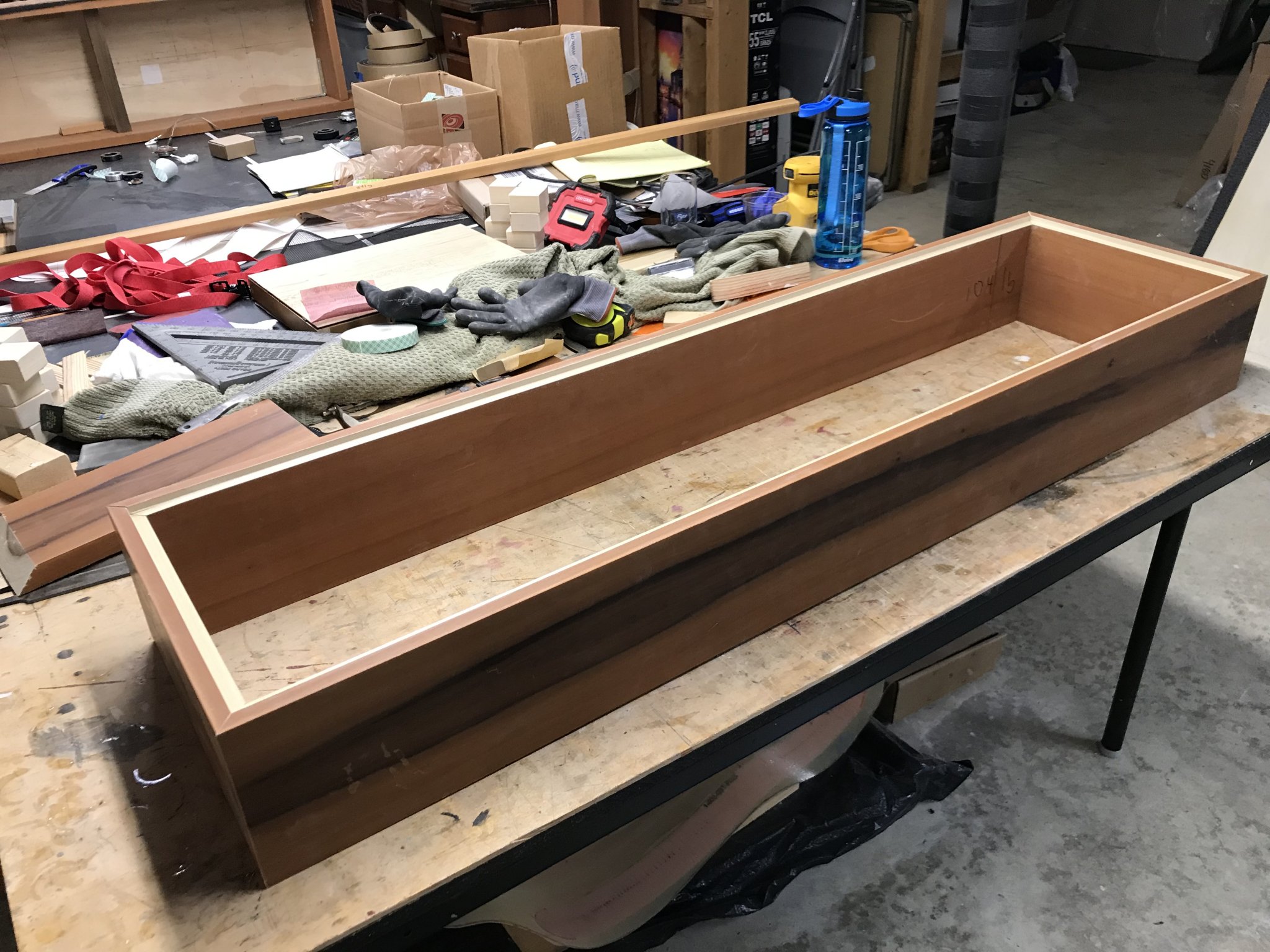

I like it. That's basically the same framing method I used for this pair, only I routed the inside corner rather than add the quarter round. I think recessing the plate a bit like Deude suggested is a good idea to protect the plate (especially if its PS).
