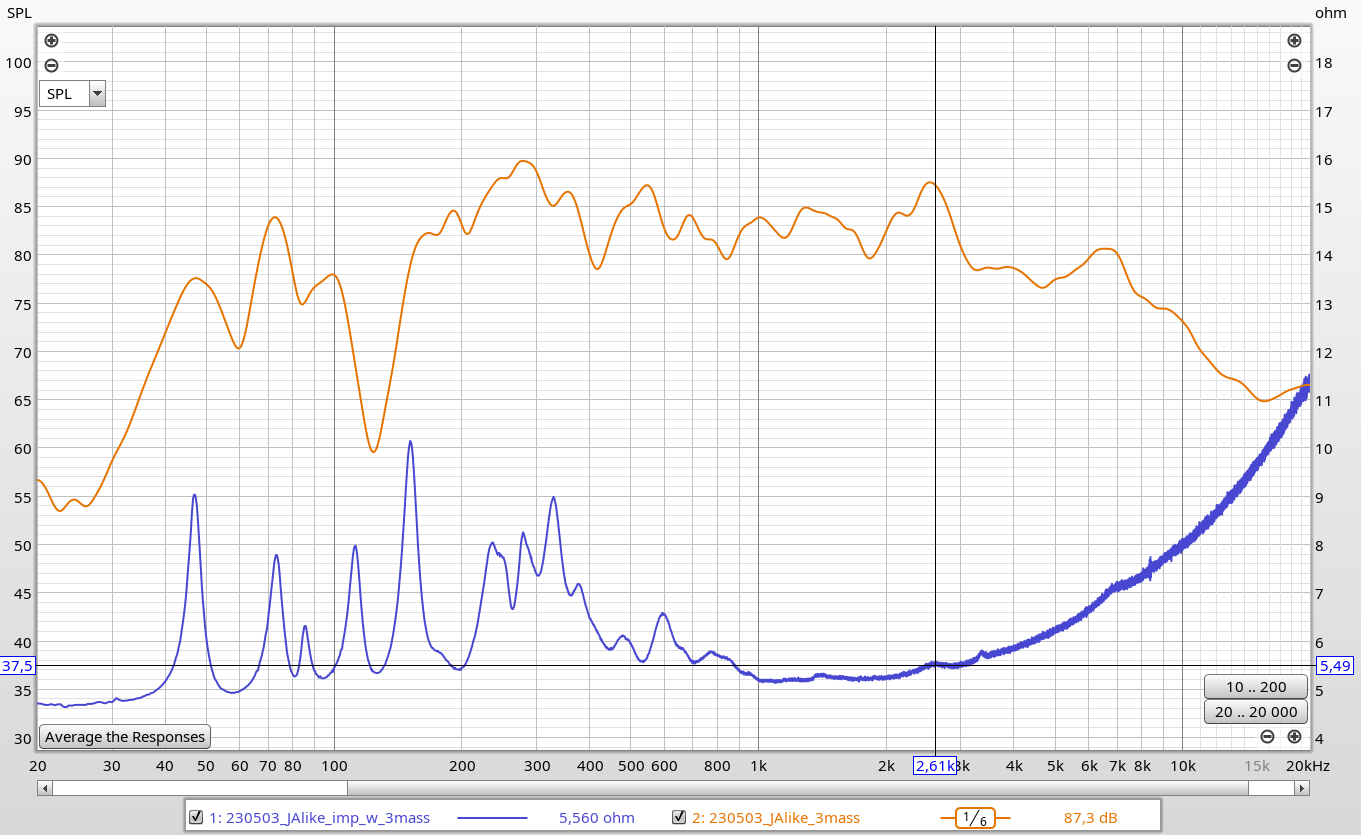

Hello,
If it can have an interest for somebody...

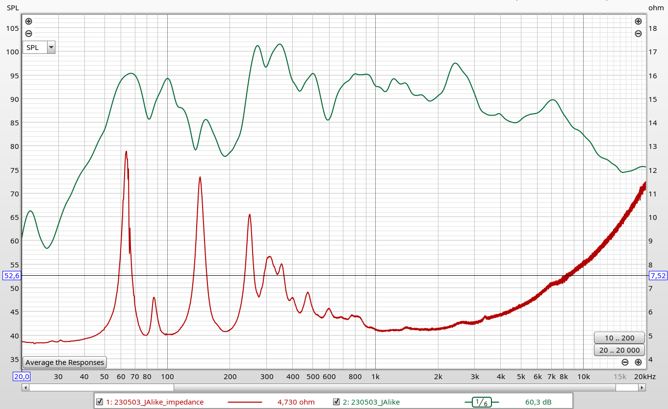

After a long time on the theoretical approach, I decided to start a new pair based on the use of a 3mm corrugated polypropylene I got recently. The goal is to explore ways I haven't explore for now with the idea to end with a realization that gives decent music.
I learnt from a first measurement cession few thinks I would like to share :
  • to make this design different from my previous one, I decided to start with a non rectangular shape, inspired from the Yamaha JA natural sound speaker series. For now, I can't say there is an advantage...
  • an other difference from previous design is the material. Polypropylene seems to have the advantage of a good damping given some not too irregular FR. It has probably the drawback of this advantage which is a limited HF extension. Not a problem here, I will test with a tweeter. A question might be to understand if a smaller panel still have this problem (to be confirm by the impedance measurement but the 1st resonance is perhaps unnecessarily low.
  • those tests confirm there is little difference between the FR from a logsweep (standard REW measure) and from pink noise with a 1/6 octave RTA. The interesting consequence behind that is the pink noise with RTA is a continous measurement so it is possible to start it, make changes or researches and see immediately the results. This I think is the way Steve use to adjust his panels. Today, it helped to find place to add mass in order to mitigate a 300Hz hump.
  • to add mass was already mention in this thread but as far as I remember not in detail in the way to proceed neither in the results. By the way, I just recently understand that most (all?) of the DML commercial realizations have such mass corrections
  • even if not used, a tweeter is a good tool to evaluate the efficiency and check the HF extension of the panel.
  • the origin of the hump at 2.5kHz was more difficult to find... seems due to what Steve called the exciter noise. In my plywood panels, i thought the origin of sch hump was due to the "too large" exciter fixation I had. Seems not as here, there is only the exciter at the back side. So beware of the rear wave. My intention in the next steps is to see if some solution is possible. At least the today measurements give a method to check the origin of such hump. For now the best countermeasure (only from measure point of view) is to attenuate the rear wave.
  • as I need some passive crossover in this application to limit the power going to the panel, I have tested a second order LC filter with the component I had... Not to bad result
So, by this end of today, it gives a panel going from 250Hz to a little bit more than 7kHz in a 5dB corridor (1/6oct smoothing) with a not too bad efficiency and omnidirectionnality... Far better than the previous small horn seated on top of this woofer, and for a for a low cost.
More detail in the attached pdf.
  • JA_shape_DML.pdf
Reactions: 3 users

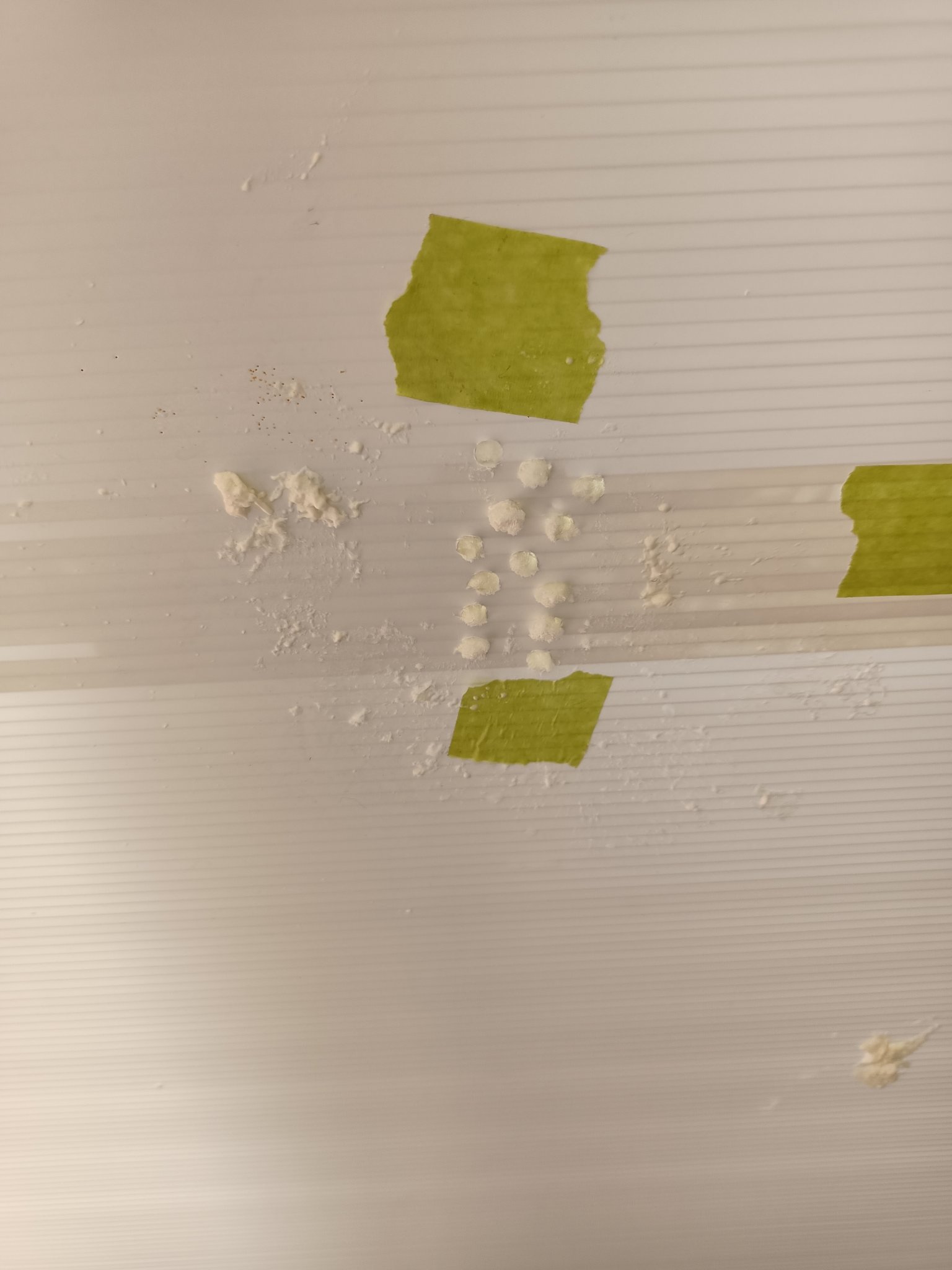

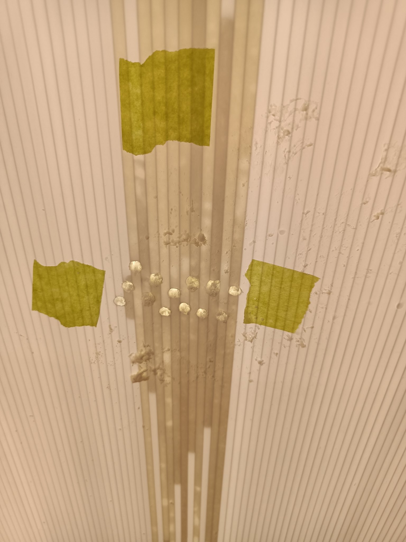

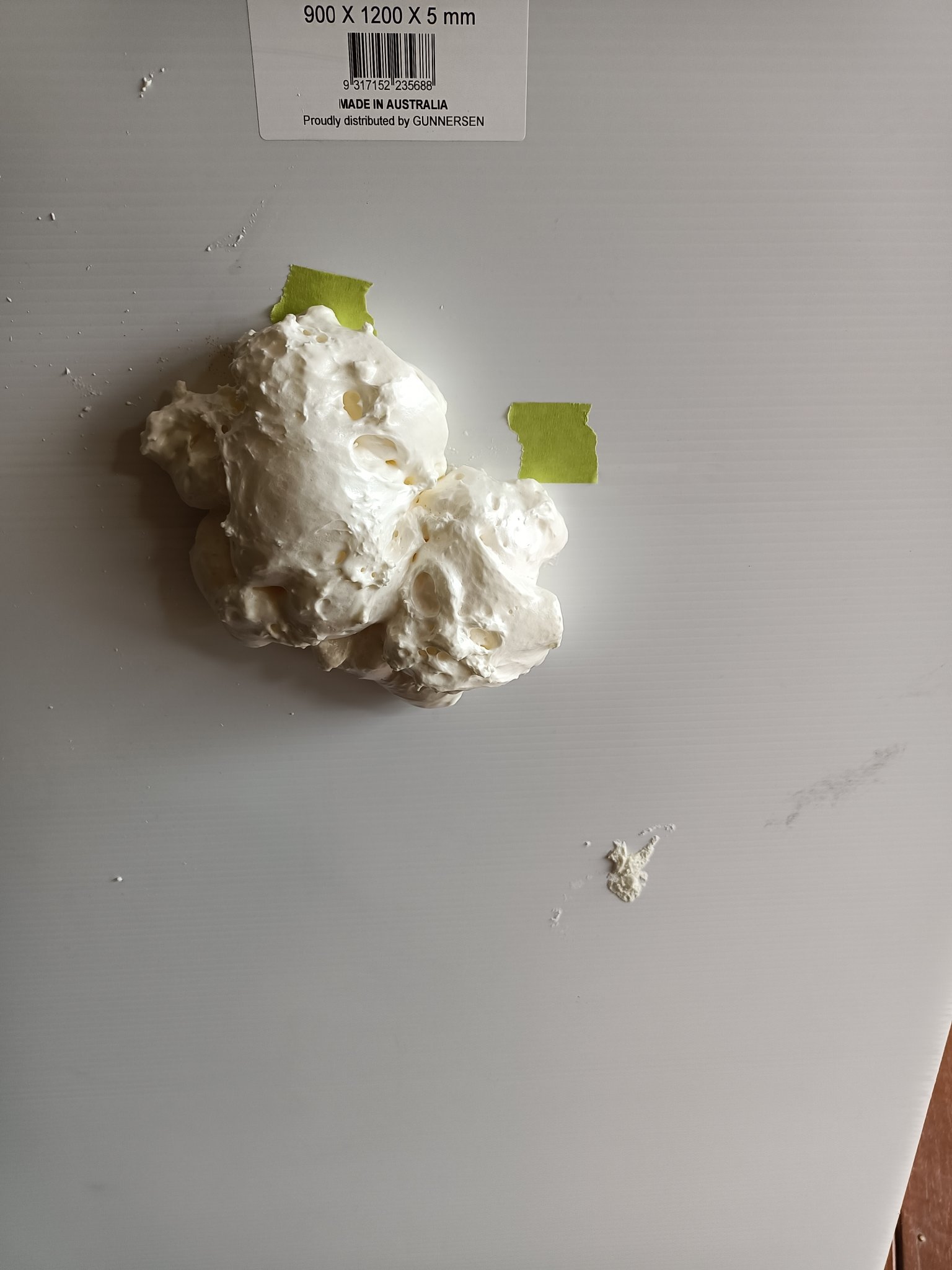

Another idea I had for PP and have commenced a trial of (suspended until I return home) is this:
At the location of the exciter, I drilled small holes in the rear face into each flute, moving the location of each hole so they don't line up. I then injected PU foam into each hole, and was surprised at how easily and far it spread along the internal flutes (see attached photos) It made a mess on the injection face, but it trimmed off easily when cured.
I haven't had a chance to test this yet but I'm hoping it will assist transfer to the panel and brighten the output.
With a more organised technique, you could even do a whole panel like this with way less mess/wastage. You can see by the changes in shading that the filling was somewhat uneven, but it was a rough first attempt and can be improved if it proves to be worth it.
When I get the chance I'll do a comparison test with an exciter both on and off the treated area

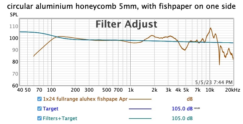

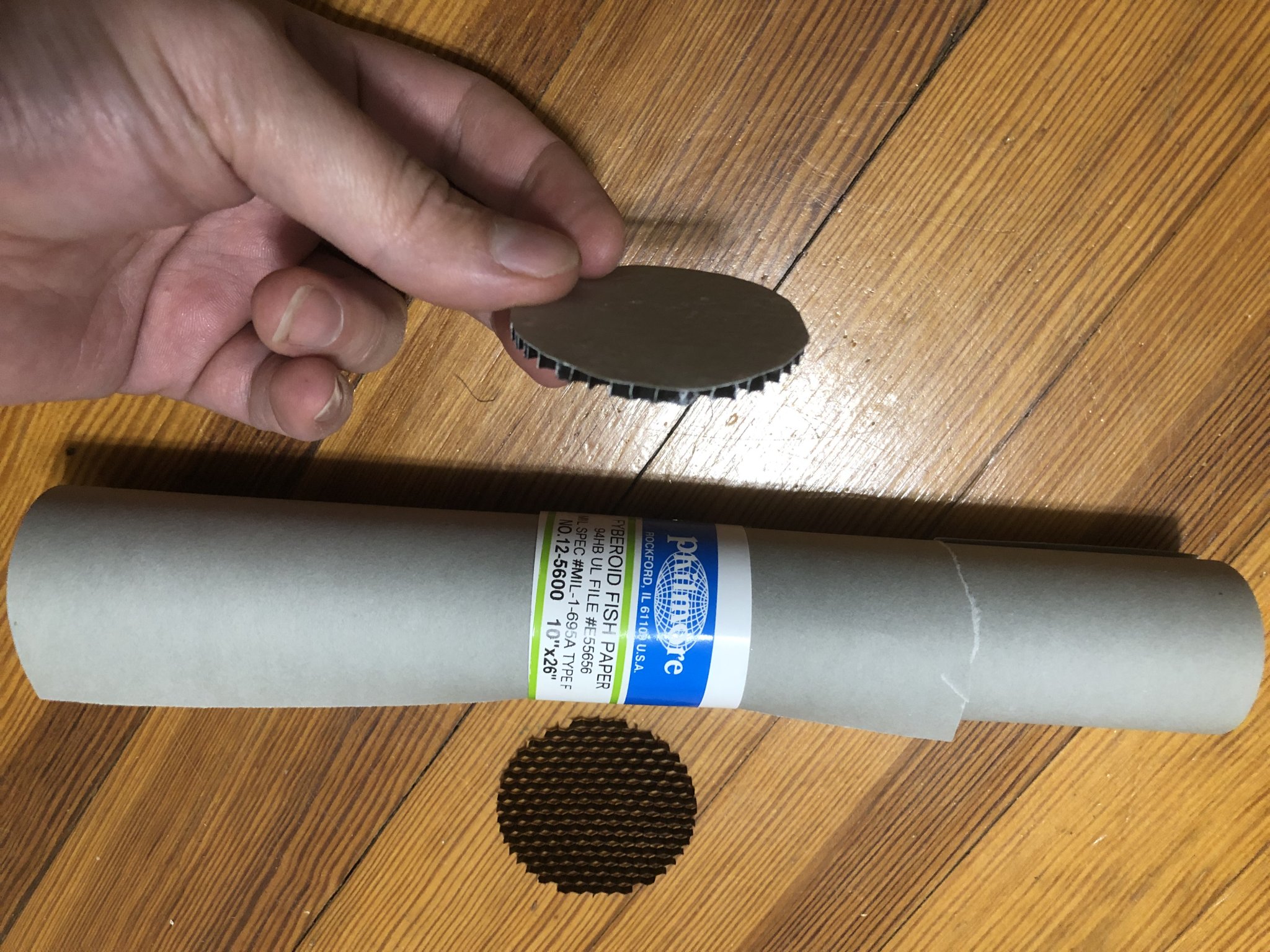

Hi, I have been following this thread for a few months.
I have been on my own material testing journey.
I have recently been able to get great results.
One is with aluminum honeycomb which has fish paper on one side.
Graph below is with the Dayton calibration mic at 10cm.
