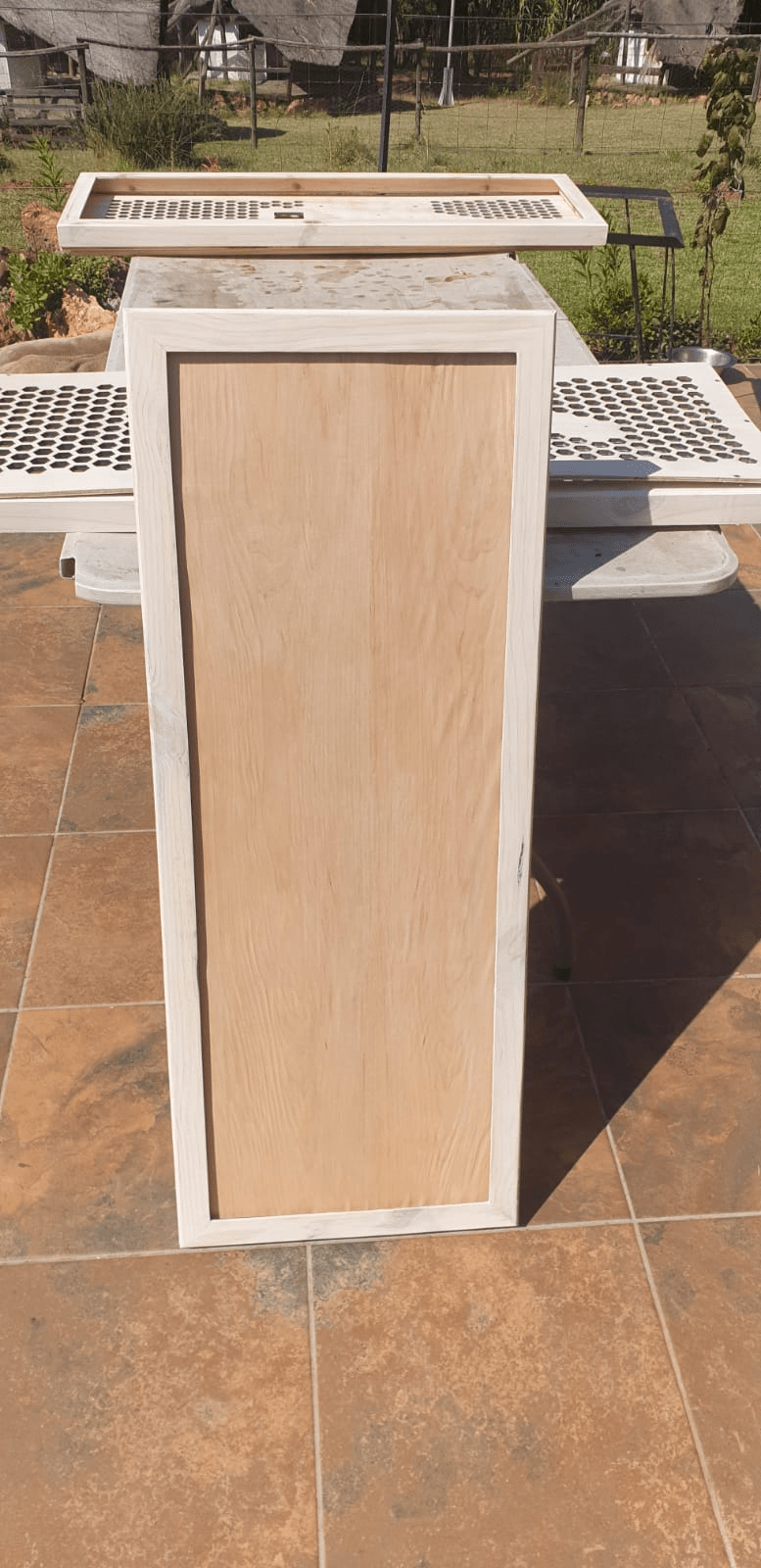

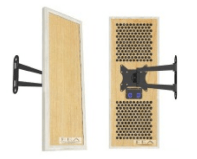

I've installed six panels into a new church near here. The panels are 1,000mm x 400mm. The membrane is 5mm EPS skinned with maple veneer, edged with weather tape in a white-washed pine frame. There are 4 x 25FHE drivers per panel. The back has a honeycomb holes laser-cut into it, lined internally with underfelt.
Front
Back.

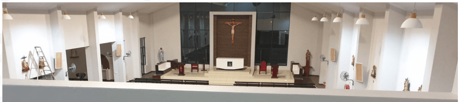

This is where you play 'Spot the Loudspeakers'
This place seats about 800 people, and it has NO SOFT SURFACES... The roof/ceiling is easily 15m high. RTA60 is more than 5 seconds!!
When standing even in the middle rows, it's extremely difficult to hear what somebody is saying (unamplified, no microphone) at the front due to the massive reverb. The panels did make a small difference to those in the first 10 rows or so, obviously more panels need to go up at the back.
I have advised them to get carpets, or tapestries, curtains or seat cushions etc, but they are completely against such ideas. Surprisingly, they're not so averse to installing acoustic absorption panels. We'll wait to see at the opening service if 500 or so human bodies make sufficient difference to the reverb to make the speakers intelligible.

Very nice work Andre, congratulations 👍
Questions:
1/Did you test a panel before installation?? If so what are your comments?
2/ is the veneer on both faces?
3/ how much gap is there between the panel and the underfelt?
Eucy
Thanks Eucy,
1/ I had less than three weeks from order to installation, to import materials, get the woodwork done, and build the panels. Unfortunately, I didn't even have a spare hour or so to do any response testing except to see if they would go loud enough.
2/ Yes, veneer on both faces otherwise 2nd harmonic distortion would go through the roof, and the panels would bend in or out depending on humidity levels.
3/ The gap is about 10mm. The panels are not mounted flush against the walls, and the back panel is perforated and damped to allow some of the sound through, and not to kill it completely. So the resultant directivity is more cardioid than omni.

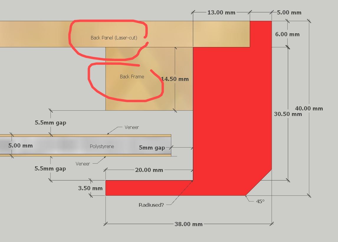

Would love to hear more details about your construction if you are willing to share.
Eric

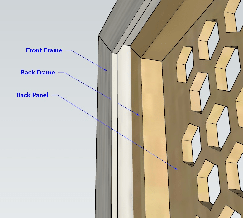

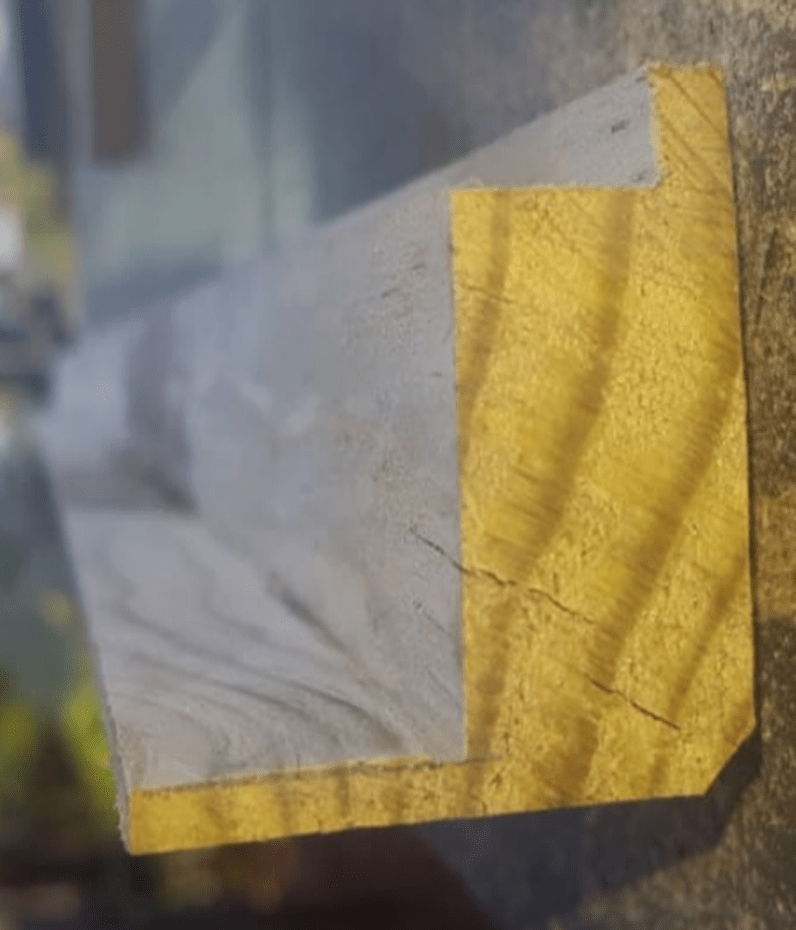

After I built the membranes (EPS/veneer) I put 12mm x 8mm weather foam all around the edges of the panels. It is then clamped onto the front frame by an internal back frame.
So the total edge thickness is 5mm for the panel, plus 2 x 8mm for the foam, = 21mm. There's an internal frame between the back and front frame allowing a 16mm gap, so the foam gets squashed firmly to hold the panel in place.

Further,
When the venue had a few hundred people in it the reverb problem was significantly reduced, as expected.
Volume levels were very acceptable without the panels drawing attention to themselves (as in 'THIS is where the sound is coming from!') As far as the audience is concerned there's no PA, and the guys on stage simply appear to project their voices very very well.

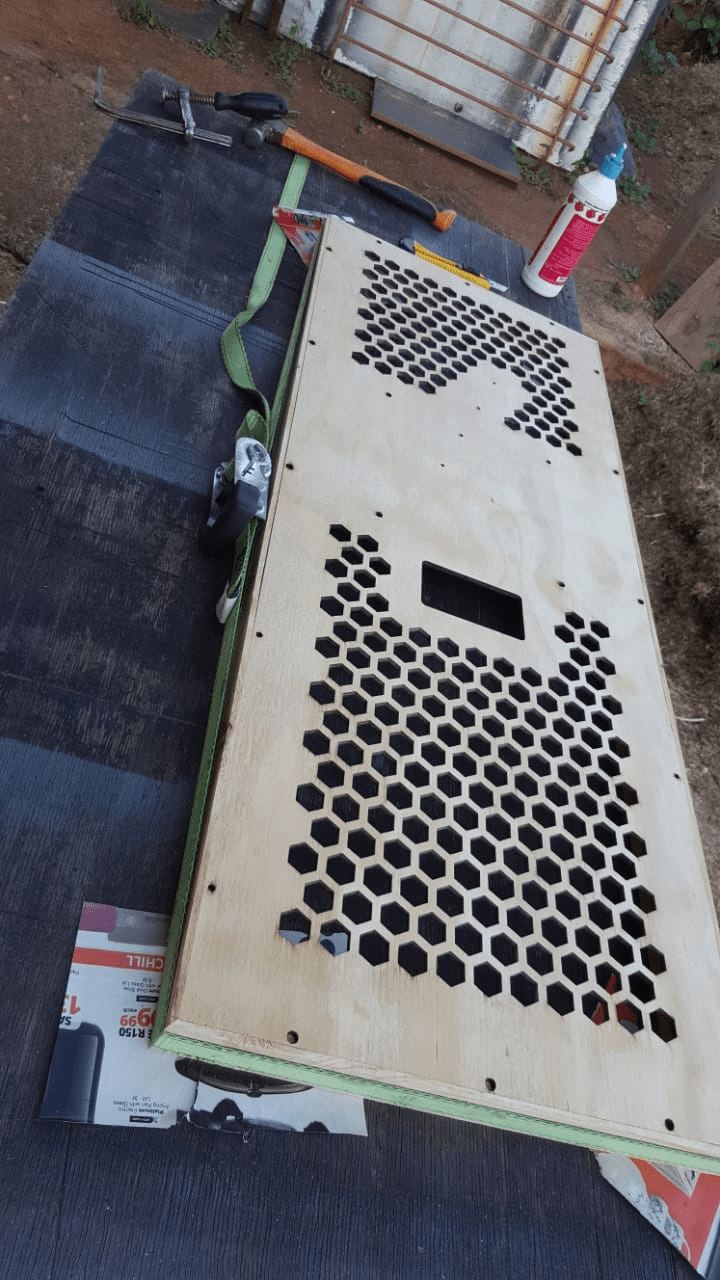

More detail:
The red bit is the outside frame.
Here's the whole thing without the DML membrane which fits into the slot between the front and back frames.
Marketing...
There's still a helluva lot of tweaking to be done. I think the honeycomb perforations on the back are too large and allow too much sound through. And I think I prolly need thicker damping cloth over those perforations. TBC.
For PA use and professional installations, I want to damp the rear signal a bit more. But for home/hifi installations, I might want to allow more of the rear signal through for a better open-baffle sound.
