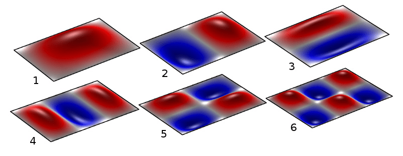

Concerning "nodes and modes" perhaps I can try to explain....
Panels, like all structures, have a set of frequencies at which they "prefer" to vibrate. These are called natural frequencies, resonant frequencies, or even eigen-frequencies. And the set of natural frequencies of any panel depends on the material properties of the panel (primarily its elastic modulus and density), as well as its shape and dimensions (length, width, thickness), and its supports (are the edges free, or hingelike, or clamped?)
At each of these natural frequencies, the panel has a different characteristic "shape". Each of those shapes is a "mode". Here is an example of some of the shapes, or modes, for a typical plate:
Or, for an animation, see here:
https://resource.isvr.soton.ac.uk/spcg/tutorial/tutorial/Tutorial_files/Web-standing-membrane.htm
When a plate is vibrating at the natural frequency associated with a particular mode shape, there are locations on the plate where the vibration amplitude is a maximum (i.e at the centers of the red and blue regions in the images above), and these location are called anti-nodes. Also, there are places where the vibration amplitude is zero (i.e at any point along the gray lines in between the red and blue regions), and these are called nodes.
As you can see in the images above. Nodal regions are typically lines, while antinodes are technically points. For example, for mode 2 in the figure, the gray line between the red and blue regions is a "nodal line", while the centerpoints of the red and blue regions are anti-nodal points, or simply anti-nodes.
Concerning the question of exciter location: An exciter will be most effective at "activating/exciting" a particular mode of vibration if it is located near one of the anti-nodes for that particular mode. Conversely, an exciter located along a nodal line for a particular mode of vibration, will not be able to "activate" that mode at all.
The reason that the center is considered to be poor choice of location for a single exciter is because the nodal lines of many of the modes pass directly through the center of the panel. Hence, placing an exciter in the center activates fewer modes of vibration than virtually any other point.
The idea of using the often cited 2/5 position likely stems from the patents of Azima/NXT, who advocated placing the exciter(s) at locations that avoided the antinodal lines as much as possible, to activate as many modes of vibration as possible, and hopefully thereby produce the smoothest frequency response possibe. Interestingly, the NXT patents never actually cited the 2/5 location. Rather, they cited several other location ratios, such as 3/7, 4/9, and 5/13. But all of these are pretty close to 2/5, so I suspect someone just decided 2/5 was probably good enough and that ratio become popularized on you-tube etc.
Likewise, I would probably not use two exciters out of phase on the same panel for any real speaker. But I actually do build test speakers with variations like that all the time, just to see what happens and to test my understanding of how these things work. That's where the real fun is!
I hope this helps.
Eric

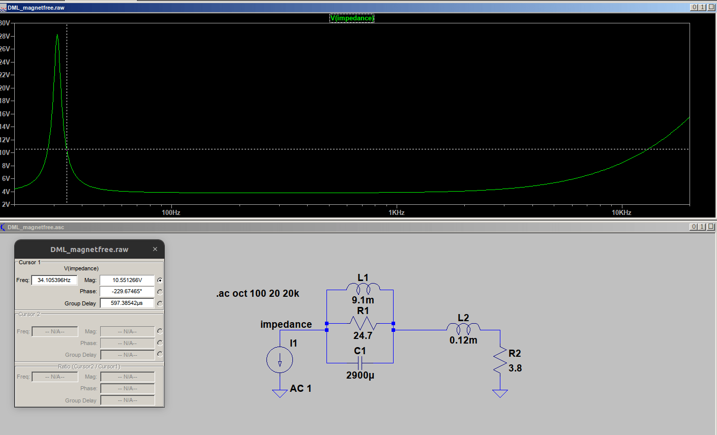

Yes, but...The impedance peak without a brace actually reduces heat (and power consumption) at very low frequencies.
+ @Veleric : Eric, your impedance measurements are steps to a better model of the DML behavior. Thank you for publishing it.
So to come back to what happens in free magnet conditions (no brace/spine) : as it was pointed in #11100 (@Eucyblues99 ), it is a coupled mass system. When the resonance of the magnet occurs (about 30Hz in the measurement), it limits the current in the system so the power in the voice coil and in consequence the force applied to the panel.
The problem is when this happens, the displacement is important leading to request to the exciter to work in an unwanted area of its stroke and then inducing distortion or compression in higher frequencies.
You will find in the attached file how the standard modelling of a loudspeaker can be applied to this first resonance to get an equivalent electrical circuit. Sorry, I haven't found an "easy to read" source to explain this... The source for today was in an excel file from M Linkwitz
In a certain way, letting the magnet free is the same as adding a RLC notch filter in series with the exciter... in worse speaking about the possible non linearity.
The next step should be to analyze what happens depending where this resonance is compare to the 1st mode of the panel. In the example you posted Eric, the magnet resonance is much below the 1st mode (even if it is not easy to say where is the 1st mode...). Is there a risk depending of the exciter/panel material and dimensions this resonance interfere in the bandwidth? The answer should be possible going further in the topic.
Waiting for that... it is one additional point in favor of a spine?
In the next steps I see from the impedance measurement is the evaluation of the damping as you suggest Eric. It is time to come back to modelling... when I will have fully re-install the needed software on my (new) computer.
Christian

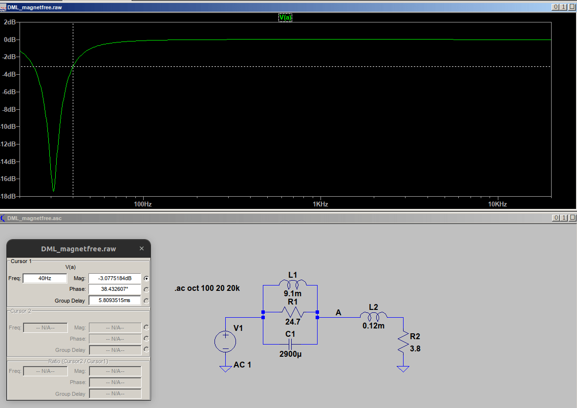

In addition to my previous post, a LTspice simulation (now re-installed on my computer!) showing the simplified model above fits pretty ok to the impedance measurement (model for 1st resonance and HF... even if L2 is a bit small here).
In the simulation as the AC current source is 1A, the voltage is equivalent to the impedance (1V <> 1Ohm)
And here the filter effect (means the equivalent attenuation). Pretty steep (-3dB at 40Hz)

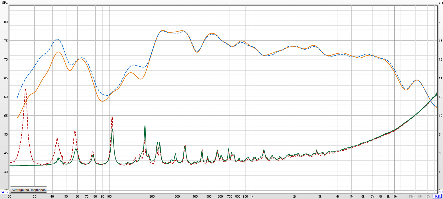

You might think the braced exciter would give better base response. I did too until I tried it. But the several times I have compared the same speaker with and without a brace, there was no increase (or decrease) of any significance in the base response.But instinctively I would say that bracing will give you a bit better bass response, and at 35hz you will get more acoustic power, but also use more electric power with the lower impedance.
For example, the results below include the frequency responses I obtained with the same speaker assembly, with and without the brace, along with the impedance results I shared earlier. The dashed lines are without the brace, and the solid lines are with the brace. I have tried this same test at least a half dozen times with different speakers but the same result, that is, no significant effect on frequency response.
Indeed that is a fair point. In fact, the 1st mode of this panel is at 100 Hz (confirmed by tap testing and the impedence curves). It's possible that the results would be different if the panel had a lower first modal frequency.
Eric

I concur entirely 👍👍You might think the braced exciter would give better base response. I did too until I tried it. But the several times I have compared the same speaker with and without a brace, there was no increase (or decrease) of any significance in the base response
I would have thought the +5dB difference around 70Hz would be audible. It is a very important range for bass reproduction, and I'm a bit surprised if it is not a noticeable difference, but you probably would need to do AB testing to spot it. And when it comes to power applications it is certainly significant. 5dB at 70Hz is the same difference in power as 11dB at 140Hz or 17dB at 280Hz.You might think the braced exciter would give better base response. I did too until I tried it. But the several times I have compared the same speaker with and without a brace, there was no increase (or decrease) of any significance in the base response.
Overall the bass response seems stronger in the unbraced, and response in the braced version looks very similar except that it is pushed up a few Hz below the first mode of the plate, so certainly confirms that I was wrong in my speculation.

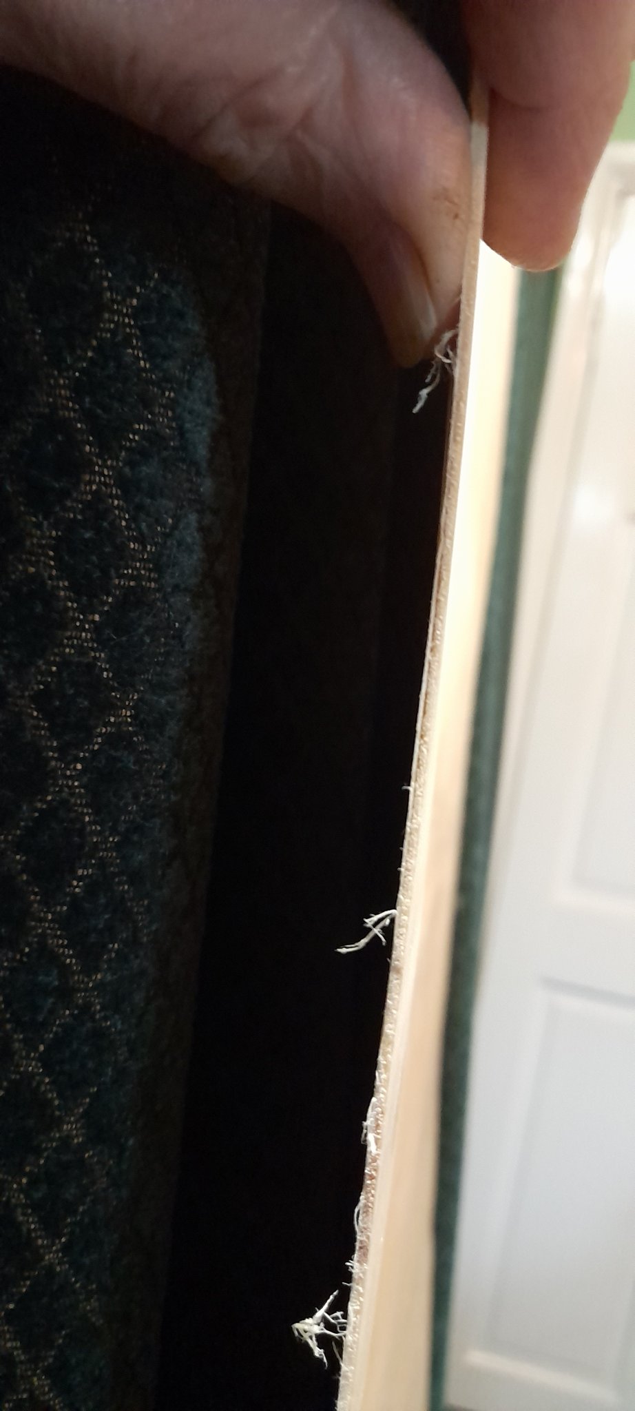

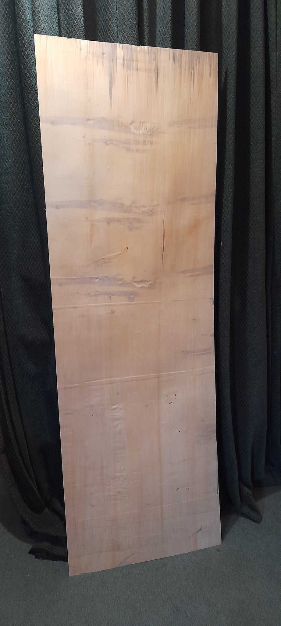

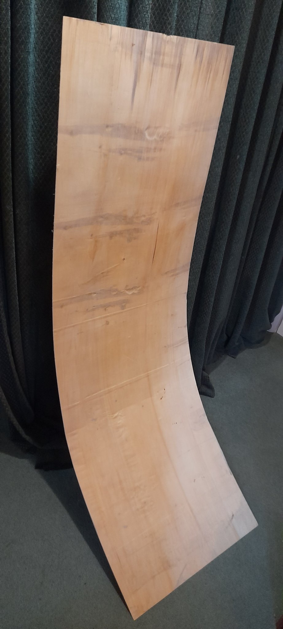

While I was getting some plumbing supplies in wickes diy store, I noticed this sheet of 1mm 6x4ft scrap of ply🤔
I could not stop myself from asking if I could have it.
As you can see from the three pictures it is exceedingly flexible.
I was hoping it was a single ply so that I could test different flexibilities in different directions.
But when I got home I found it was a 2ply.🙄
My wife was very happy to see this suddenly turn up in my front room, overjoyed in fact🤥🤣
I will have to find somewhere to hide this, until I get around to testing.
Which will probably be some time, as I have a lot on my plate at the moment .
The idea was to make small panels , time will tell.
Steve.

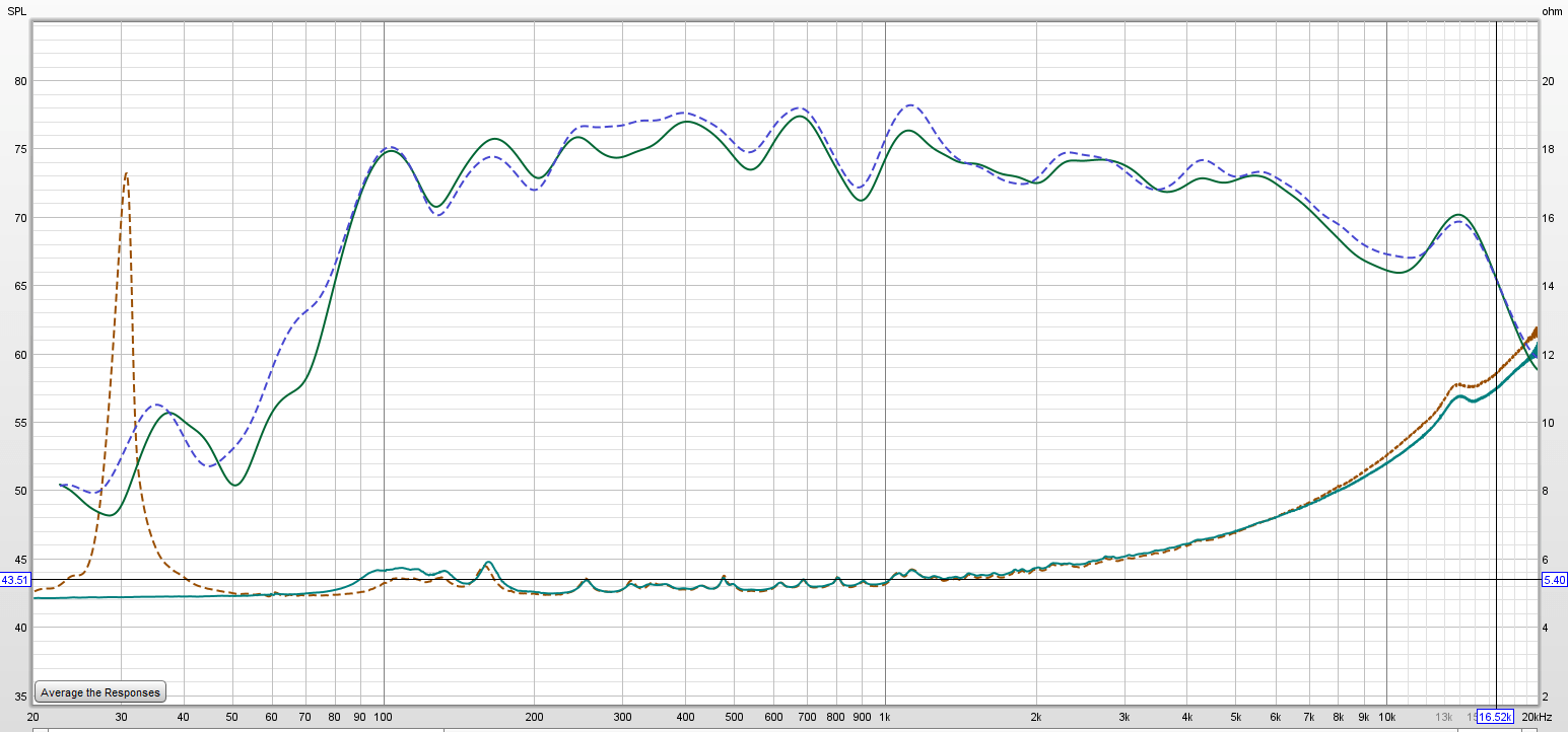

Below are the results of a second test that I just performed, comparing SPL and impedance curves with and without a brace supporting the exciter. In the new test, I used a panel with a much lower fundamental frequency (about 43 Hz) than the panel in the previous test (about 100 Hz). The panel in the new tests is a 48"x18" panel of 14 mm thick XPS.
The dashed lines are the results with no brace, and the solid lines are the results with the brace. As in the previous test, the addition of the brace eliminates the impedance peak associated with exciter's mass and spider (at about 25 Hz in this case). Interestingly, the addition of the braces reduces height of the first several panel resonances as well.
Concerning the SPL, there appears to be some increase in bass output without the brace, particularly below about 60 Hz. In the previous test there was a similar (but much smaller) effect.
For me, evidence is building that the addition of brace does not increase bass output, but rather may actually decrease it. That said, I wouldn't consider the elimination of the brace to be a meaningful improvement to this panel, as to me this panel is really only "useable" above about 200 Hz (if at all).
These results demonstrate another thing that I've observed fairly consistantly (but has nothing to do with the brace). Which is that if I build a panel with a fundamental frequency of about 80 Hz or higher, there is a chance (with the right aspect ratio, right suspension and right exciter placement) that the SPL response can be reasonably flat above the panel's fundamental frequency up to at least 5 kHz (or even 15 kHz). But If I build a panel with a lower fundamental frequency, I inevitably end up with a big gap in the frequency response between the fundamental and about 150 to 200 Hz. So while tuning the panel lower allows significant bass output, it's not what I consider "useful" output, The present panel is a good example of that, with the large dip in output between about 50 and 200 Hz. For this reason I've pretty muched stopped even trying panels like this where the fundamental is below about 80 Hz.
Eric

Oh I'm sure she was as thrilled as my wife would have been!I was hoping it was a single ply so that I could test different flexibilities in different directions.
But are you sure it's not 3-ply? 2-ply would be really unusual, and particularily prone to warping. Except for veneers, I've never hear of it.
Eric
Eric.
I believe this is the centre core of an unfinished scrap 3 ply .
